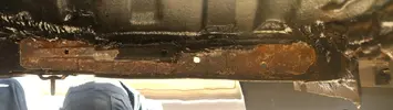

Finished off the under-sealing today... until I find the next bit of rust! 🤦‍♂️
Front Nearside Arch:
Front Offside arch:
