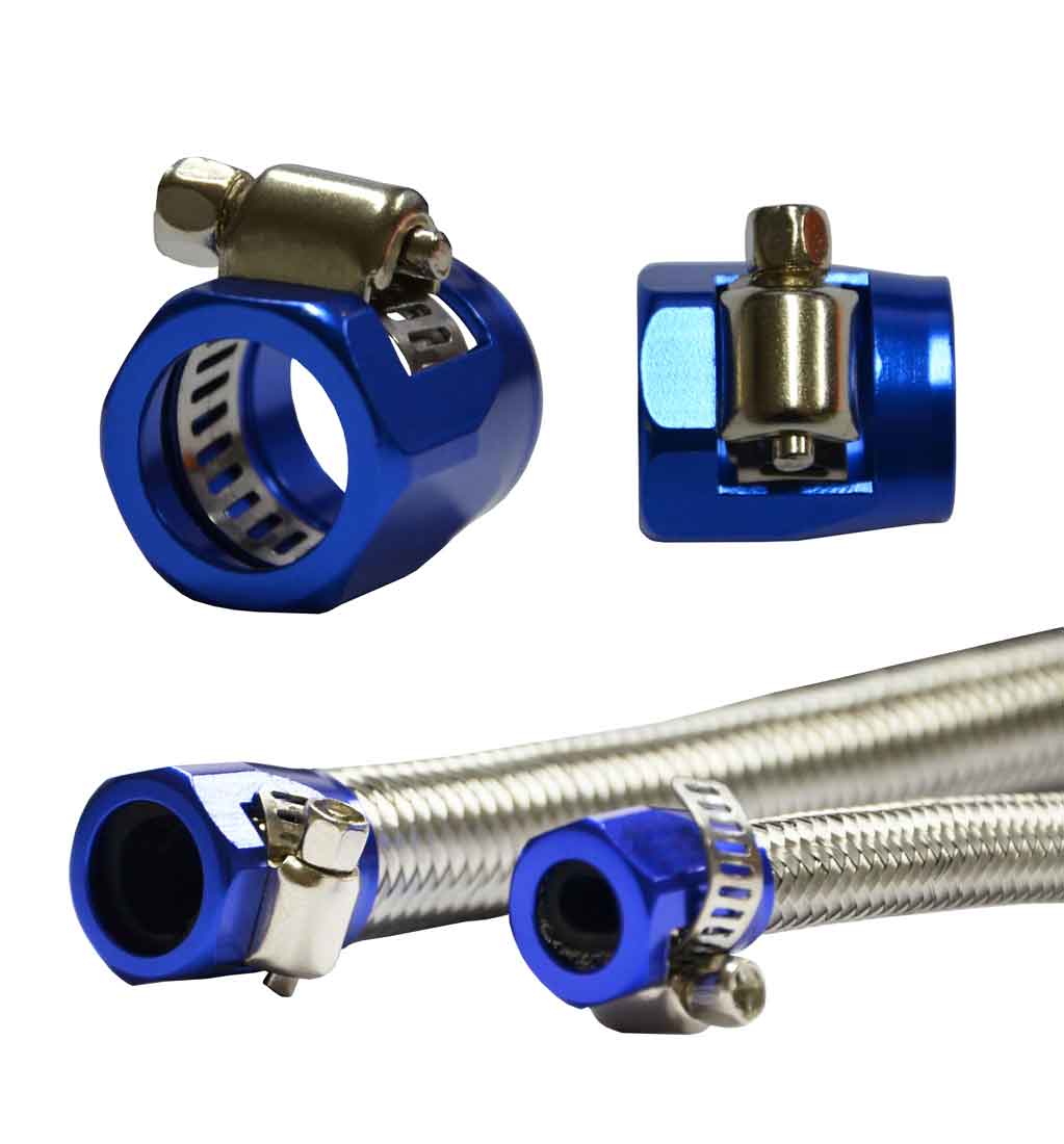

They are a proper Jic type fitting for use with braided rubber hose the nut slips over the hose and the rubber is pushed up the taper in the other part of the fitting, then it is tightened up and locks up. Cannot be swapped about with PTFE hose fittings, but allows push on fittings at the barb type ends.I've decided to remove the stock tank ( in the rear) and add a new tank in the front (boot?). The front tank setup will have a properly sized outlet and return ports. Plus the weight transfer to the front will be nice. I plan to copy the setup Steve Swan used on PaulE's car. Just more work and $$'s.
I'm curious abou the "push-on" hose fittings on the fuel fump and filter. Are they half of a JIC (AN) hose end? I've not seen this type of fitting before.
