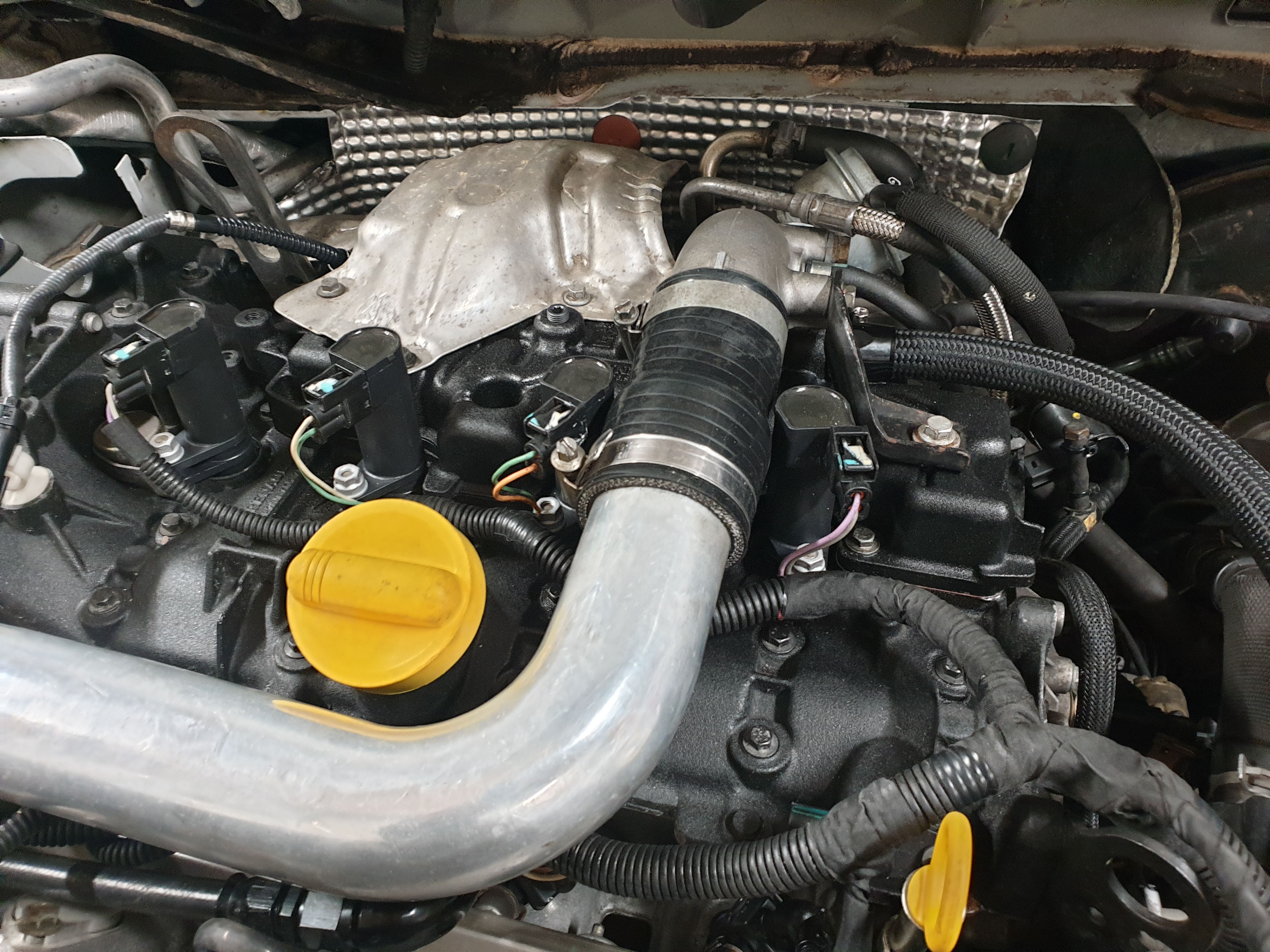

Breather plate was leaking oil as the sealant had failed (as per most f4r) so took the opportunity to fit the correct meg 250 larger volume breather plate compared to the r26 one i fitted previously.
Its knacker tight to fit with turbo on but just managed to slide it in on an angle. Used a gasket instead of sealant this time, see how that fairs.
Also took the opportunity to remove the pcv valve that goes the breather plate, removed the pipe and fitted an 1/8 npt grubscrew and bunged the hole on the inlet with a samco end cap. Thats the last of the emissions crap gone.

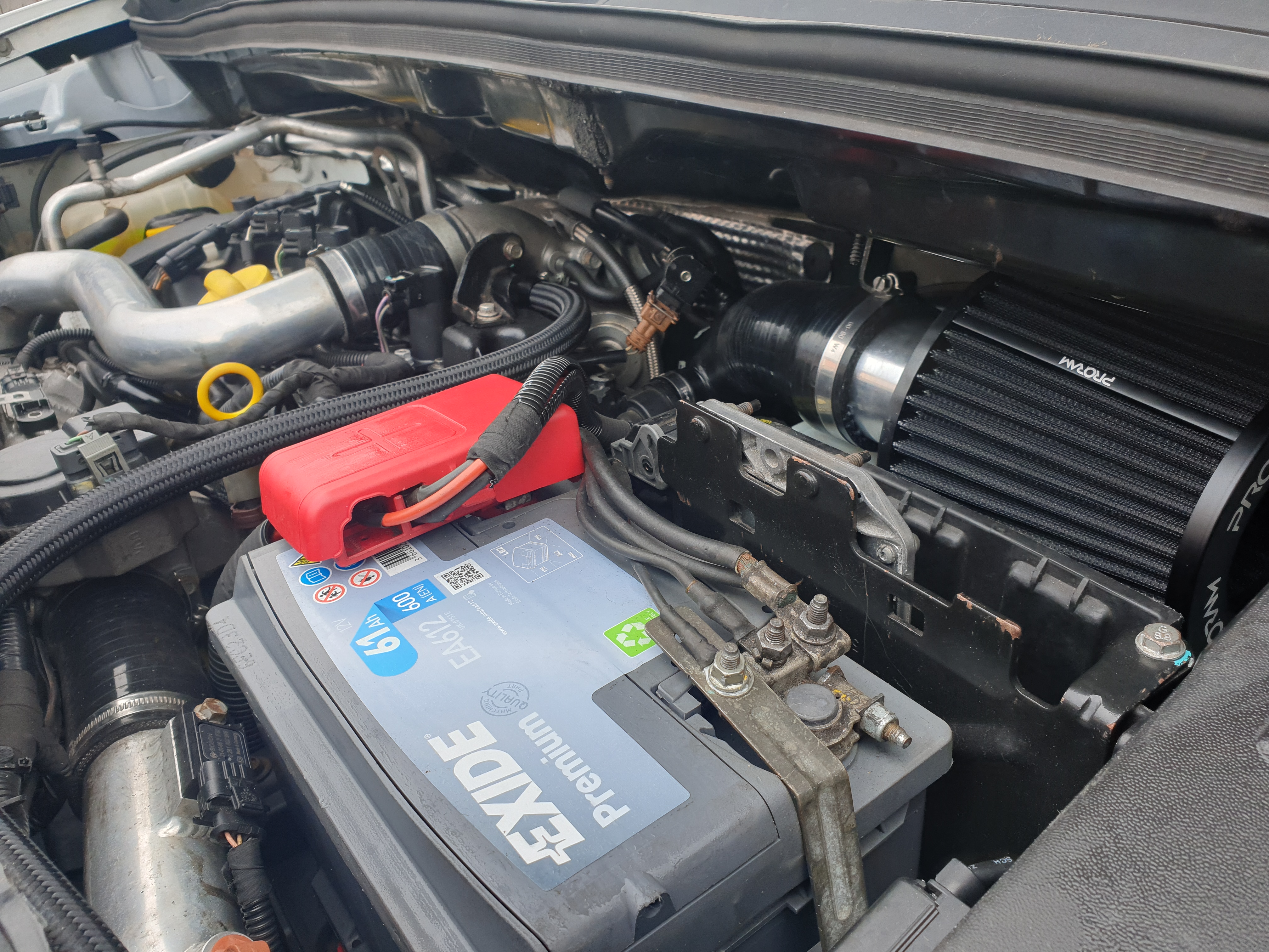

Fitted a new Ramair proram airfilter. I had a foam one fitted previously, but not too keen on them now as seen a couple fail and damage turbos.

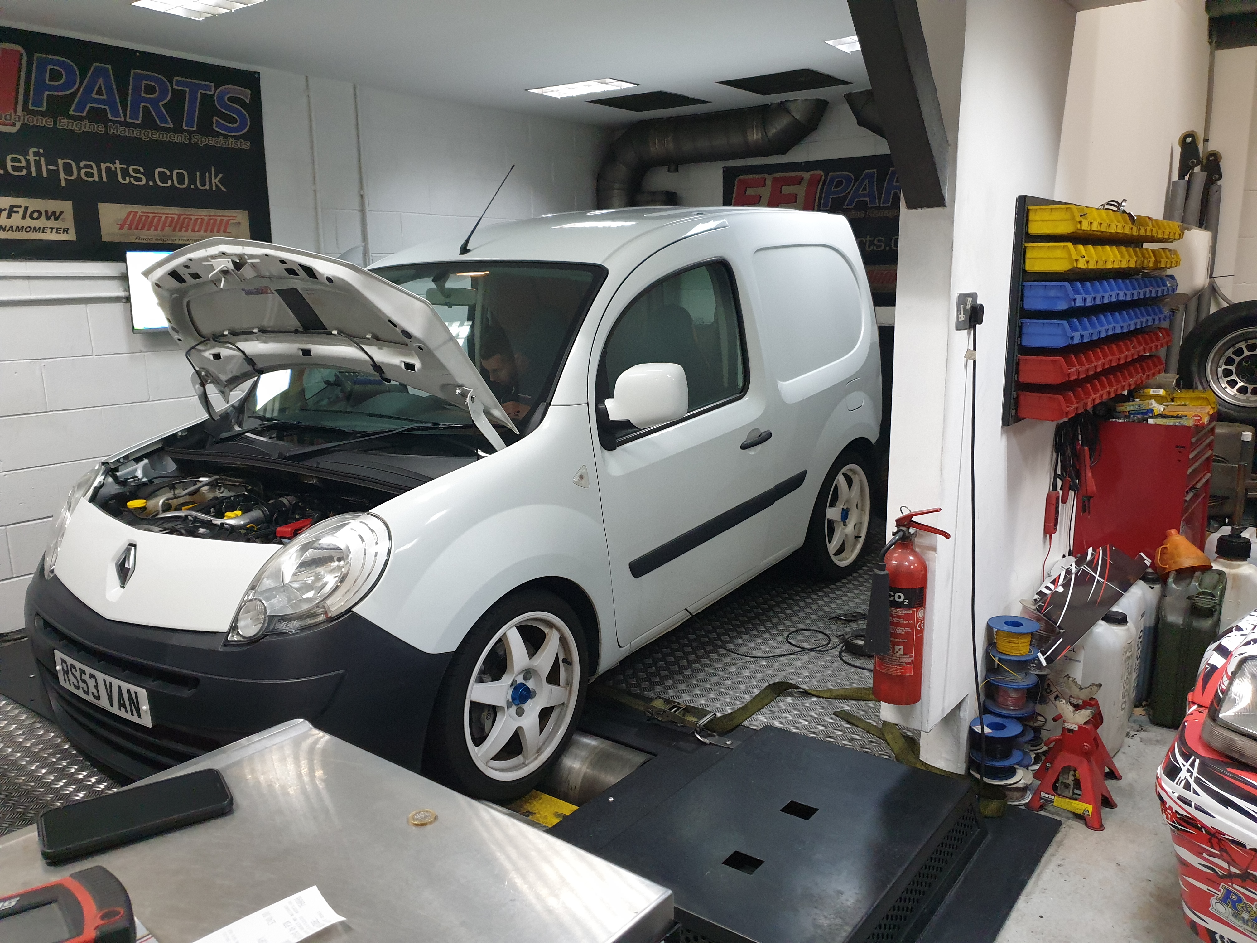

Updates

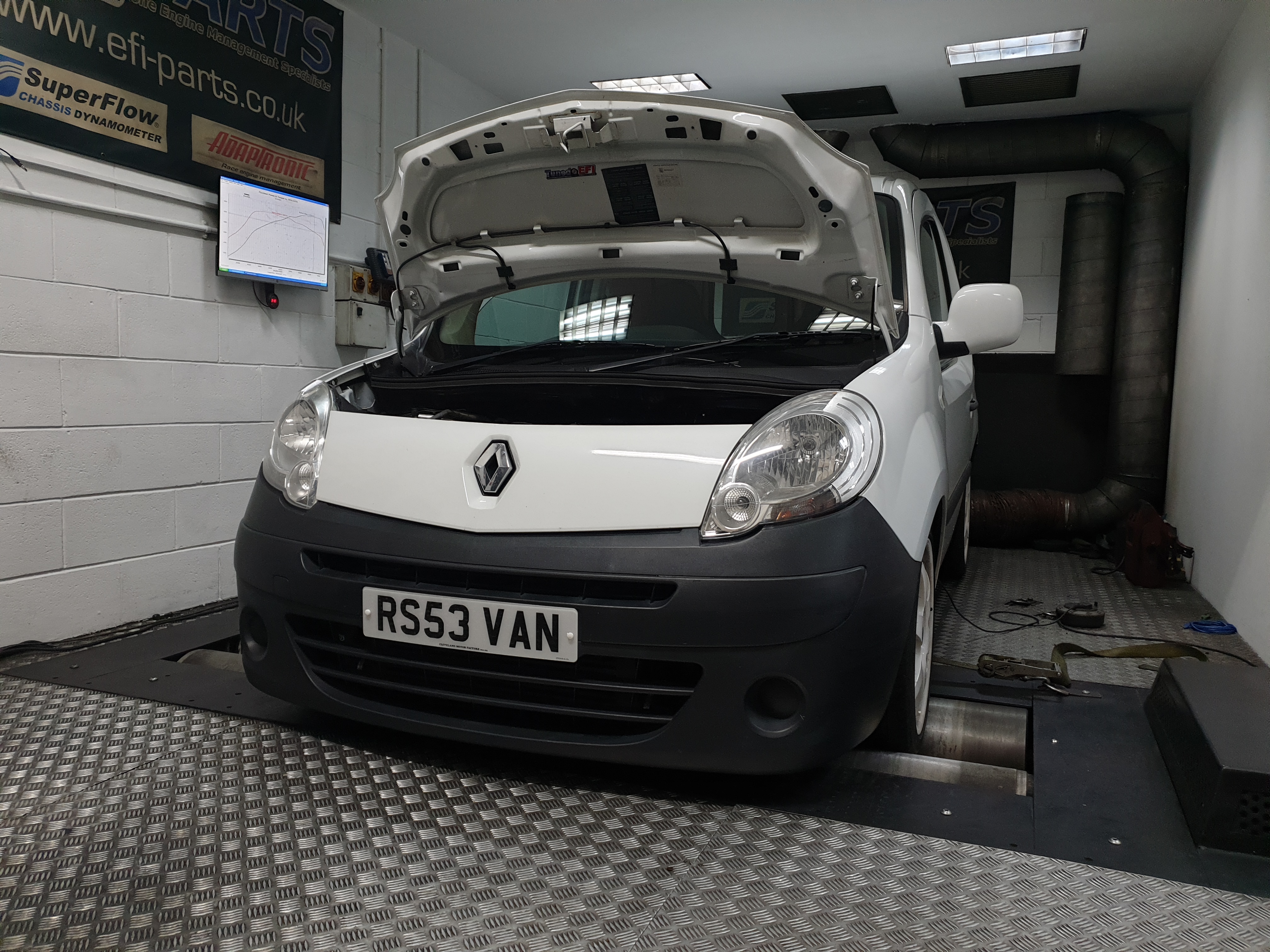

Had the Kangoo in for a map tweak at EfiParts, as changed a few bits since last map, new clutch, new oem n75 valve, air filter etc.
The short story is - clutch basically failed straight after mapping earlier this year, it was slipping on the last power runs and once fixed with uprated clutch it was quick for a short period of time then boost dropped a bit. Que fault finding and replacing a load of bits (Renault life?!) New n75 valve got the boost back up and felt quick on the road again but didnt really log boost.

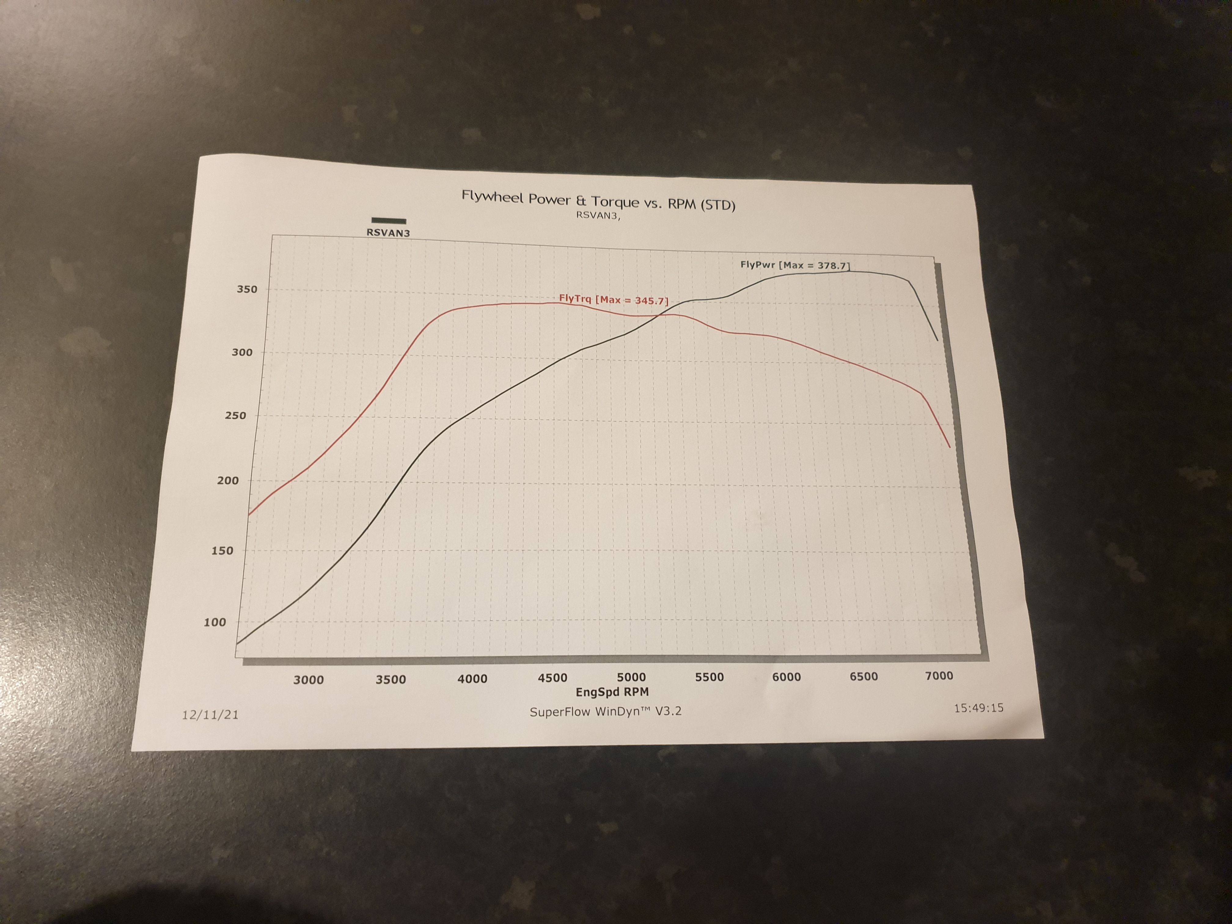

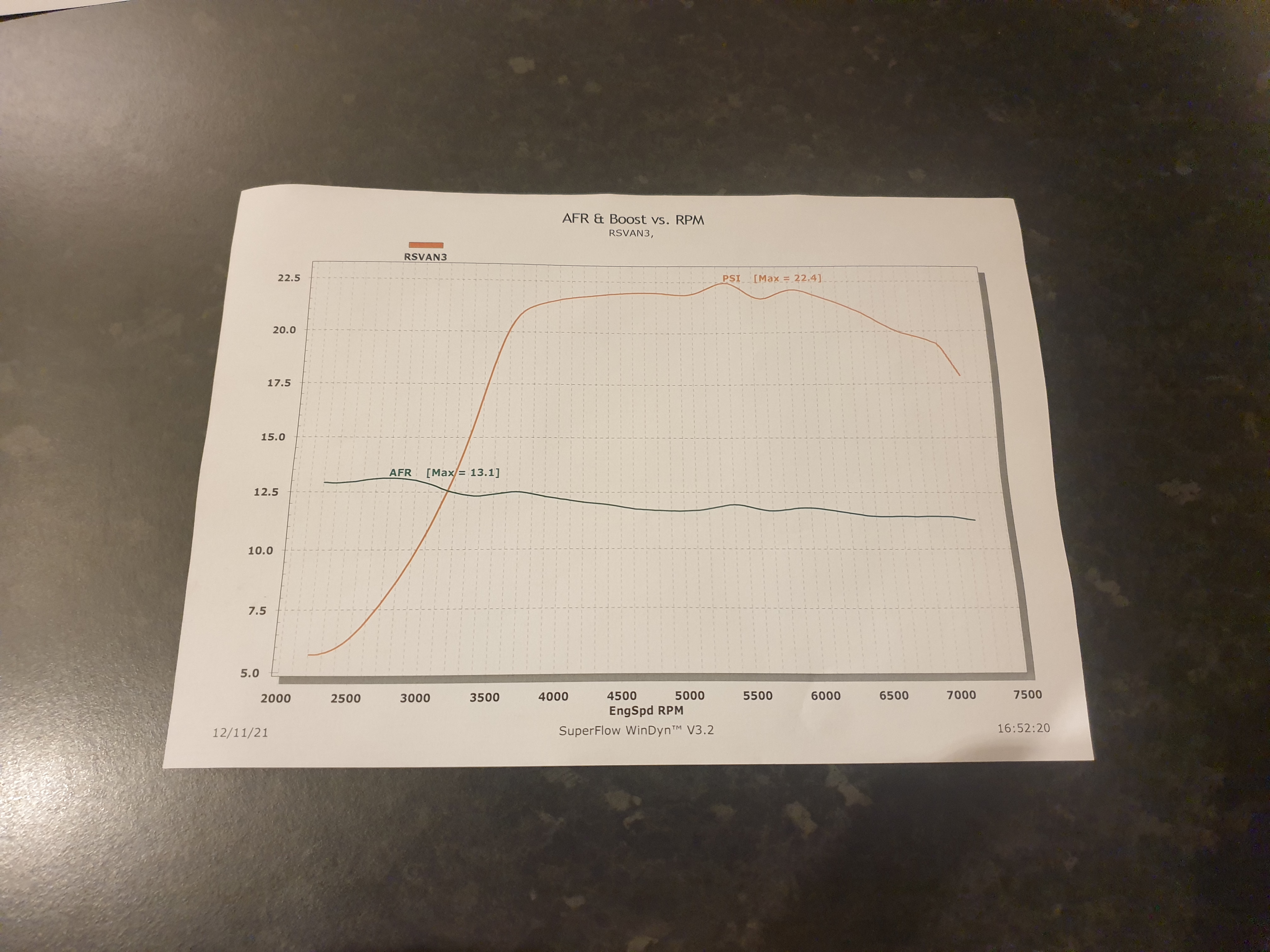

Strapped on the dyno and first run was 335hp ish hp, down on power from last time due to lower boost pressure. Looks like the n75 valves can differ a lot from new, which might not cause too much bother on stock power but quite a difference on a mapped setup with raised boost.
A few more runs and more n75 duty was dialled back in to raise the boost pressure back up to around 22psi resulting in 378hp & 345ft/lb.
Feels mega quick again, and loads smoother power delivery which helps with traction. Great job from Chris as usual, it feels loads better to drive now.
