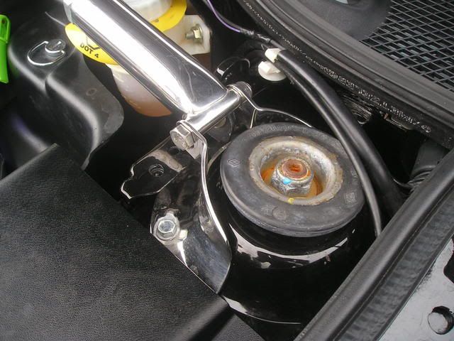

Front strut braces you can use any 172/182 fitment ones BUT if you have the front cargo tray fitted you have to slightly cut it on the passenger side.
i think i have an omp adjustable one fitted, there's no mod required?
but you cannot take the tray out without taking off the strut bar
so it will be inconvinient if you need a head bulb change or battery replacement
Slight trim around the brake fluid bottle on the 255.
