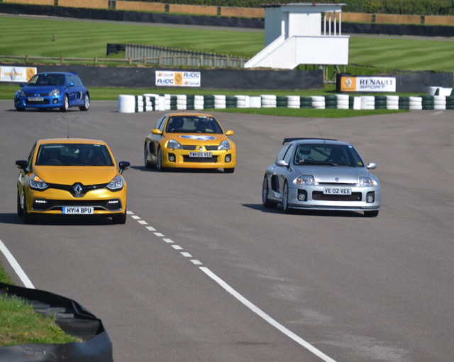

I booked a 'whole day' of track time to familiarise myself with my Ph1 Vee. The body shop hadn't fitted the 'ducktail' V6 Trophy spoiler, so the 'facelift' spoiler was still in situ.
I was having a wonderful time and was enjoying mixing it with my wonderful compadres from our club.
It was roughly on the the fifth session was the 'incident' happened. I vaguely remember passing Jitstar's missus between Madgwick and Fordwater, when suddenly the rear end felt very light.

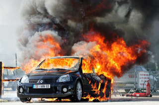

I checked the rear view and there was a plume of white smoke behind my Vee. All I could do was straighten my line and gently coast onto the left hand side grassy verge.
By sheer chance, Scott Glander was on board. We piled out to see what was up, only to be confronted with an engine fire!
As you can imagine, there was only one image going through my mind...
Remember it vividly.....white smoke, got Charlotte to back off and slow down.
Saw you go off the side of the track and then saw licks of flame from the back of the car....the above image also went through my mind!
You calmness when I saw you back in the paddock was admirable!
CHAPTER 4b...the great escape (of Goodwood).
Scott didn't hang around. He whipped off the engine covers and discharged the contents of the fire extinguisher to the front of the engine compartment (directly at the source of the fire).
Unfortunately, this still was not quite sufficient - but the Goodwood fire crew were soon on hand to completely tender the situation safe.
The car was then recovered and transported back to SGMs got decontamination and inspection.

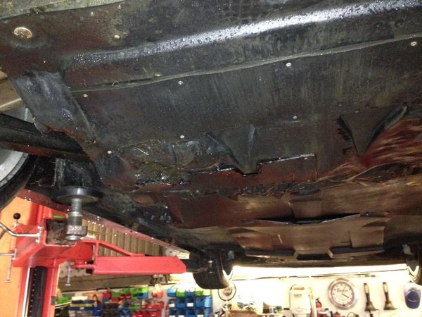

The undertrays were flocked...
Overall, the fire was contained and damage was relatively limited. A scary moment nonetheless!
Further investigation has identified the source as a 'pinched' Samco hose which fed the Mocal Oil Cooler, fitted as part of it's engine customisation plan.
We think an engine removal/insertion for a service or inspection must have caused the component damage.

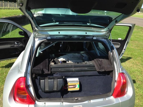

Also, great shout on raising the diagonal on the cage! Annoyed I never did that! You will notice the extra weight of the cage though and the smell when you open the window! (Pro's and con's of the cage!)

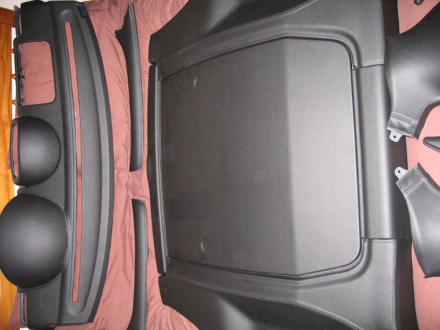

The next stage has been quite an eye opener. It began with my Danny Coolaslife's interior retrim.
His work was done by Andy Stenning of
http://www.ajtrimming.co.uk
In principle, my plan is to follow suit. I thought it would be something I could 'get on with' whilst the Clubsport was laid up.
On that basis, I began collecting:
As you all know - V6 parts costs a 'premium and some'. Well these 172 parts cost pennies.
