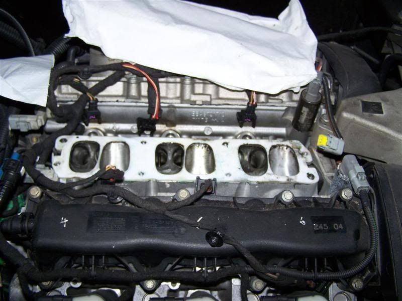

Which items do you need part numbers for?
I don't see a plenham gasket on the MK1 ?
Can't see big versions of those pics but I need part numbers for
Phs1 Inlet Manifold Gaskets
Phs1 Plenum Gasket
Phs2 Inlet Manifold Gaskets
Phs2 Plenum Gasket
so all x3 inlet gaskets for both model variants.
