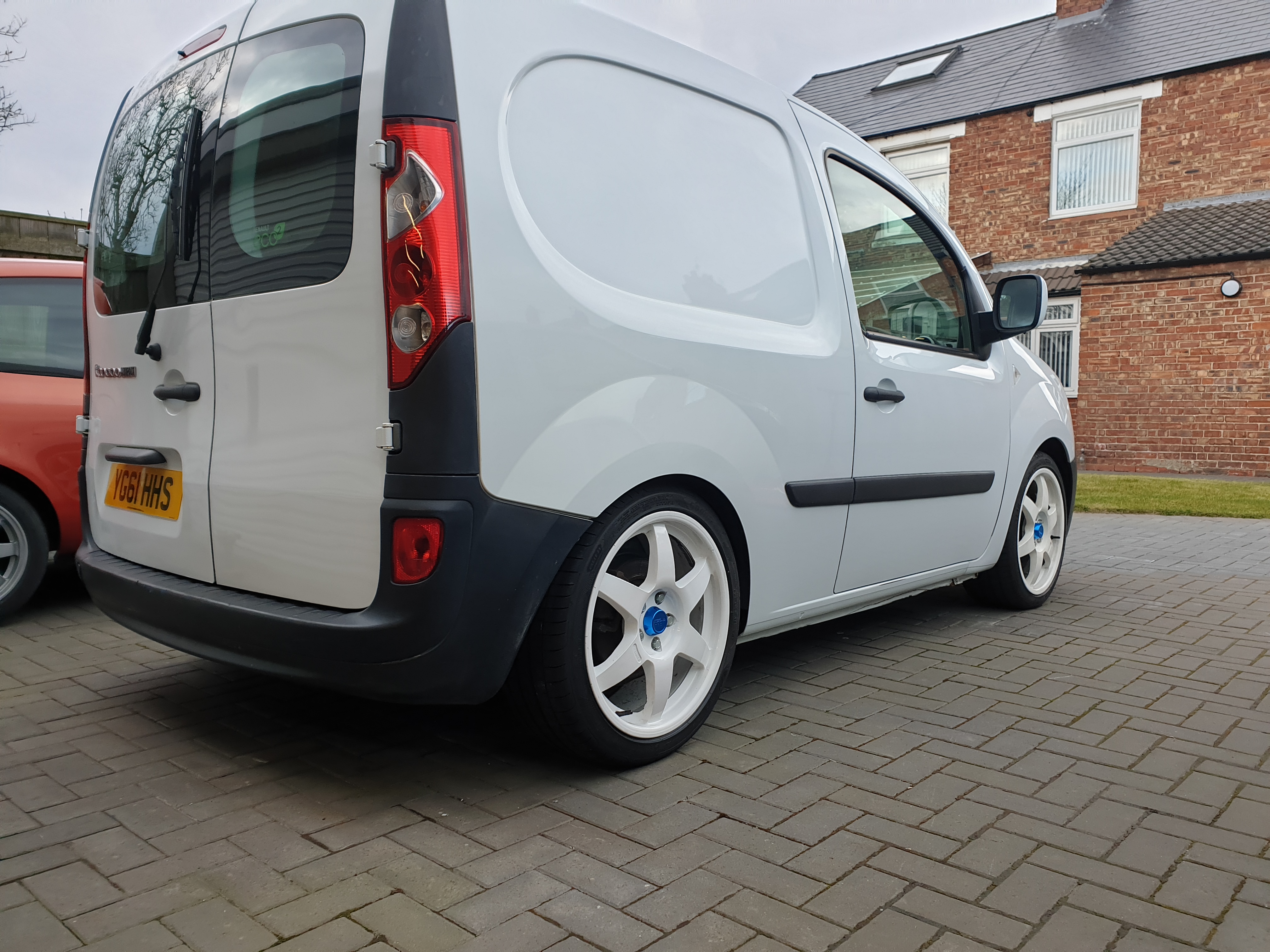

Bought a set of clio 197 H&R springs to see if the rears would fit to sort the rideheight out
Kangoo H&R on the left, 197 on the right
Original rideheight
Fitted, on its arse
If anything its actually too low on the back now :LOL:
To run this low, id have to drop the front a bit, and it feels a bit scene to me, ultimately i just want a reasonable arch gap, 25mm from tyre to rear arch will be ample.
Ive had to refit the Kangoo H&R as the clio springs just fall out when jacked up and need some shorter shocks, i ordered some gaz last week but 6 weeks lead time. Will revisit soon.

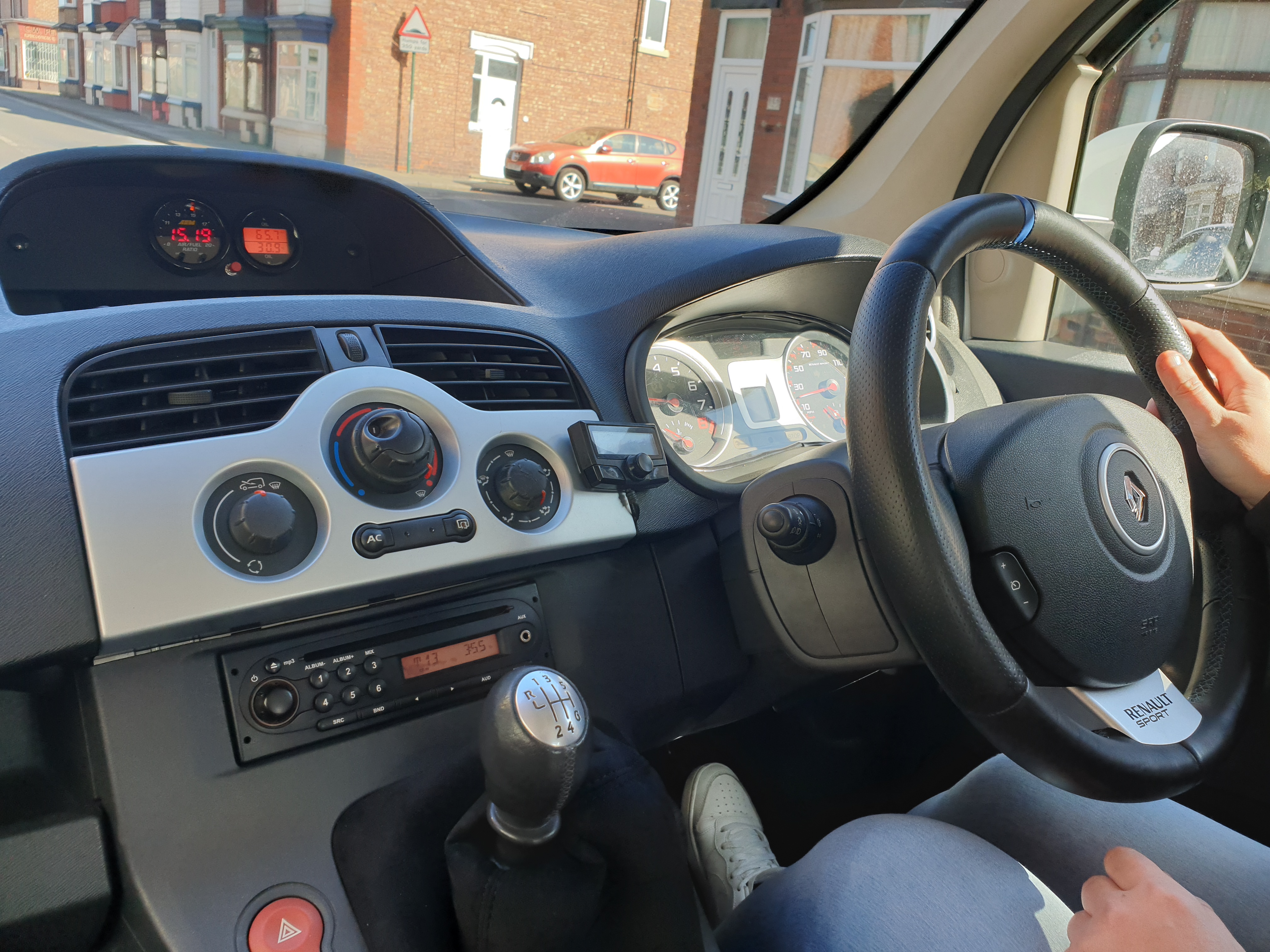

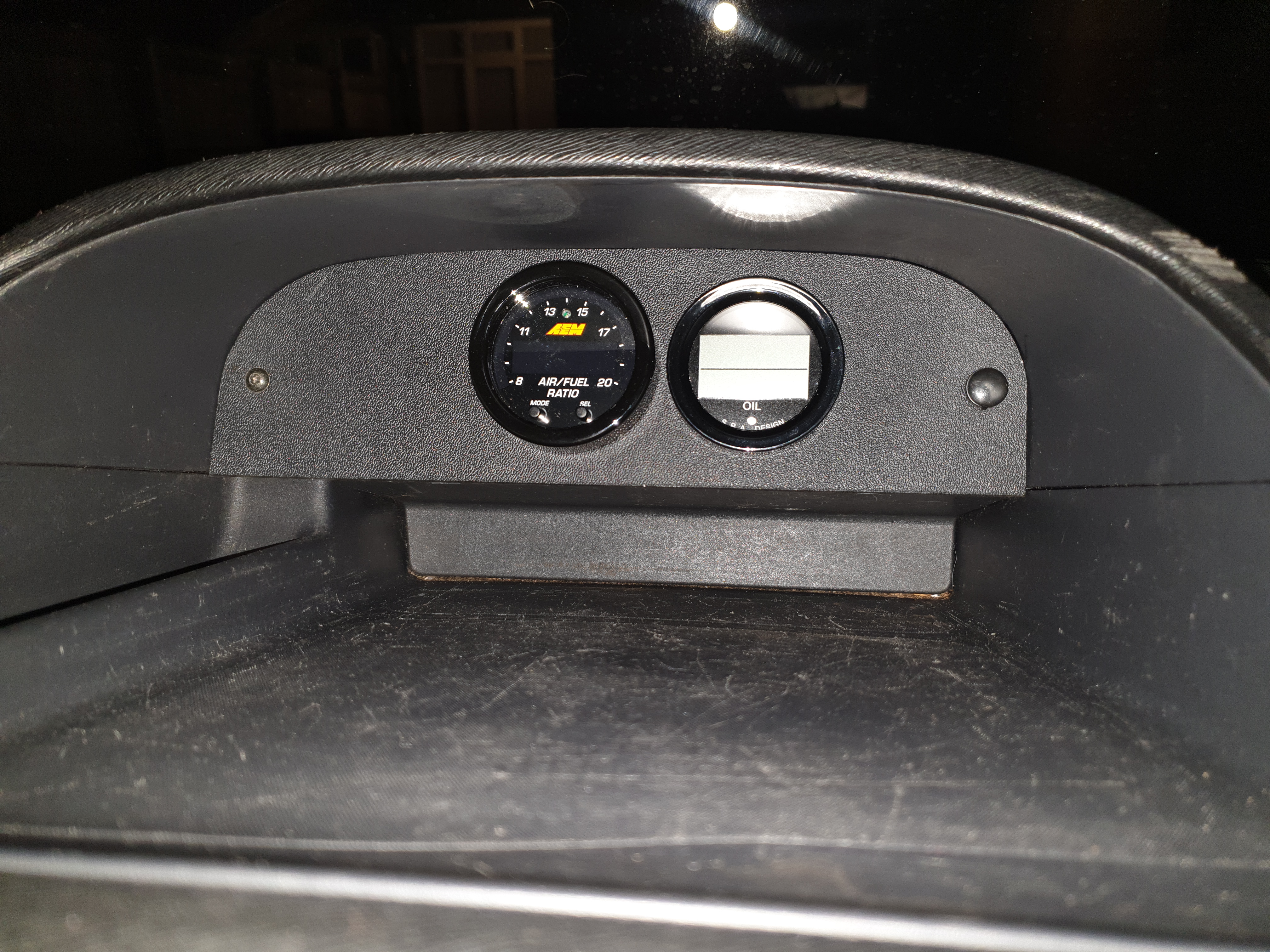

Made a start on fitting my aem afr and spa oil pressure/temp gauge. Knocked up a quick gauge pod for the cubby hole, wiring needs fitting next but ran out of time and light. You might notice the gauges are slightly offset,this is to suit the cubby hole behind and save chopping the dash. Nice discreet installthough quite hidden.

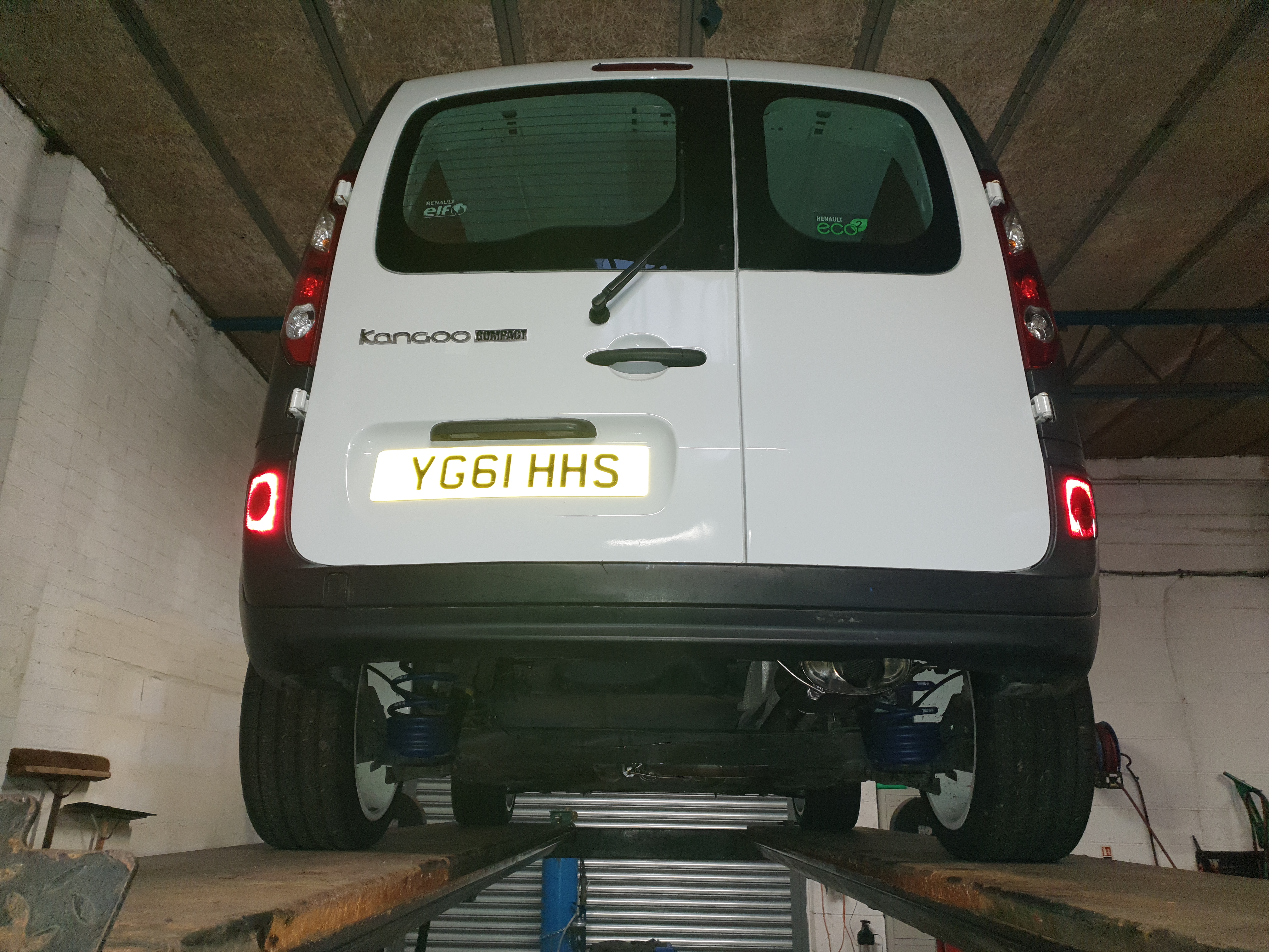

Small update

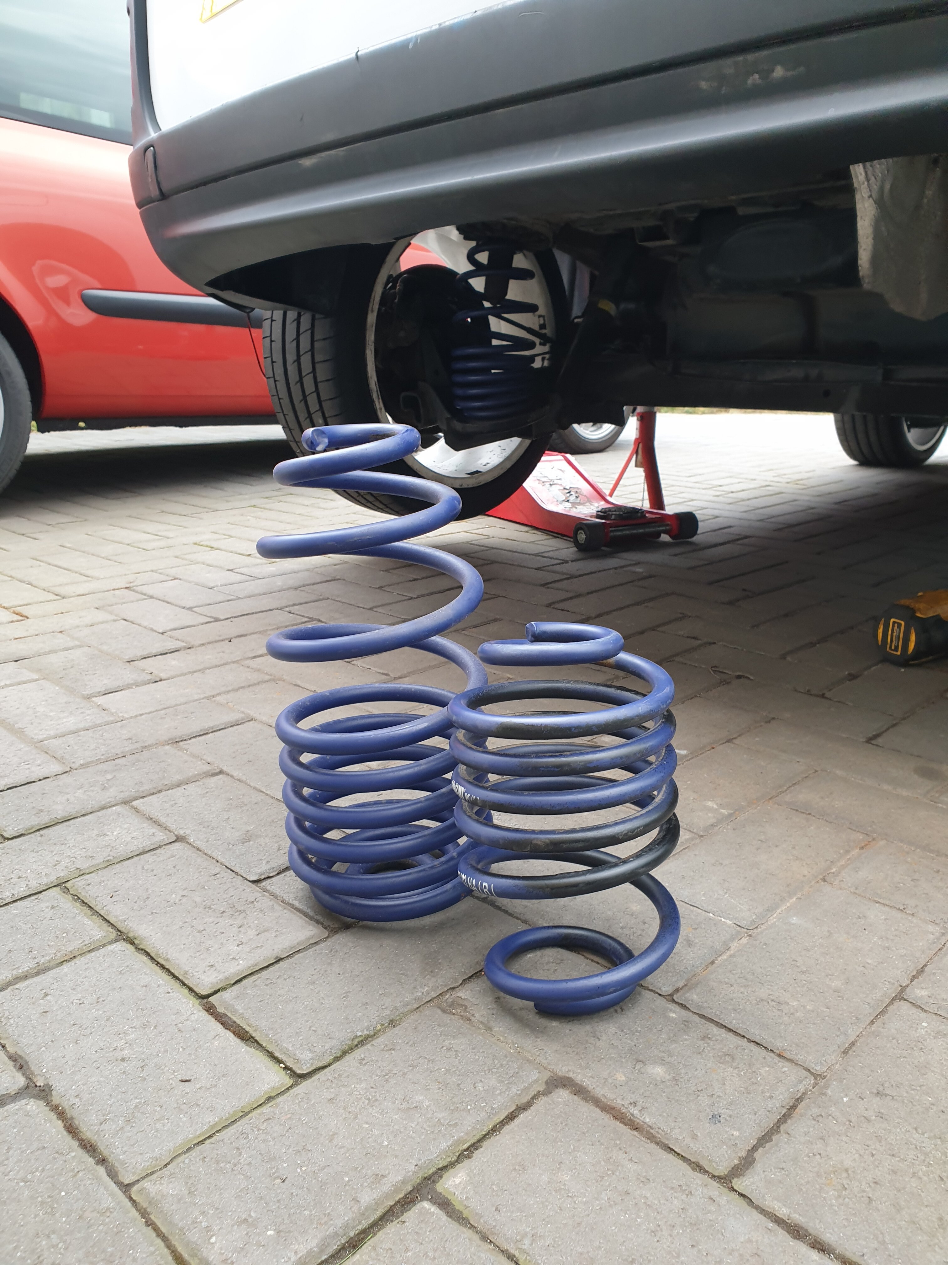

Original rideheight
Fitted, on its arse
Thanks for reading!!
Looking at the line if the sill to the floor in the pic it looks spot on to me.
looks good to me too, though you could try adding spring seat adjusters to raise it up a touch if needed ?
Will revisit rideheight when shorter shocks arrive. The sill level is about bang on, shame the arch gap is bigger on the front.
In the pics its not too bad, but from most angles it looks like its dragging its arse with reverse rake, which will only look worse if squatting on acceleration, and i think it could be riding the bumpstops when cornering on the back unless very hard springs.
Im reluctant to slam the front as the geometry looks quite good as is. Id be happy with a bit of rake, as i always find the handling is better. Will see.

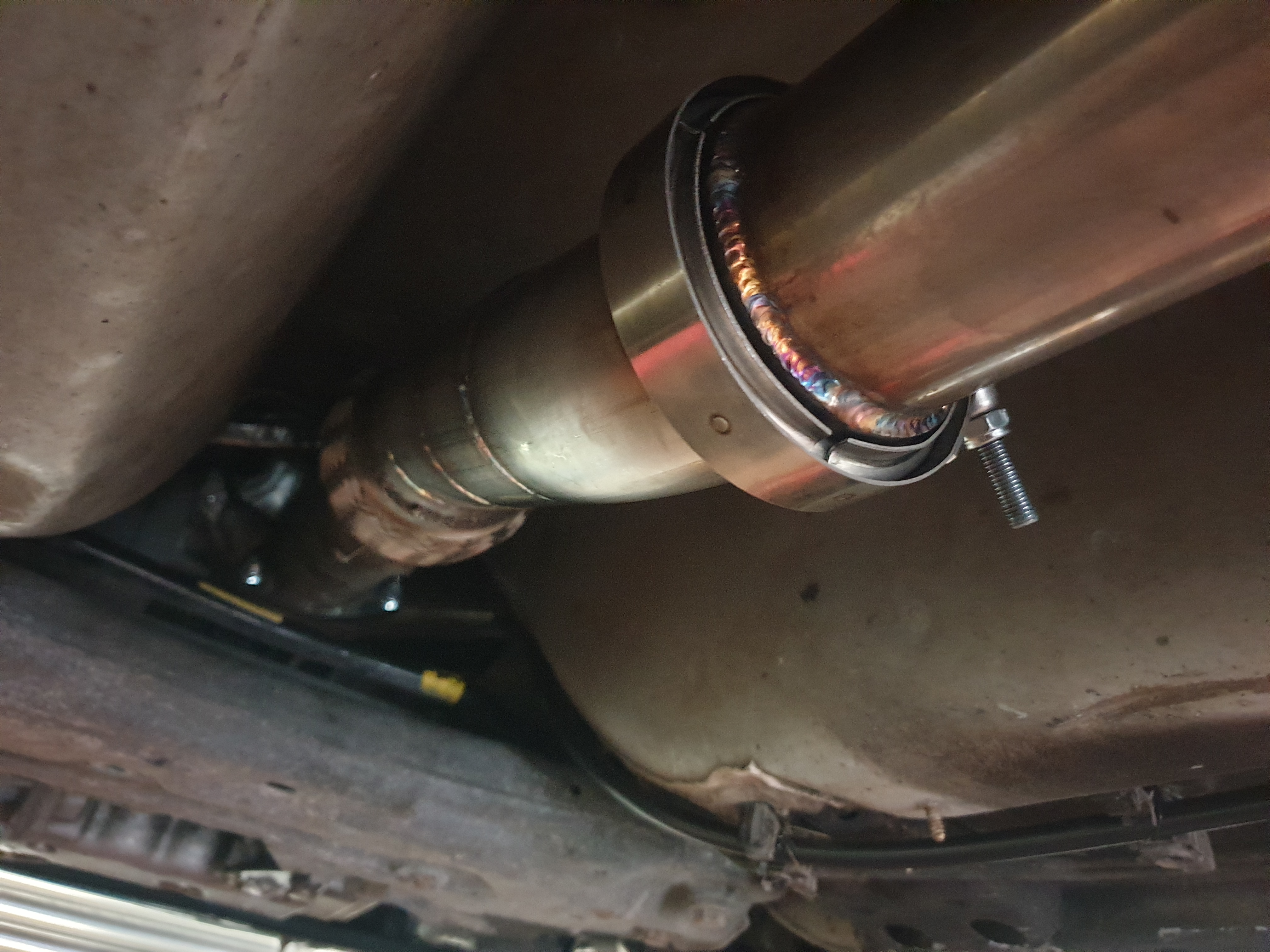

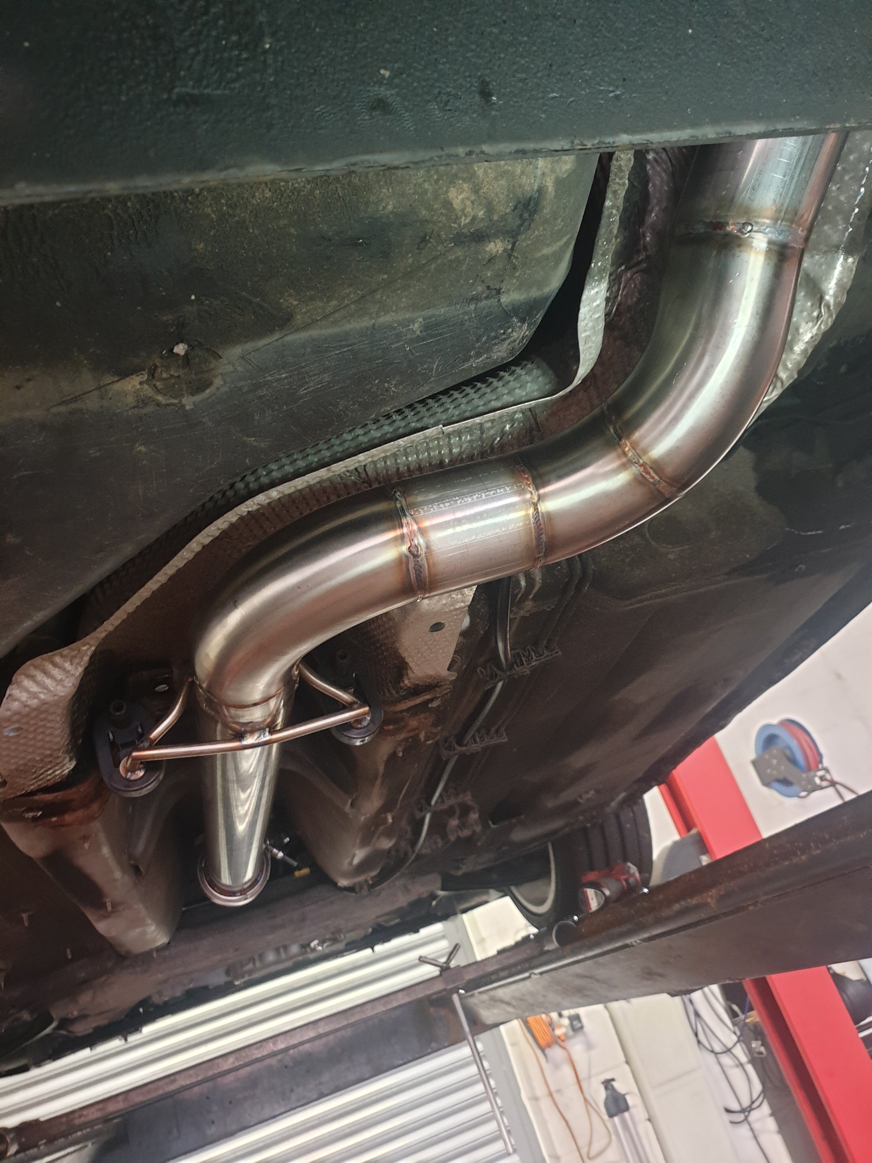

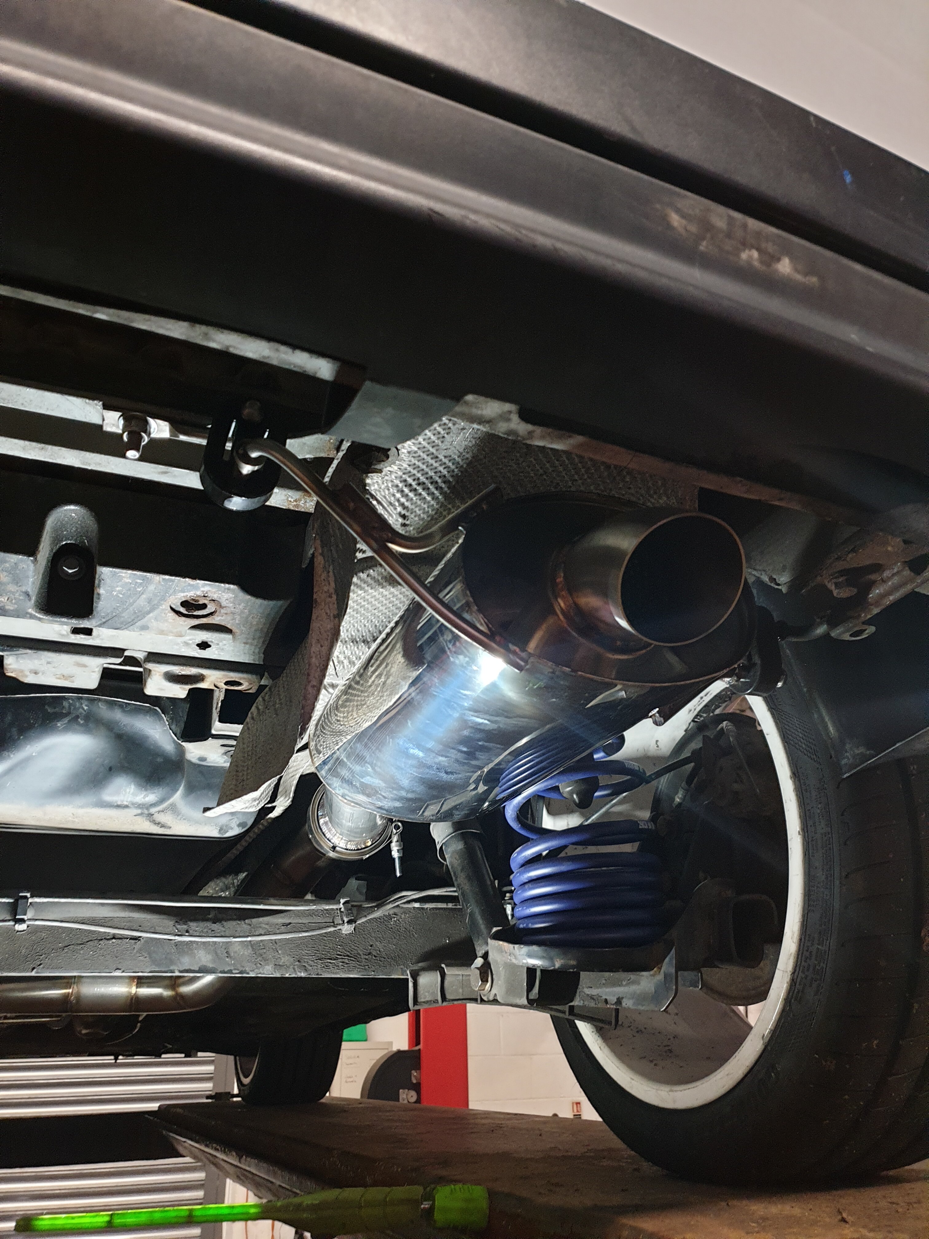

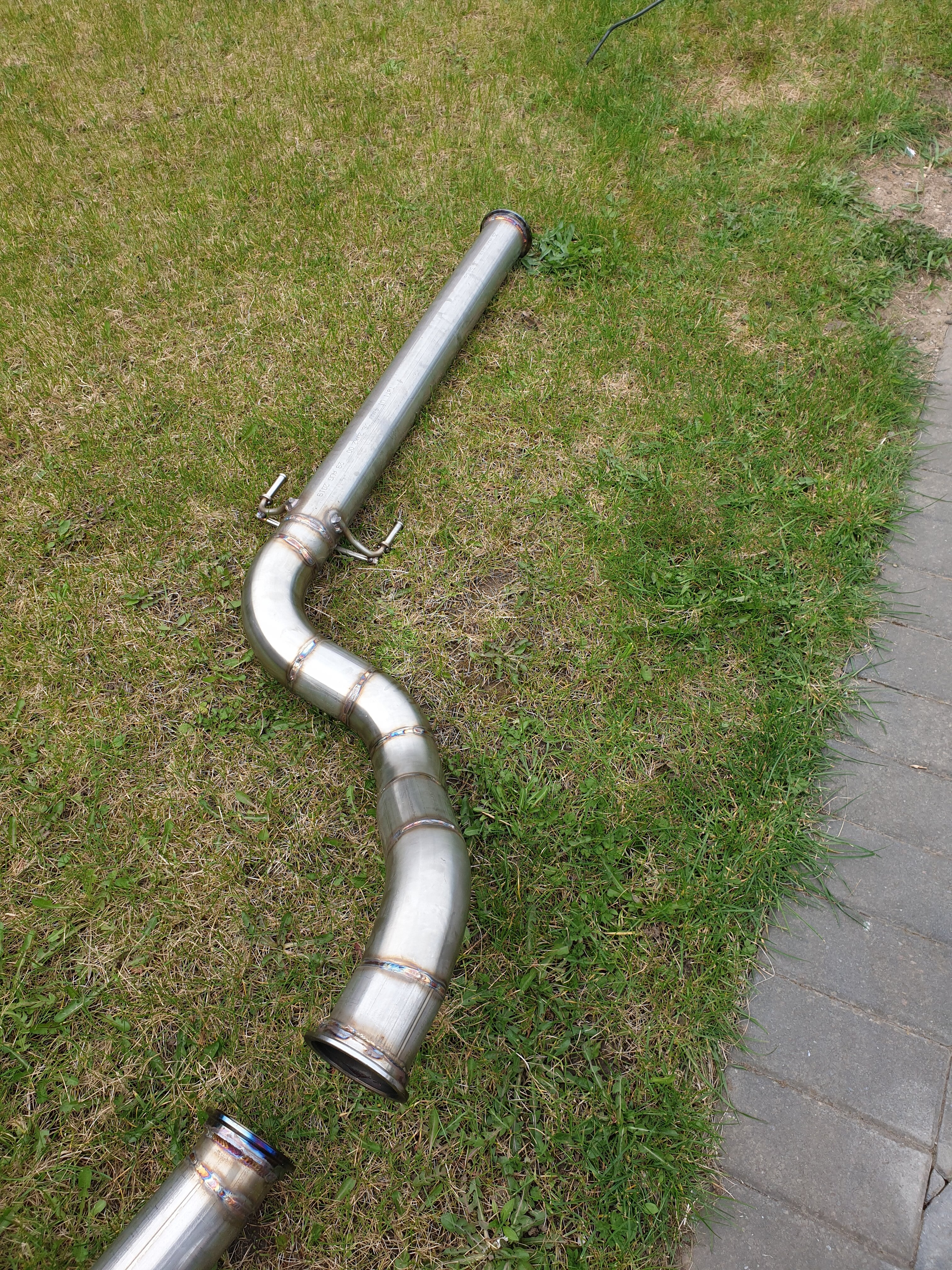

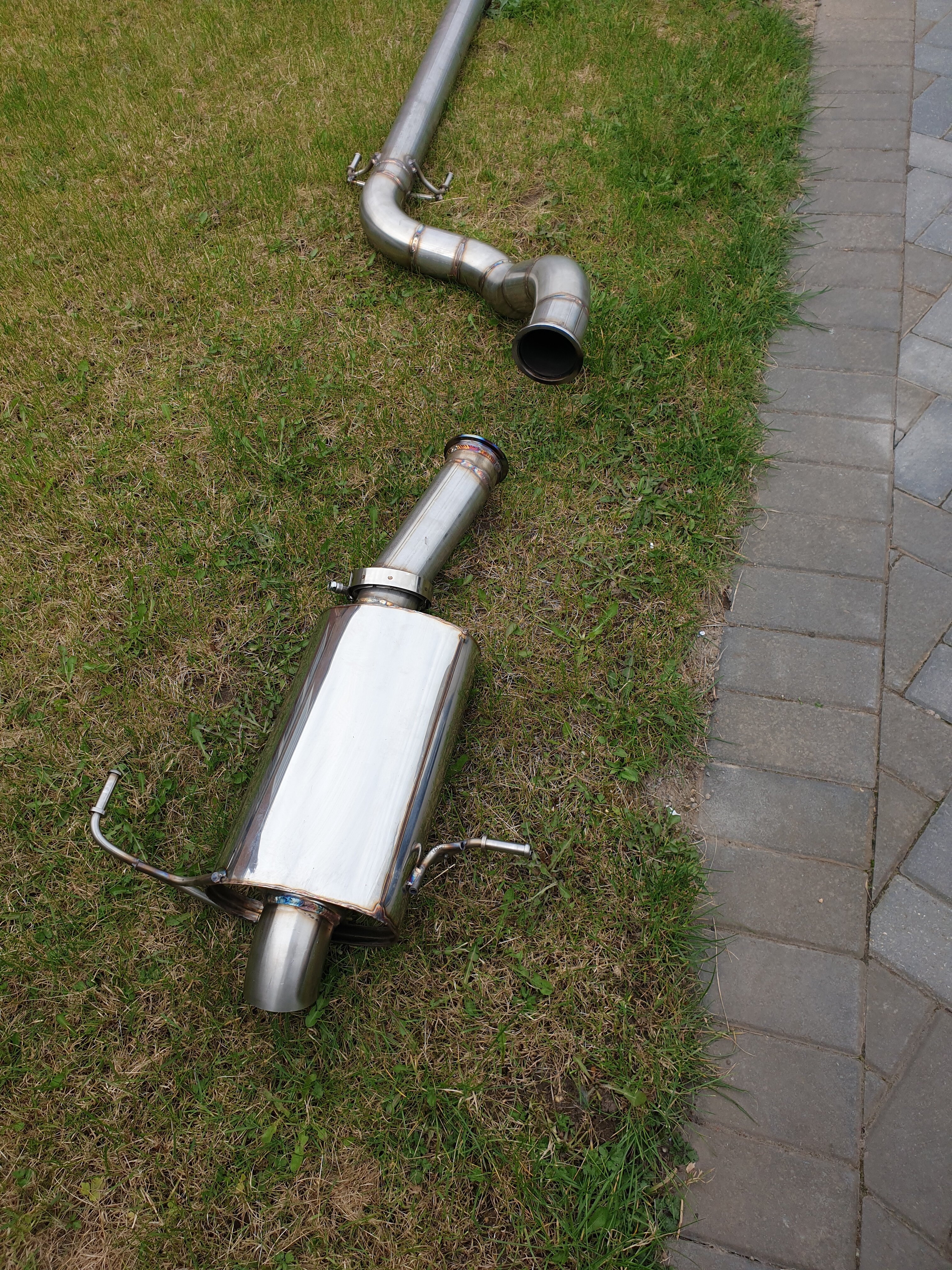

Arrived at Longlife Middlesbrough and straight on the lift. Asked for 3" stealth system with single silencer with v bands for ease of removal.

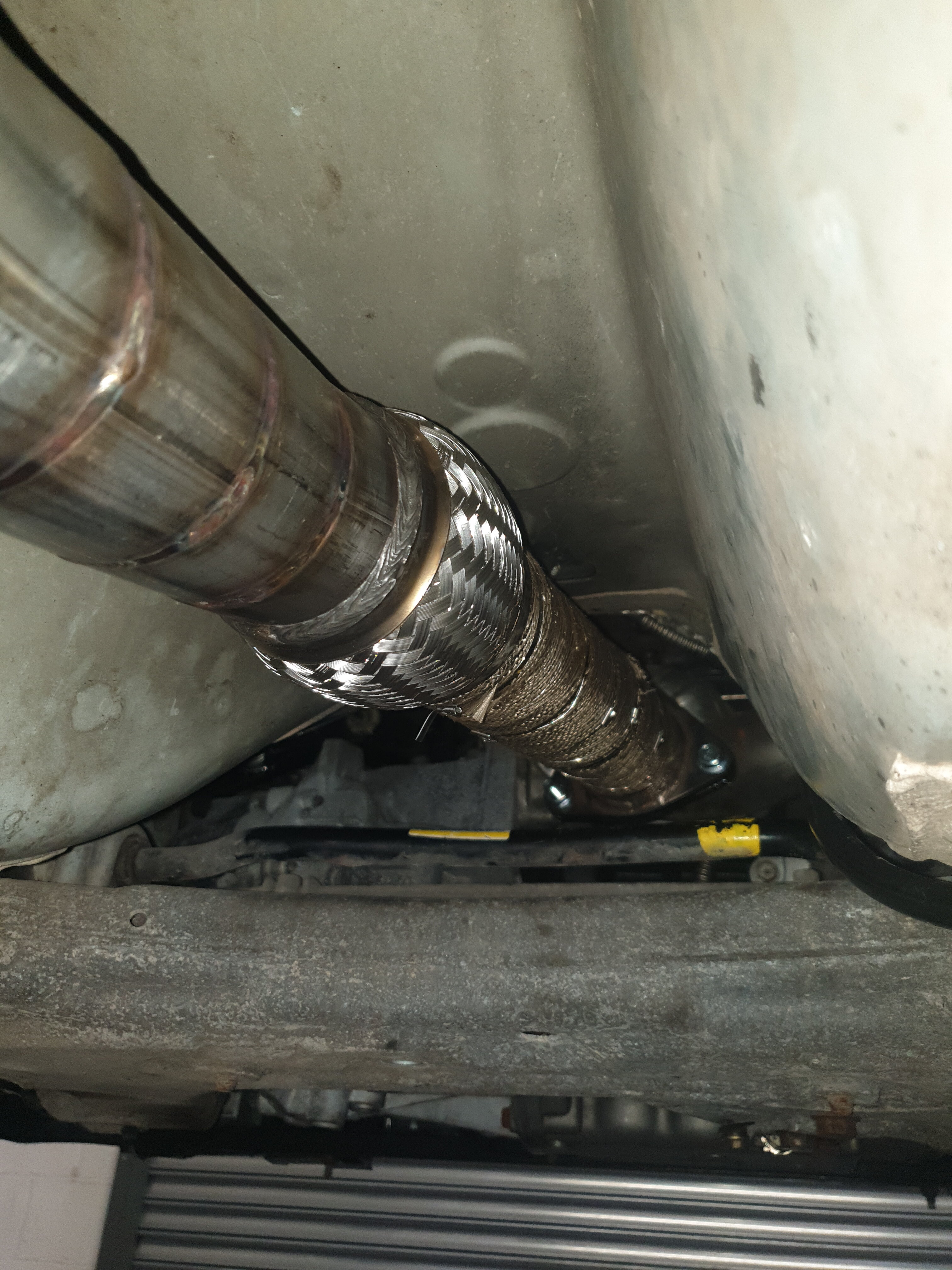

Megane Scorpion 3" front pipe needed a tweak as a bit close to the floor.

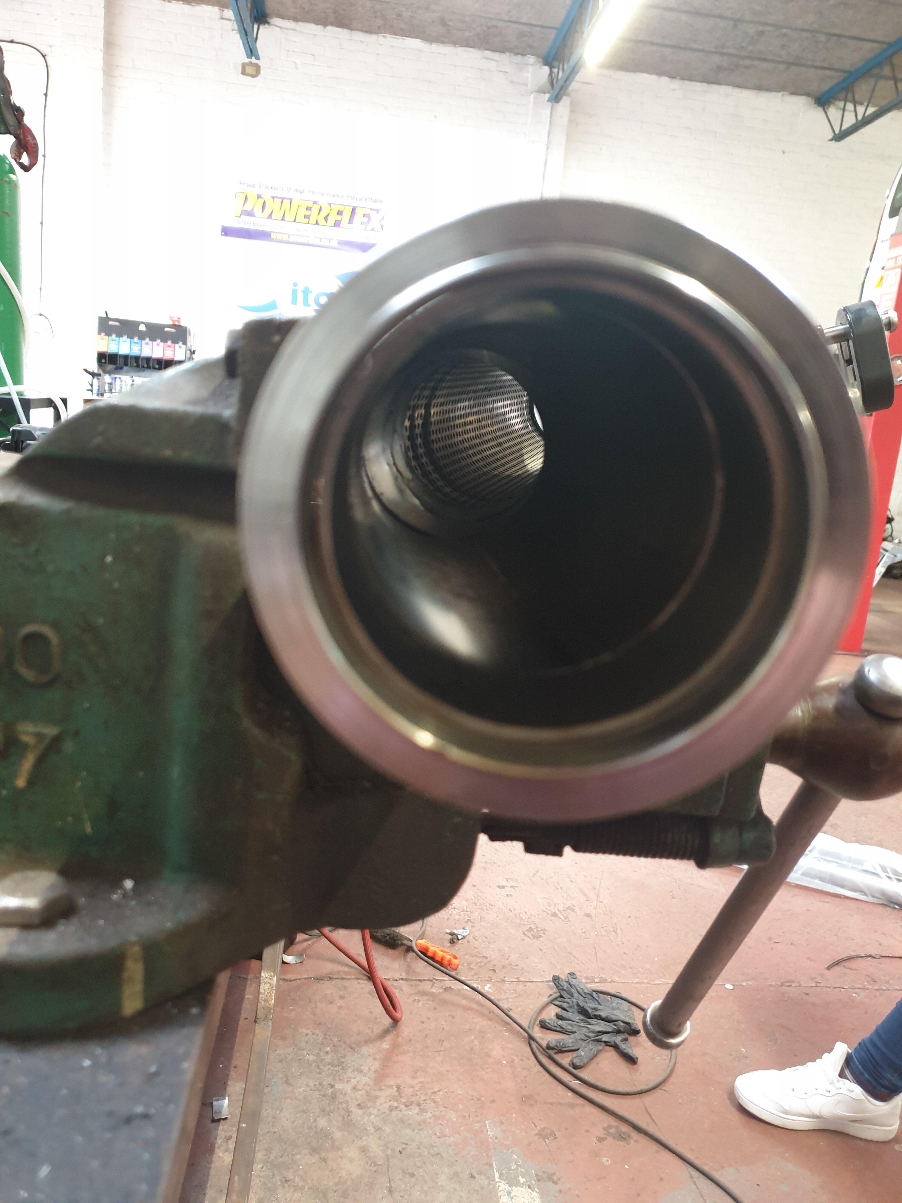

Vband and pretty tig welding

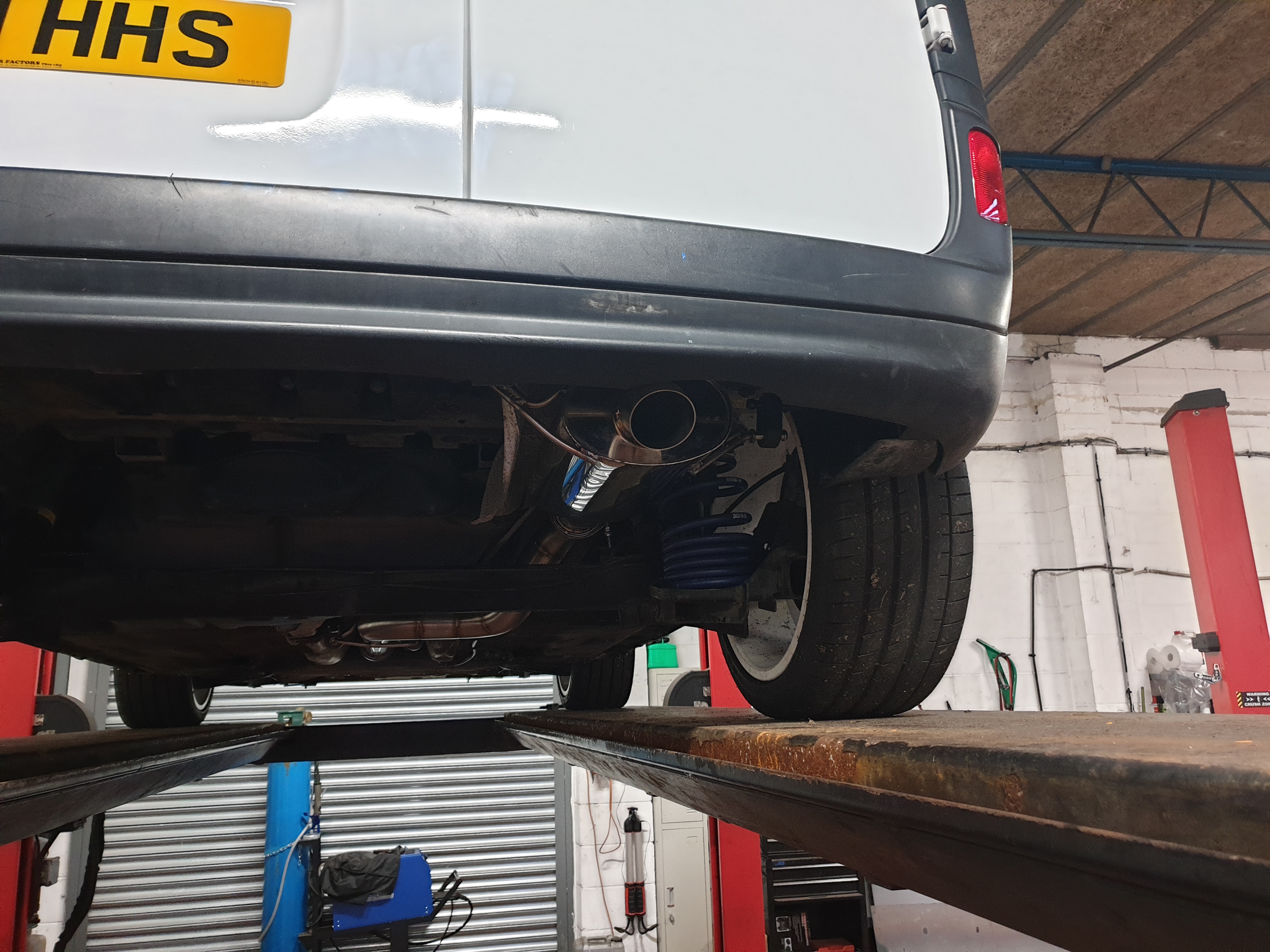

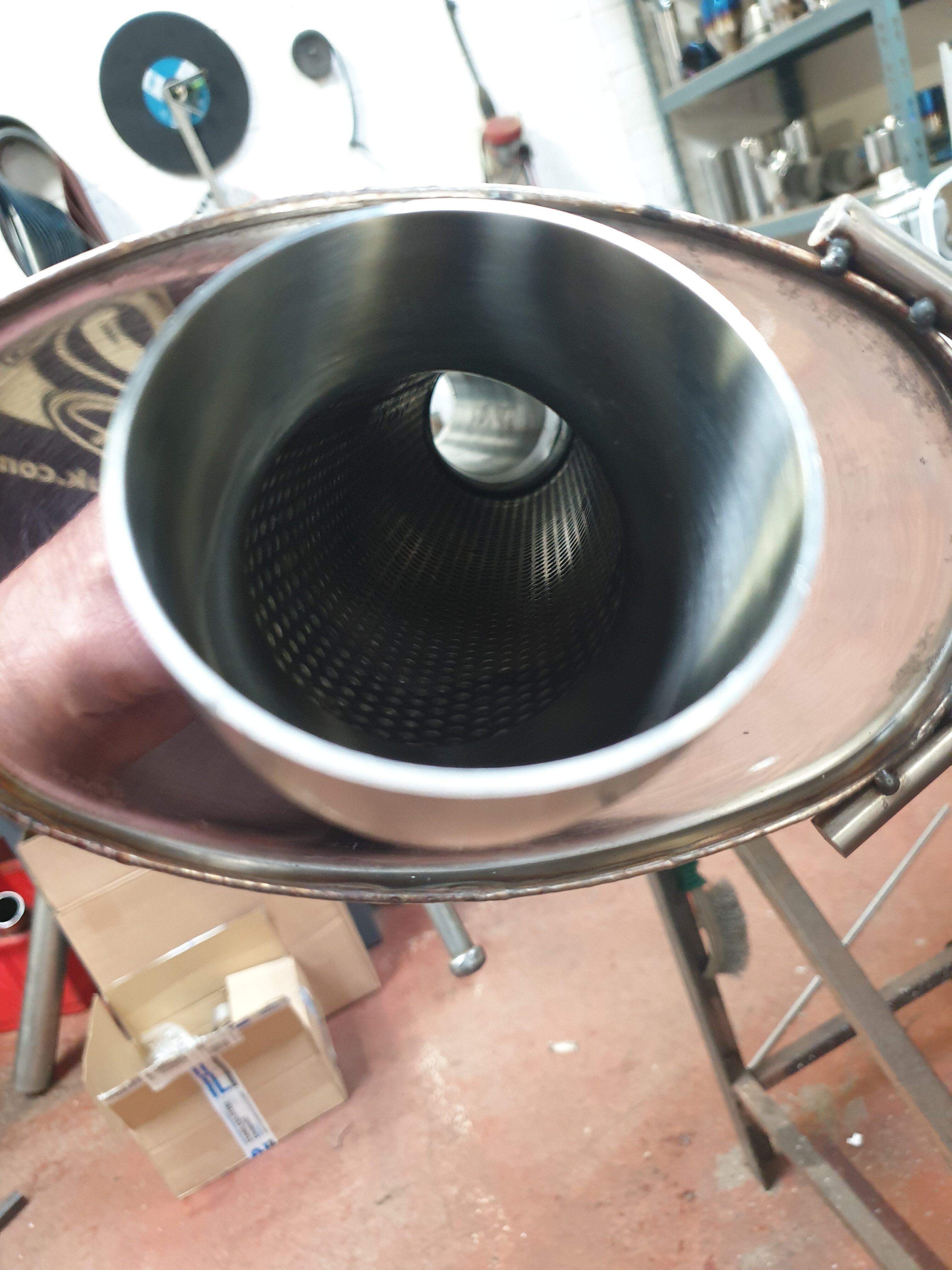

Mocking up backbox. Went for an offset baffle pipe to drop the noise a bit. Most megane systems use a small round straight through baffle piped silencer, which makes them loud as feck/bit washing machine sounding.
No restrictions here

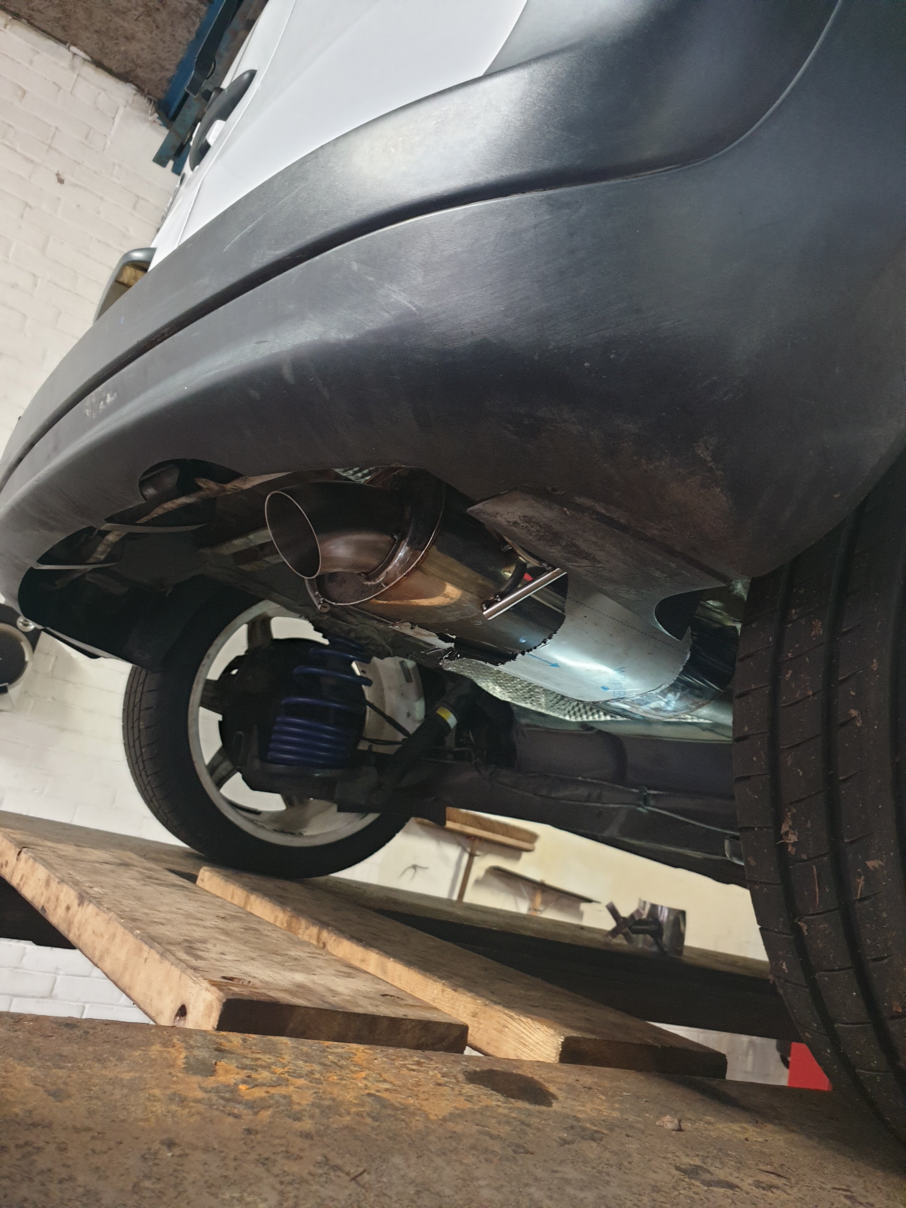

Finished
Nice and discreet
Noise tested it and it should be ok for 90% of track static noise tests, i think it was 98db around 4500rpm.

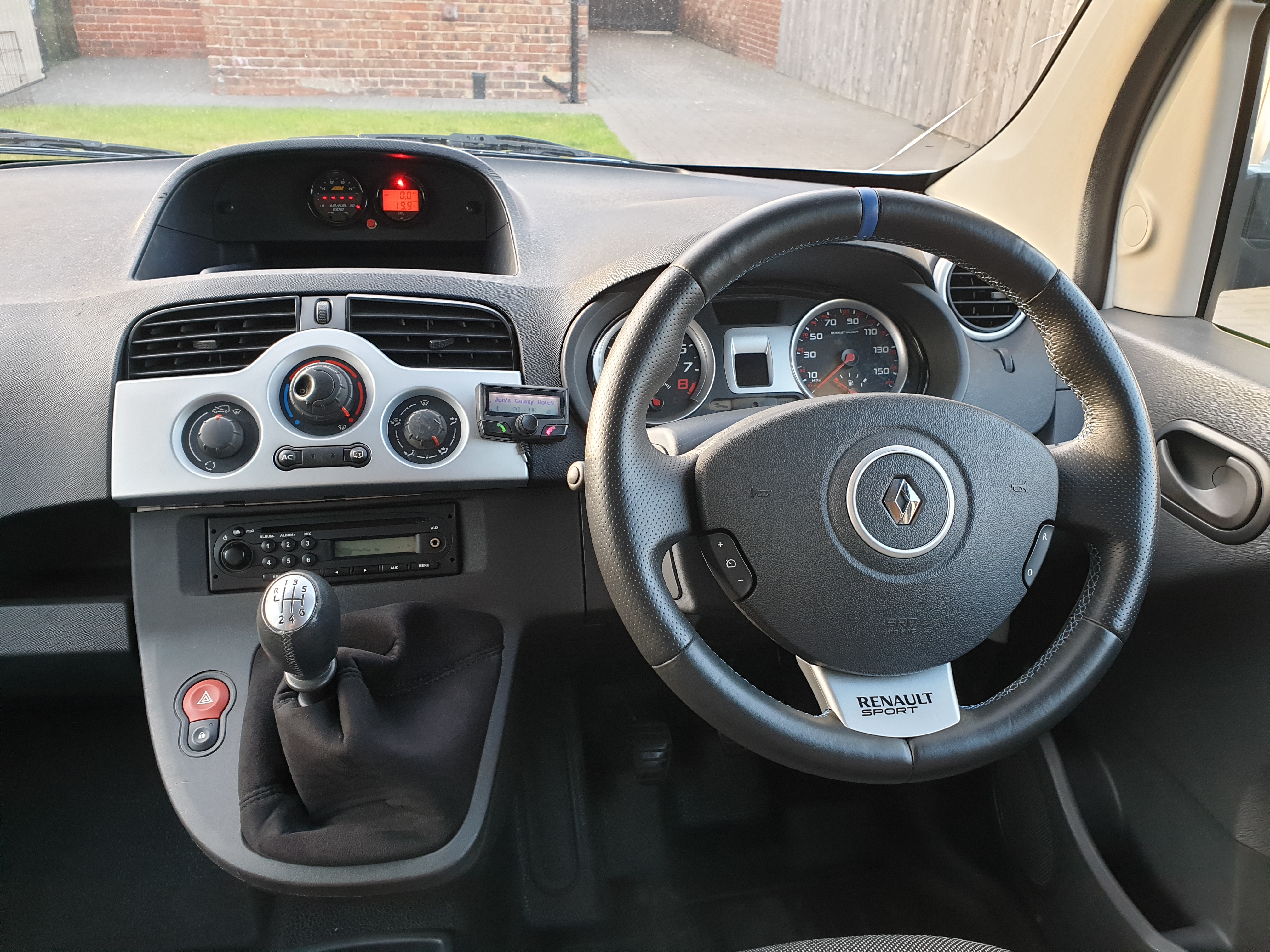

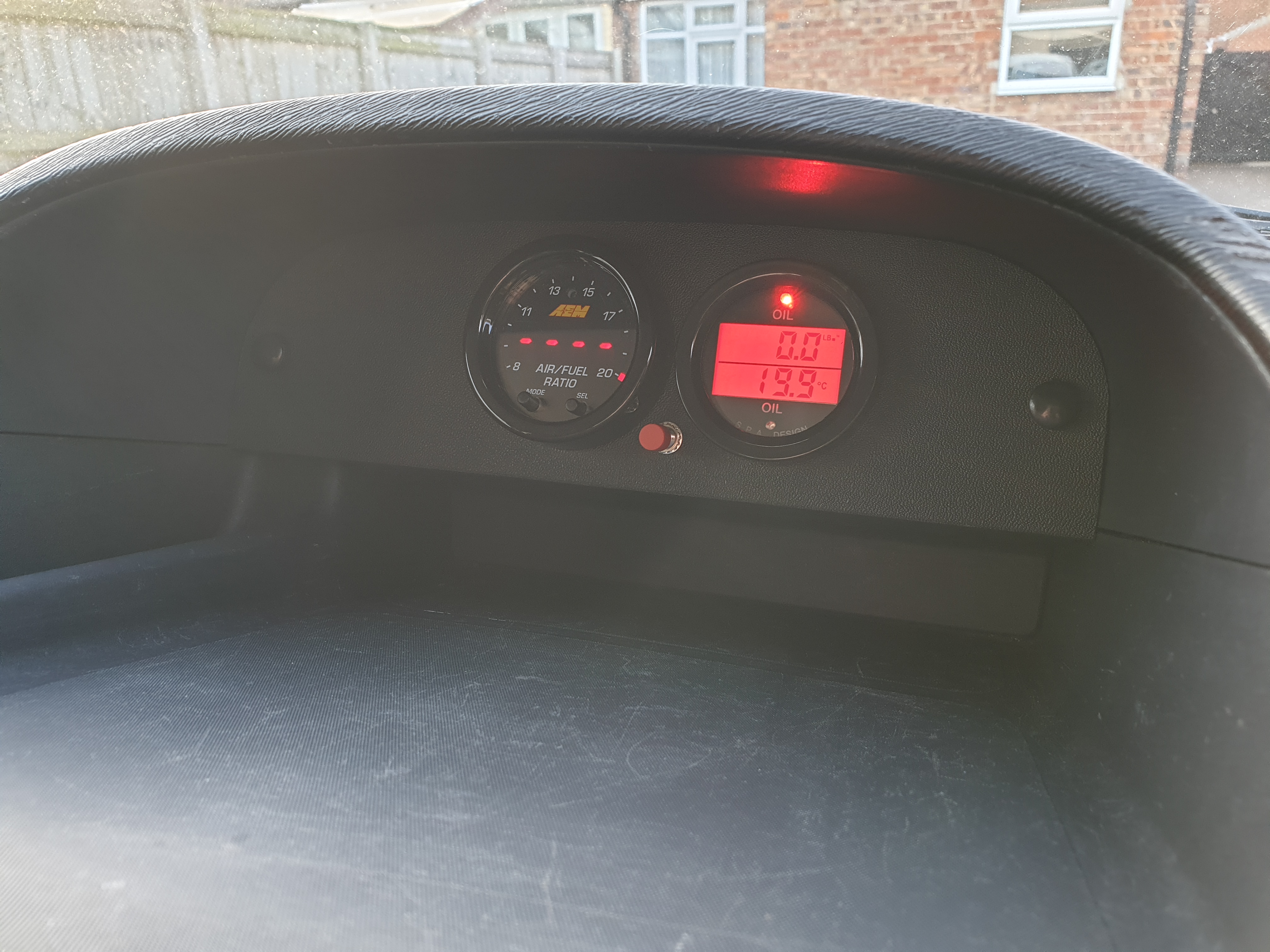

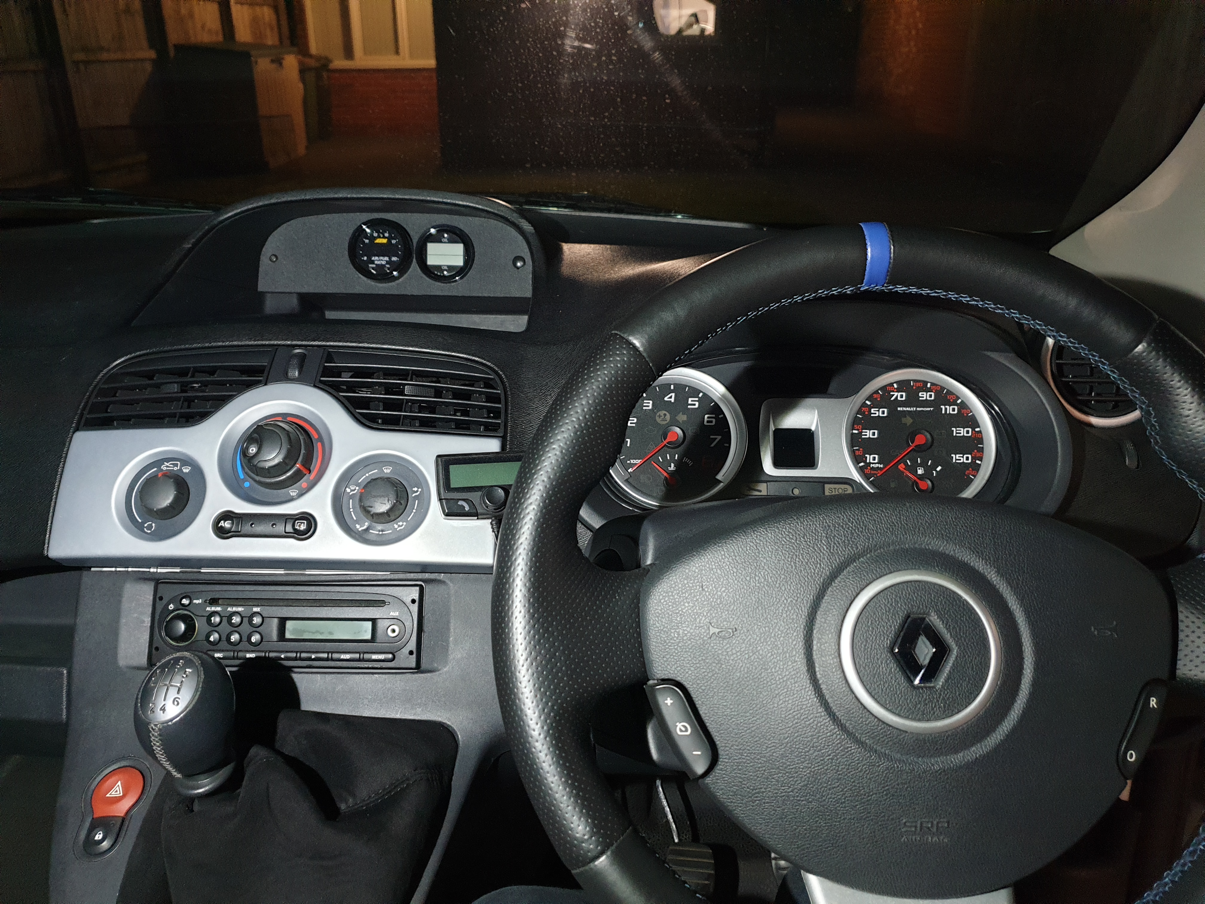

Weeks leave off work, so finally got my Aem afr and Spa dual oil pressure/temp gauge wired in.
Ive been putting this off as ballache to run wiring through to engine bay/up the dash. 8 hours later and done, had dash almost fully stripped to run wiring, as heater box is tight against the dash and almost no room to run wiring to the cubby hole. Front end off to get the sandwich plate plumbed in, and oil and filter changed for millers cfs motorsport 5/40.
Look good though, and work grand. Oil pressure seems good, ran it up to 75deg oil temp so not fully warmed up, its reporting 70lb pressure when revved to around 3k so cant be in too bad shape.

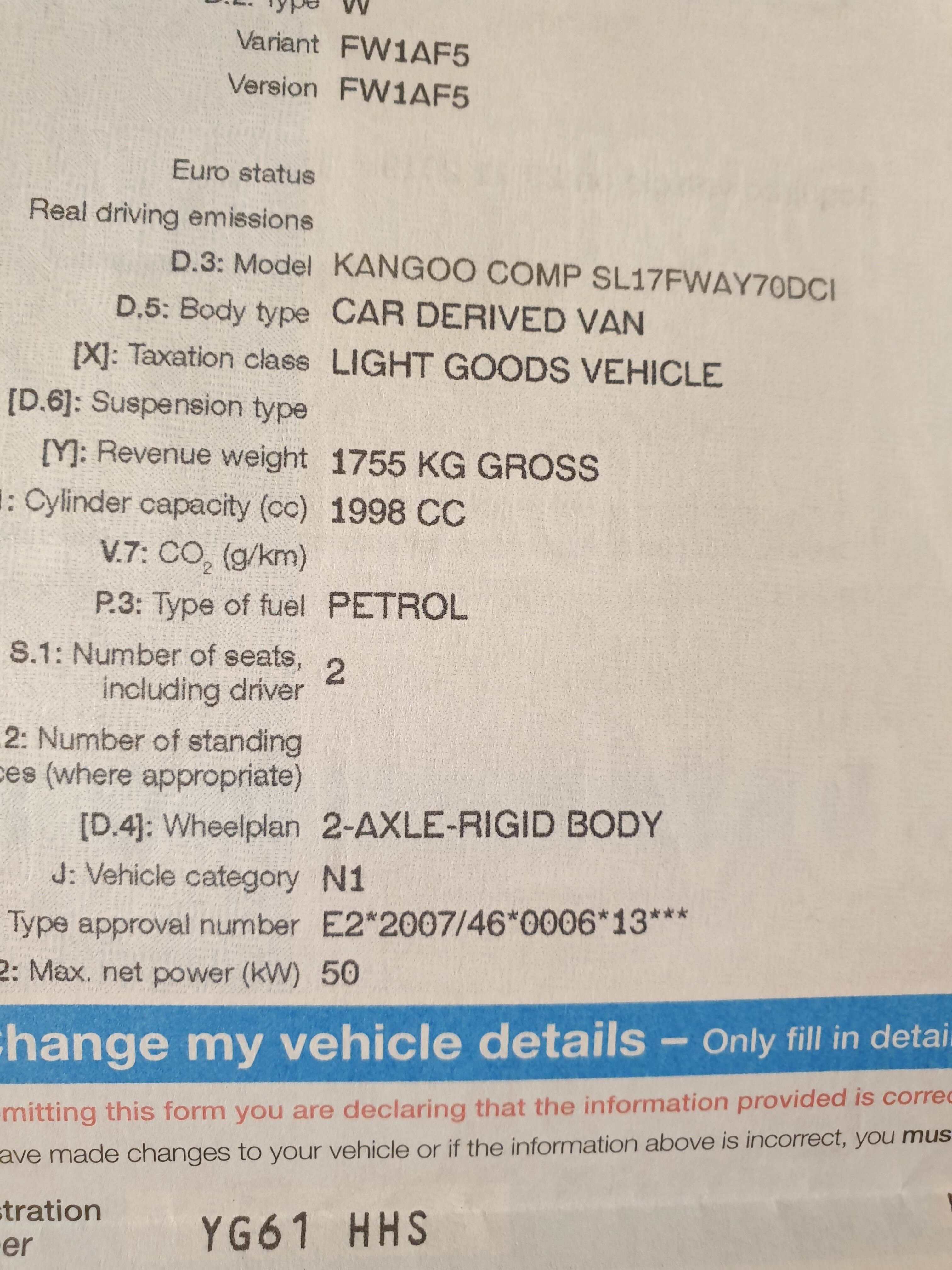

Logbook came back yesterday after a 3 week wait with 1998cc and petrol declared.
This is good news as i need the logbook to tax it, and last engine conversion i done with fuel class change took 3 months with Dvla losing the paperwork.

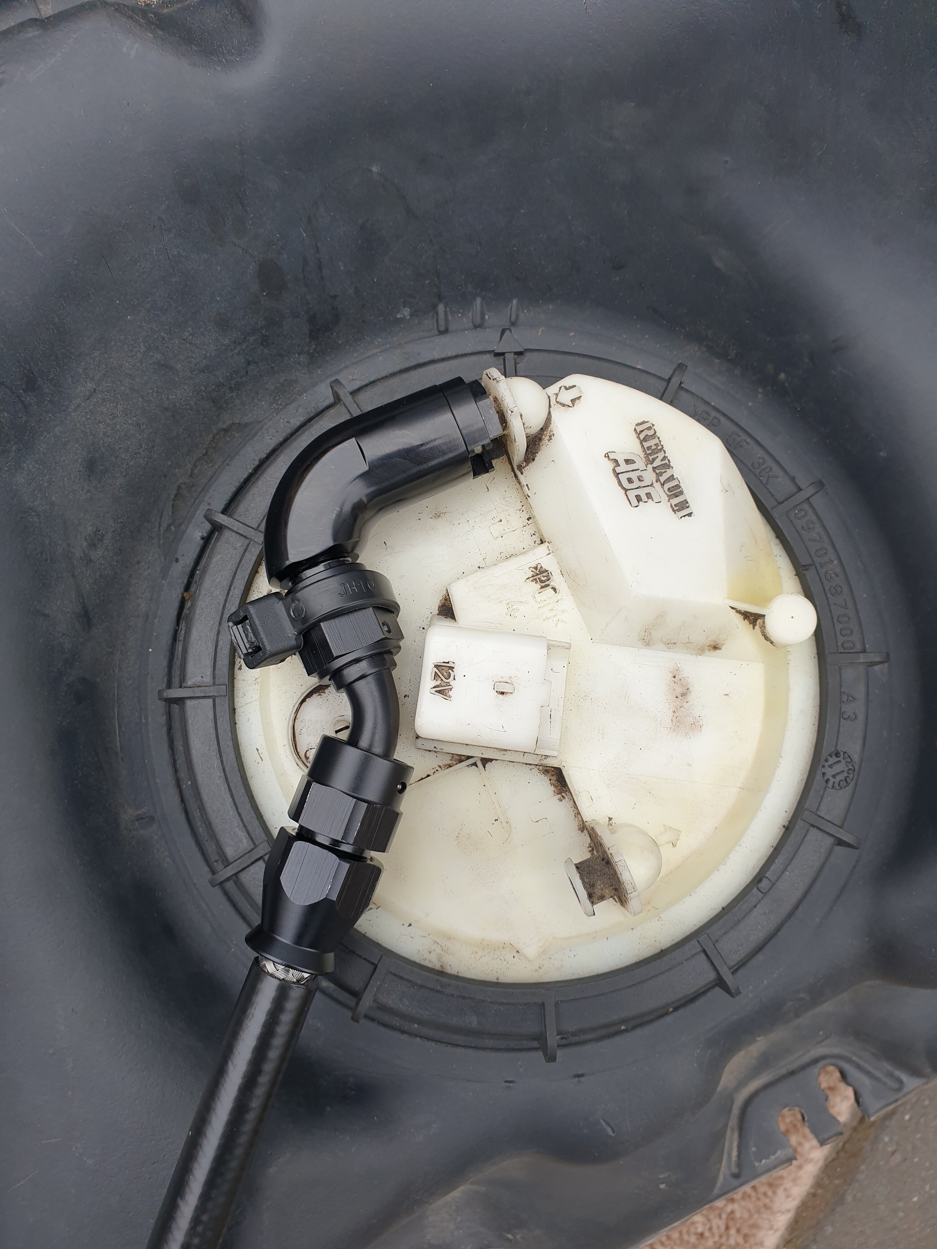

On Good Friday (fuel leak Friday!?) dropped the fuel tank to sort the leaking pipe.
Exhaust off in ten mins, so easy on vbands.

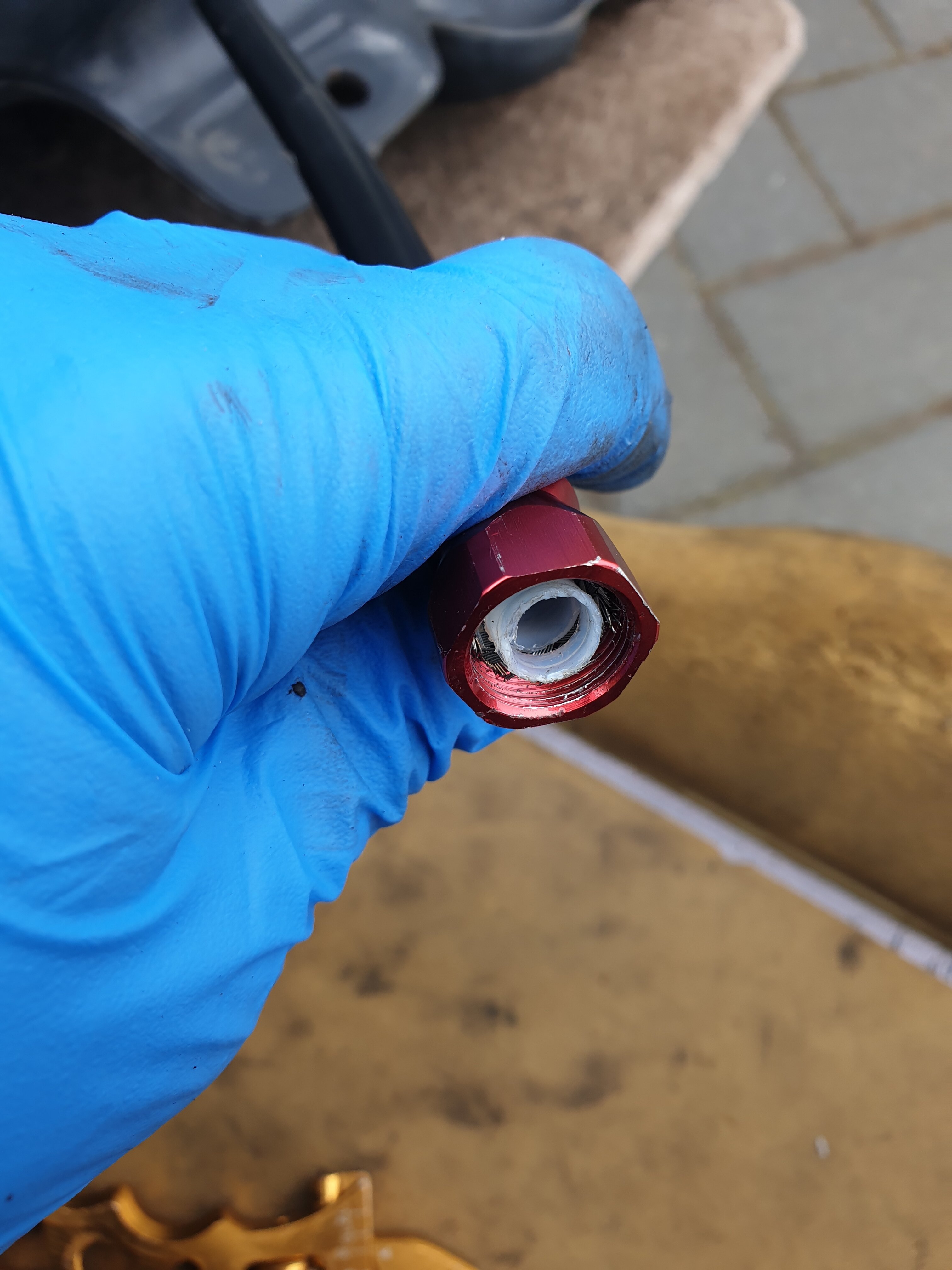

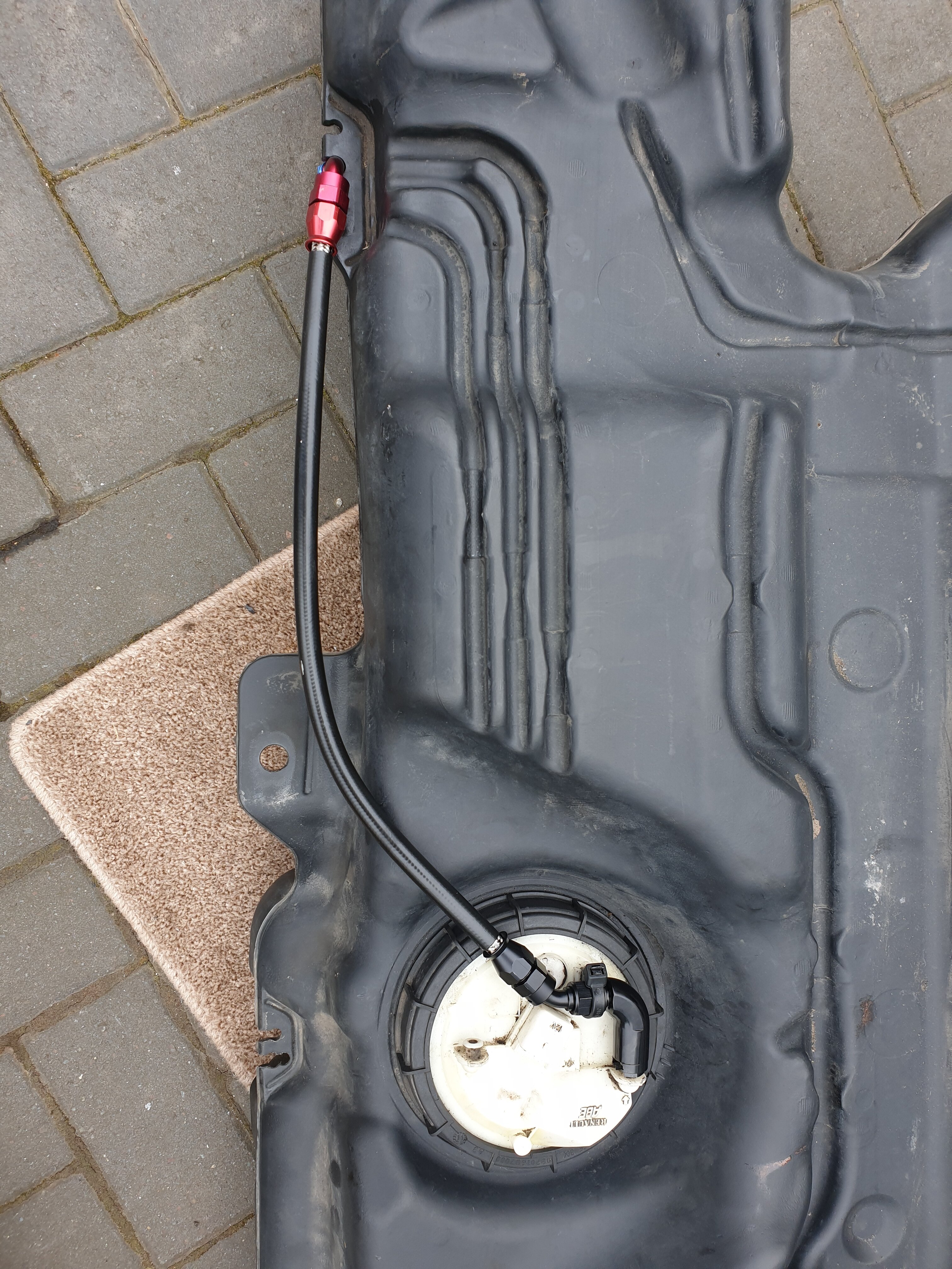

Tank off in 20 mins and could not immediately find a leak. I changed the tank sender fitting to a 90deg one and redone the sender connection, to make for minimum tension.
See the red/blue an fitting? That was an old ptfe fitting i used with a new insert.
Refitted tank/tested with pump on for leaks and the red 90deg fitting was leaking like feck.
Diagnosis, insert was incorrect and cut into the ptfe liner!? Ive made loads of an lines up over last 15 years and not had an issue.
Drop kicked the fitting, cut the hose and fitted a brand new 90deg fitting. Job jobbed, from now on will fit new fittings as not expensive.

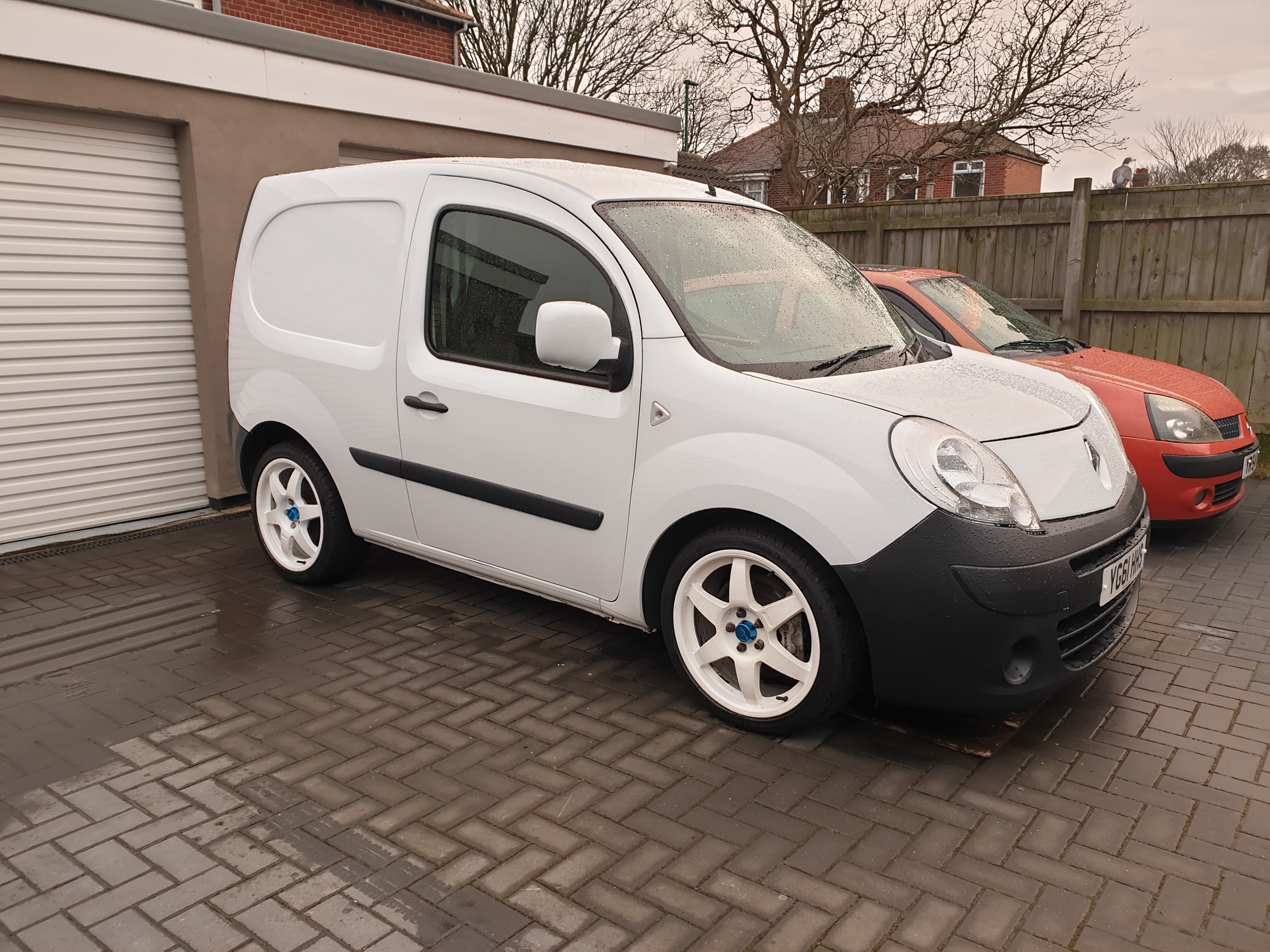

Took it for mot today and straight through its test. Mot tester and the garage staff were amused at the wheelbase :LOL: had all the staff looking at it and a few nice comments of how good the conversion looks.
So with that milestone achieved, taxed it - £275 a year which is great as cheaper than megane.

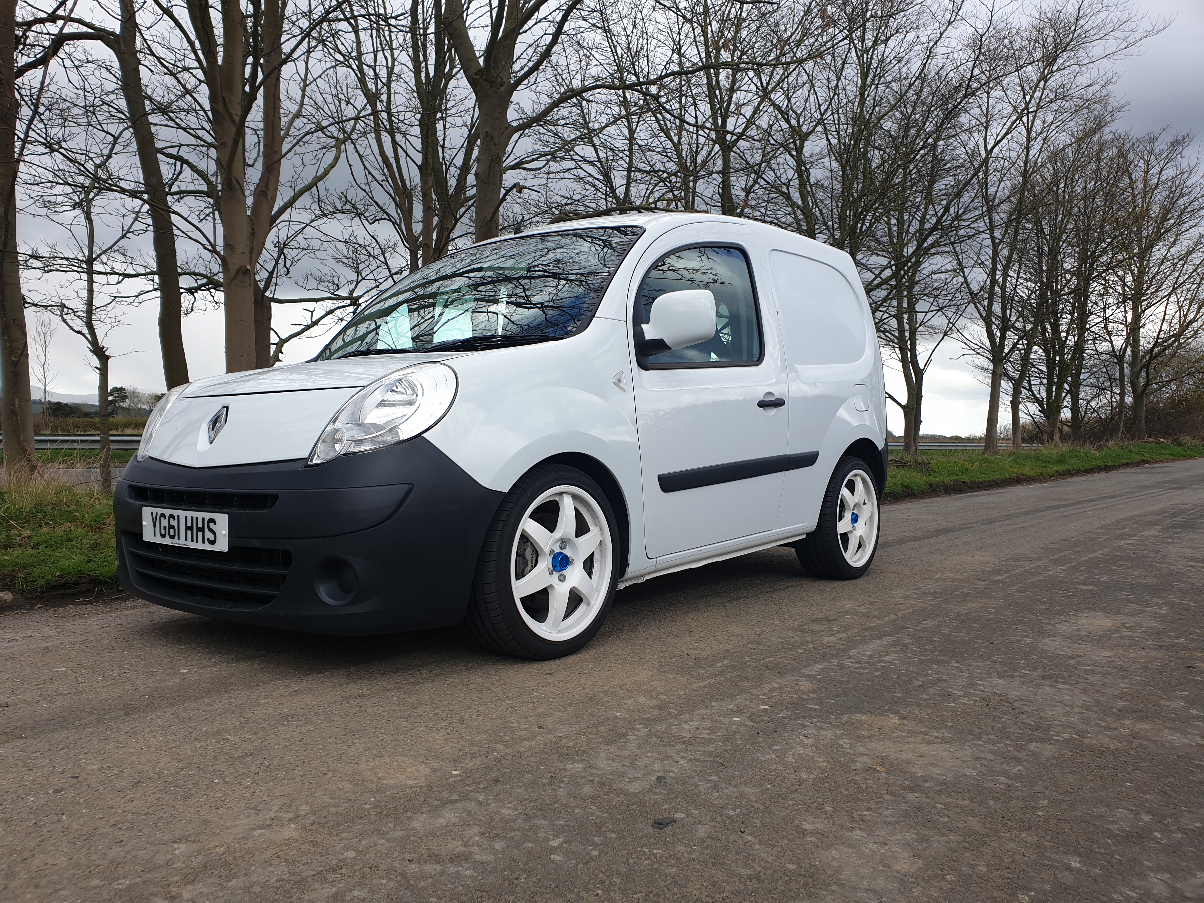

Stuck some more fuel in and took it for a 30 mile shakedown which went well with no issues. Drives great steering is spot on, direct and sharp, suspension feels nice and solid like a good meganesport should, gearchange and brakes are good, interior suprisingly rattle free. Could daily drive this in comfort no worries.
With the afr gauge hooked up and had torque monitoring the boost on the obd, give it a tickle in 4th to check it all works and no vibrations etc.
Makes 20psi peak boost and theres plenty of fuel in the current map (mid 11 afr on boost), its all systems go when its on boost and feels rapid. Had to roll off the throttle as no knock detection on and not pushing my luck too much, but once mapped it should go well, really well for what it is.
Give it a check over and cant see any hoses rubbing or nothing untoward, stuff that causes unreliability. No coolant or oil leaks touch wood which is nice.
Shakedown pics

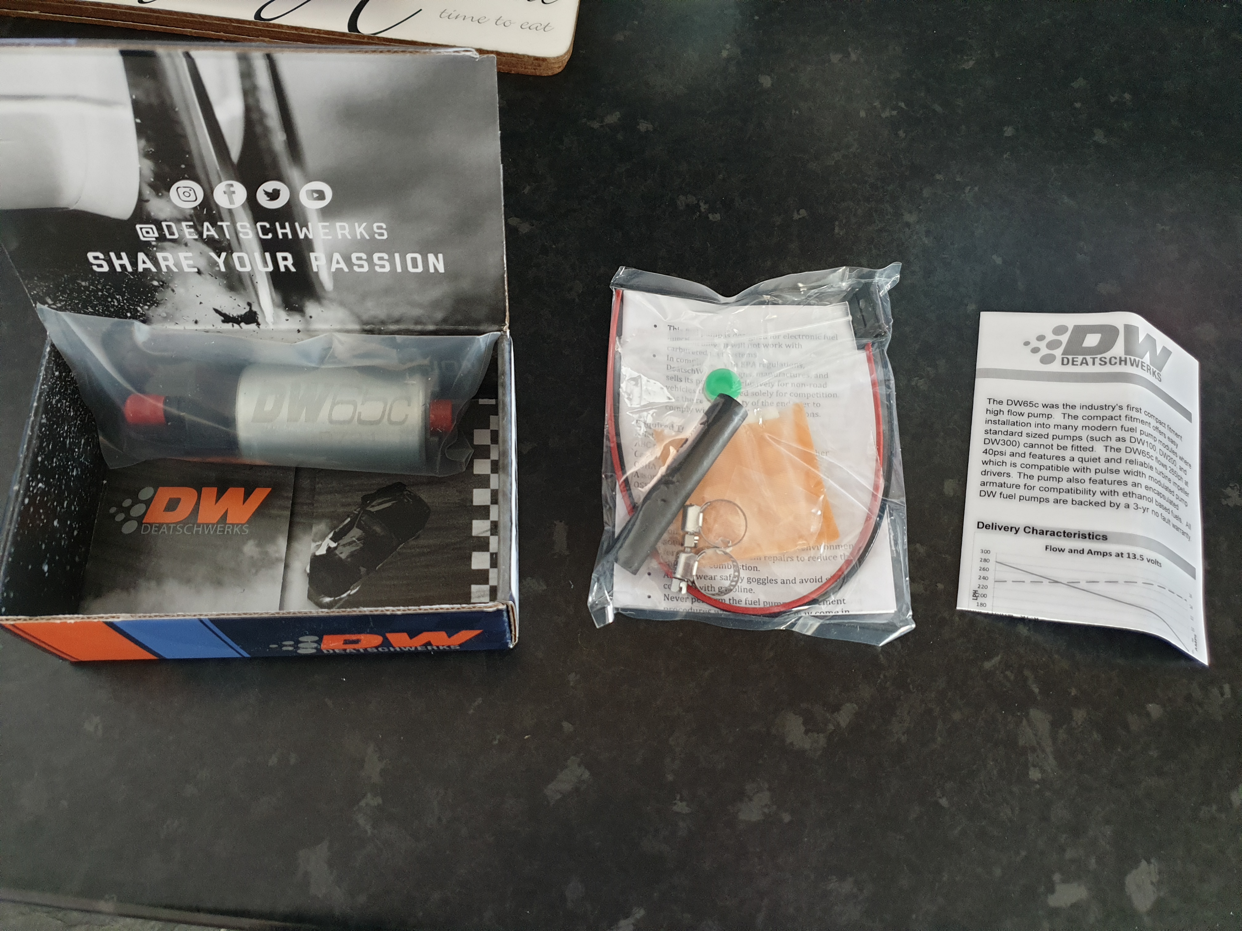

In other news i ordered a deatschworks dw65c fuel pump to go with the 5 bar intank reg i have to fit. Arrived promptly, will build up another sender to fit.
