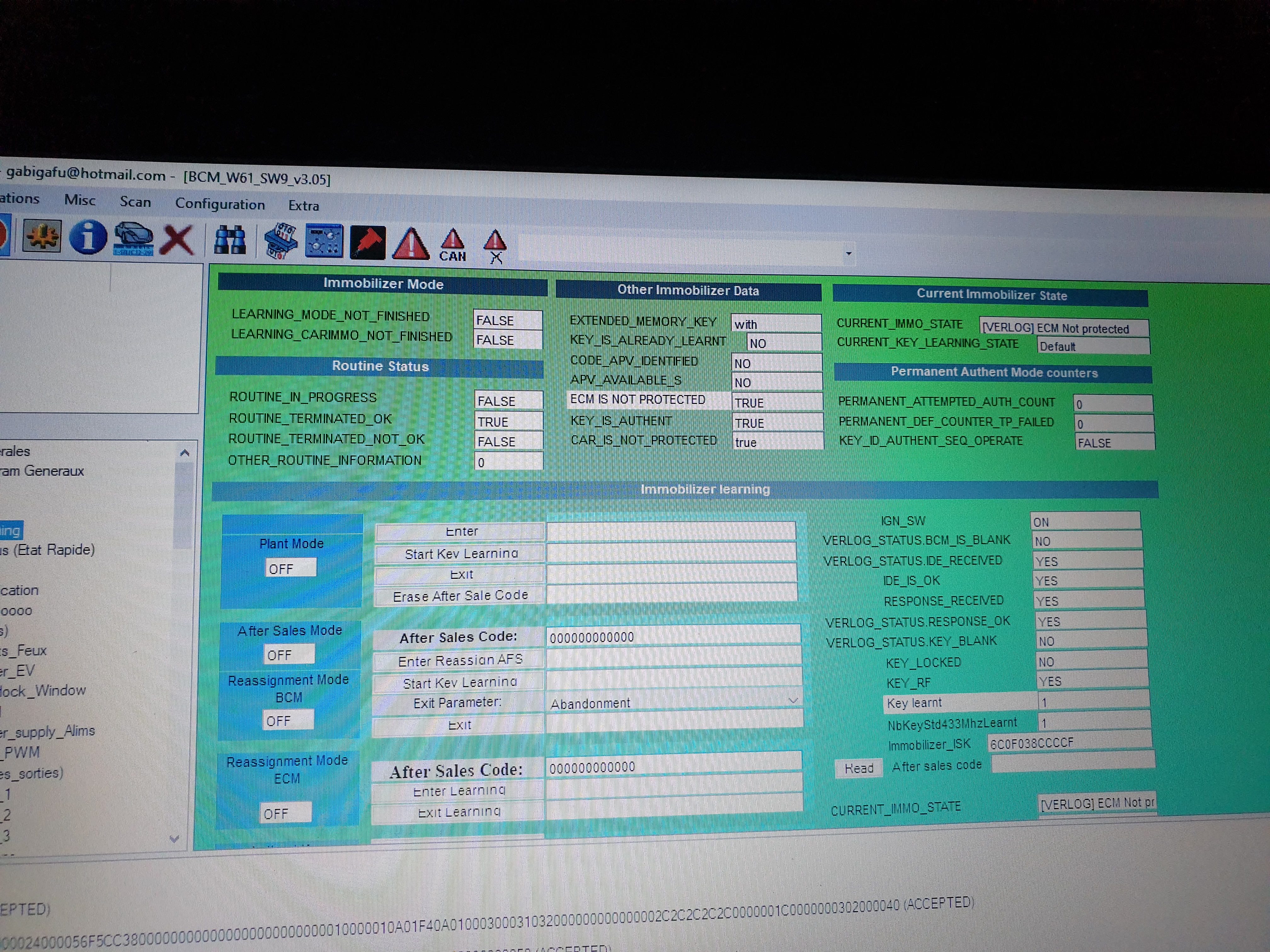

Went with Ren0link, as its a little easier to use and bought the latest copy with a licence. For the people who have not heard of Ren0link, its a great alternative to clip. Its a 3rd party software and powerful, press the wrong button and your in the s**t basically, there is hardly any info or instructions for anything apart from key programming. Press a button and theres no warning, or do you really want to do this, it just fires the command, and if not careful you have wiped or bricked one of the modules and its a trip to Renault resulting in £££.
I went with this as it has a tool to find the isk and pin in the uch to program keys, and other easy to use tools, i.e. virgin uch and ecu on obd, vin change to attempt to marry my 197 cluster and sagem s3000 up to the Kangoo uch.
Tried a few methods to pair up the immobiliser using Ren0link to virgin uch & ecu, tried to pair up no joy. Pretty frustrating at times i admit.
Anyway stuck with it and bench read/wrote the eeprom and modified the file a few times and finally cracked it. Used a good modified virgin immob file for ecu, which would usually auto sync but did not on this case. I used reassignment mode bcm which then paired up the ecu.
Engine cranks over and ecu unlocked / can delete dtc's from the ecu so assume once it has a fuel pump fitted should fire up🤞
Some screenshots of Ren0link in action

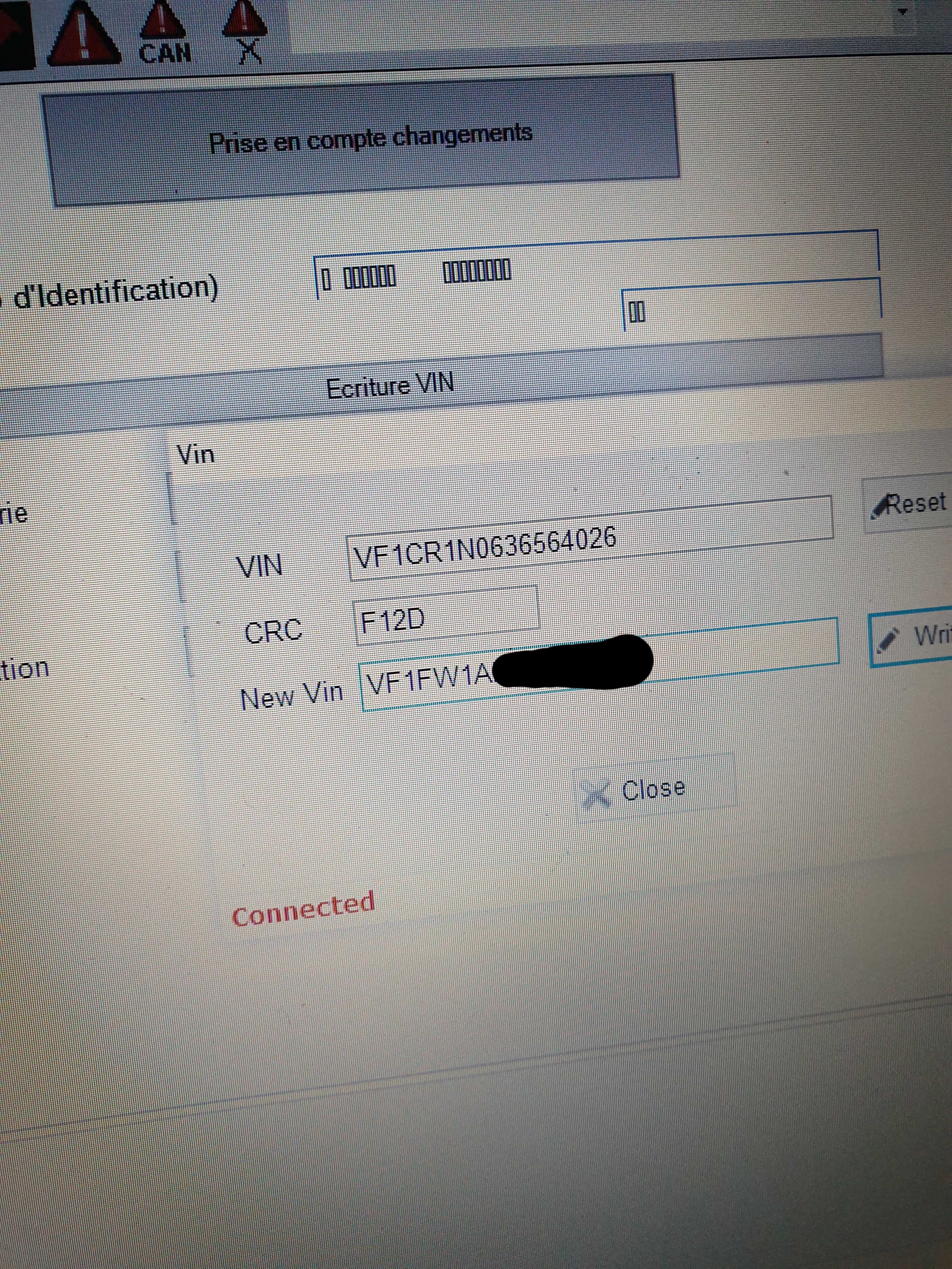

Changing vin on tbc (cluster)

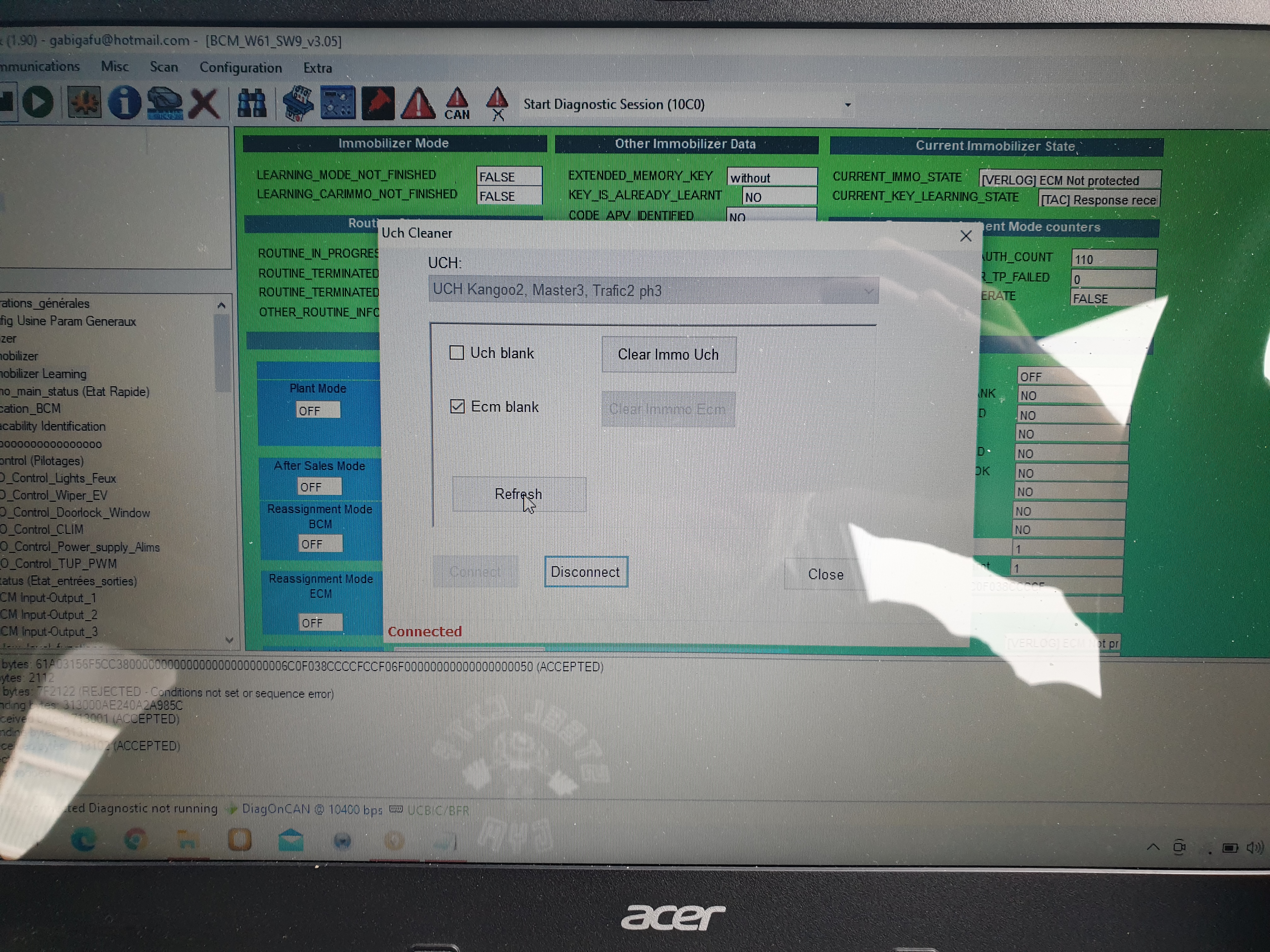

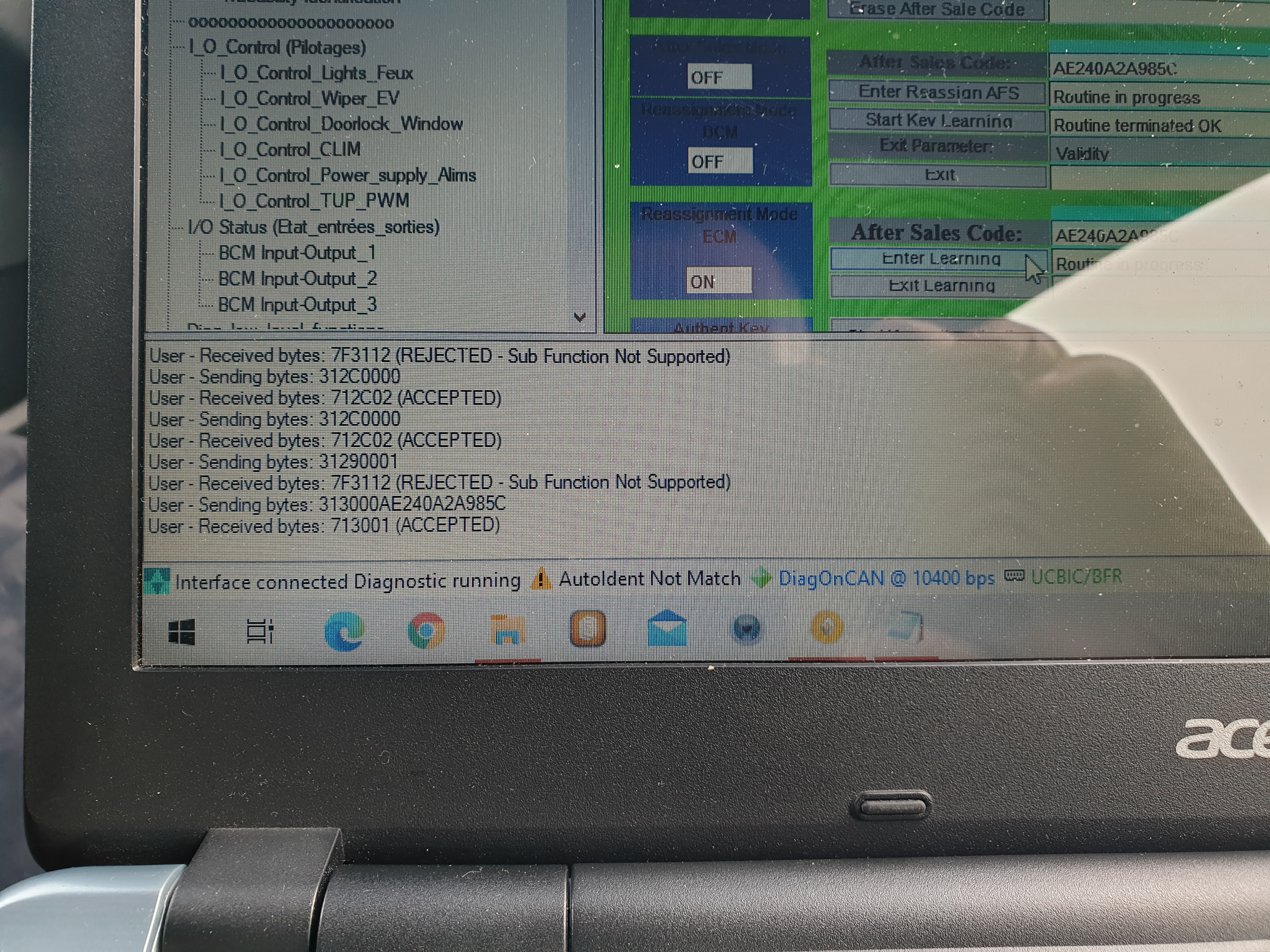

Commands in progress, reassigning ecm. Note some commands rejected, as there is a sequence required and some commands can only be done on virgin uch/ecm.
Uch cleaner to virgin immobiliser. Need to get your isk and pin stored before this as it wipes the keys off, and without the isk/pin you will need a trip to renault.
Hit clear and your immob and key data is gone.
Imobiliser paired up. Note "ecm not protected" = true. If it says false your ecu is locked by immobiliser.

Reason for it taking an age to detect is the baud rate ( transfer rate ) looks really slow - 10400bps. Typically the interfaces I use on my exige are 11500bps. I dont know if there is scope to change that on yours?
@andybond i did change it to 11500bps but the software comes up/changes to 10400bps, might be the chinese cable tbh. Theres the odd drop in comms so just let it scan slowly, had a charger hooked up to the batt whilst it was on with it 😆

It might default to 10400bps for slow and steady comms TBH. I guess you dont want any errors while flashing!
