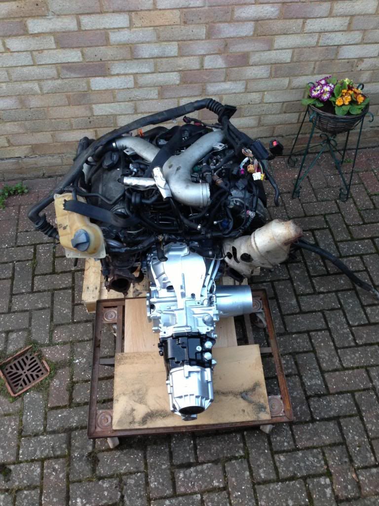

LSD found! After talking to a gearbox specialist in the States, it turns out the Porsche 968 uses the same 6 speed 'box as my audi lump. Apparently it was fitted with an LSD as an optional extra which fits my 01E without any modifications. Great I thought....until I tried finding one for sale!! Luckily a local chap has offered me an entire gearbox but is reluctant to split it for the rare diff. Hopefully, after abit of badgering this week, I'll have a perfectly suited lsd for a road car in my hands! Fingers crossed!
Well here they are, the first pics of the year! There should be a long line of them to come over the next few months. The car is due in to be worked on in a couple of weeks time so its hands on deck now the weather is getting better!
This is the box as I bought it a few months back. Following a good going over, it was time to clean it up good and proper. It was probably clean enough to stick straight in to most, well used engine bays but I have the option of having it on show should I want to cut the centre bar out of the bumper again. Not only that but I'm sure a few people may try and take a good butcher under the car to see how I've mounted the engine and 'box in the way I am. Anyway, after a bit of elbow grease, its now ready to face the music and 600hp should I wish to throw that much at it.
Next job, ENGINE!.......
Top job there fella, that looks sweet :approve:
