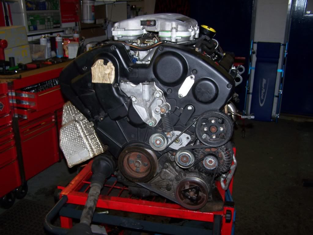

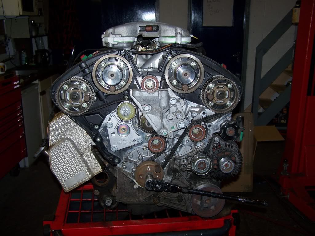

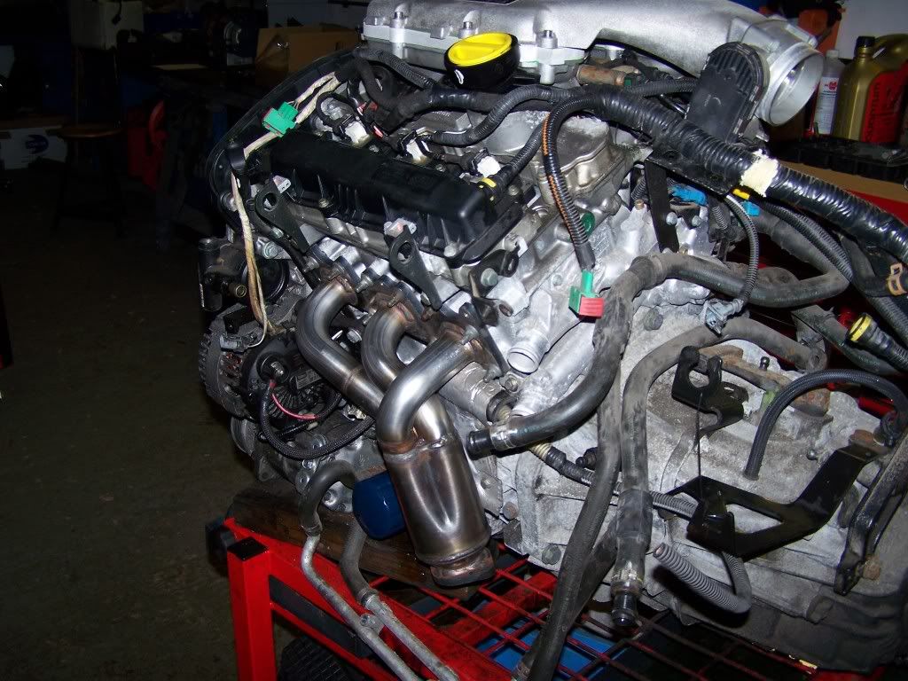

Ph2 engine is fully assembled and only the modified ph1 loom has to be connected before he can swap it in with the gearbox.
Will be popping down to Scott's at some point before Christmas so I'll take a load of photos, as they've been few and far between of late!

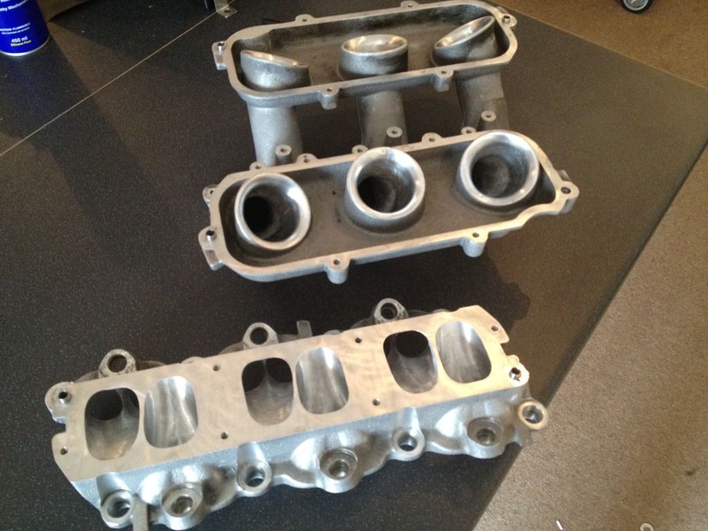

Shiny, shiny
New clutch with lightweight flywheel

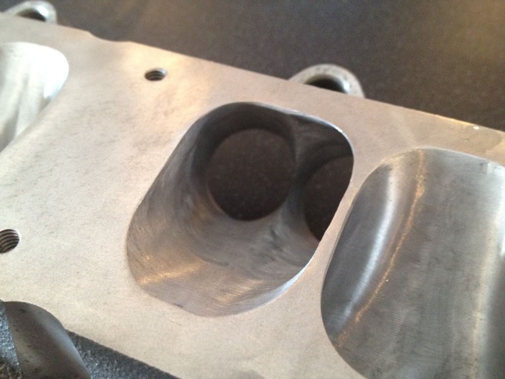

Plenum spacer and full manifold back exhaust
Ph2 engine ready to fill big hole!

What sized Plenum Spacer did you go for?
Cheers guys, real labour of love, but we're clawing our way to the finish line now!
It's 16mm. 10mm saw good gains at the top end of the rev range on Tim and Ray's cars so 6mm extra should be plenty. In conjunction with the plenum polish, airflow into the engine should be vastly improved over standard.

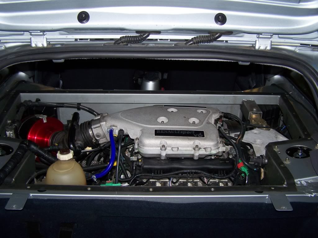

Now we're cooking on gas. Vee needs a shake down and an MOT and we're there. :) :)
Must say I hadn't really missed the car that much (RS4's fault) but after seeing Paul O's Ph1 sat there menacingly in the early morning gloom, lit up only by the overhead lights of a petrol station, the juices started well and truly flowing again! As an aside I don't know what it is about petrol station lights but, strangely, they have a unique way of making cars look fantastic. Anyhow enough rambling; pics.

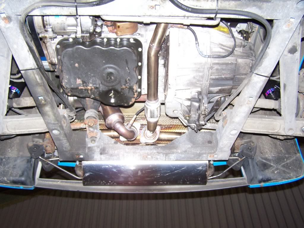

Certainly looks more appealing than a ph1 engine.
Going to be a wee bit loud I think!!

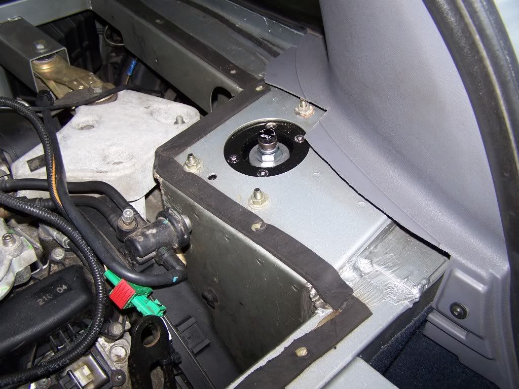

Fully adjustable BC Racing coilovers.
