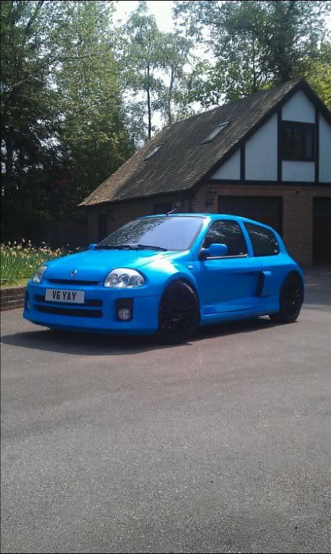

The car now looked like this at the front:

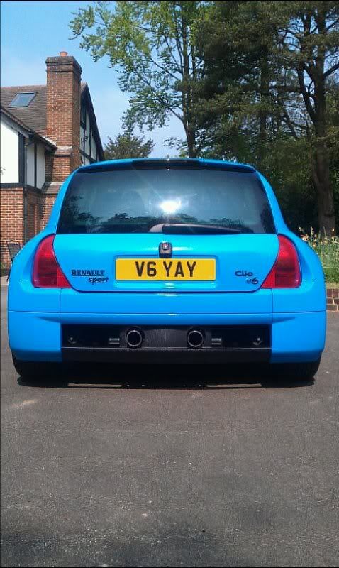

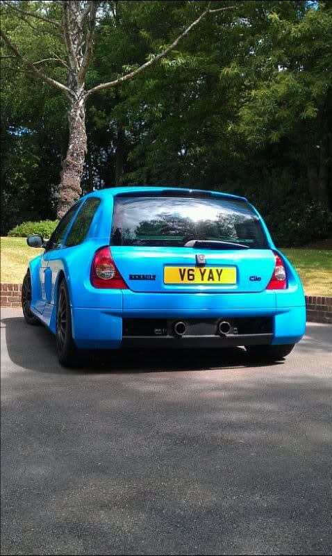

And this at the back

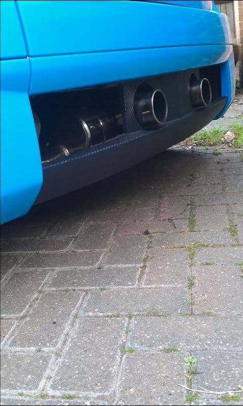

Closer shot of the carbon effect wrapped 'splitter'

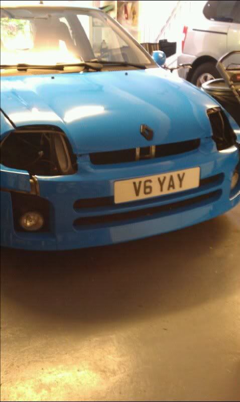

First up were the headlights. Having read the how-to guide to removing a ph1 bumper I set about doing it. It took a long time but then again I was going purposely slow to make sure it was done right (think twice, cut once and all that). In the end it was really rather straight forward and I didn’t even have to fully remove the bumper to get the headlights out
Lights out:

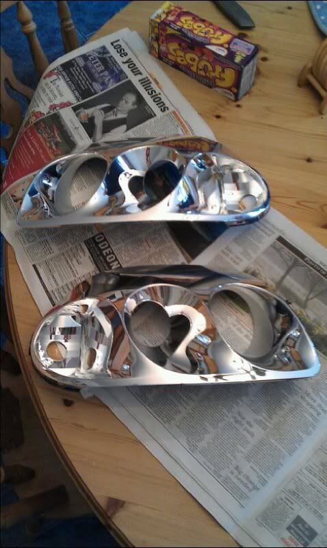

I then disassembled the lights in the oven [smilie=icon_eek.gif] 150 degrees for 8-10 secs at a time until the adhesive had softened enough to peel the lights apart.
Nasty silver bits ready for sanding:
Once sanded/primered and painted I left them for a couple of days to thoroughly dry and then reassembled the lights (exact reverse of disassembly) and fitted the lights back in.

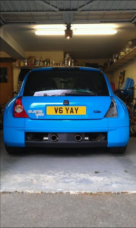

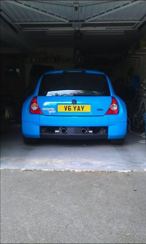

Headlights now sorted it was time for the rear lights (sourced brand new for £28 delivered!!) . Now having taken the best part of a day to get at the headlights I was prepped for a struggle with the tail lights. This (initially) turned out to be the easiest job I’d yet had to do. I started on the left tail light and, again following the how-to guide, loosened the wing nut, removed the tail light changed the wires round to ph2 fitting and then replaced and secured the light: 5 mins in and I’m already half finished!!
So far so easy. Then I moved onto the right hand tail light....
Followed exactly the same process but was met with no ‘plug’ and a bunch of wires soldered onto connectors :s I phoned Renault for a quote for the connector and they priced it at £150!! (connector comes as part of the loom). I couldn’t be bothered with the hassle/time of contacting scrappies so I just decided to use my GCSE soldering skills and solder off the old wires and solder them back on in the correct ph2 configuration.
Left tail light – 5 mins
Right tail light 4 hours :evil:

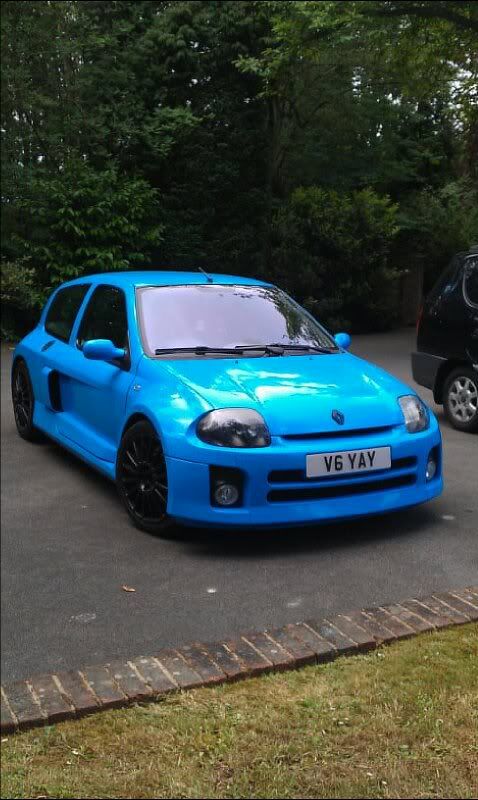

My favourite angle of the car:
