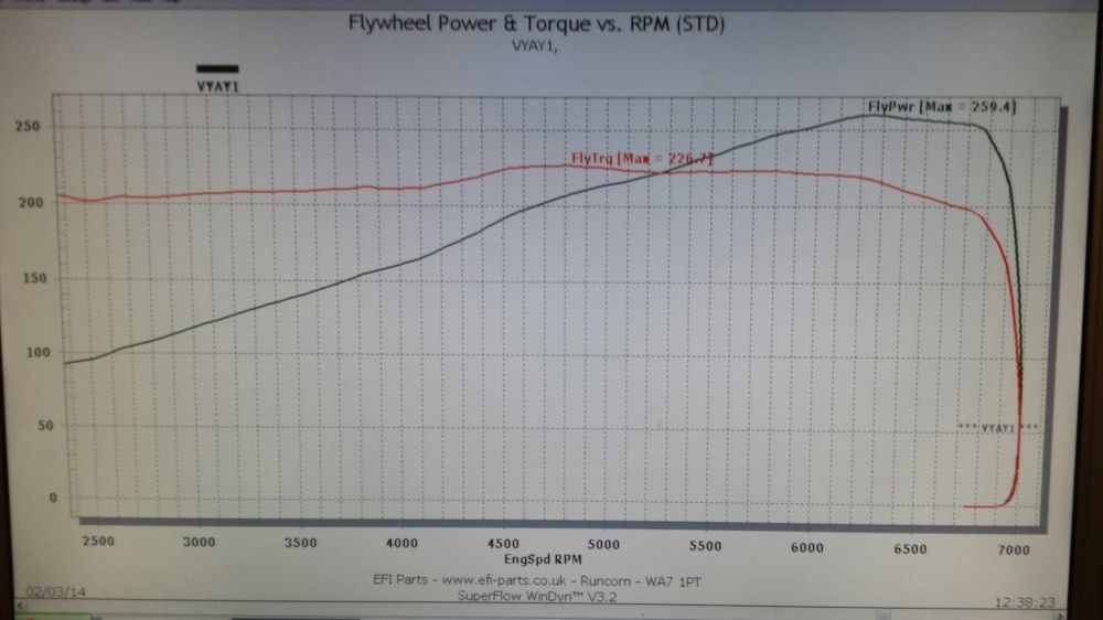

Looking good Jon. If you engine was completely healthy then even 245 would have been optimistic so to get 259 after is a fantastic result I think.
How does the torque look like?
Very true, Dulan. I think the 'before' graph was something ridiculous like 178bhp or something [smilie=icon_eek.gif] [smilie=icon_eek.gif]
I take it you mean the torque curve? I don't know yet as I haven't seen the graphs, will let you know when I get them. :approve:

All this talk about TORQUE, can we see the graphs, anyone?
And please, no pixelated scans, nice big juicy pictues/graphs!

All this talk about TORQUE, can we see the graphs, anyone? And please, no pixelated scans, nice big juicy pictues/graphs!
Patience my good man. Not even picked the car up yet.
From what little I know about graphs I think it looks pretty good :)
Not sure what the standad car's graph looks like, but going to have to be careful lower down the rev range with the gearbox as the torque seems to be pretty much instant and continuous.
Pretty normal as its NA engine so torque is virtually constant the whole way thru the rev range and remember graph starts at 2500rpm. Mine was absolutely straight when tested it Surrey Rolling Road hence why whichever gear you pull in the vee whilst accelerating you get the same thrust each time. Nothing to worry about mate.
Ah yes, good spot. Hadn't seen that it started at 2500rpm!!! :rollseyes: :)

That's a nice increase in torque you have there Jon, at least from 2500 rpm. As its lighter than standard your Vee must surely be pretty quick when compared to a standard one.

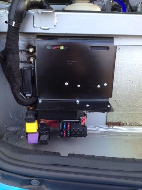

After a weather delayed but uneventful train trip I managed to get up t’north to collect the car from Chris yesterday. He had a bit of a slow morning, so I ended up spending nearly an hour or so over a coffee bringing him up to speed on all things Vee. We also had quite a detailed conversation about gearboxes, as he’s developed an Renault adaptor kit for one of the Audi 6 speed box that’s proving rather popular with the 172/182 guys. Obviously useless for my purposes, but a useful contact to have none-the-less as I’m sure I’ve not heard the last of gearbox troubles...
Anyhow, he walked me round the car and showed me what he’s changed and the effect it’s had. To be honest, as you can see from the photo, it all looks rather neat and other than a few screws you wouldn’t know anything’s changed. Turned out to be a good job I left the tool kit bracket in there after all!

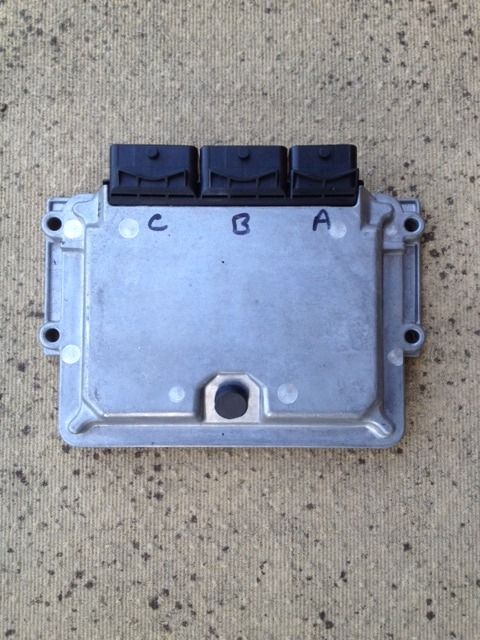

Out with the old:
In with the new:

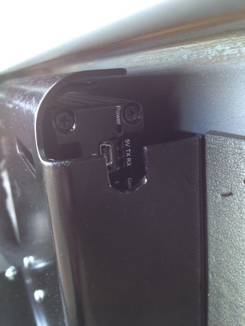

The ECU is a simple plug and play now, so once the tuning software is downloaded from t’interweb it’s just a matter of bunging the USB cable in to the laptop and then voila I can adjust pretty much whatever parameter I want. To be honest I’m only going to do more harm than good if I start changing things, but I can always run data logs and email them to Chris for his critique and tweaks if required.
Having picked up a lot of tuning mumbo jumbo from the MPS crowd, I was aware that everything and anything can be tweaked using the software, but what I didn’t realise was I can now do random stuff as well, like adjust what temperature I choose the fans to come on or play with the VVT. It really is a complete shift from “impossible to crack” to “change anything the hell you want”!
