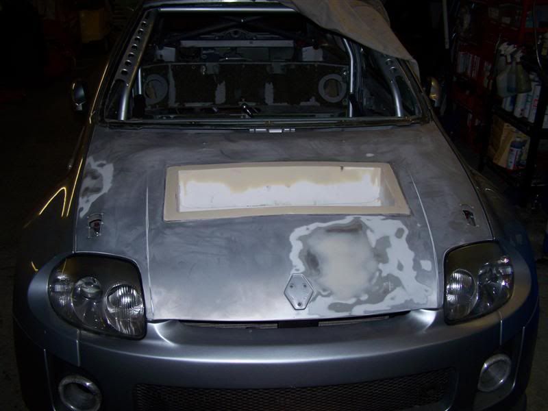

Just had lots of painting done, panels, airbox, window pods, bonnet and the chassis where we had been chopping things about.
Lots of little brackets have been anodised or powder coated and the car is now being rebuilt for the final time.

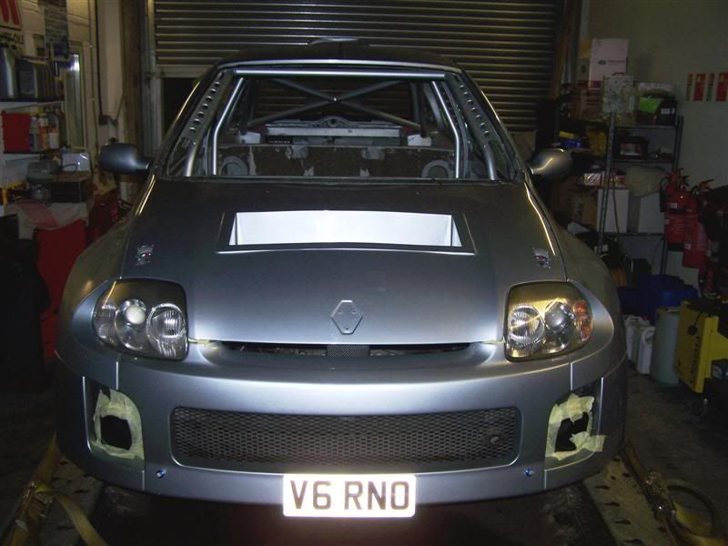

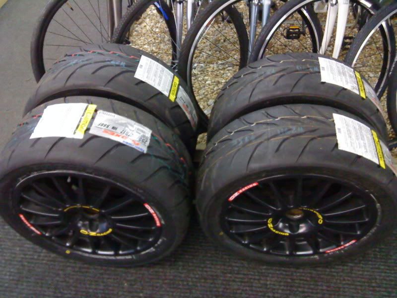

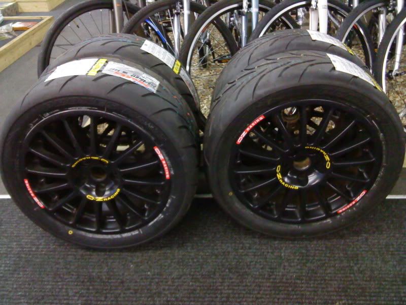

Got 2 sets of these.....standard 17" in black with 255/40/17 rear and 225/45/17 front, Proxes R888 on both.

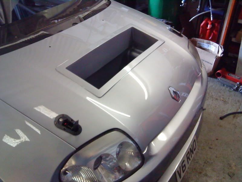

Bonnet looks great and paintwork is all refreshed. Makes a big difference to the cooling as seen on Mark's rally car.

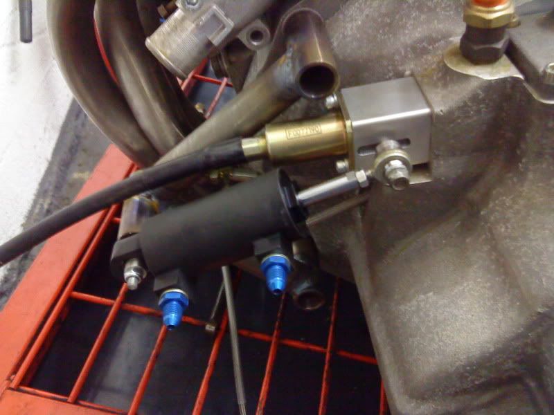

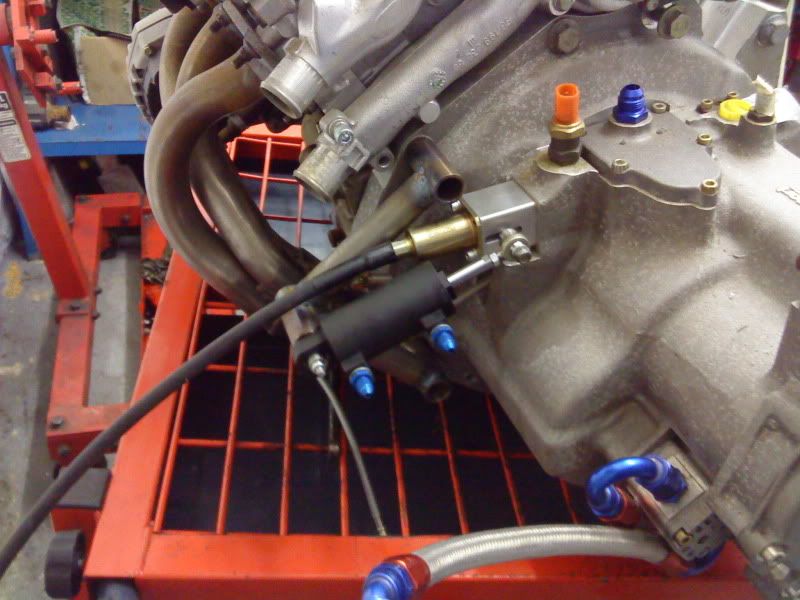

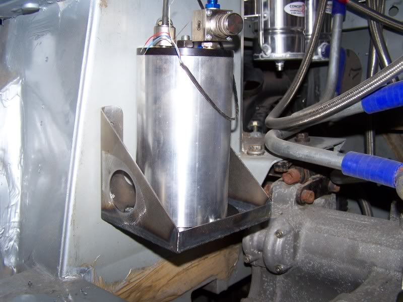

Geartronics paddleshift is really nice kit. Had to adapt a bracket for the ram which mounts on the gearbox but the standard stick shift will also work depending on mode selected.
The accumulator sits nice and close to the ram so that keeps the lines short. Brackets will all be painted of course.

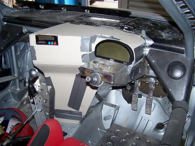

Inside, you can see the development of the centre console. This is now all made up in carbon and the steering column is painted black.

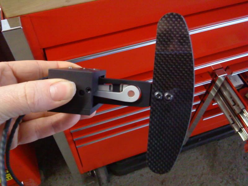

Will probably add one of these as the airbox will obscure most of the rear view.
