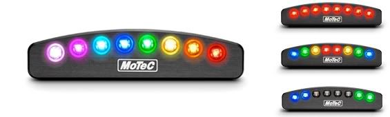

Steve from GWR Motorsport is creating the wiring loom now and we're switching from the AIM Strada dash to a MoTeC SDL with MoTec Shift Light Module and Advanced Central Logger and 2 PDM 15 Power Distribution Modules (electronic fuse boxes)

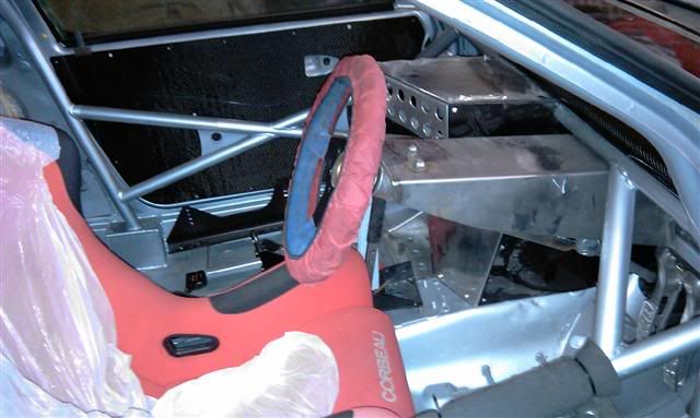

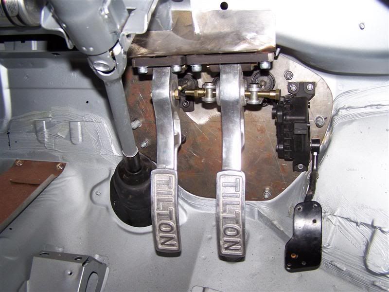

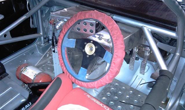

Scott has turned a Tilton floor mounted pedal box upside down and bolted it to the bulkhead.....we'll have a brake bias adjuster on the dash. Now got a Mk2 throttle pedal but we need to get it adapted a little to sit in the right position.

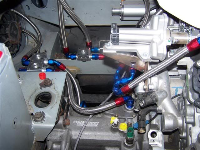

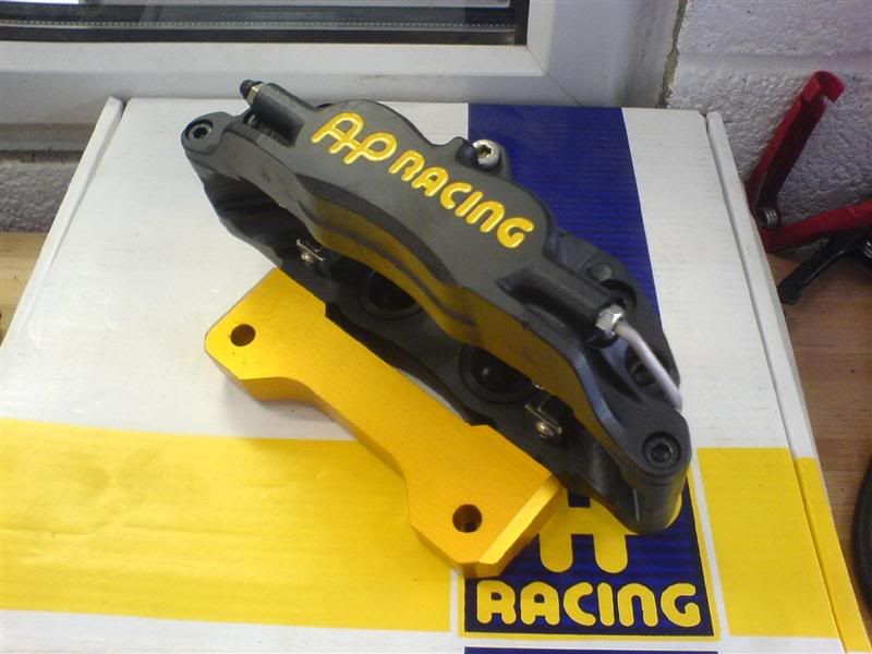

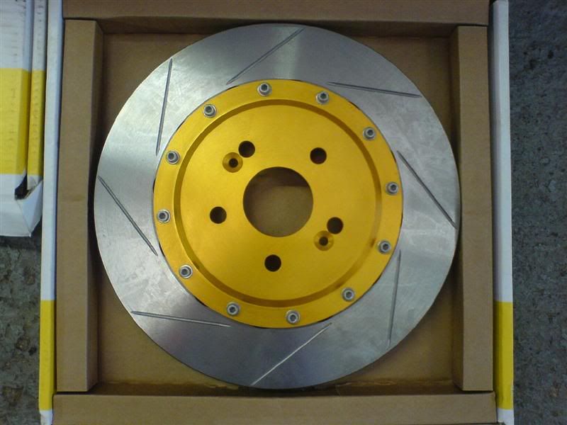

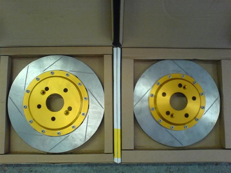

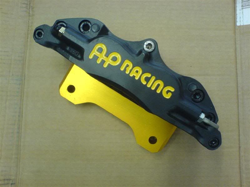

The brake parts are all there now ready to be bolted on. Still AP Racing but better calipers and slightly bigger rear disks than standard so we can run a caliper for the fly-off hydraulic handbrake.

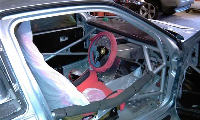

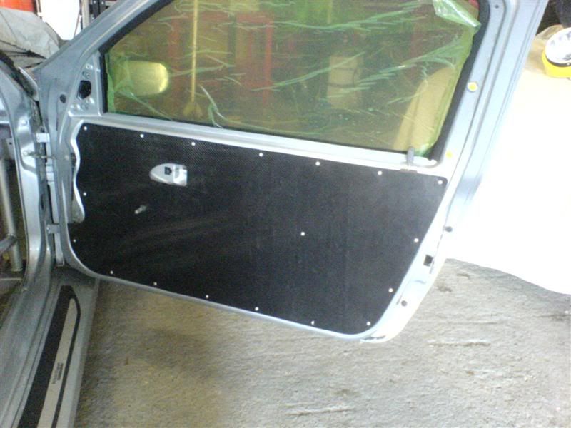

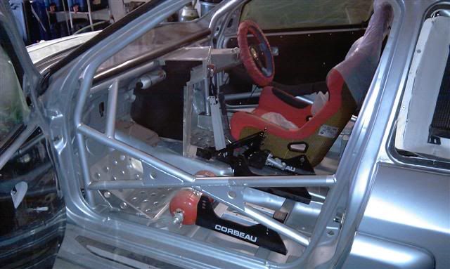

Carbon doorcards have been cut and fitted

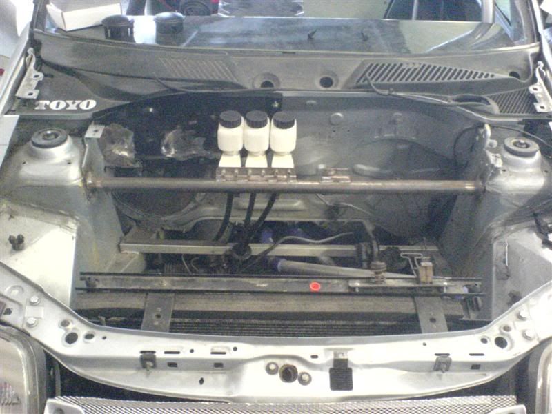

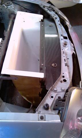

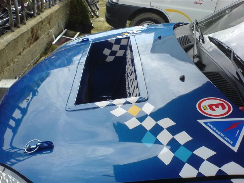

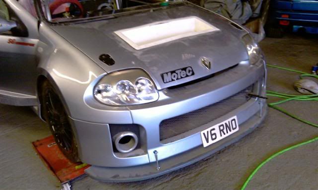

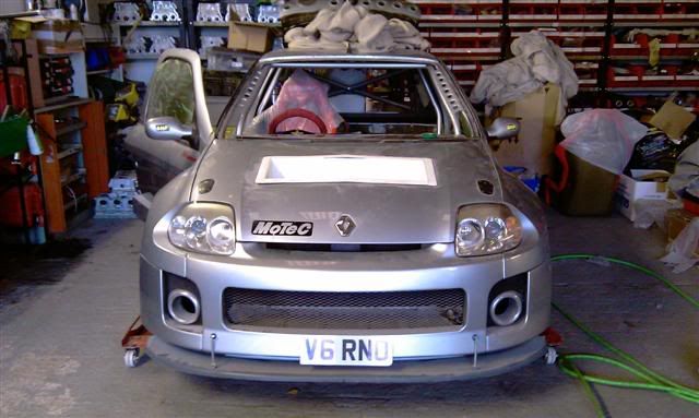

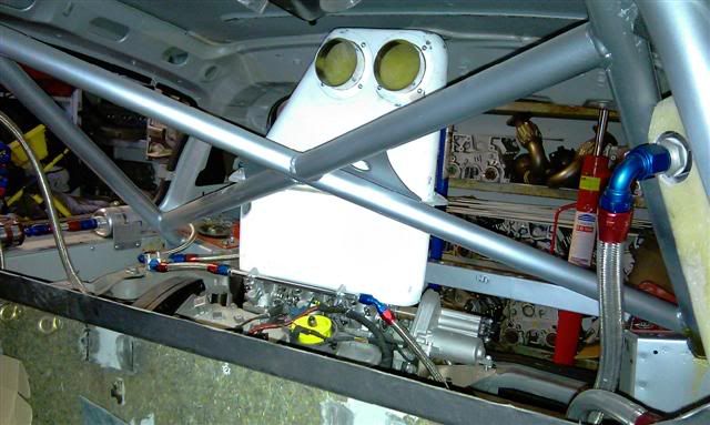

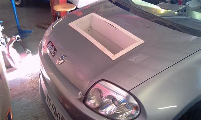

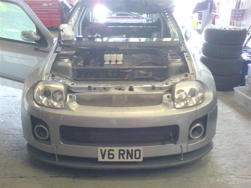

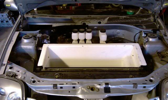

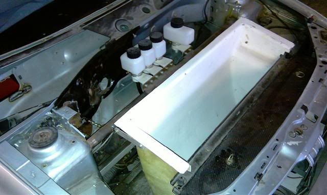

Resevoirs fitted to the front strut brace and we'll put a big hole in the bonnet for cooling as per the Rally Car.

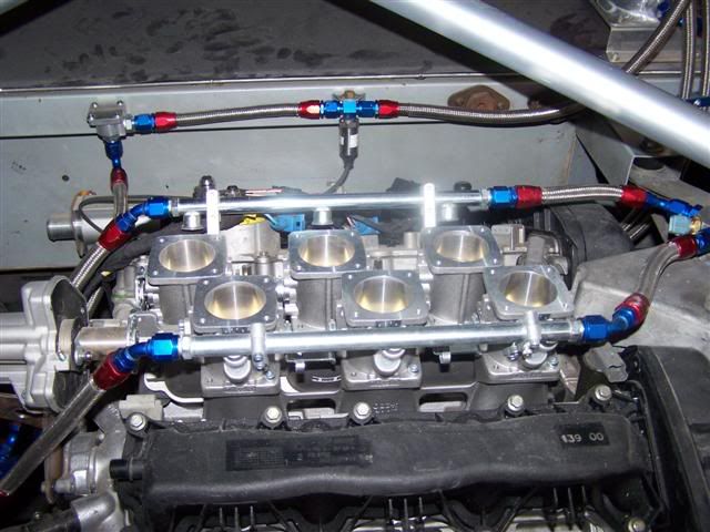

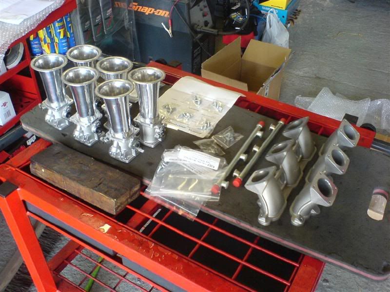

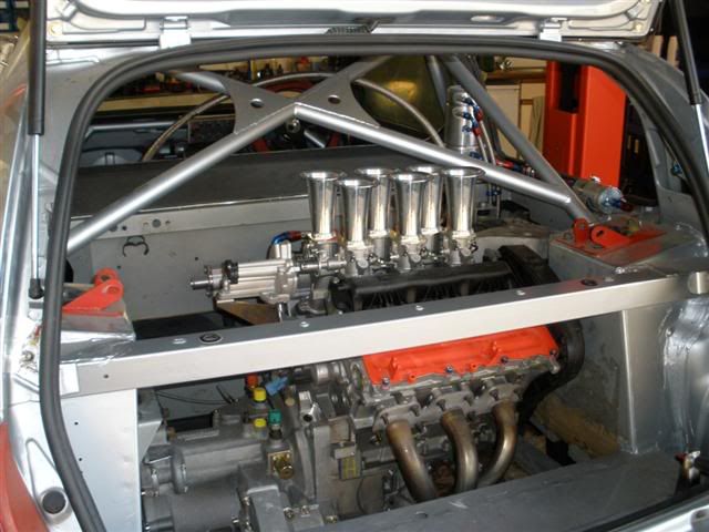

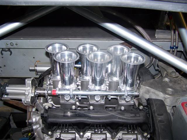

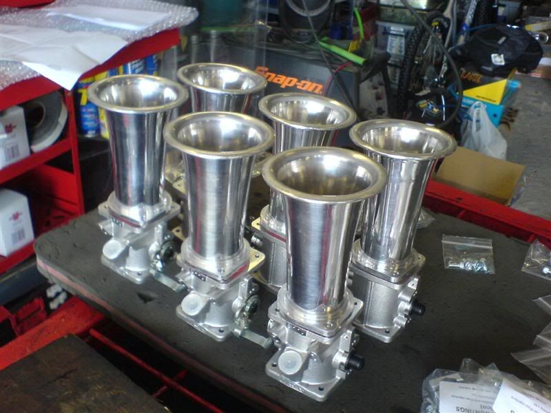

Finally we're going with ITBs which we'll run drive by wire...Leaving the nitrous off......for the time being at least....
If it weren't for me fitting the Trophy inlet it would definatly be a set of them!! They look brilliant and will no doubt sound fantastic!!

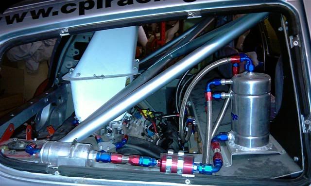

Steve @ GWR Motorsport is working on the MoTeC install now.
Am at Scott's tomorrow so will post pics if they're worth looking at......
