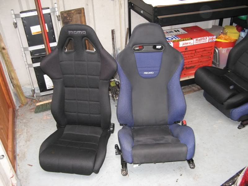

Here are the seats side by side - I think the Reacaros would look good in an Illiad Blue Vee ;-)
Still not sure which ones I will end up in my car but am erring on the side of trying the Momos first to see what they are like.

seeing them side by side..te recaro's look far more supportive..
especially in the lower back width, and base side bolsters
...Keep the MOMO's..... :D Sell the recaro's to someone who owns an Illiad Blue Vee.....for "much-cheapness....!!!!" :wink: :wink:
Jainy
:D
As much as I`d love to buy the Recaros off you... [smilie=icon_moneyeyes.gif]
You have to fit them. The Momos look cheap in comparison. imho.

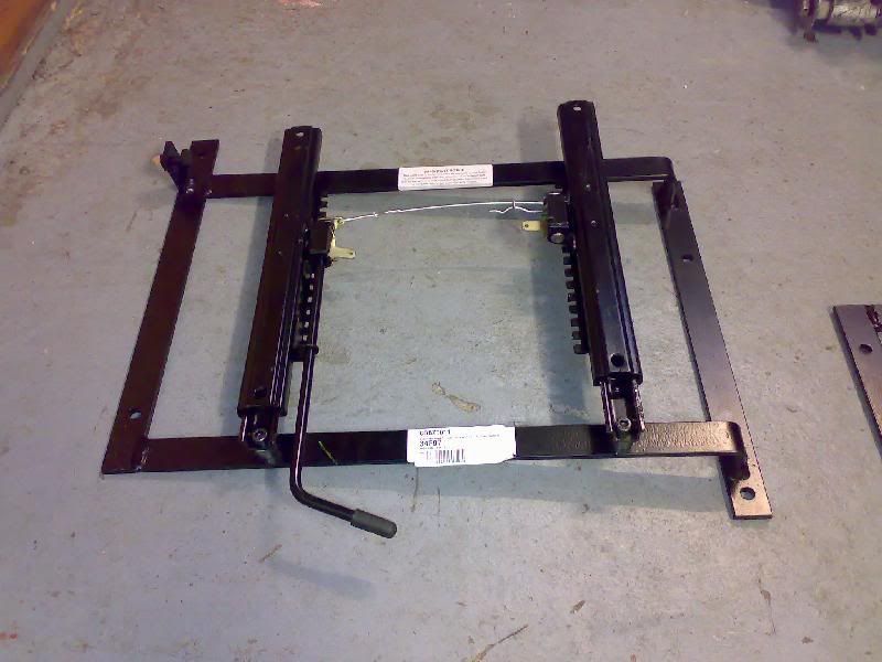

Just received my Cobra subframes and they look pretty good and substantial actually.
Due to their design I am confident they can be adjusted to fit any aftermarket seat with a 4 bolt fixing.

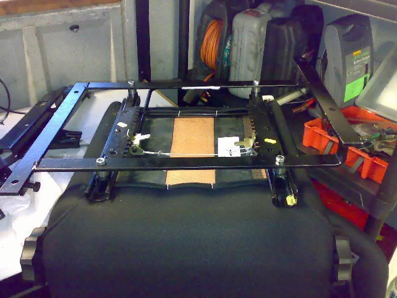

Cobra subframe (passenger side) ...

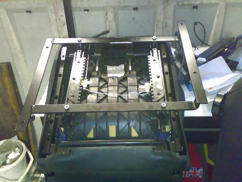

Cobra seat alignment
Evo/Recaro seat alignment
In both cases the sliders need repositioning width ways and additional holes need drilling in the slider bar to match the position of the seat mounting holes front to back. Pretty simple. The seats can be raised, if required, using spacing washers.
