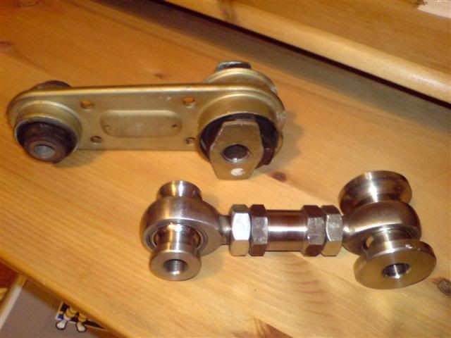

Mounts were made by Spot on Cables, it's a one-man-band engineering works. Hywell has fabricated a few parts for us. The main one to do is the lower engine mount, we've basically got two large rod end bearings mated together, I had a pic somewhere but cannot find it at the moment. I also had the others remade with a more solid polyurethene.

Found that pic of the lower engine mount......this is the one to get sorted.
ahh i see what you had doen there, thats cool..
Yeah lower mount on the S3 and golf was the major one to do, doesnt look like that would be much money to make either.. hmm

That standard engine mount is really poor on the Mk1 and uprated (totally different) for the Mk2.
I like the idea of the solid mount only cocern is the stress it might put on the subframe mount point, as if the hole becomes elonggated major work needed to repair it.

Mk2 subframes are beefed up as well compared to Mk1. I have a Mk2 subframe on my Mk1. I'll let you know if it wears out........
Yes much stronger I am goung to fit a Mk2 mount on mine and will be moding the subframe to suit.
You can see why it was changed when you compare the 2.
