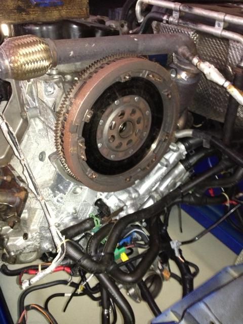

Bad news, the flywheel has a bit of play in it, so I can gamble and keep it or change it while they've got it all apart. I've gone for the expensive option, but at least it will be all well afterwards and I fancy doing a day at Bedford next year (though might be a bit skint now)
i do hope you're not fitting another dual mass unit! They're crap, call TTV (twenty twenty vision or you can order through demon tweeks) and buy one of their flywheels
Feck me! Didn't realise they were off the shelf. That's a no brainer. Sack the dualmass. Stick a ph1 clutch and pressure plate in and your away! I remember seeing the Trophy down Scotts. The way that thing reved was insane and that was down to the lightweight flywheel. For that reason I tracked down the original Renault trophy part.
Have you fitted one of these Fred? Or anyone else for that matter?

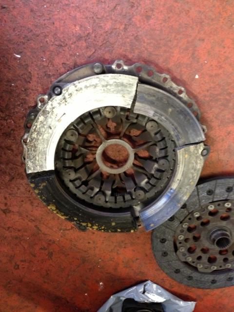

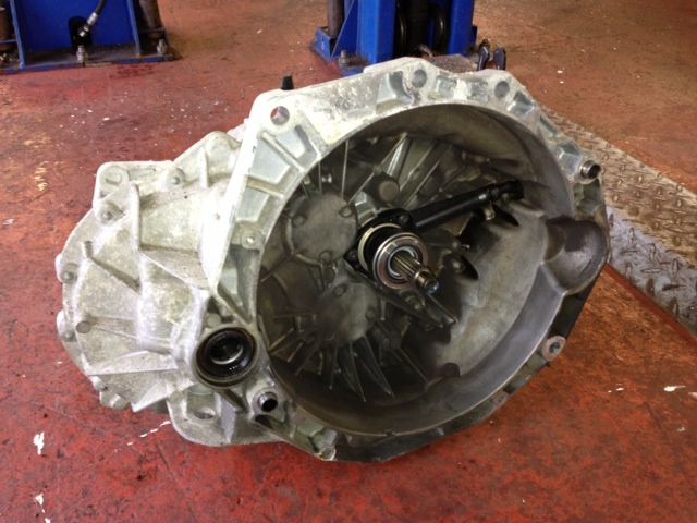

I've got some pics of your car with the box off, feck me the clutch is in a bad state!
I'll post them later on when I get home, I've also taken a small video of the play in the flywheel.
Cheers
Dan
Yeah he said the clutch was knackered. What I thought happened clearly didn't, I must've revved it and released the clutch.

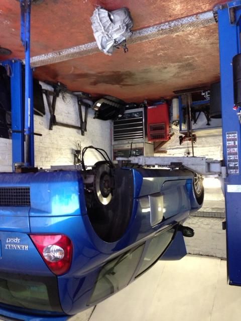

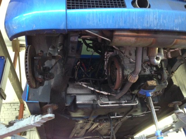

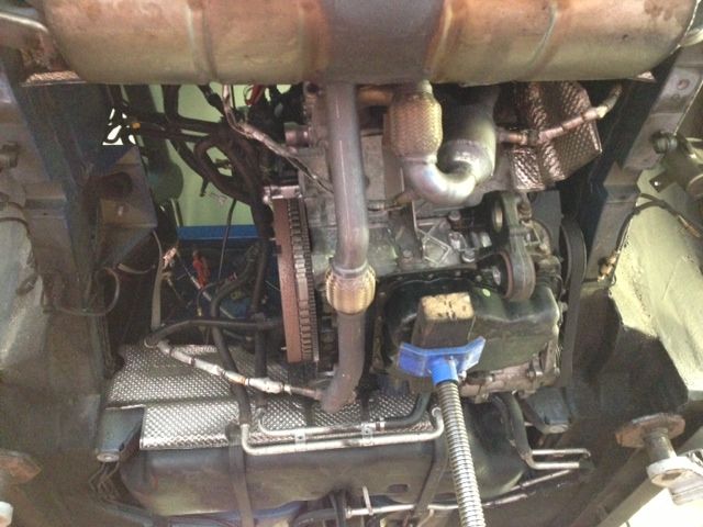

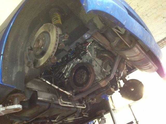

Here's a few pics taken this morning...
Never seen a clutch go like this before! ...
Very tidy engine bay, and I was shocked at how much space there is up there once the subframe is off and the gearbox removed.
