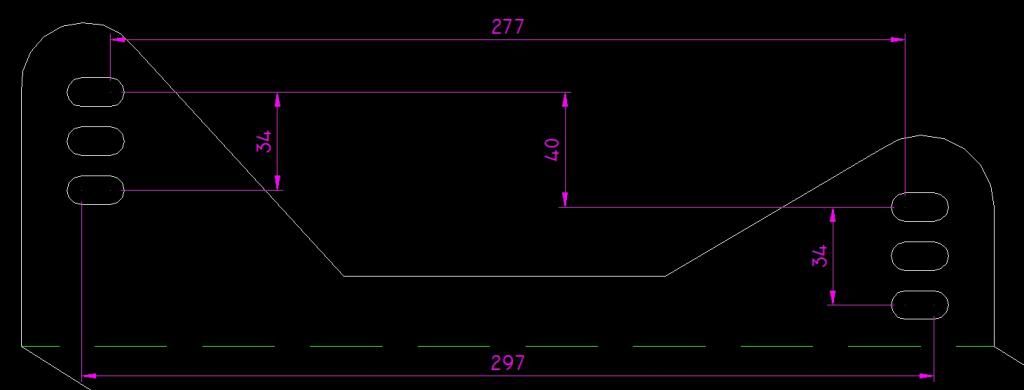

ClioSpyder I checked today the min / max distances between the centres of the holes.
Here is a screenshot to show this.
The distance between the faces of the brackets is 455mm once fitted to existing rails
Let me know if this will work with your seats.

Hi Jon,
Just been checking the Seats I was interested in fitting........
The Hole to Hole fitting would have been spot-on as that was 290mm but the distance between the Mount Faces is 455mm and the Seats I would like to chuck in are only 370mm - so an 85mm gap that'll be too difficult to fill !?!
Many, many thanks for taking the time to measure.
