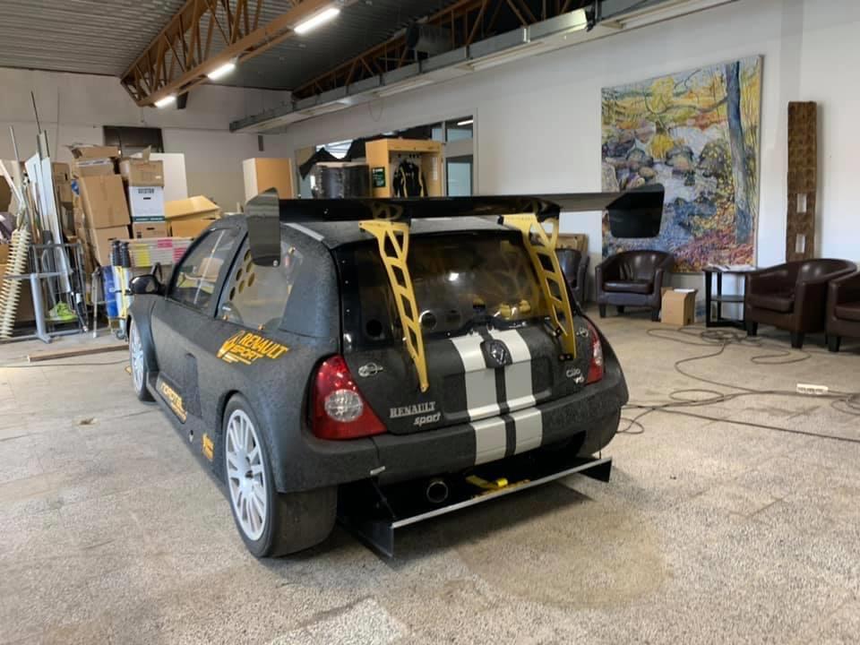

Over the years people have always seem to wonder about gearbox option for the v6. Well tonight myself and Blake mated an uprated gearbox to his supercharged engine. Originaly designed for motorsport its strength is massive in comparison to a pk06, it has an LSD and even has provisions for cooling. We have a little way to go yet but once done there will be nothing to stop Blake putting massive power (gearbox is good for 800hp) to the wheels. He wants a drivable 400hp.
