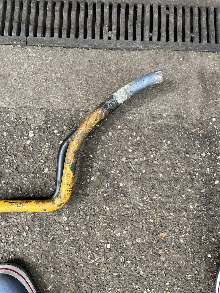

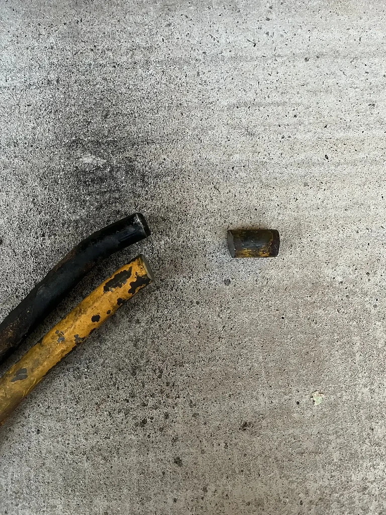

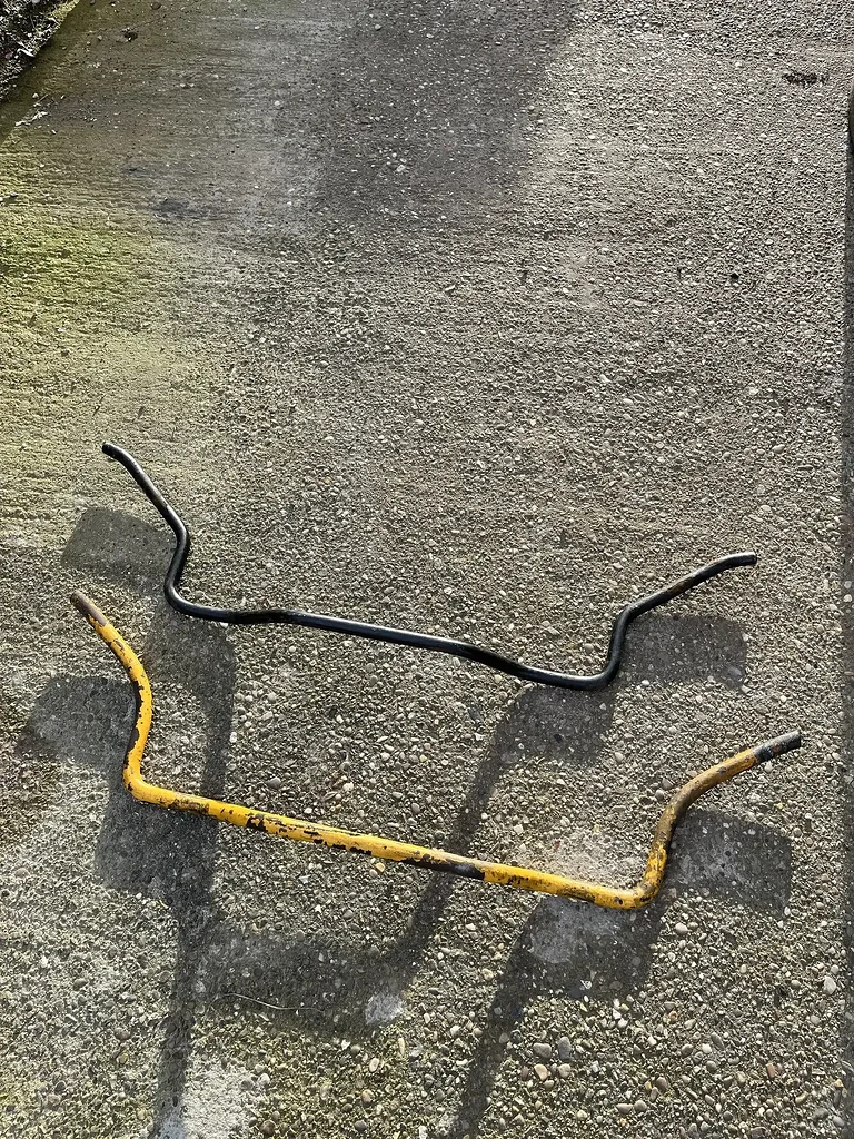

After finding a Williams arb for cheap, even though it’s sacrilege… I’ve chopped 20mm off each side and bent the ends so it matches the gtt arb I’ve got.

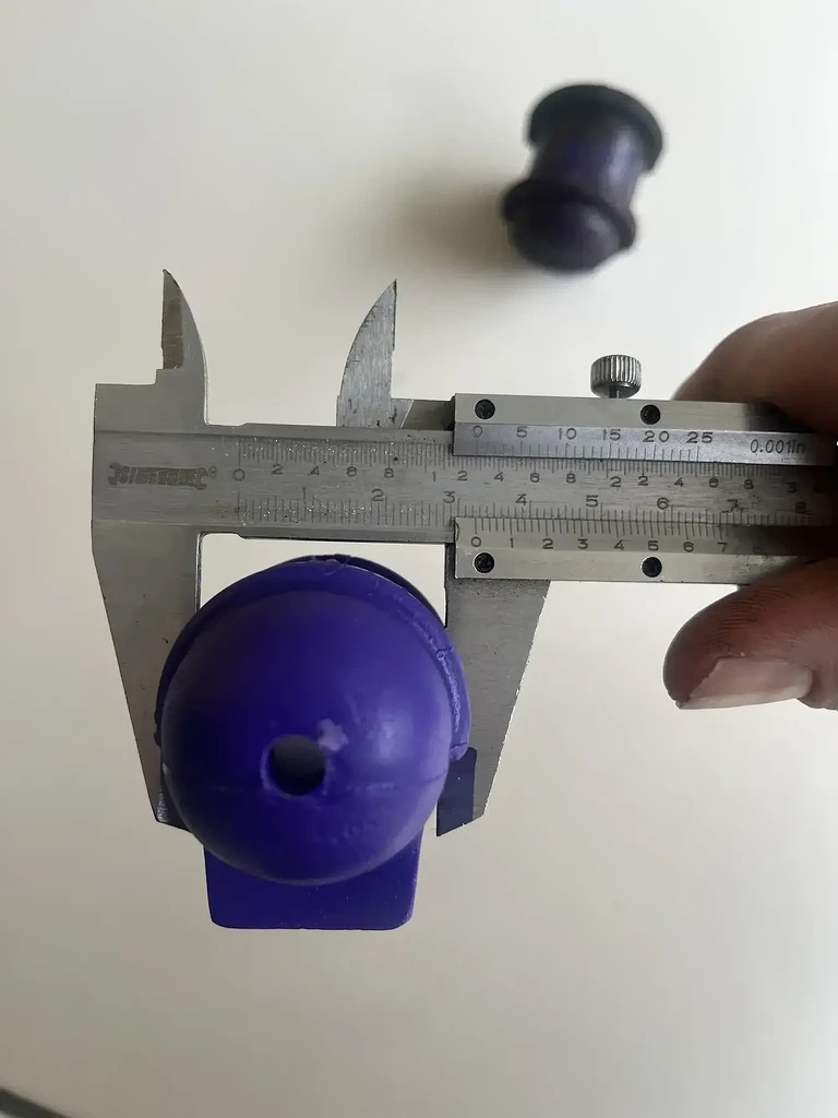

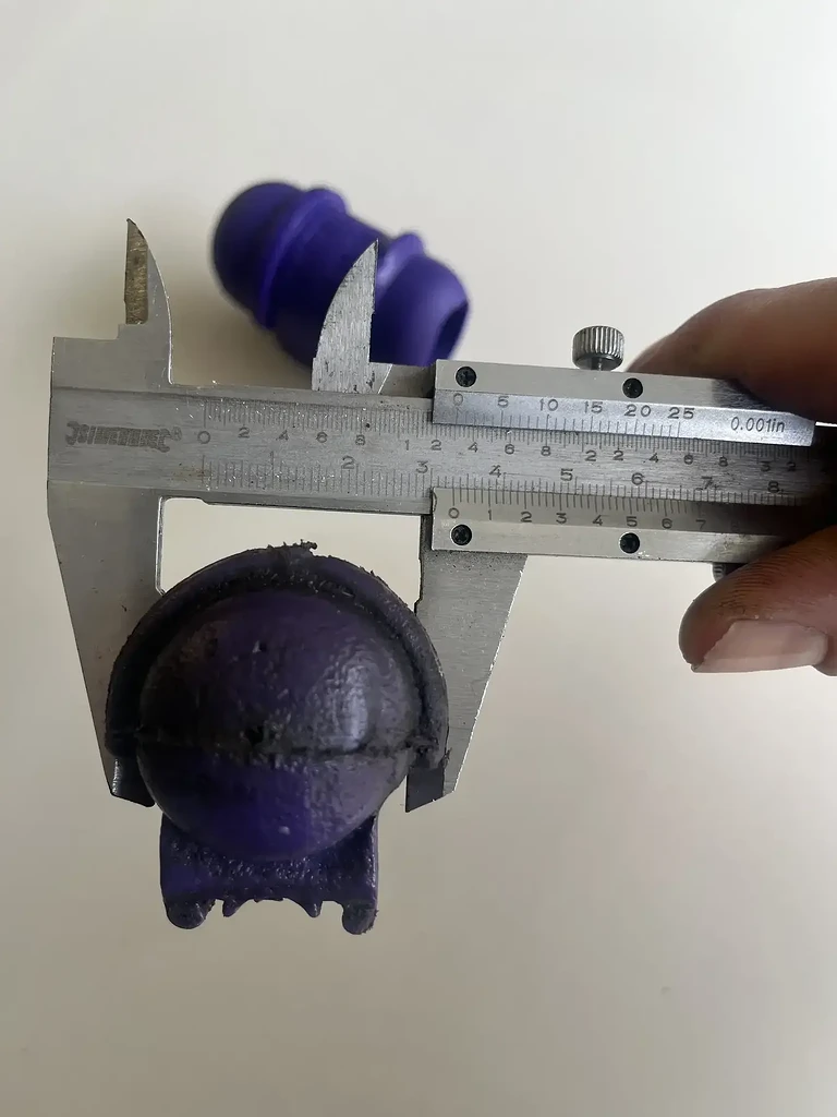

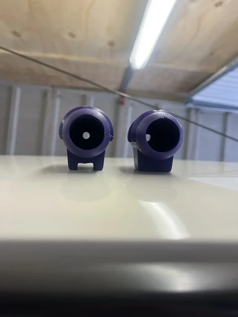

Also had to modify the power flex Williams bushes to match those for a gtt as they’re slightly different. The outside diameter is the same on the outside bushes but they don’t have the groove that sits inside the gtt arms. I didn’t take any pictures of the inner bushes but it seems that the Williams items are slightly thicker which I’ve took back to match the gtt inner bushes.
Here’s the slot I’ve cut into the outer bush:
After fitting there was a massive difference. Even though there’s only 2mm difference in thickness between the gtt and Williams arb, I think shortening the arb has increased its torsional strength and the 5 is definitely more stable under heavy braking. The rear wheels no longer feel like they’re lifting off the floor when going into corners. I’ll remove the arb at a later date to paint it as this was only a trial and error. However this hasn’t sorted the wheel spin out of corners. A Mate of mine came across a Clio cup car that was for sale and came with loads of spares. I had to buy the Grp N torsion bars off him which had never been fitted!!

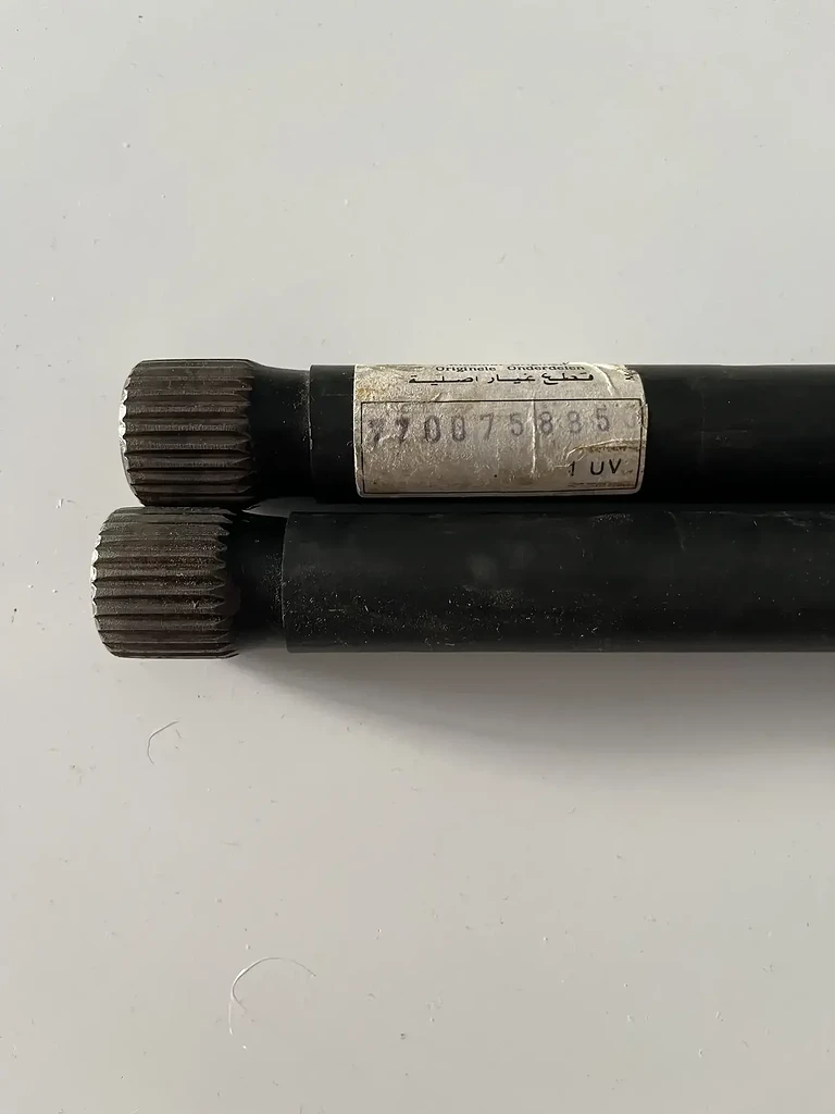

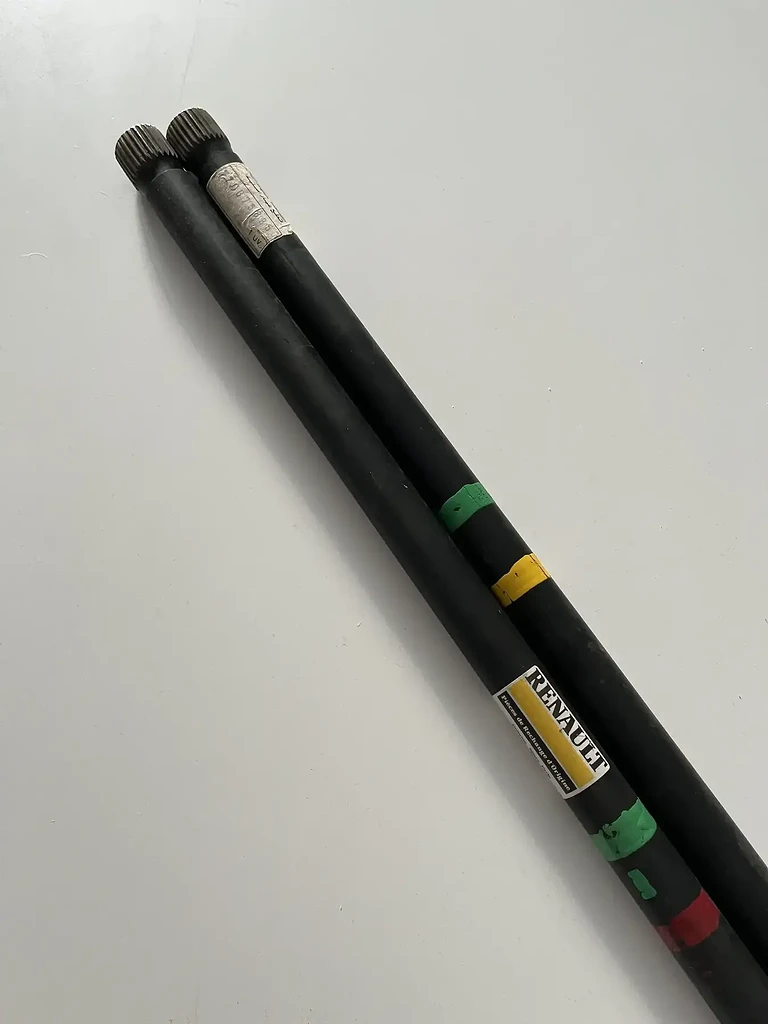

These are the 23.2mm torsion bars and they have stopped majority off the wheel spin out of corners and they still feel comfortable and not crashy which I thought they might have done. The car is now feeling great and getting closer for a track day!!!

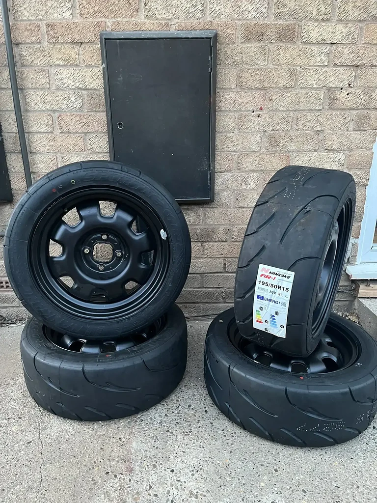

Another purchase this month was some AR-1’s. Not really a nankang fan but heard loads of good reviews about them. Ktec was selling these at £104 each.

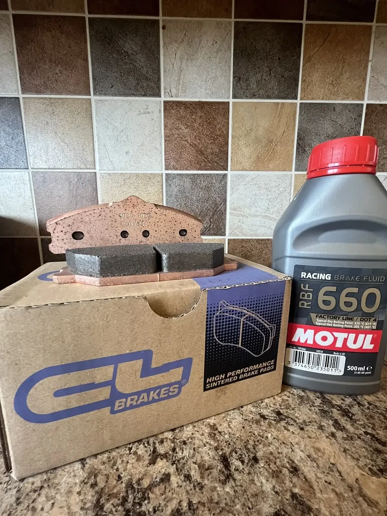

And to compliment track tyres:

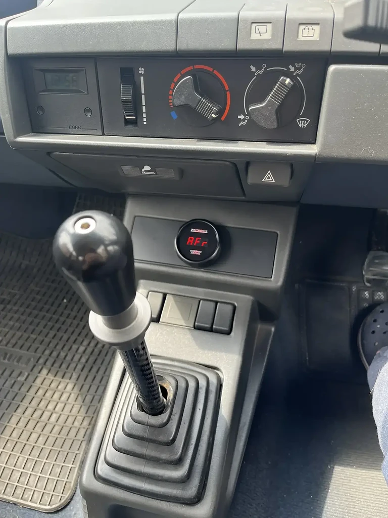

As you lot know, I try to keep my car looking as standard as possible inside and out. So with not having many gauges, not even a rev counter! I do need to keep an eye on somethings. Last time I was at efi I purchased a Zeitronix wideband to replace the AEM item in the Meglio (which is for sale £10k ono HIT ME UP) I decided to fit it into the 5 instead. Kinda makes sense as my 02 plug isn’t being used so it was literally an hours job using to radio wiring and feeding the 02 sensor through the dash into the engine bay to the exhaust. Bought a £8 single din blank off eBay and just drilled the needed holes.
Literally can’t hear the radio over the ITBs anyway so makes sense :joy:

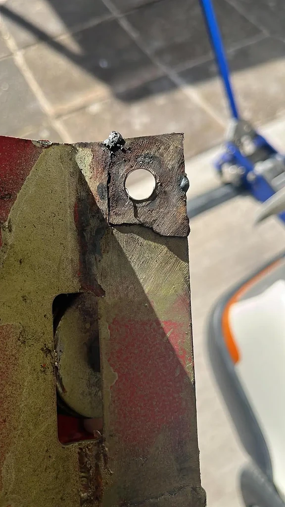

Went out for a quick spin to test the wideband and surprise surprise I broke another engine mount, this time the rear one!
That’s 2 mounts this year!! :joy::joy: swapped it out in situ anyway…

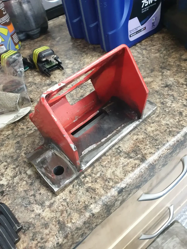

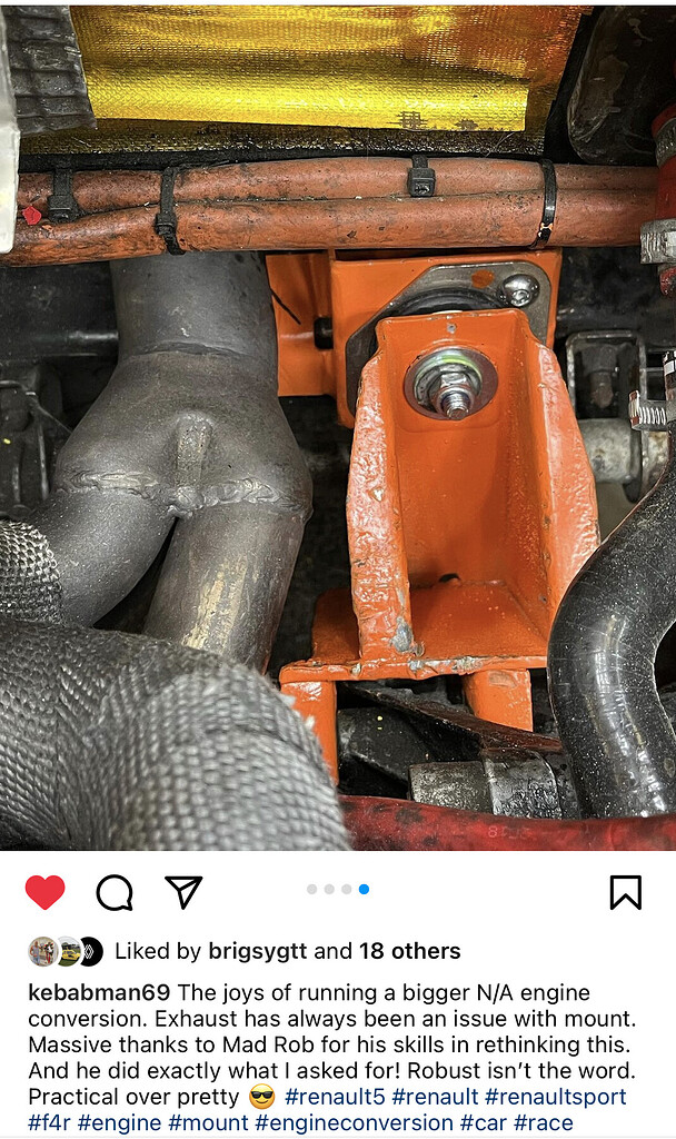

Been helping a friend with his 5 and F4R conversion. Made some progress but his budget is really tight as he’s got other projects on… biggest outlay for the 5 F4R conversion is the exhaust manifold. Most fabricators want +£1000 for these and if you can’t weld you literally don’t have any choice but to fork out a full bag!! I’ve been looking for ways to use the 172 4-1 manifold as people just give them away for nothing. As I was researching Tom frankland (kebabman69) posted a modified rear mount.
It is literally GENIUS!! It moves the rear gearbox/engine mount out the way so
You can run the 172 manifold. I can’t believe I haven’t thought of it before!!! He’s a local lad to me and been chatting to him about if it works well and looks like it’s the way togo if you’re doing this conversion for the first time. I thought I’d have a go at having one modified and see how easy it was so gave a mount to a friend of mine who’s a really good welder and….

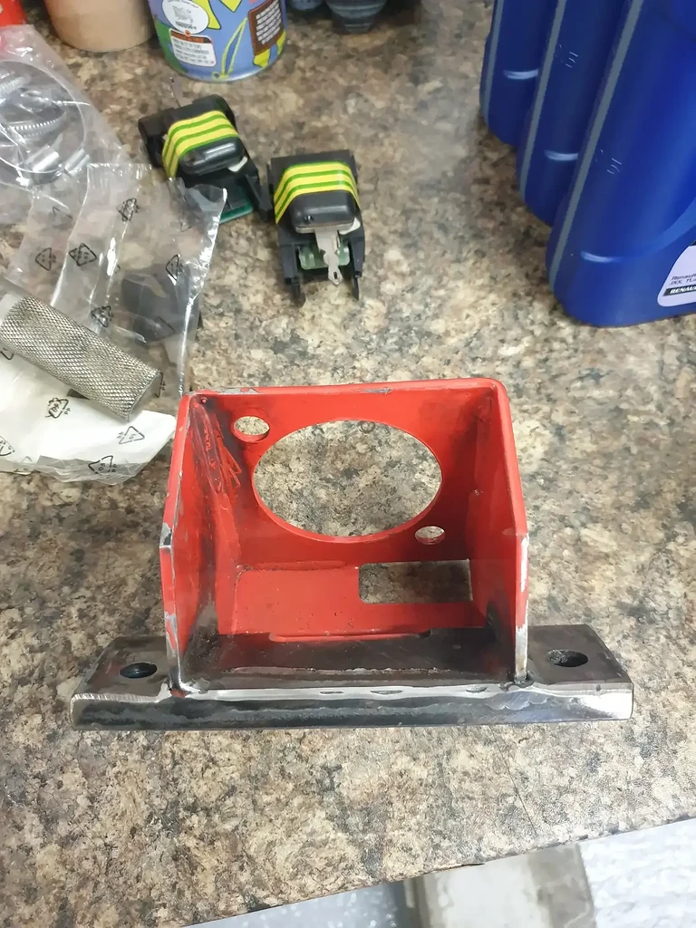

Didn’t take him long, said he did make a small Jig so he could do more which I’ve just purchased some rear mounts to be modified for anyone else that wants to go down this route.
Used my old snapped mount to test it and results speak for themselves :+1:t3: plenty of
Room for the manifold to run over the subframe into the exhaust tunnel. Just need to fabricate a front pipe over the subframe to the exhaust which won’t be too hard! Went for a drive out and met up with @StuR5 as his car was getting close to completion. He’s done a proper good job :clap:t3: it’s really clean and I’m kinda jealous as mine looks abit tierd or used and abused shall I say :joy:

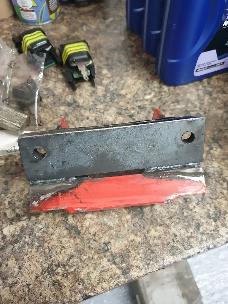

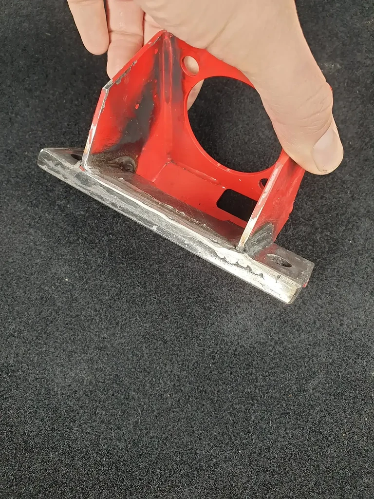

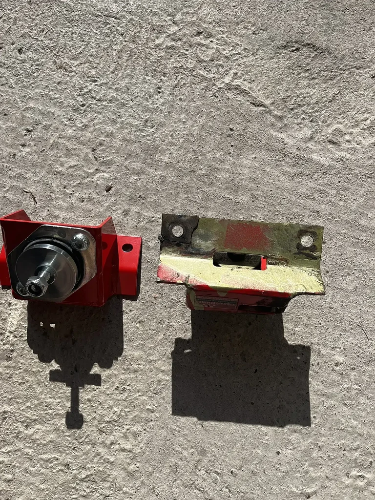

The vibratechnics rear mounts are shite. Mine lasted about ten miles after mapping. Reinforce it like this and you wont have any more issues mate.
Cheers brigsy :+1:t3: I was gunna make a new one but if you’ve just welded thicker gauge to the bottom of the mount then that’ll save me some time. Might get chance to get it done before retrorides but if not, I’ll get it sorted whilst I’m having my new exhaust manifold fabricated :eyes:

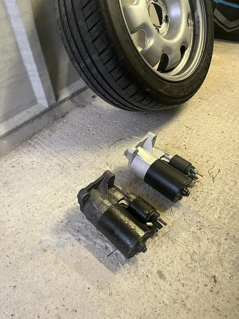

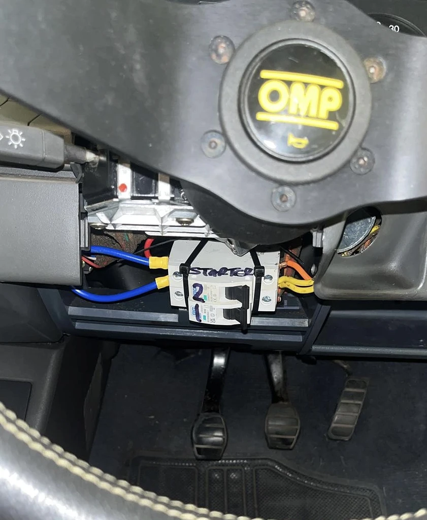

Been looking forward to RetroRides at Mallory all year and literally been prepping my car ready for it. Even though I had loads of issues I was determined to get it there. Monday previous the starter decided to pack up so ordered a new one to fit. As with my 4-2-1 exhaust manifold over the starter, it was easier to Jack the car up, remove the drivers side front wheel and drive shaft the do the job from underneath.
After fitting tried starting the car but literally could not get the key inside the ignition barrel. Spent all night stripping out the steering column to get the barrel out and remove the steering lock as I only had afew days left till the show. Spoke to a friend of mine and he said to hot wire it whilst I wait for a new barrel to arrive.
Ended up using 50A RCD for the ignition and a 6A for the starter. Worked a dream and might actually make a proper push button start in the future. After proving how awesome the RCD starter switches were I fitted the track wheels and tyres and went to shell to fill the car up with the finesest 99 petrol

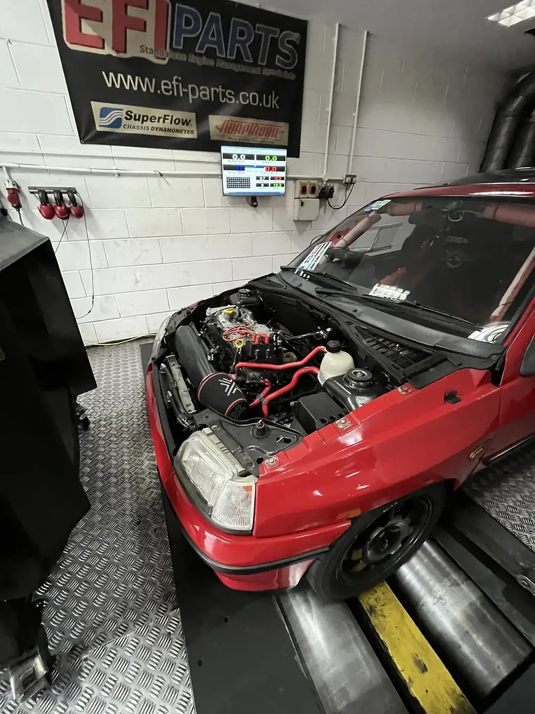

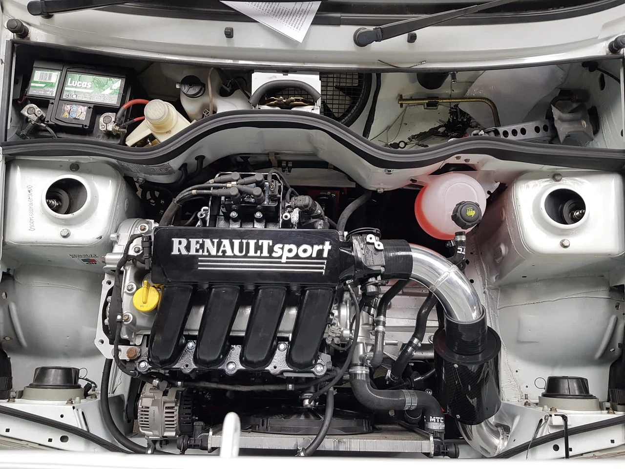

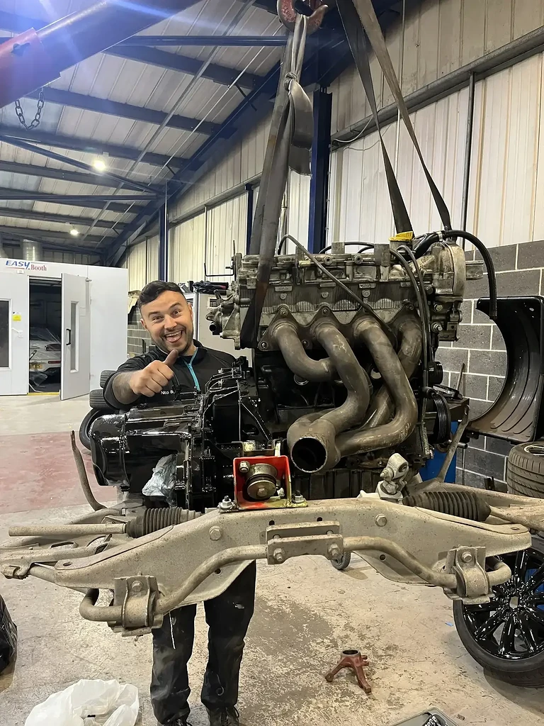

This time he’s fitted a pipercros px600 plenum and also changed the valves and valve springs as we only found out the other month, 172/182’s run 2-piece valves and he wanted to change them for piece of mind.
as you can see, PMS engine mount kit in a mk1 clio…. Yes 172/182 mounts are a direct fit for all those unkowns.
The car had lost afew hp & lb/ft due to what we could guess was the few changes that he made. He removed the middle silencer as he was told the noise was forward facing and not coming out the back of the car however, Chris said that this can effect torque and which it had lost afew!! I wasn’t aware that it would make that much of a difference!! Also… it had lost 7bhp from what Chris said would be a mixture of stiffer valve springs which Chris made clear that the engine is now having to work abit hard to turn the cams plus the lack of air getting to the jenveys as there’s left area for air to enter the filter.
All in all… made good figures for a non forged engine. I’ve literally got all the same internals boxed up in the garage waiting to be built up and put into the renny 5! I would also be happy with similar figures.
