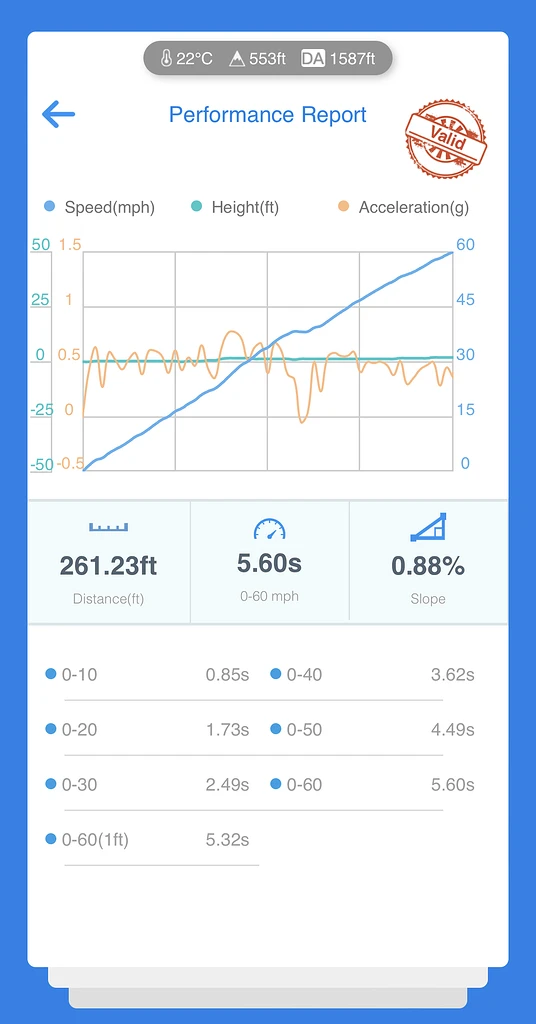

Since the weather has been warm I’ve been going out at night to set some 0-60’s on the dragy box. Done plenty of runs and I just can’t seem to better 5.6. It’s really hard set off with out spinning the wheels in 1st and 2nd and this was literally my best run.

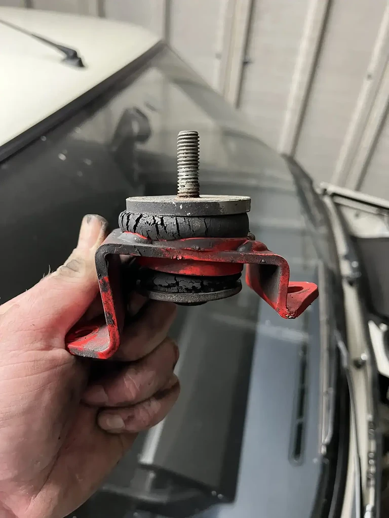

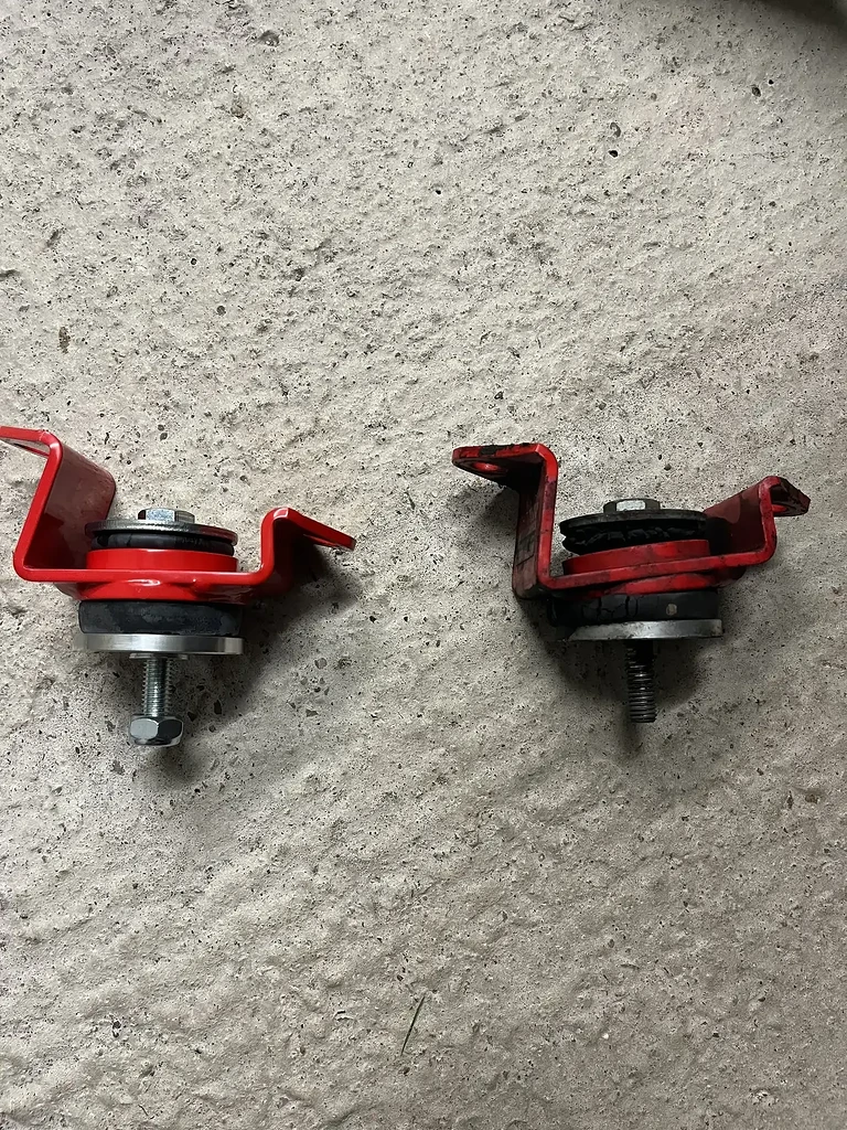

after a huge absence I’m back :eyes: been a busy winter and now springs on its way it’s time to get some jobs done. First port of call was the front engine mount which had collapsed through its arse.
Bought a new mount and also purchased the “gtx” bracket from one of the guys off the b18ft groups. Dunno if anyone else has issues with going though mounts but this is my 3rd front mount and I’m also on my 2nd rear mount. The front gearbox mount is still the 1st one and still looks in good Nick
New vs a year of abuse. Also pics below of “gtx” mount which did move the engine closer to the offside suspension strut tower but there’s still afew millimetres of clearance for the engine to move.

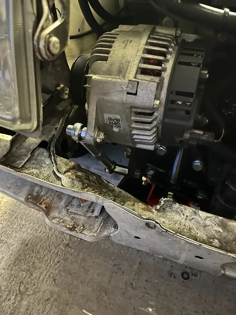

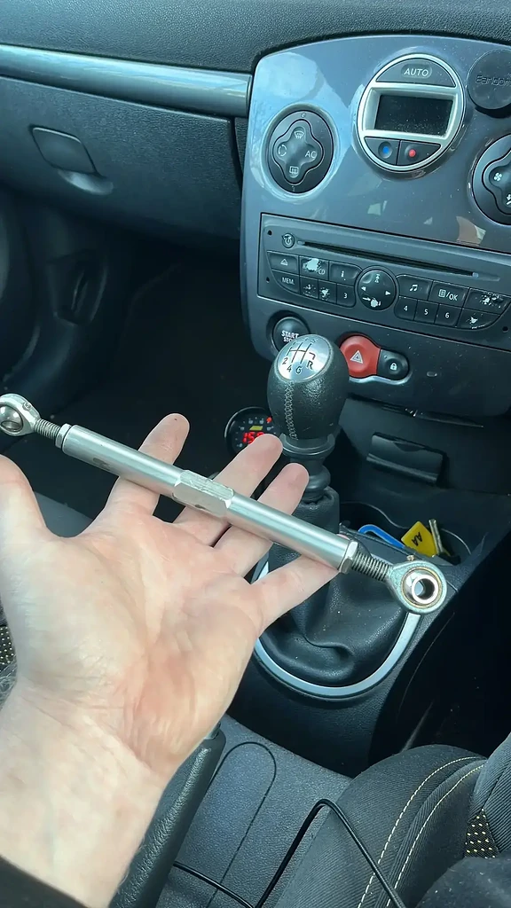

Didn’t get any pictures but did have to make some clearance on the left hand side of the bracket to clear an area around the water pump casting. After that was done I’d got fed up with how bulky the 172cup alternator setup was and decided Togo down the rose joint adjuster route. My mate had a spare so had a cheeky five finger discount on that :eyes:
You can see where the front cross member has been “plated” to fit the cup alternator setup which I’ll sort out at a later date!! Anyway, new set up is loads better!! Can adjust it without taking the bumper off (unlike the cup setup) and ended up selling the cup alternator bracket and adjuster for £100 :clap:t3: after completing this task the fucking clutch cable snapped! Only one that I could find quickly was from CGB-Motorsport which sent out next day delivery but the fire wall grommet was incorrect!!

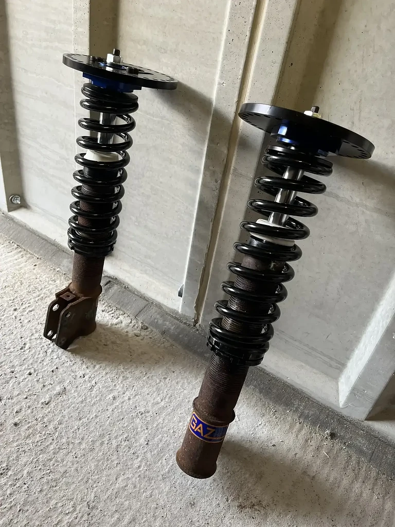

after fitting these and the filter I took it for a rip and I’m glad to say that there’s enough room to let the car breath and once again my cars an absolute animal which now has a proper air filter!! Another job ticked off the list now it was time to tackle the front coilovers, which looked like they’d been chucked to the bottom of the sea with the titanic!! Also with this I’d gained a knock which I believed with the OE campus top mounts. After chatting to afew lads including Brigsy I’ve put my hand in my pocket and purchased some COMPBRAKE top mounts. Was told by afew lads that I had to buy billet spring caps from GAZ so that there’s not interference between the top mount and spring cap.

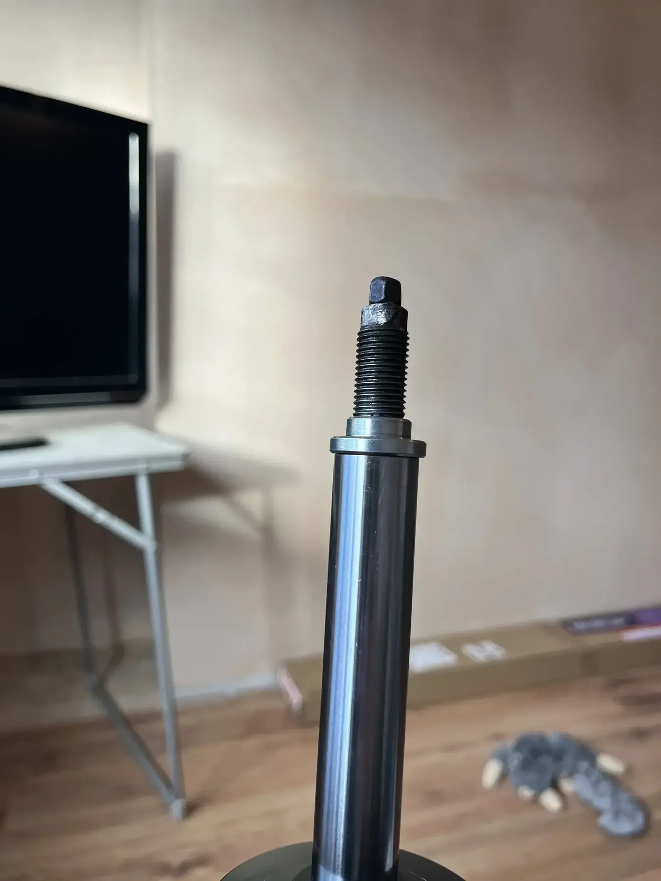

After fitting these I noticed that the bearing collar wasn’t sitting correctly on the suspension strut shaft.
Rang GAZ and told them the issue and they said that they can machine the shaft to allow the collar to sit right and I also took this opportunity to have my coilovers reconditioned and also purchase some heavier springs.
Collar now sitting flush with the strut shaft and now that is sorted I was a piece of cake to build the rest up and fit them.
Beefy 350lb springs… hopefully these will sort afew handing issues I had on 250lb springs.
Dampener adjuster is now billet and not shitty plastic like the ones I’ve had in the past!! :clap:t3::clap:t3:

Did GAZ refurb them and leave them looking like they were at the bottom of the sea?? That new GAZ sticker looks a little at odds with the finish on the coilovers??
Cheers Steve. I assumed that when you’d ask for a “recondition” of your coilovers then you’d expected them to be back new but apparently not. I spoke
To a friend of mine who also runs GAZ and he said that you have to ask for them
To be rebodied if you want them looking like brand spankers which is a couple of hundred quit ontop of what I paid. They’ll do for now though as I’ve got other expenses to pay for and they work as they should now which is better than they were
Wow, strange that, but I guess they are refurbishing the operation of the shocks, not the aesthetics, and as long as they do the job that’s most important.

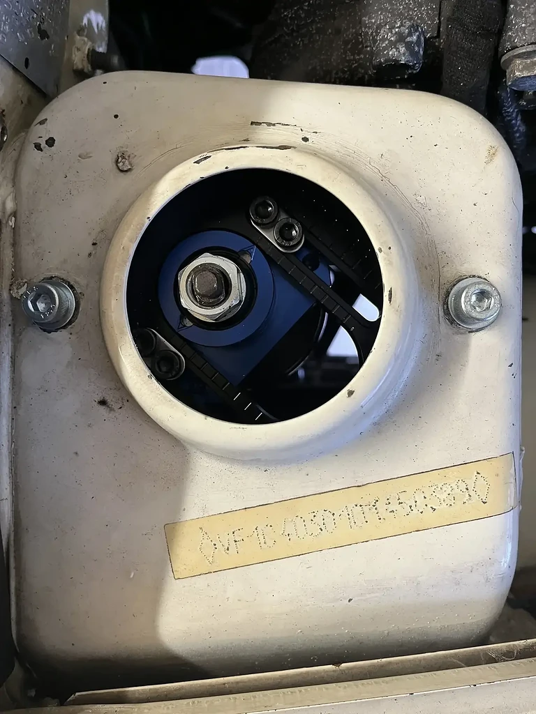

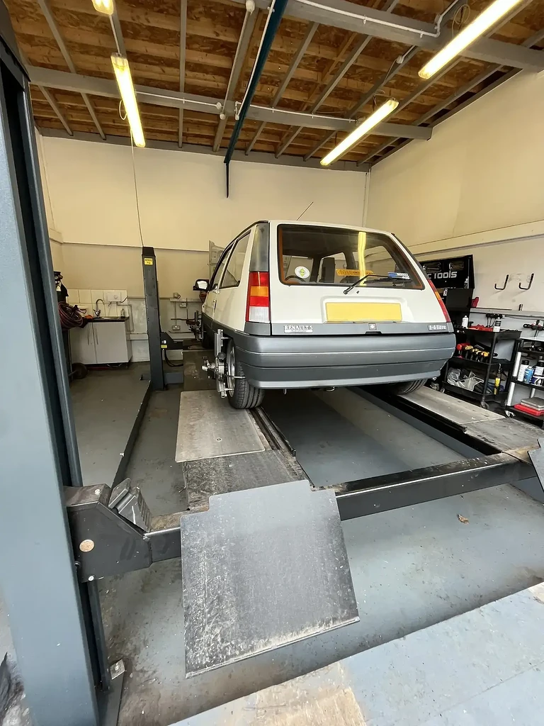

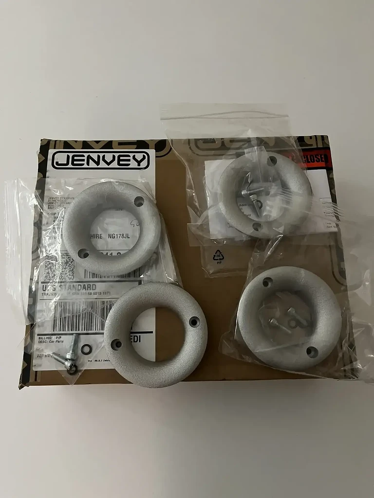

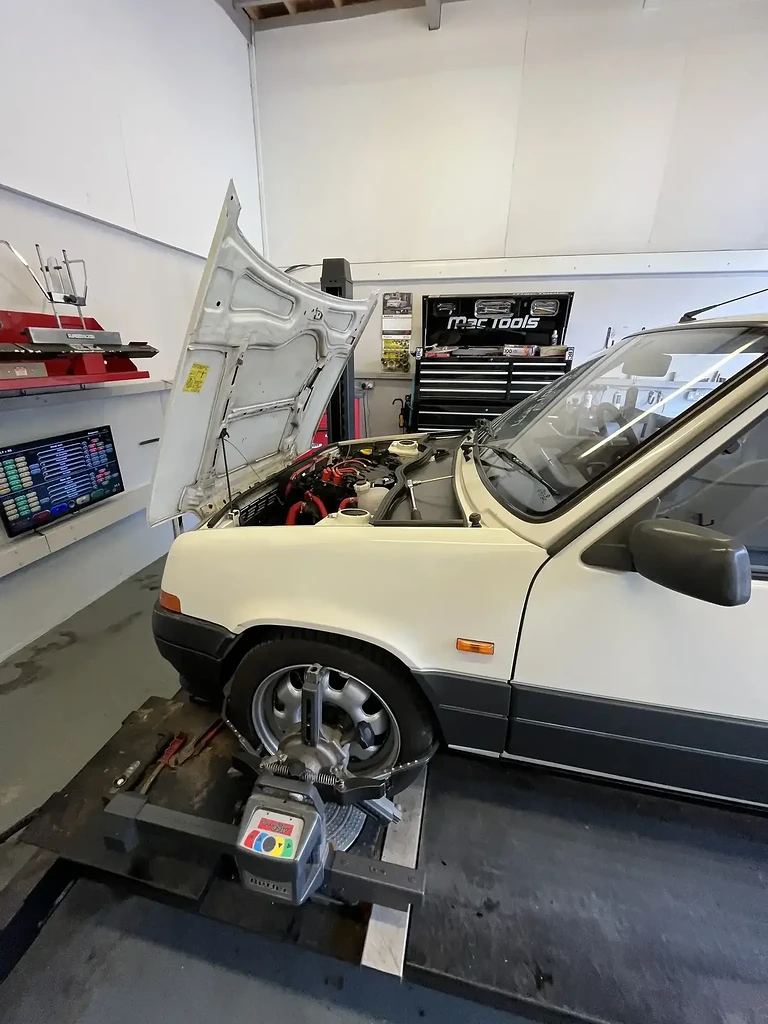

Took the 5 to a local geometry specialist to have the front setup. Tried to aim for -1degree on camber and as much castor as possible. With how I positioned the top mounts and adjusting the camber so both sides were equal I ended up with -2degrees of camber and quite a bit of castor (I don’t actually know how to measure this properly) :man_facepalming:t3::rofl: after this I took the 5 for a thrash and it drives amazing!! The suspension is a lot more compliant now and is lot more comfortable even though I’ve gone from 250lb to 350lb springs. I now think that there was an issue with the campus OE mounts I was running as I can’t think why solid mounts would make it a more settled ride.
I’m really impressed with the top mounts though and will definitely advise any one else to get them fitted as it’s been a night and day difference on mine. after looking at the position of the top mounts I will have to reposition them and go back to have them set up and aim for -1degree of camber as I’m still getting wheel spin coming out of corners/roundabouts or maybe this could be just a fettling with the dampers. Also to help with the weight transfer issue in corners I’ve purchased a 23mm anti roll bar (Williams arb) as my current arb is only 21mm so I’ll need to purchase some more polybushes and swap everything over.
