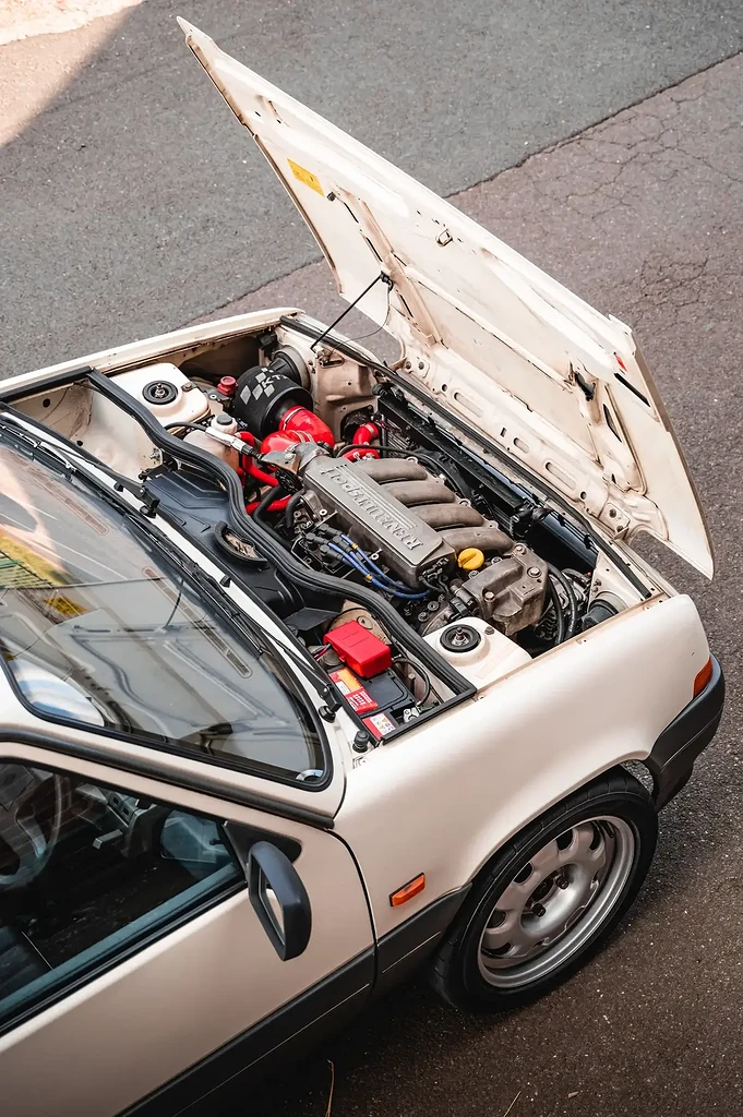

Had my Renault 5 auto with a Clio 172 conversion for about 2 1/2years now and hopefully will be doing some more work to it over the winter. Planning on fitting clio 197 internals (which I’ve already bought) into my 172 engine and also tidy up some loose ends. It’s already got a massive spec and hopefully will be show worthy next year

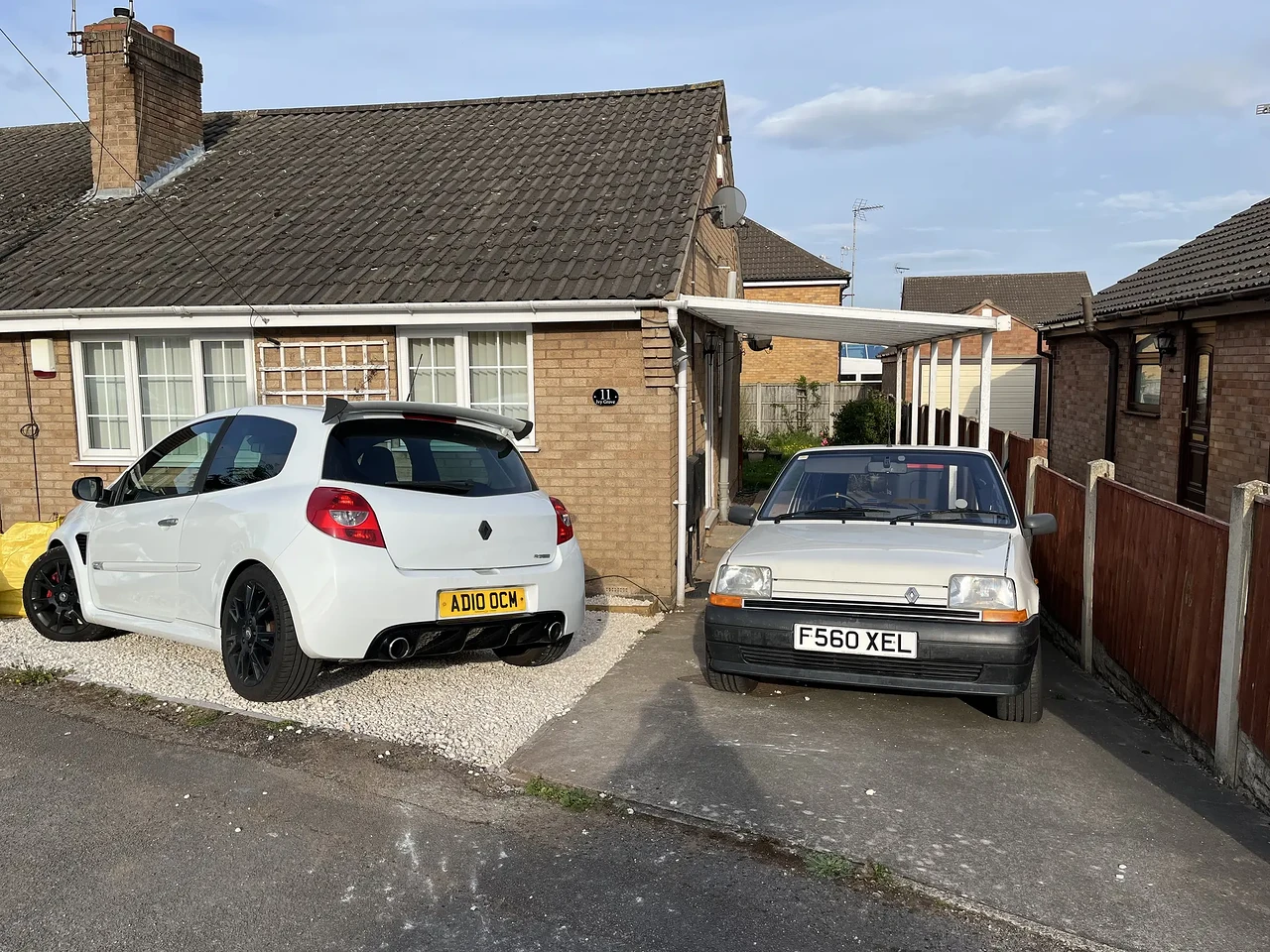

Continuing with this, bit of a back story (May 2019)

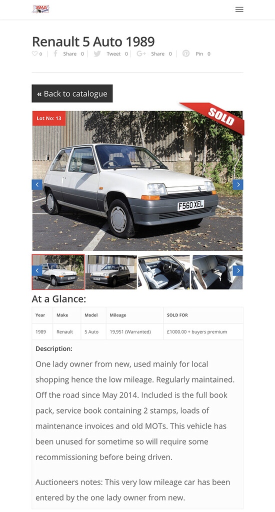

After breaking my mk2 golf 16v turbo, splitting up with the ex and selling my Clio 172 cup I decided to indulge myself with another financial mistake. Looking through eBay i
Found a young lad selling a Renault 5 auto for £500 in an auction. Having chatted for an hour we agreed on £1000 and that he removed it off eBay if the car was emaculate!! He said that he’d bought it for £1000 from a local auction and it had only had 1 previous lady owner.
It had plenty of paper work and drove like a dream. I kept it standard for about 2months before I decided to molester it. Once a ph1 clio 172 donor was found the conversion was done and also fitted GAZ coilovers with some turbine alloys. Unfortunately I’ve lost loads of photos over the years and I’ve only got this one.

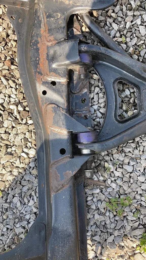

After about a year of owning it I killed a gearbox, bent a selector fork which gave me an excuse to have a fresh box with a quaife. I know mark “northloopcup” was only down the road so I got him to build me a box and fit a diff. Whilst I had my box done I thought it was time for some more upgrades. The campus subframe, arb and rear axle werent upto the job so decided Togo R5GTT Instead. Tony Hart was selling one of his reinforced and seam welded subframes with all the poly bushes for £200 and it’d be rude not to fetch it seen as he only lives 20mins away.
Obviously i stripped it down, painted it before rebuilding it with fresh ball joints. Once the gearbox and the gtt subframe fitted with some vibra technic engine mounts. the campus drive shafts werent long enough possibly to the fact that I use Clio 172 hubs. After afew trial and errors, I found that I had to use a Clio 172 tripod coupling on the OS driveshaft to solve this.

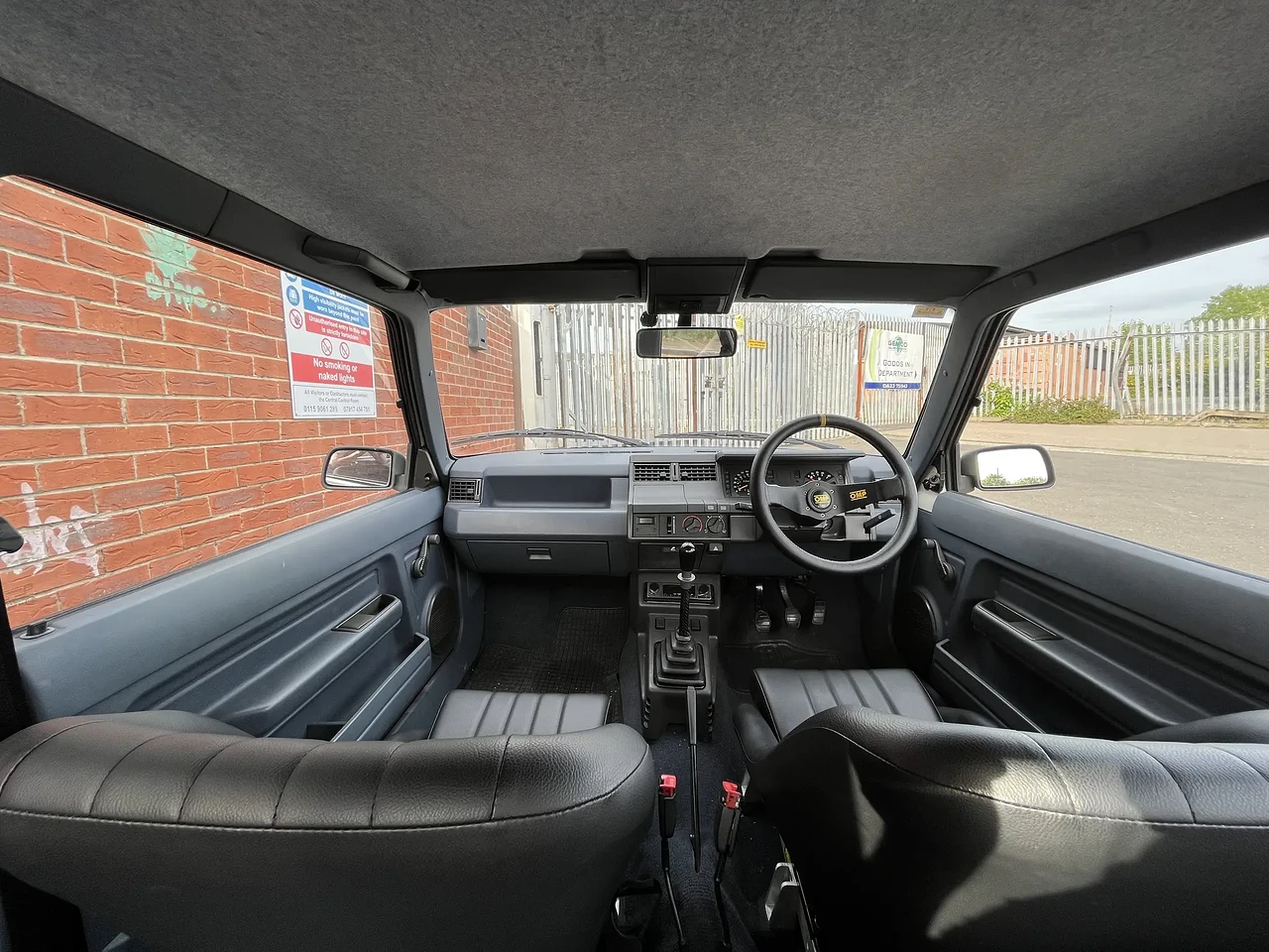

After fitting the Gtt subframe from Tony at prima, Williams torsion bars, rear disc brakes and a fresh jc5-129 with a quaife from northloopcup the car was handling amazing however. Because I still had standard seats I literally couldn’t drive the car fast due to me sliding about! I wanted something that looked cool was comfy and suited the sleeper style I was going for. I saw a that a local business were doing a sale in cobra seats and thought I’d have a nosey and I literally fell in love with the cobra classics with no headrests. Including the OMP subframes and sliders they cost £550. Whilst I was at it I thought I’d splash out on a OMP steering wheel and a PMS shifter just to tie it all in.
Once these were fitted I could actually feel how good this car actually was. The seats are absolutely amazing and everyone always comments about how awesome they look. I will get them retrimmed at some point just to so the front seats and rear bench match.. The car stayed in this form for about a year due to me buying the meglio, killing its engine… having a new forged engine built then mapped and also moving house.

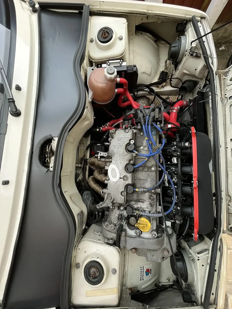

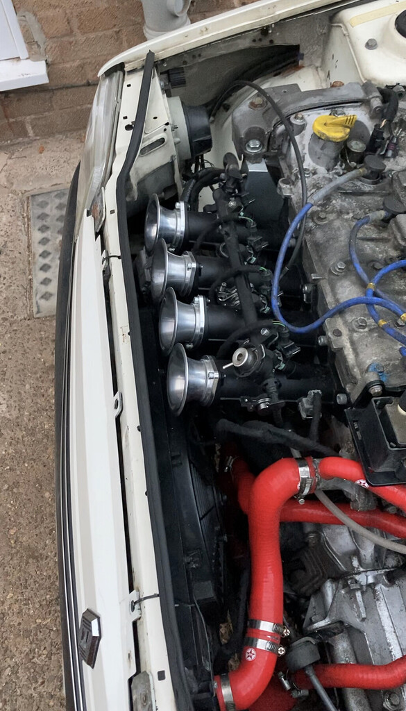

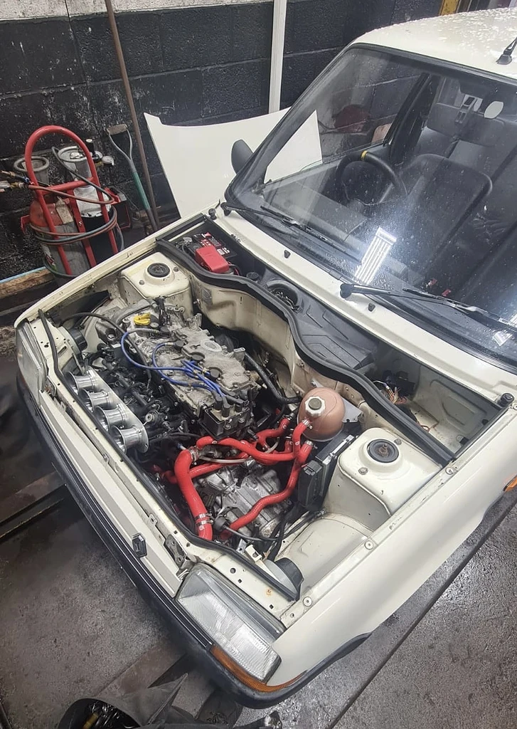

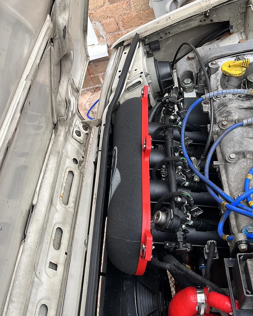

Once I heard the ITB’s on full chat I knew…. 100% knew I had to have some and then a week later, a second hand set come up on cliosport forum for £1800. The kit included the direct to head itb’s, Ktec filter (which is garbage) Clio 197 injectors and the plug & play gen90 ecu which had a base map on it. I had a word with Dan about the loom as some of the pin outs need changing from the standard ecu to the gen90 and he said he had a spare Clio 172 cup loom for me that was already made up. This would be loads better for the Renault 5 as the ph1 Clio 172 loom I currently had was basically loads of terminated wires for stuff like abs, air con, T/C etc. I can honestly say sometimes, Dan is an absolute legend and said he’d fit it all whilst I was away with the new missus which I proper needed!!
Once I got back from my first holiday in 3years :eyes: I started to tidy up the engine bay. I saw on Instagram someone was selling scuttle tray covers. As I still had the original battery it wasnt going to fit so I purchased an odyssey pc680 and a battery tray. Redid the battery fuse box and replaced the ring terminals on the lives and earths.
The trumpets that came with the kit were 70mm and too long to fit any air filters so I had to ordered shorter trumpets (35mm) ITG filter and backing plate. The filter just squeezes in with just enough room to remove it.
Still got plenty todo before it goes to EFI Parts at the end of May. Paint the rocker cover, fit a PMS breather plate, oil catch tank, set the cams to Group N Timing and a new expansion bottle as mines gone brown
Can’t beat the sound of Itb’s.

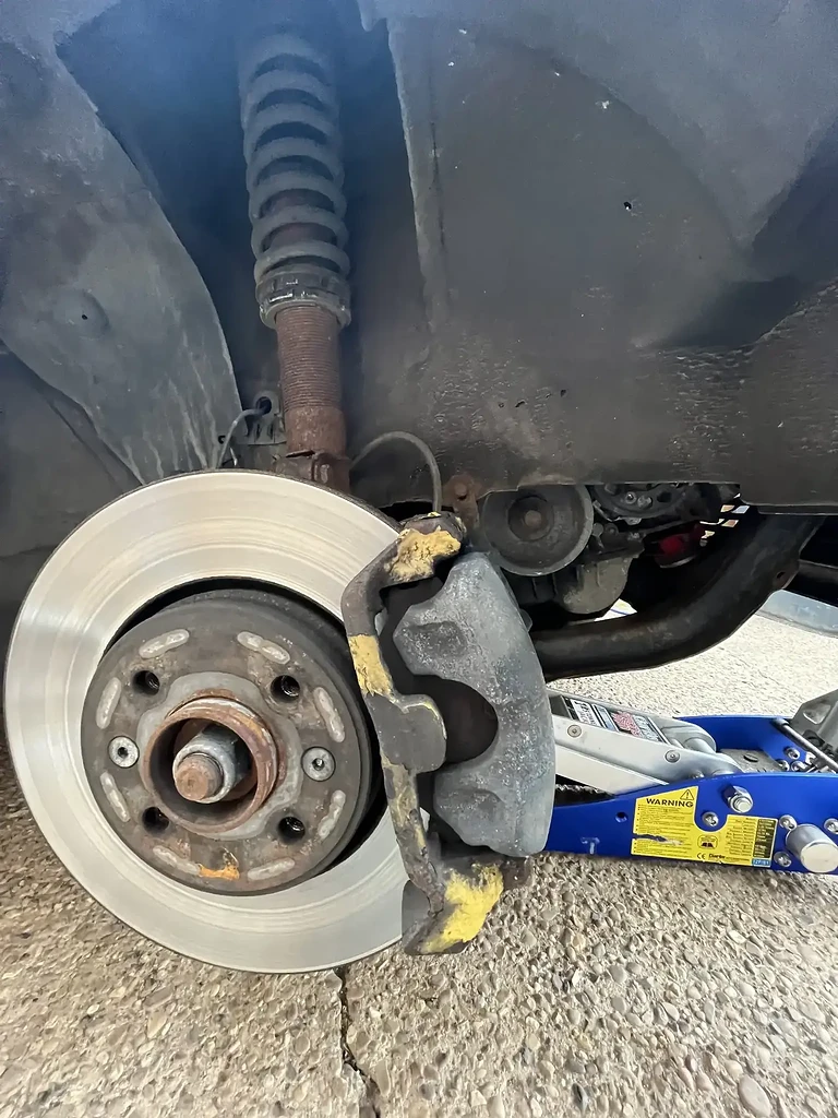

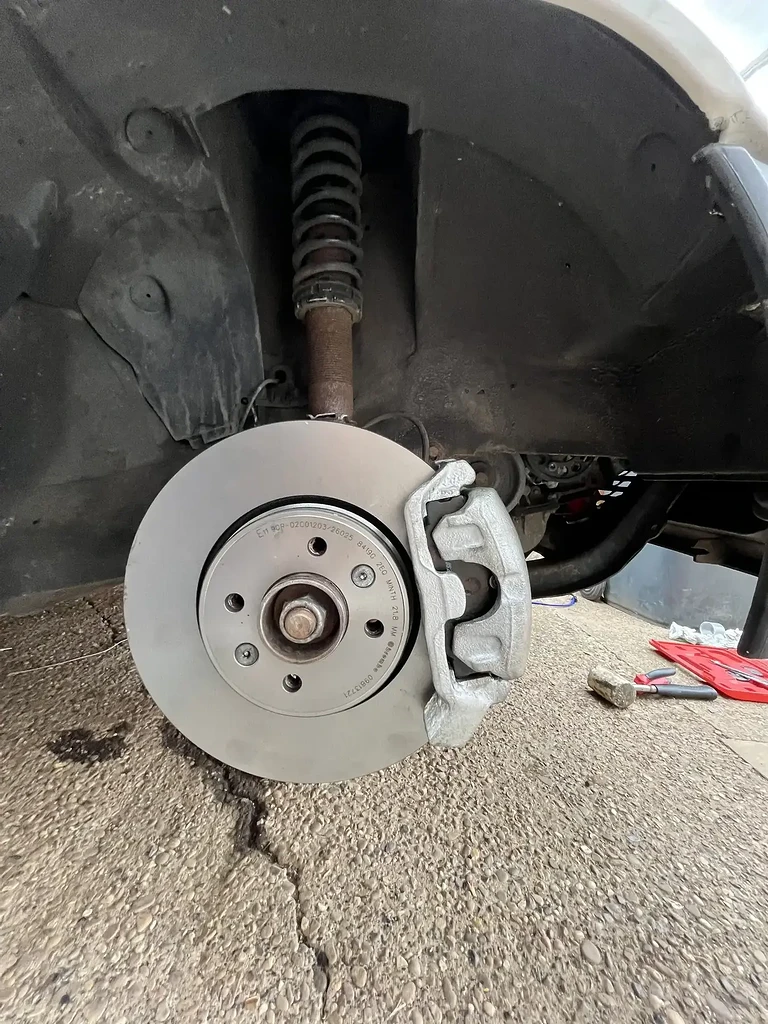

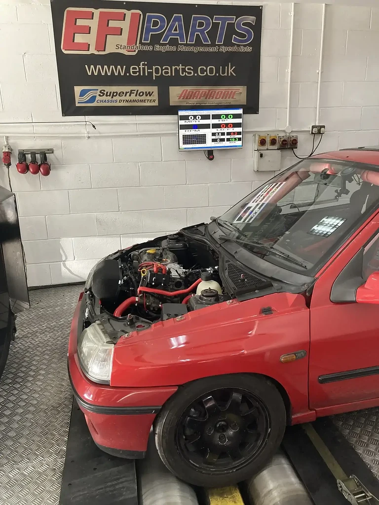

So after bombarding you lot with loads of posts I’ve actually caught up to today. As I’ve said before the renny 5 will be at EFI Parts at the end of the month and I always like to make sure my cars are spot on for Chris. Me and Dan are regulars as some of you have seen off my Instagram and we’ve had to help him afew times get other customers cars off the rollers because they’ve either got flat batteries, knackered starters or other issues and I would be embarrassed if that was me but anyway. I’ve been using PBS pro race pads and they’ve warped my front discs!! This has actually happened on the meglio too (which I’ve changed the pads to ds3000’s) so it’s time to refresh my front brakes!
Purchased some ds2500’s and Brembo high carbon discs. I’ve used these before and we’re pretty good. Reason why I bought the pbs pads were because they were only £100 which I regret buying now!!

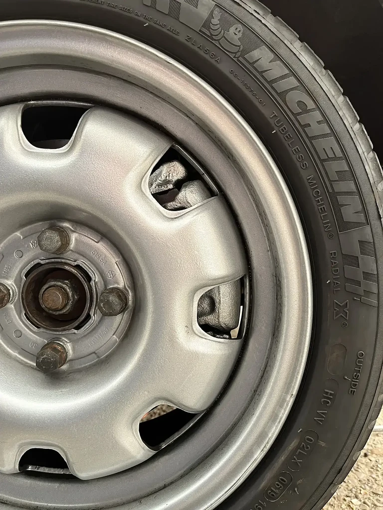

My 172 callipers are looking nasty so though I’d spray them up in “sleeper silver” just so that look like standard callipers to any joe public who ain’t got a sharp eye :eyes: for anyone else who knows there stuff can see my PMS billet pullies :ok_hand:t3:
These look loads better now and glad I’ve spent today doing it. One thing that does catch me out every time though is that brake pads always come way too thick and I’m having to grind them down… does anyone else have this problem or am I stupid?? Another job for tomorrow is to have my wheels balanced as I noticed a bit of wheel wobble when I took it down the motorway and I don’t think I can handle that all the way to Liverpool.
None the wiser of what hides behind these steelies :shushing_face:
Which front discs did you use? 5 gt turbo list 20mm thickness new and 172 24mm new
Never got close to 172 calipers on the 5 but could it be this? No idea on hub mounting position with 172 calipers?
Looks much better sprayed :wink:
