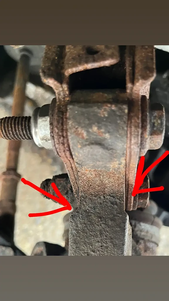

Im using Clio 172 hubs. They’re literally beefer version of the gtt hubs. Only issue being is that I had to use a mix of Clio 16v/gtt shafts and a Clio 172 coupling. I guess the offset on the inside of the hubs is greater than the gtt hubs?? :man_shrugging:t3: Only other thing to make them fit is to machine the tab where the coilovers bolts into as this is about 4/5mm thicker. You can see here where I’ve had the tabs milled down a couple of millimetres either side:

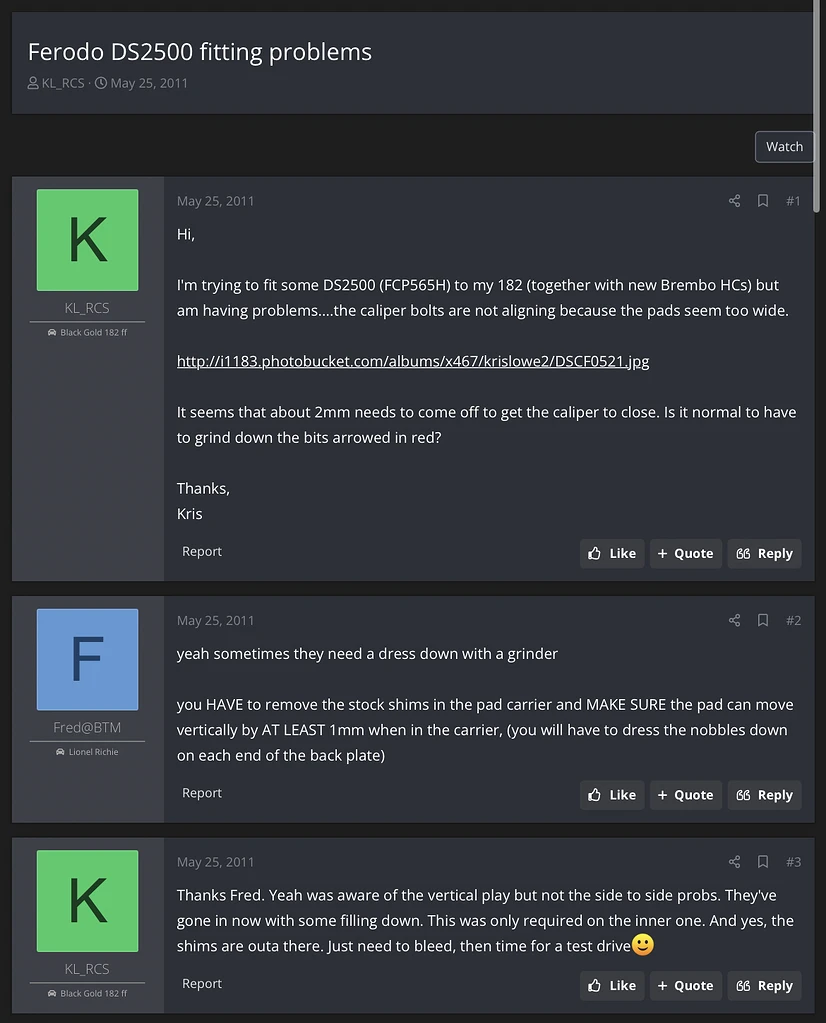

Read through cliosport forum and I’ve found that there’s been many other people having fitting issues with Ferodo DS2500’s so I’d though I’d just post it on here just in case anyone else on here has a similar issue.

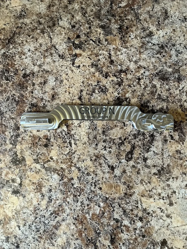

Took the car to my mate garage to set the timing to Group N with the standard 172 cams… usually this is a do it at home job in a Clio but because the engine is so close to the suspension strut the engine and subframe needs to be dropped so it’s a lot easier todo it in a ramp. Whilst doing that put in some fresh oil and filter.

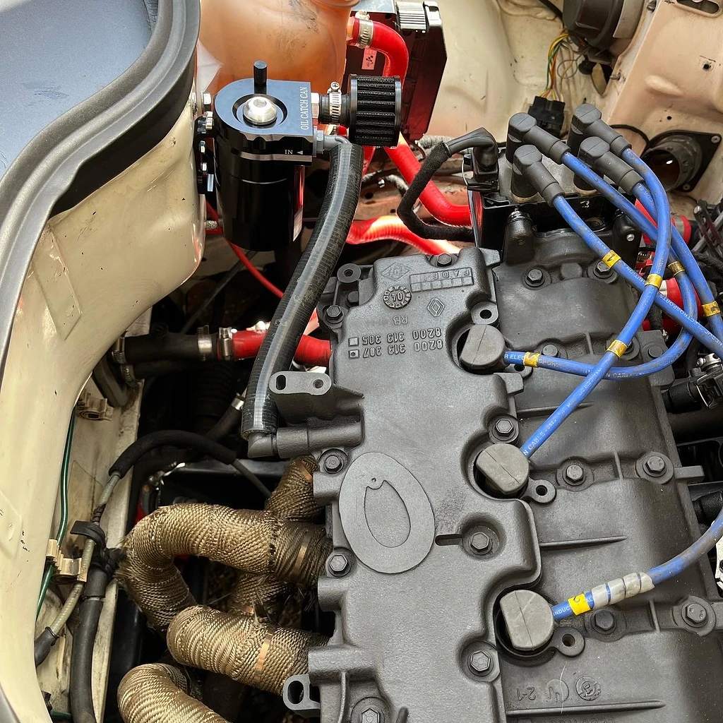

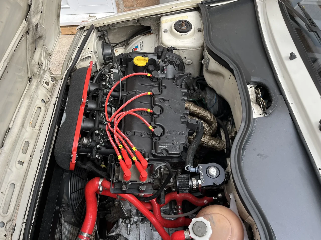

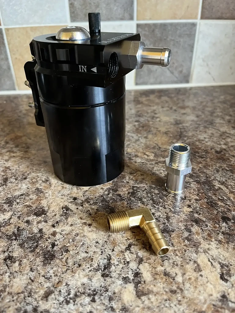

Finally got a cheap oil catch can and the correct fittings. And after a 3 MONTH wait my red HT leads have finally arrived!!

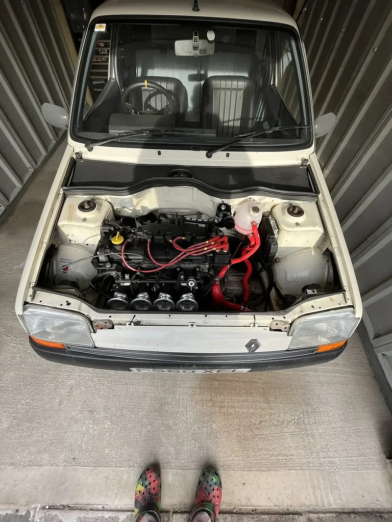

The red HT leads tie everything together…. Just a few loose ends but nothing that can’t be sorted at a later date. Hopefully everything will be sound tomorrow and me and Danny should have a good day as both our cars Renault 5 and mk1 clio both on ITB’s will come out with good figures at EFI Parts!!
Looks super tight to get in the cambelt side in the gtt bay.

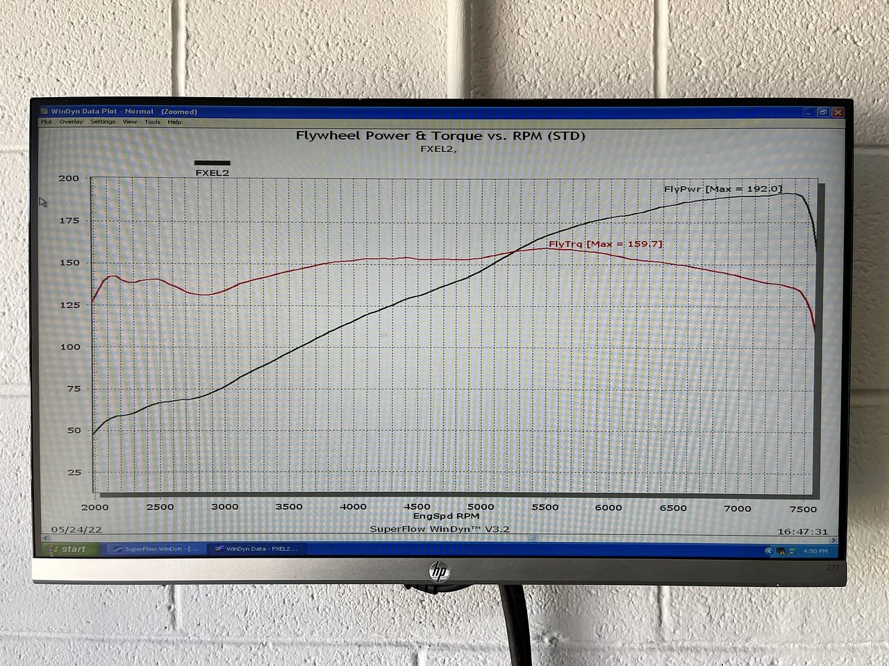

Keep us updated on power figures. My guess is 200hp
I’m hoping for 200bhp-ish and 170ftlb but some low down torque seen as I’ve kept the standard cams but went Grp N timing :crossed_fingers:t3:

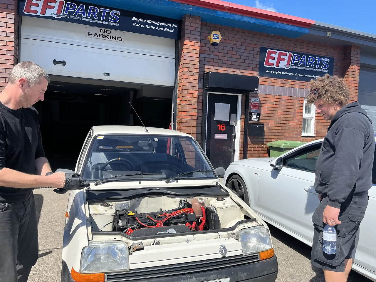

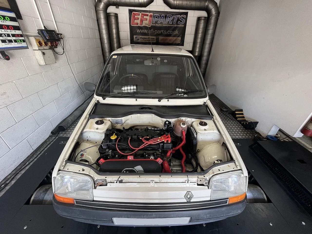

EFI-Parts….

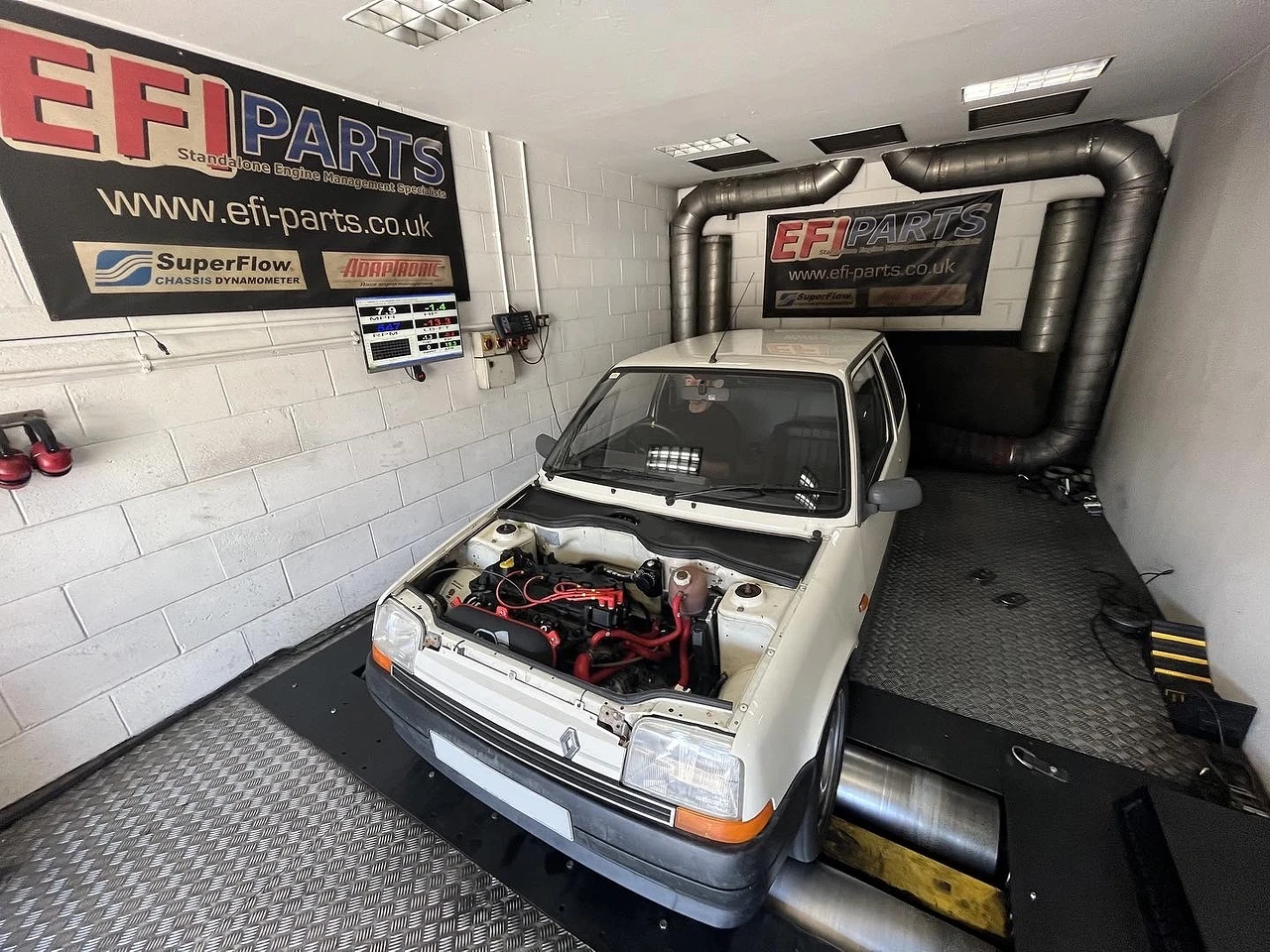

The day has finally arrived. Me and Danny had our session booked with Chris at 3pm on Tuesday so we both thought that it would be better to turn up abit early and just check everything before both our cars went onto the rollers due to the fact it’s bang on 100miles door to door. Mine was in for a full map due to the ktec-jenvey kit coming off an unknown engine setup and Danny’s was a slight tweek from swapping his 197cams to cat cams-421’s.
The renny 5 was first as we knew it was gunna take Chris longer…. After about an hour Chris said that he was struggling to get anymore than 170bhp out of it. He asked to remove the air filter due to the fact it might have been choking the itb’s. Not long after it started making +190bhp. Due to the fact that the trumpet length is only 5mm smaller than the internal height of the air filter it choked the engine from getting any air!! It made great figures though being an £250 unknown mileage engine on Group N timing and itb’s.

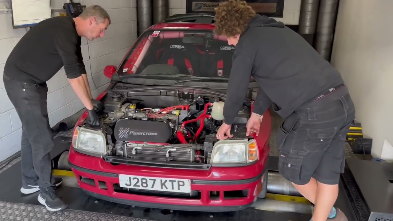

After mine was done it was Danny’s mk1 clios turn. He has got a big spec on this track car. It’s a ph1 172 engine with 197 crank, rods, pistons and valve springs. Cat cam 421’s, Clio 182 manifold and the same ktec-jenveys and Gen90 ecu that’s in my Renault 5. Last time it made 209bhp so he was hoping on bigger power torque curves…
Lower black/red lines are Clio on 197cams and higher black/red lines are on catcam 421’s. It’s made that car so torquey and has massive midrange and loads top end. Also before we set off I took the Renault 5 to the local weigh bridge and it came in at 840kgs!! This means now that it’s pushing 228bhp/tonne!!
Also done a video which I will upload tonight… I’m happy with the results as usual from EFI and Chris is always brillant. The engine will get a refresh as he did mention that he had to add extra ignition timing which he reckons is probably lost compression. I’ve got 197 internals waiting to be fitted this winter and I will be back next summer at EFI to try and break the 200bhp mark.

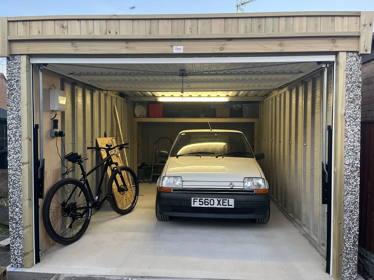

Small update…. Put about 200 hard miles on the 5 since being mapped at efi and it’s not missed a beat! It’s never been this good I’m proper chuffed with it! I was literally debating boosting the old setup because I’d heard mixed reviews about ITB’s and I’m glad I’ve gone this route!! Had a prefab garage built so I can keep it dry through the winter months and get the engine refreshed rebuilt for next summer.
Because I’m renovating my house aswell as building a new garage, keeping two project cars and paying for holidays I didn’t have much spare cash to having anything bigger than this. I’ve built a large storage shelf for “Renault spares” :rofl: wired it up myself and just boarded what I needed to for the time being. Whilst I was sorting the garage I’ve also been sorting new engine parts into new boxes for the next engine :eyes:

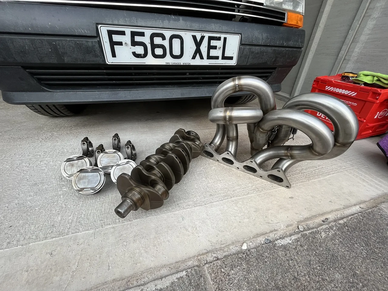

Pistons, rods, arp bolts and crank from my old clio 200 engine (now meglio) which will hopefully make my engine higher comp :folded_hands:t3: Seen folk getting 12.5:1 compression in 172 engines so should be aiming for +200bhp and the PureMotorsport manifold which I’m still unsure will fit?!?
