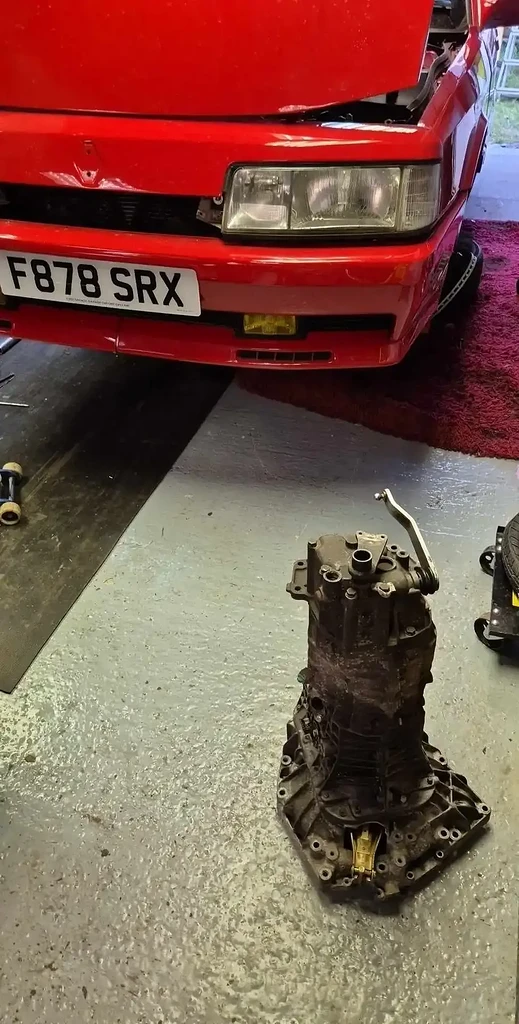

I’m not very happy with the gearbox, it crunches into third and theres a funny whine on decel in 2nd. So now thats going to have to come out for a rebuild!

Gearbox is out and away for rebuild already, went for the full treatment including blasted casings.

Only what it needs. Likely itll be a used good 3rd gear one, I can get new but i’d have to buy the 3rd, 4th and 5th gear rings as a set. The guy doing it is a retired UN1 specialist, he made a living off these things for many years mainly on the GT40 & kitcar scene and still does the odd one for old contacts out of his home garage now. He has quite a reserve of parts so I think it’ll be OK. I told him to rebuild it and replace anything out of tolerance or worn.

Box is back, turns out there was a whole load of issues inside with mismatched gearsets - whoever rebuilt it didnt really do it very well!
Now reassembled with a lower final drive and a longer 5th gear from a R25V6 Turbo :slight_smile:
