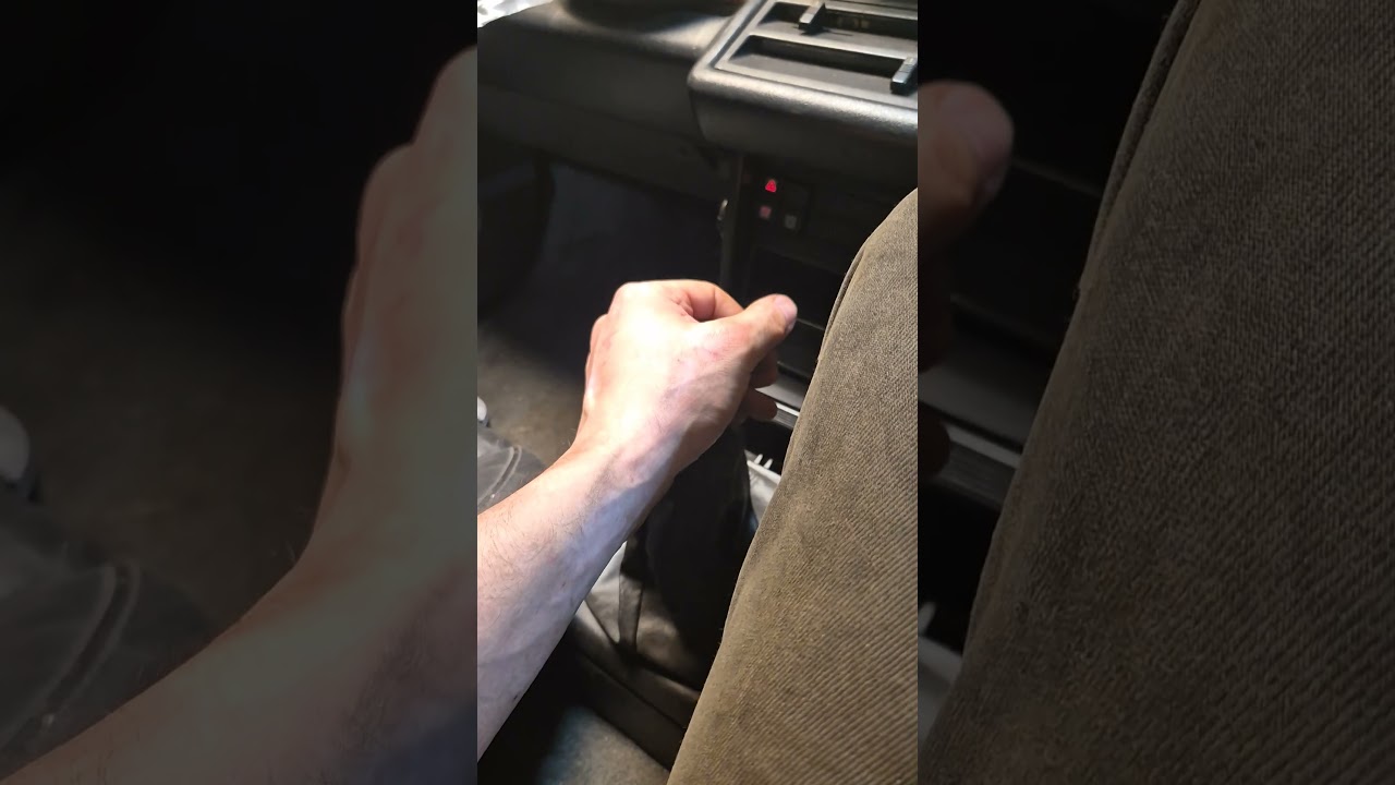

Connected up the minimum and tried it, slots into 5th. Win! - or so I thought. Rebuilt basically everything save putting the wheels on.
Listen and tell me when you know. You’ll need sound.
Racked off level = 4,975,490 / 10
Fancy giving it a go Steve? Stuck for options now.
I’ll speak to Rob tomorrow show him the video and see if he has any ideas or knows someone that knows these boxes.

Did the guy not tell you he’d made 5th straight cut :thinking:
Having 2 balls and a spring in the Detent hole was probably the non select fault, easy to do if you get distracted at the wrong moment, and will effectively lock it in or out of gear as the spring will be coilbound with the ball in the detent, no chance it is retracting to allow movement.
A warning to all of us, is to physically check you get all the gears on the bench before fitting, The irony would be it could have been checked in the car and repaired in situ. Definitely one to learn from.
HOWEVER. The noise can really only be coming from the 5th gear pair, It’s quiet in all the other gears, meaning all the bearings and gears are ok, just 5th pair and only when transmitting drive, they are quiet when idling round when the box is in any other gear.
One gear is fixed to the shaft, so that should be OK, for any unwanted movement, the other runs on a needle bearing, so it’s possibly worn, but highly unusual. Leaving the gear teeth themselves.
If it’s 4 wheels away from a road test, I would try it, mainly to see if it is only noisy on drive, or is it on coast also.
@Andyquadra joked about it being straight cut, but it covers what is being heard here.
I’m sitting here racking my brains trying to remember if it’s possible to fix the fixed gear backwards, I’ll need to dig a pair out and see. If it can then it has mixed the coast and drive faces up. It should be noisy on both drive and coast.
That’s as far as my thinking takes me.
