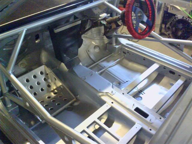

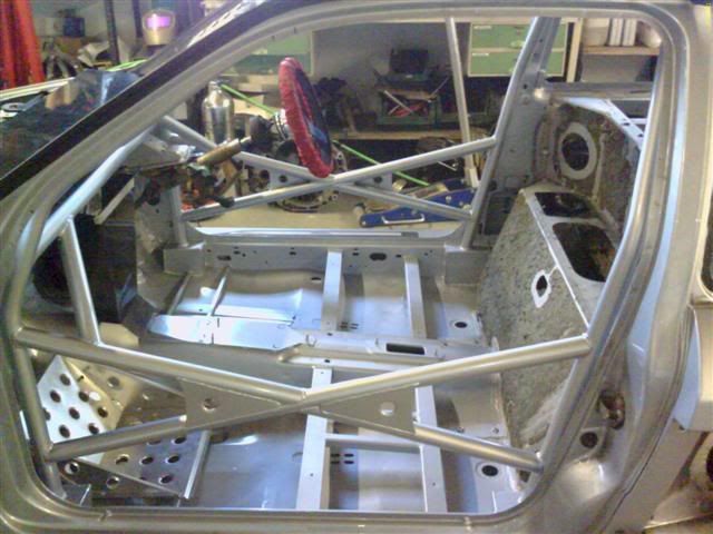

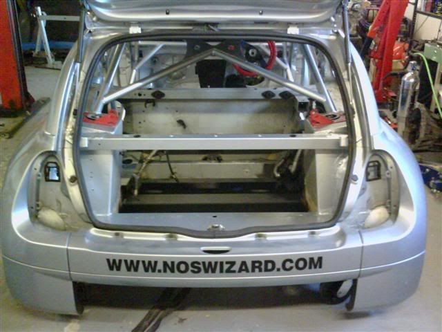

TRW1 Roll Cage PAINTED
TRW1
Starting to look better. Carbon dash and centre consul to go in.
Car will start being rebuilt now.......

very nice...is the carbon dash made using an original dash mould..or is it a totally different design?!
It's just a very simple flat sheet with a culed lip at the front edge and will sit on top of the roll bar. You can just make it out from the pics as it's sitting loosley on top.
Not an ideal swap for your existing setup I'm afraid Colin.
