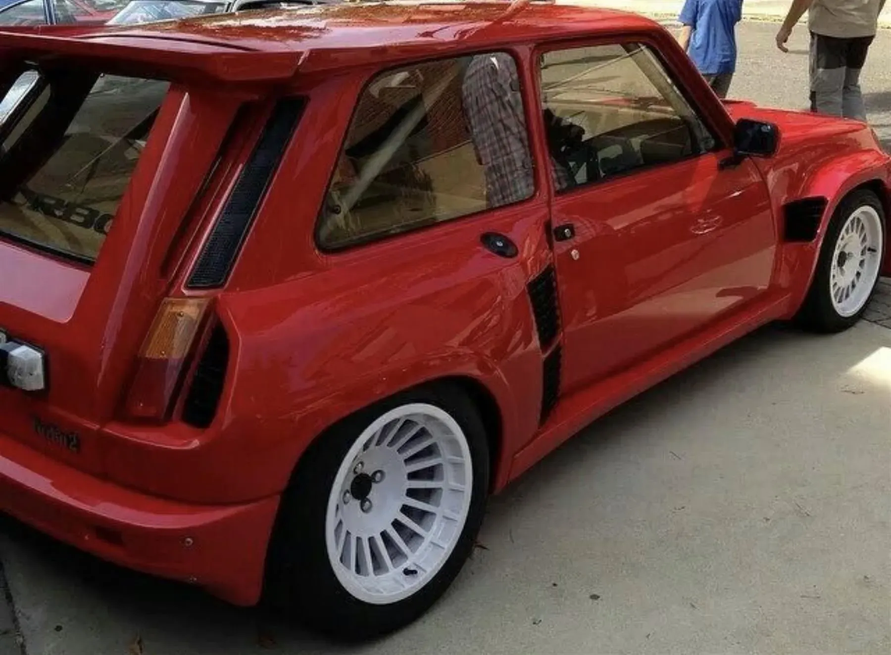

How fricking much, stole my concept and design lol
Also lotus and vx220 engines are not going to really stand out imo - be far better to have in said lotus flavour, not exactly ugly cars and look special already
It's certainly not a 'given' mine will drive like a 'lotus' but should handle well and plenty of scope for fine tuning. Definitely going to be an interesting mix with extra height of 5, hoping weight will be sub ton still not that far off but maybe ends up a fatty lol
The core ingredients are correct but does not mean it will taste fantastic
but might come out perfect
I have worked hard on chassis positioning, setup to avoiding giving myself problems to fix later on, one step at a time mind. Also my own changes of increased 50mm width of pickups all round to allow engine in, meant increasing wheelbase. The % increase changed lotus wheelbase to exactly same mm as recorded GT Turbo......meant to be or just random coincidence.
I also decided against full on turbo 2 maxi kit as mine is a Mk2 5 so not even a proper copy of original, they look epic but trying to be something it just is not and cost going different route
