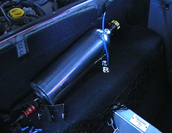

Mine is on the shelf with 2 seats in and on the passenger floor when 1 seat is in. Ideally longitudinal is best but the shelf is fine. I wouldn't try the boot, even if it fits, as there's too much heat from the exhaust that will play havoc with your bottle pressure and could be dangerous. There is a dip tube inside the bottle which should be pointing down to the rear of the bottle when placed across the car. That way when you accelerate the liquid is forced to that side of the bottle and there is better pickup.

You could experiment with the temps in the boot....(if the bottle fits!!) Maybe an insulating blanket would help. The problem is, if the bottle gets too hot, the pressure will rise whereas you should be jetted to about 900-950 psi. Anything above this and you will run lean with all the dangers that entails. I assume you have a bottle guage? Stick it in there and see if the pressure shoots up. Try it also when in traffic so there's no airflow either.
You could fit it in the front but that means running a very long line. Lots of people with front mounted engines stick the bottle in the boot though. I've seen bottles mounted on top of the engine covers, along the windows, a bit unsightly and lethal in a head on crash as they would come at your heads like torpedoes I imagine. Is there no way to mount it above your sub and amp build?
