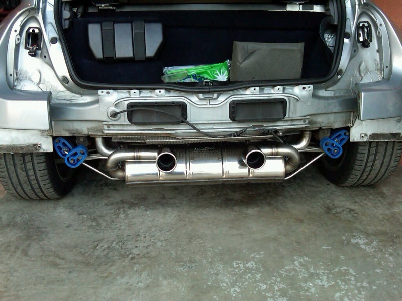

Going to try and fit this over the weekend,
and just have a couple of questions.
It's come with two 48mm u-clamps but am I better off getting some 'clam-clamps' as per clamp ?
Is it a good idea to replace the original rubber mounts (e.g. with mount) or will they be alright?
I might be wrong but do you need different downpipes and collector box for the janspeed system too as the backbox won't bolt straight onto normal collector?
I do have two link pipes if that's what you mean?
Can just about see one behind the backbox in the pic
I've just had one fitted!
I bought original clamps from Renault which were £8 each and 4 of the blue rally design mounts that you've shown!
It's all you need and will go on no problems :approve:
That's what I wanted to hear :)
Although I stupidly only ordered two of the mounts, doh!
Changing the tips is something to bear in mind...
Mine was £330 from DCPerformance, but just checked and it's gone up to £354! Seems to have come direct from Janspeed mind.
should fit straight on gregg, i' advise removing the bumper etc, will mate it a lot easier to access etc. i fitted my side pods this afternoon and did a couple of other little jobs on the vee :)
