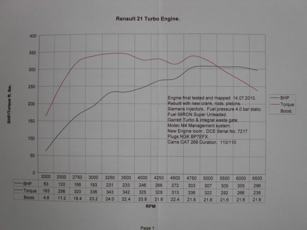

It is a very serious engine and so is the 8v 21T engine that I built for John.
Engine spec is
Renault 4 cylinder 1995cc J7R 720 aluminium block with under piston oil jets & modified to accept turbo oil return feed.
Standard crank lightened, balanced & knife edged.
Standard con rods balanced. (Serdi)
Super Ductile liners (Westwood)
Forged pistons, 8.1 compression (Wossner)
Renault 21 Turbo cylinder head, bigger 46.6mm inlet valves, uprated dual valve springs, dural caps, (Ferry Developments)
Camshaft 268? duration (Cat Cams)
Vernier camshaft pulley (Cat Cams)
Inlet manifold (21 Turbo)
55mm throttle body (Renault 21/25 TXi)
Plenum (Renault 21/25 TXi)
Injectors 660cc (Siemens)
3 Bar MAP Sensor (Ford)
Turbo (Garrett GT2860RS dual ball bearing)
Double piston dump valve with 25mm neck (Collins)
3 way boost control valve (Motec)
36-1 crank timing trigger wheel & sensor (Motec/Marelli)
Ecu (Motec M4)
Engine loom (DC Electronics)
Stainless steel exhaust manifold (FBI moteurs)
3? stainless steel exhaust (APT)
3? stainless steel silencer (Borla)
Steel billet flywheel (TTV Racing Components)
200mm clutch pressure plate & twin friction disc (Sachs Racing rated @ 480 ft/lbs)
http://i664.photobucket.com/albums/vv3/Andyquadra/PICT0219.jpg
But as the saying goes, if one needs to ask, one can't afford
Andy
Definitely this!
360bhp shown on a proper engine dyno. Not only that but look at that torque spread!
