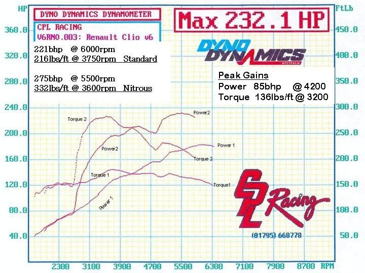

It's always bhp people look at but I'd rather have more Torque.
Tim's 240ft/lbs is impressive against what standard cars really make and is why it's so 'quick'
Generally, bhp will improve your top speed and torque will improve your acceleration.
When I had a 50bhp nitrous shot my peak torque was 332ft/lbs@3200rpm. [smilie=icon_eek.gif]
Graph shows figs at the wheels.
