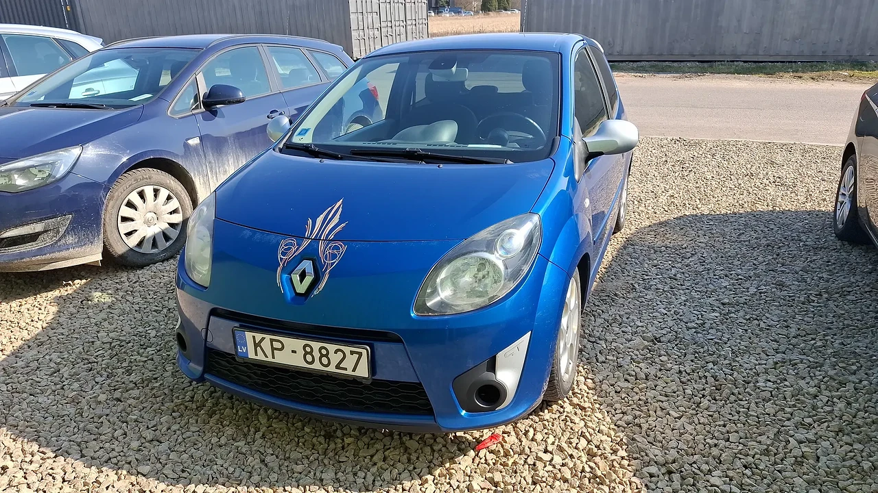

And here comes the first question, if someone picks it up…

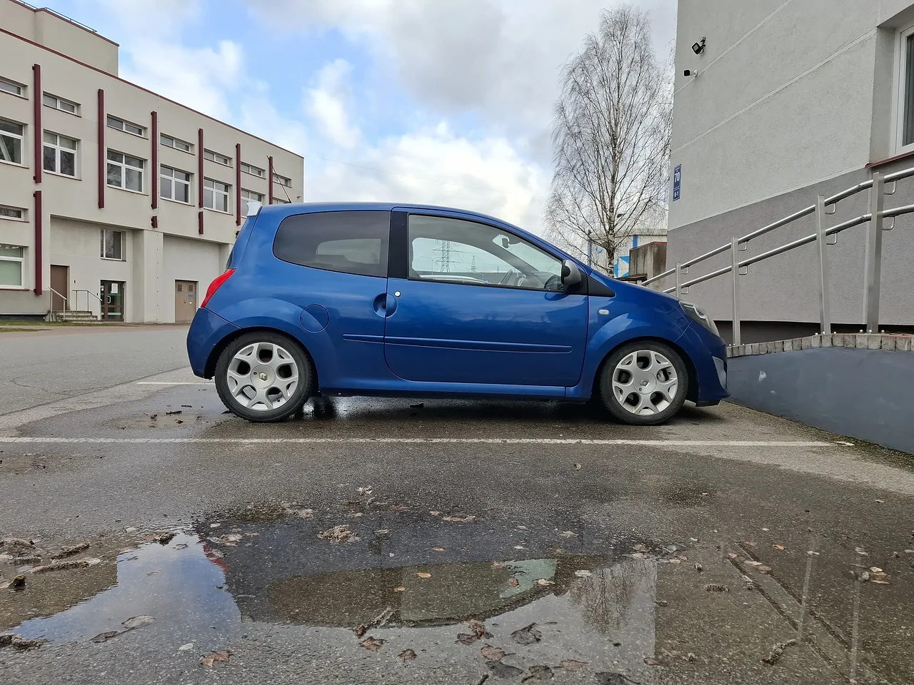

Should it be that low? Or I should expect lowering springs or some broken ones?
Will get it up on the lift, but don’t know how soon.
It drives ok, just from pictures on the internet, stock seems to sit higher.
Tires in picture are 185/55 r15.
Yeah thats too low, its modified or broken!
Ok, will brace myself for suspension job then.

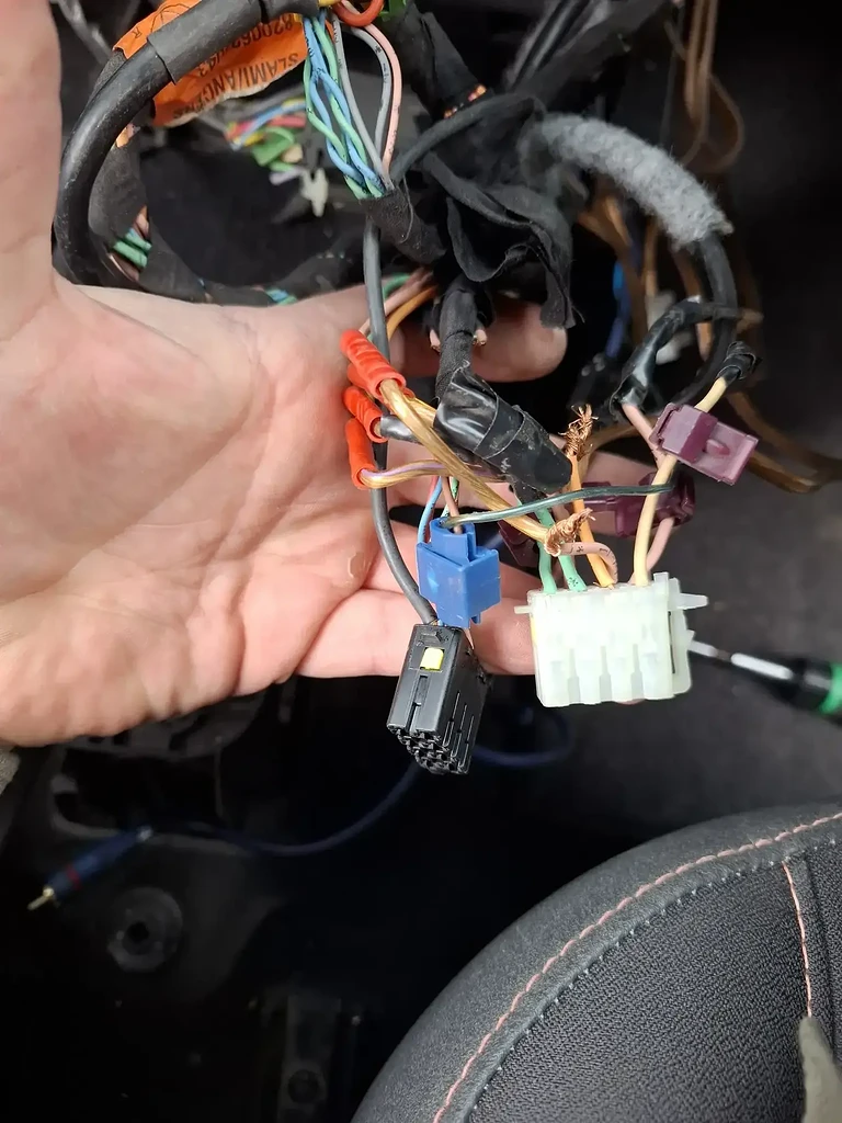

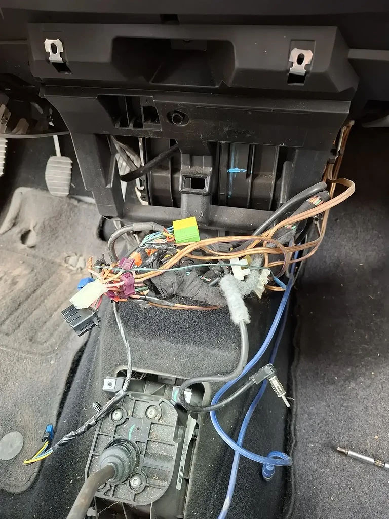

Took out existing head unit and found a rats nest of wiring. To get to it, tore down lower center console around shifter.
And then some trim in the back and around sill as well. At least, it is all simple and easy.
But yeah, audio situation is not great. Previous owner has installed pretty decent speakers, but even there he has brought wrong combination.;
It has 13cm midbass drivers and tweeters both front and rear, but those are not component sets, just separate speakers. So, no crossovers. And they are just wired together, directly from head unit, with different size and numerous times extended wiring.
Also wiring on the car side is butchered near the connectors.
After doing some research, I decided that as good as these speakers are, they don’t worth the effort to wire it all properly.
So, will try to sell them, get some off the shelf component set for the fronts and maybe will do rears later.
And of course, I need to fix all that wiring mess properly, so it’s no longer a fire hazard.

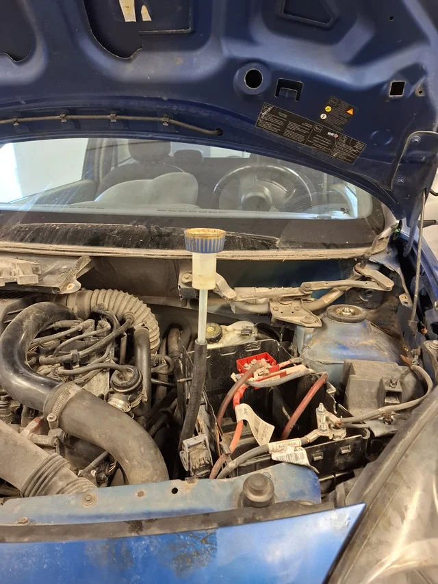

And another question is - where do I will the gearbox oil? Some of it came out when driveshaft was removed.
And if I will put in 75w90 (cause I have some), will it summon Chtulu or something, or be just fine?
Oh you poor man.. the state of that wiring :roll_eyes: the previous owner wasn’t too kind here it seems :sleepy_face:
There will be a bung located on the side of the gearbox. Usually the side facing the rad, itll be plastic usually. The fill level is usually when it starts to drip from the gearbox fill hole (providing the car is level and not jacked up one side say)
But if in doubt refer to the manuals on here bud as they’ve got alot on info in them

As you know, when driveshaft is pulled, gearbox oil pours out, so changed that as well.
With some creative solutions for filling backup, cause I’m to cheap to buy a syringe.

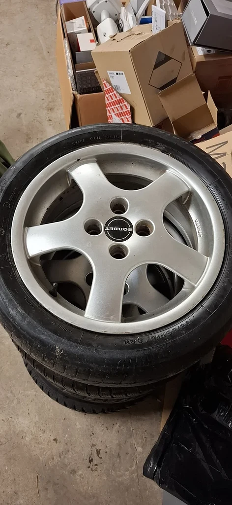

Also got some borbets for scrap price, will keep them for summer. For now, wrapped stock wheels in some 195/50 winter tires.

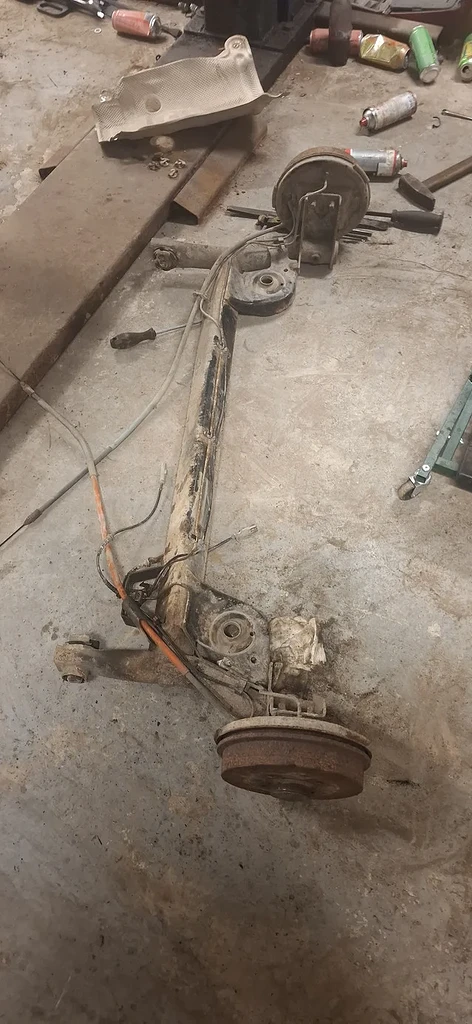

In other news - decided to check, what is going on with rear brakes, as car seems to roll quite stiff.
Now I have stuck drums, which are not coming off the stub axles and right rear bearing seems to be gone.
Oh fun times.
Allright, will try and see for myself then. Price difference is almost double, so it’s worth trying.
Oh fun times.
Got the drums off today, using some long bolts to push them.
At first sight it looks fine, but really, it’s not. Wheel cylinders are fine, but other stuff is bad - shoes, drums, bearings, adjusters are so so.
Before I start buying stuff - is there an easy way for disk brake swap?
And regarding drums - by part number, those are different than Clio 2. Are they really different, or still interchangeable?
