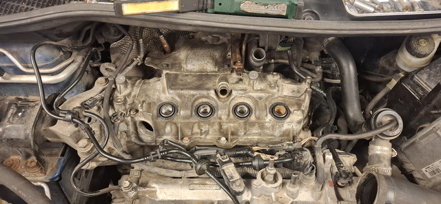

Did some deferred maintenance as well.

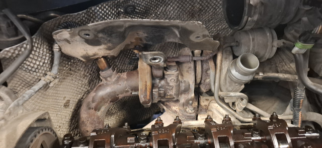

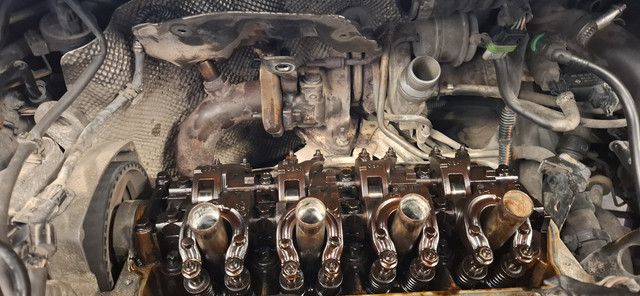

Replaced spark plugs and leads, adjusted the valves and replaced valve cover gaskets in the process.

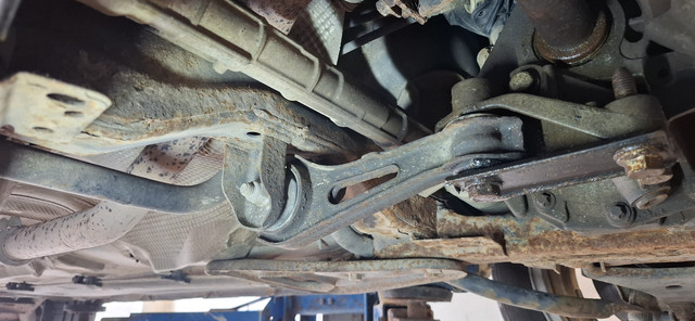

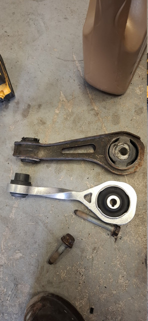

Also, replaced all engine mounts. Mine still had stamped lower mount, installed the aluminum twisted one.
And, while trying to replace right axle seal, found out that right outer CV joint boot is torn and is spitting grease.
With second try, managed to get the one that fits. But as I was not able to get the joint separated from shaft, had to do it from the other end.
Hence, repacked the middle joint once more.

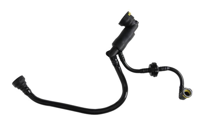

For some time I have a broken PCV (?) pipe, that from time to time snaps off.
Just before that filter thingy.
Hence question - what is that? One way valve, or what?
Cause original part is quite expensive and I was thinking about replacing it with just a regular hose.
One way valve for crankcase re breath, age/heat harden and snap, cause irregular idle, I’ve glued and put heat shrink on them, bet you can get generic and replace, it’s the valve that goes brittle, pipe is tough stuff
