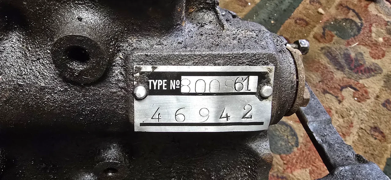

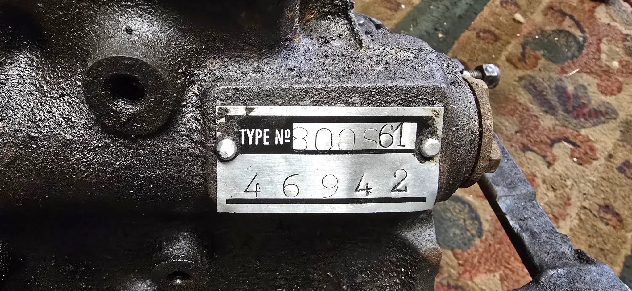

Hi Adey, well I never expected that car to be on your drive, so regarding engines and gearboxes as upgrades, there are various restorers on the web who fit 90 odd bhp Ren R5Gordini 1397cc atmo units, there are also 5 speed boxes from GTL units etc. which fit as well.
You could in theory fit your R8 1397cc Engine back to front into the R6 engine bay, options are good. The engine ancillaries need to be handed to the clutch end. The inline R5GTL 1289cc unit is quite peppy if you can find one!
The Ventoux 845cc can be “Gordinised”, 904cc pistons are readily available sporty cams [Salv] bigger valves, around 60 bhp is achievable, dont forget these standard little units rotate the opposite way to rear engine installed 845cc versions.

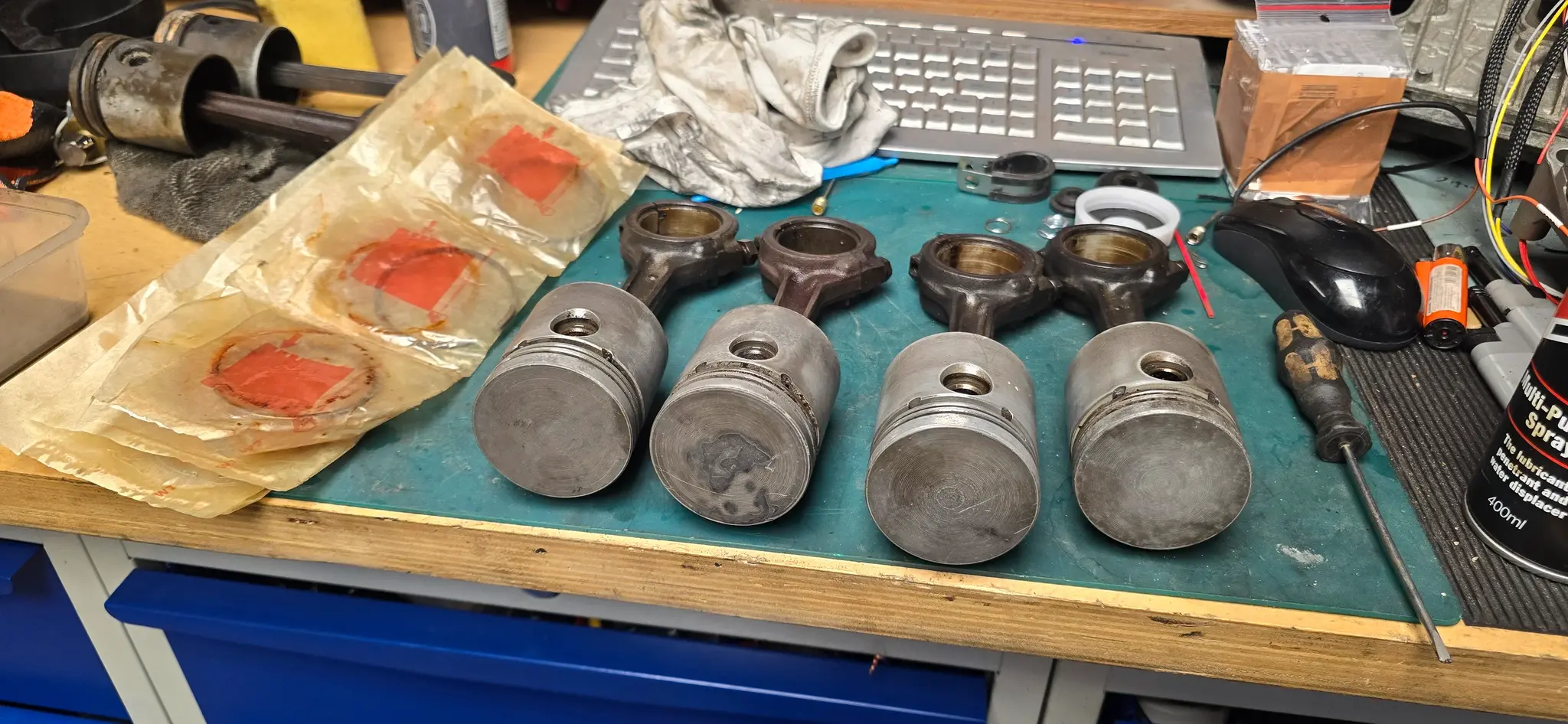

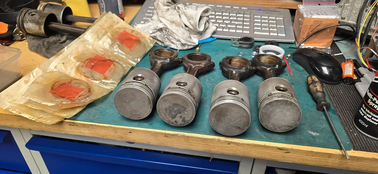

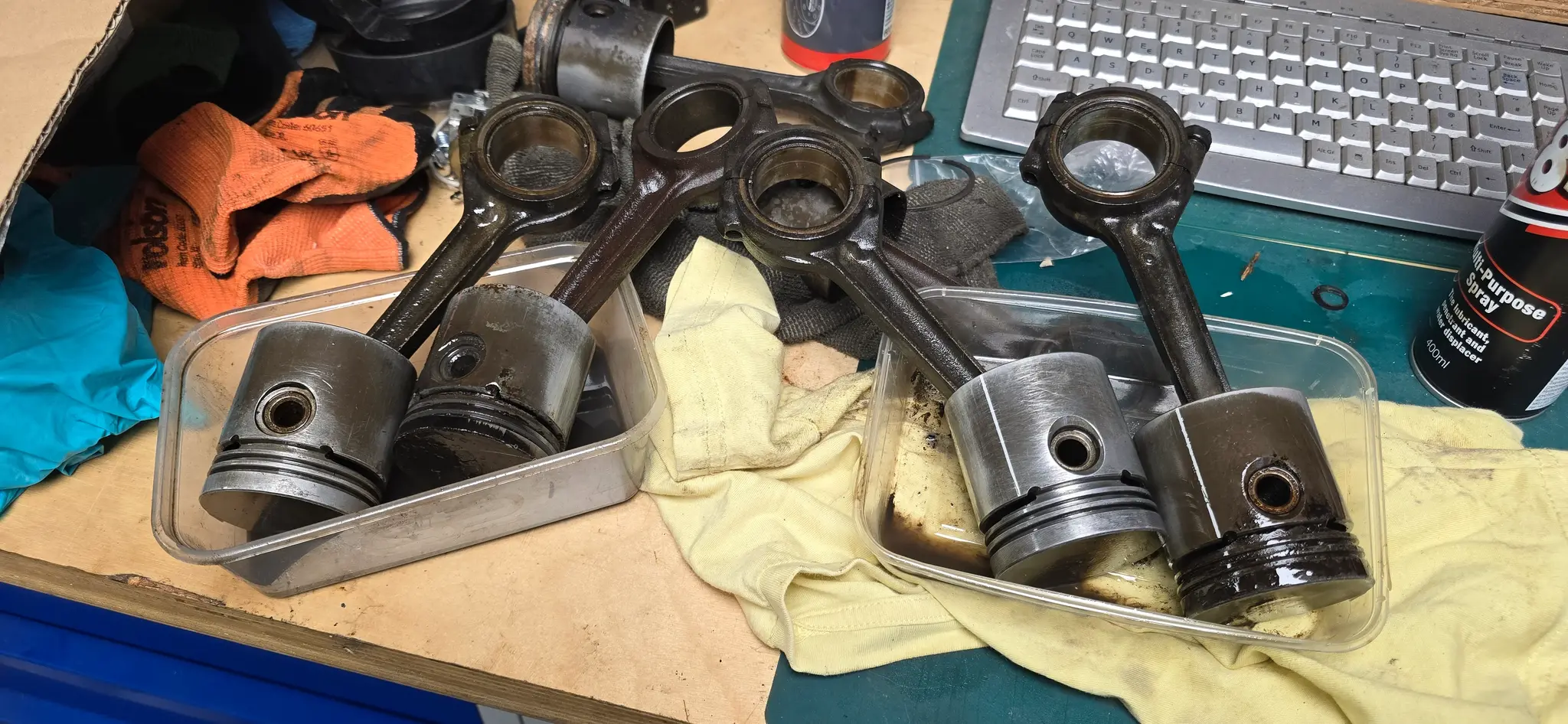

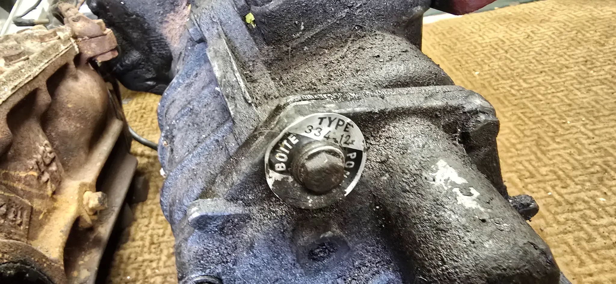

So this evening I’ve managed to salvage 4 pistons and rods, cleaned them up and fitted a set or slightly rusty rings. I’m not going nuts, tbh as long as it runs like the old agricultural engines they are, ill be happy (remember my old r8 engine… thing was doing 100s of miles with chunks missing out of 2 pistons :rofl: ) the rings cleaned up fine with a scotch pad. One of the oil scraper rings was damaged, so if anyone has a spare I would really appreciate it.
One of the blocks has the liners still in, looks ok so I may give it a quick DIY deglaze, cam rotates fine in there, just looks a little crusty on the outside.

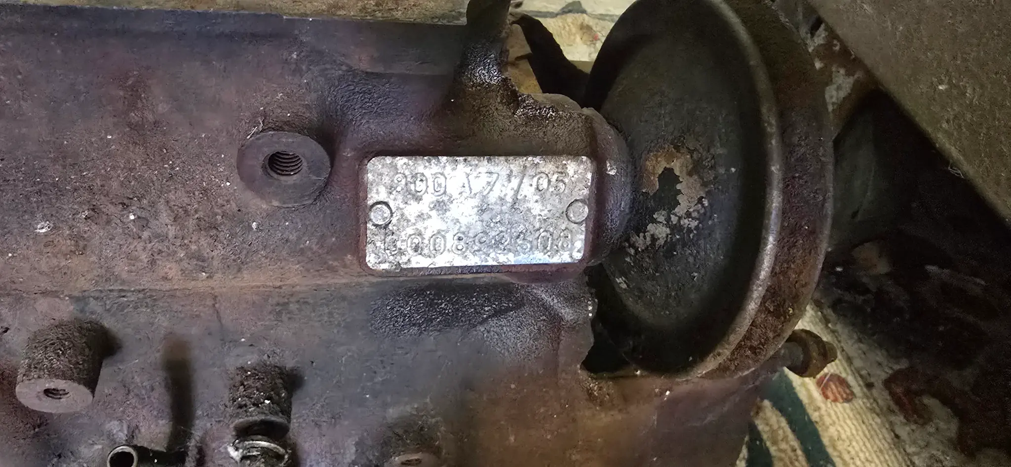

I have 2 gearbox’s here. The “Type 334-12” one is the early dog leg 1st, the other doesn’t look like it would fit without changing the driveshafts and mounts, its a chunk wider. So I need to figure a way of checking that the original works whilst not fitted to the car?
