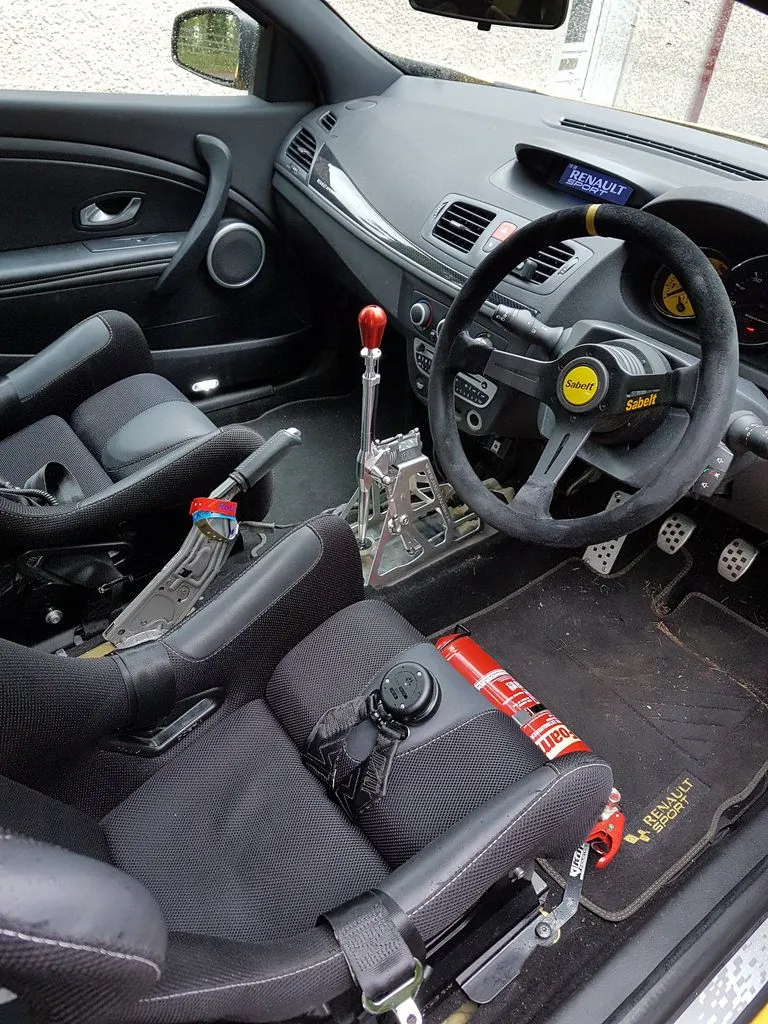

Also fitted a CAE a couple days ago
20160809_205326 by Jamie Atkinson, on Flickr
20160809_103510 by Jamie Atkinson, on Flickr
