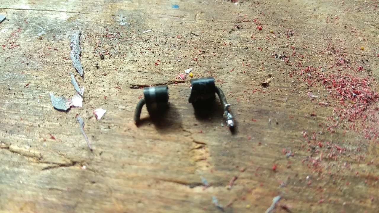

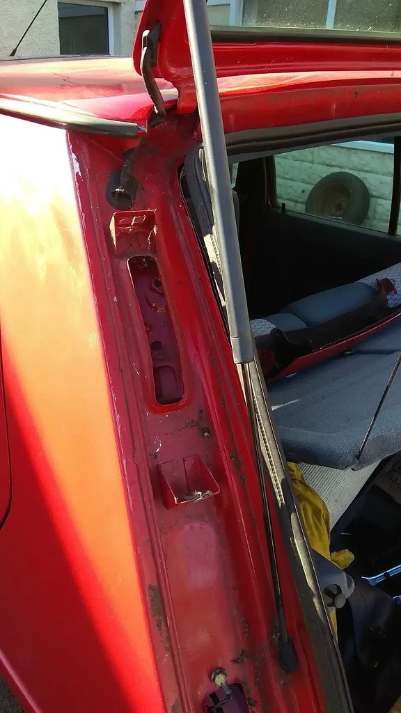

So, that was a useful learning and debugging session. Watched some videos and looked at wiring diagrams to understand how wiper motors work with regard to the park position. Eventually traced the fault to 2 broken wires in the harness from the boot to the lid. Shouldnt be too difficult to repair. For what its worth, the 3 wires going to the motor are +12v (on always when the wipers should be on), Ground and +12v pulse from the relay, which pulses half a second. In its park position, the 12v doesnt get to the motor to turn it because the motor is in its park position. When the half second pulse comes from the relay, it drives the motor just far enough for the switch to move to the off-park position, where the 12v takes over to complete the motion until it gets back to parked when the contact switches off the power. It then waits again for the pulse from the relay.
There is also a diode on the motor, which on mine looks to have crack in it. It still seems to work and the diode tester on my multimeter said it worked, but im replacing it anyway for the 20p or so its costs for a new one!
So, the problem where it was moving only a little was becuase it was only moving when it got the half second pulse, and was missing the +12v needed to keep it going until the end of the cycle.

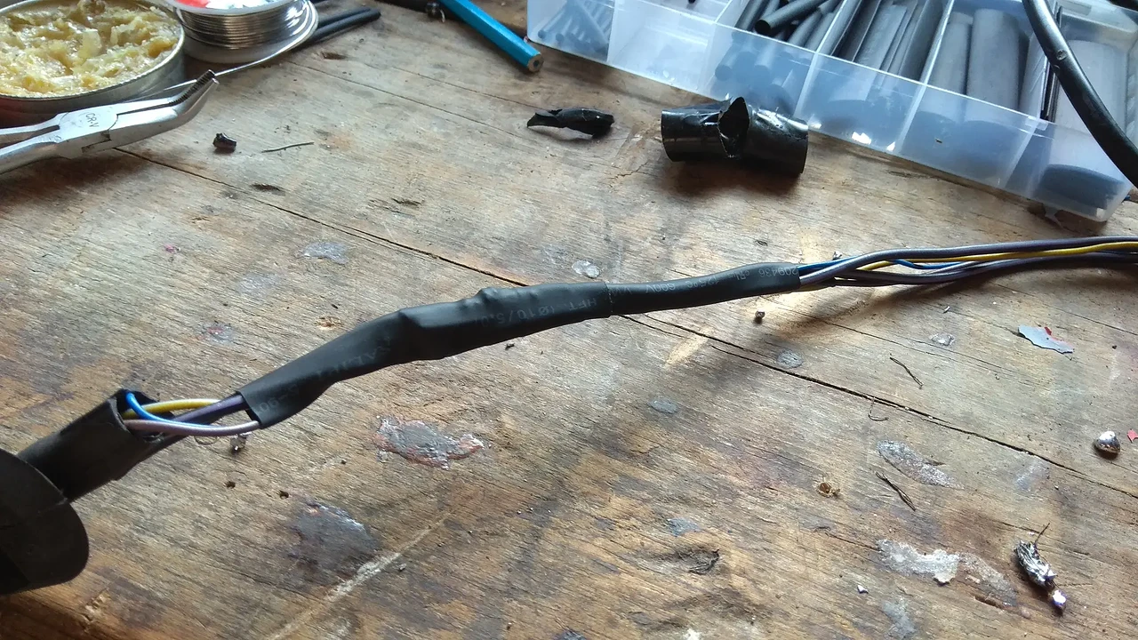

Wire, diodes and a blade must mean im fixing the rear wiper today!
Rear wiper and harness repairs…
a/gx2tUIb
Rear harness is common for breaking at the tailgate joint, resulting in popped fuse when rear demist or wiper is operated, nice easy fix :+1:
Yeah not hard … hardest part was soldering the thick wires, practically impossible to get the solder to flow through the whole lot!
Yep ballache to solder. I had the pleasure of doing it on a freshly painted gtt after the bodyshop had kindly snipped the wiring to remove the tailgate.
