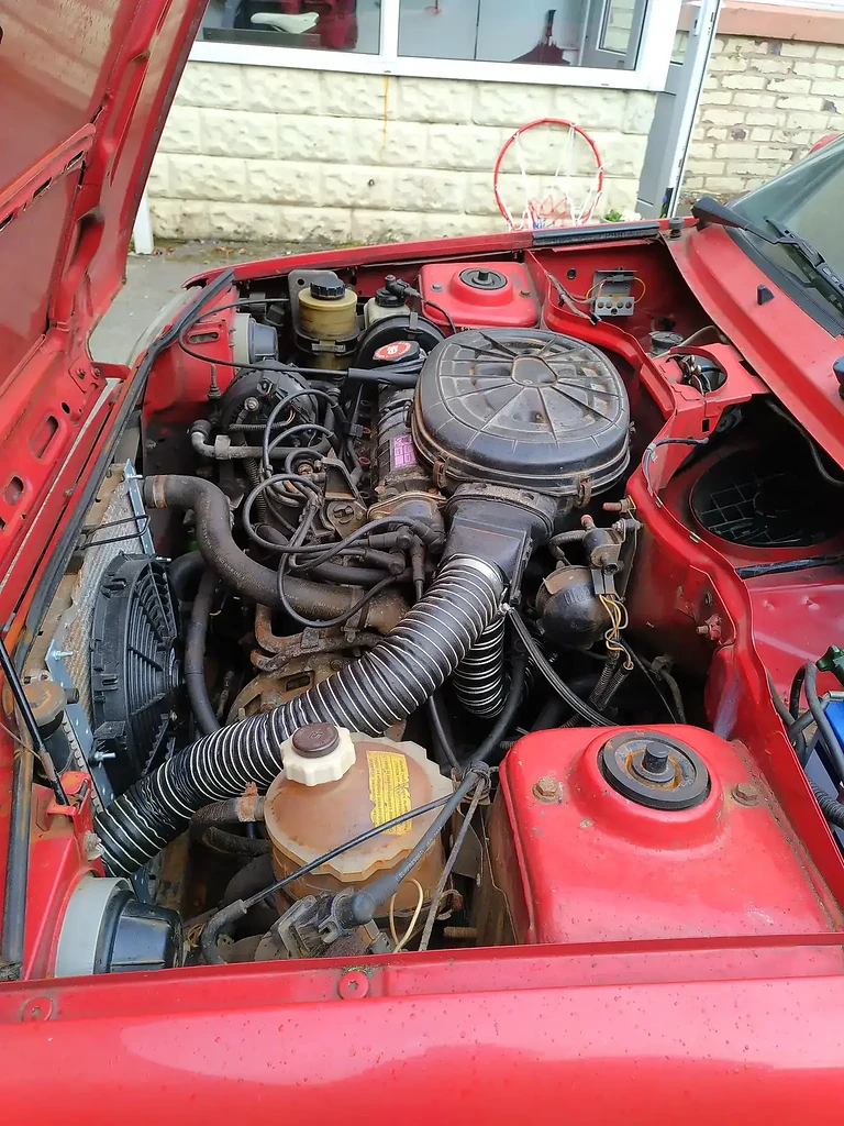

Got some new air hoses from ebay to replace the very tatty looking ones, I think these look decent enough. The fuse has arrived to fix the blower, so that will be to do in the next few days! :cry:
Whats the black ball bolted to the bulkhead, just below the airbox in the pic?
Ive no idea, open to suggestions!! I also dont know what the thing above it is with the wiring harness, because one of those sets of wires doesnt go anywhere
@DaveL485 I searched the part number, and it seems to be a vacuum reservoir. Glad a pulled it out as the hose has split :slight_smile:
7700740002
It just seems to be an empty sphere with a single hose line
https://www.ebay.co.uk/itm/Renault-Vacuum-Reservoir-7700740002-See-Description-For-Fitment-Check/184190082092?hash=item2ae2959c2c:g:vp0AAOSwoPZeWTZ3
