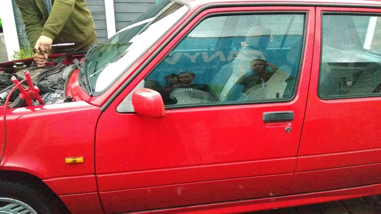

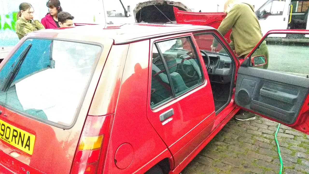

This is how it looked:
It had sat for a while and had no MOT. I drove it from Manchester to cumbria where it was booked in for an MOT. I had my mum following incase of a breakdown, and she made my take the A6 and keep off the motorway. That was a mistake! The journey took 4 hours, and it turned out the rad fan was seized, so every traffic I hit, the water temp increased! Fortunately, it made it to the garage.

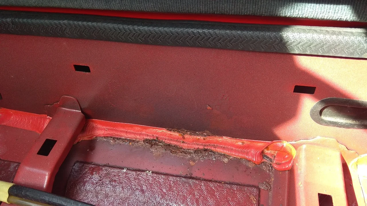

MOT failed with not too much, tyres, a boot on the steering, and the sills. The sills were covered by the skirts, and the drivers side inner and outer sills were shot, aswell as the floor.

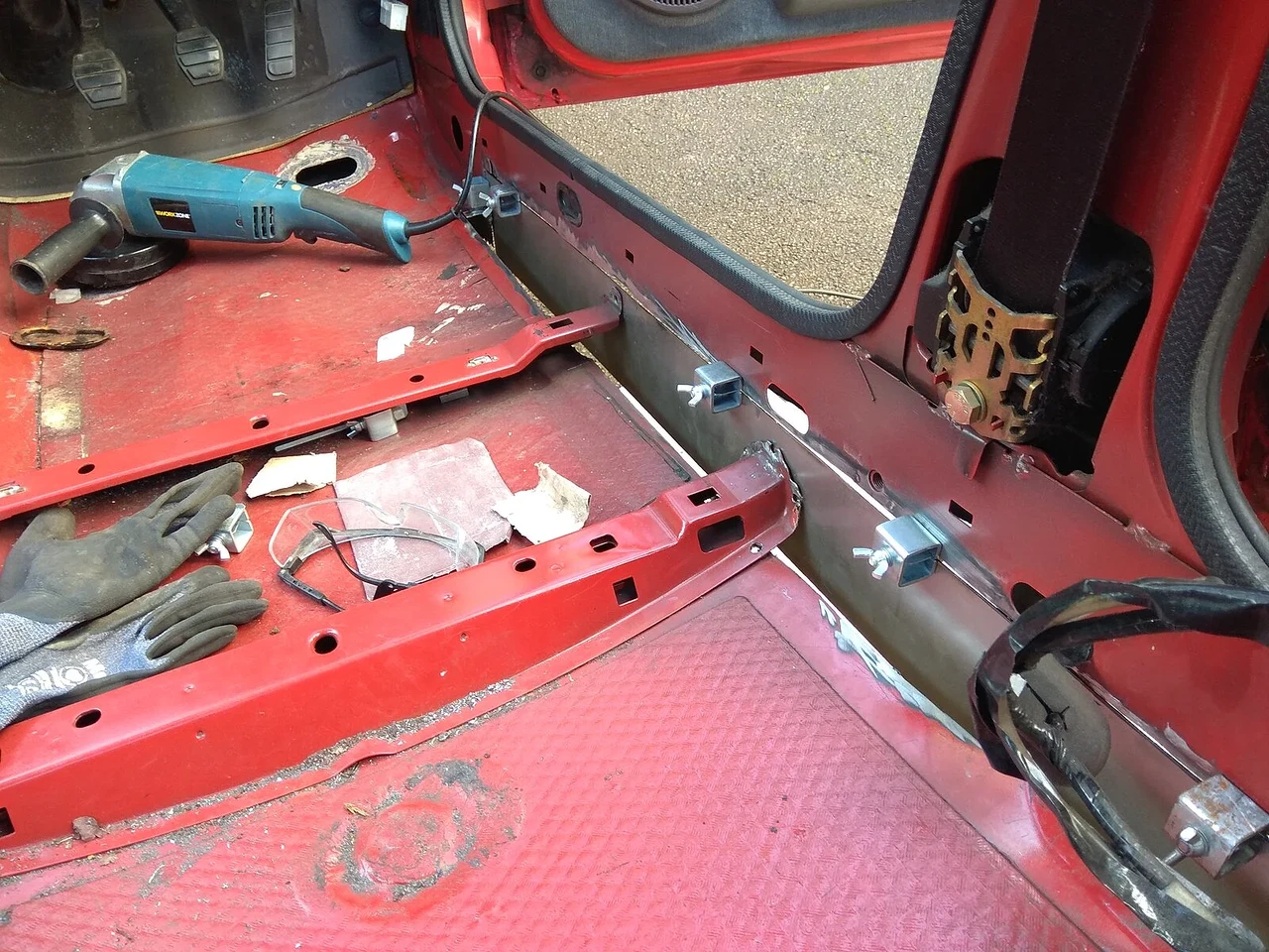

So, i set of cutting out the bad
and making new panels

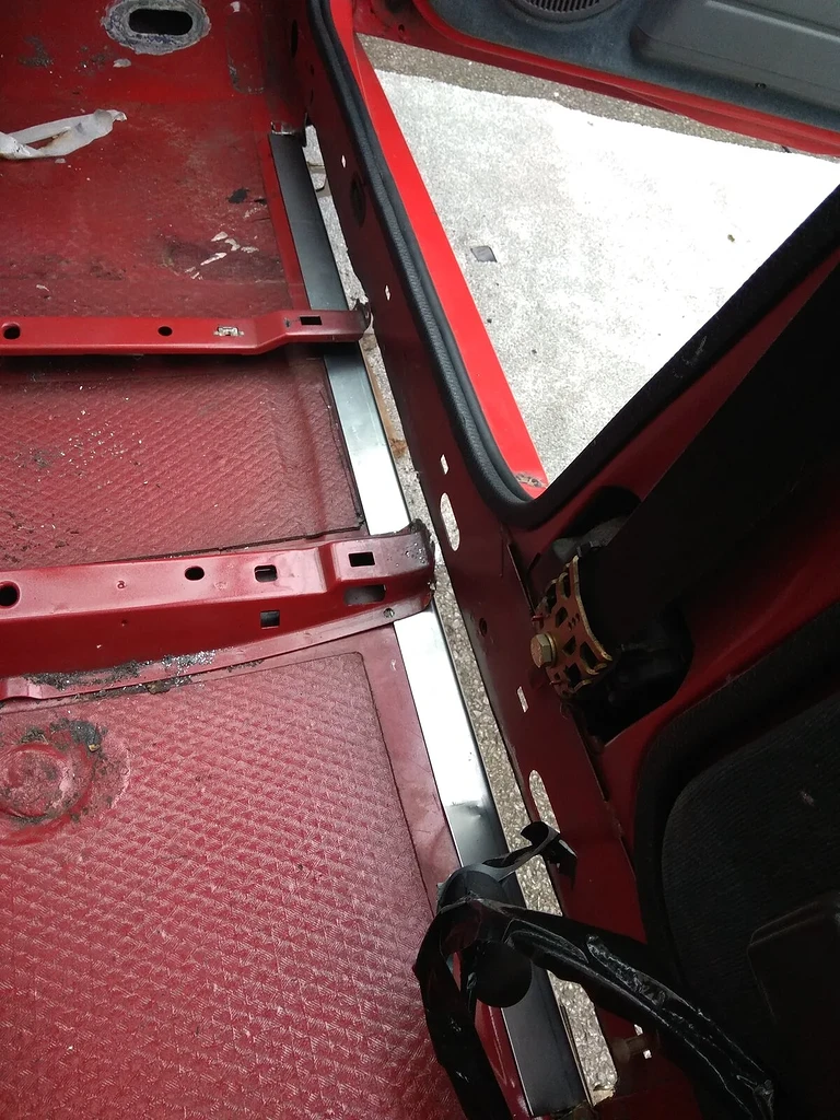

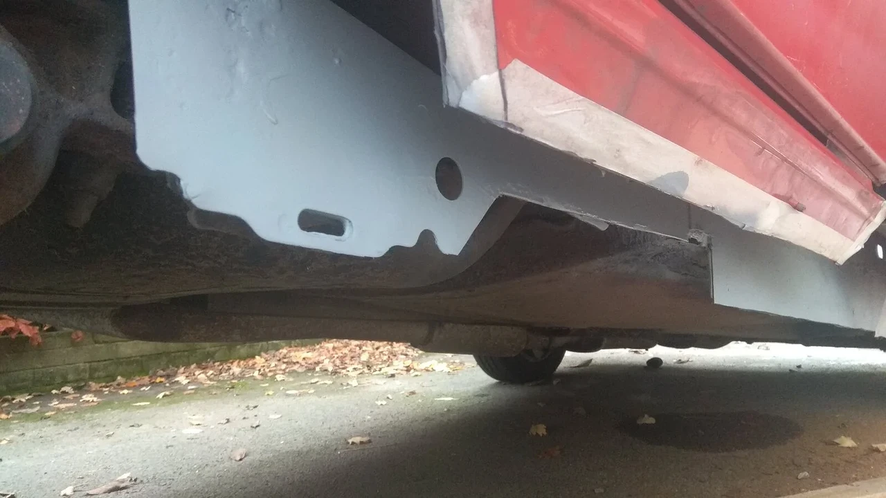

A colleague and my brother are helping with the welding, and its starting to take shape

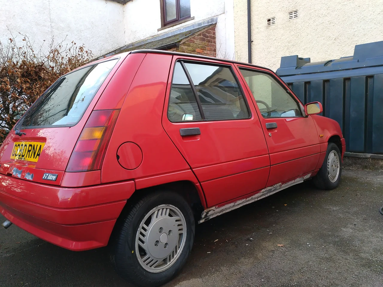

With the inside coming together, i moved to the outside this last weekend, and cut out the outer sill and remaining innersill rot

Ive ordered new seam seal, and a floor pan plug to replace the rusty metal one with a rubber one. While the dash is out, ive also ordered 2.5m of sound deadening to make it a more pleasant drive. My intention is to keep it as stock as possible and have it ready for a local classic car show next year. Hopefully the welding will be done soon, there is just the drivers sill area and a small patch on the passenger sill. I think i will go with a protective covering for the sills, as the skirts cover them anyway.
Excellent - did you know you can still buy new outer sill panels? May be easier than fabricating.
Yeah, I have one…you can only get 3dr ones though, no 5 doors. So, i have a 3 door one and will have to make it fit! Im cutting the original below the skirt clips as I couldnt find them either. I think it will be ok.

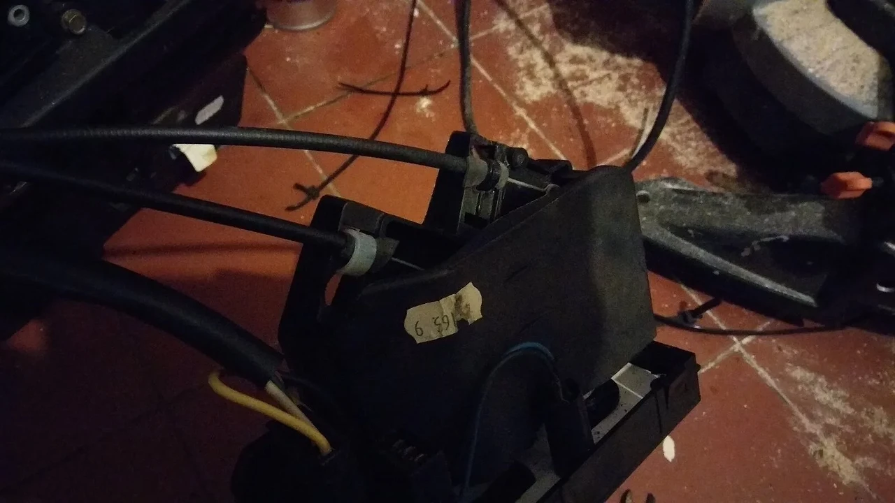

dash and heater is out. ordered new matrix, 20 new on ebay seemed.a decent price, some were 40! found that the clips were snapped on the heater controls, zip tied the outers to the plastic, hope it holds, as replacements seem expensive and hard to come by. Any suggestions for a better fix?
I had mine zip tied for years and worked fine, but you should be able to order those clips from somewhere, they look the same as a Gtt choke clip IIRC
Yep, same on the 21 heater controls too. Part number 7703076210.
I found one clip inside the controls…the problem is the plastic as snapped away so the clips dont fit!
Ive ordered some small metal P-clips with rubber inserts, and i’ll see what I can fabricate out of that! :slight_smile:

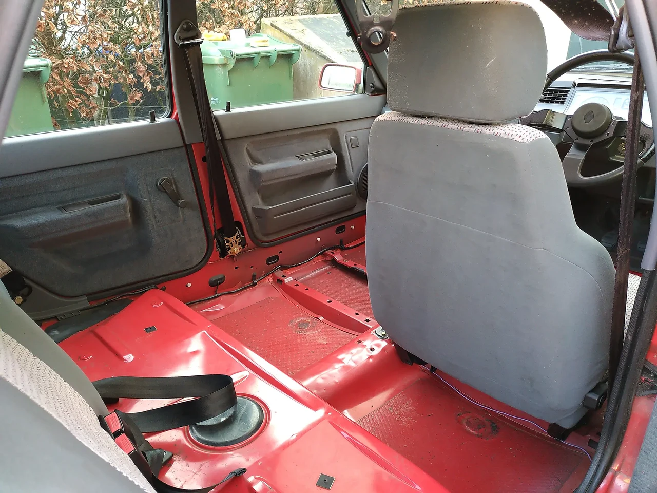

Welding is complete (thanks Andy!), that was the drivers inner and outer in large parts, and a much smaller amount on the passenger inner and outer. The bad inner sill on the passenger looked like a previous repair, so that was cut out.
Heater matrix replaced and dash back in. Drivers seat in, and otehrs will follow. I wont put the carpets back in until its been checked through the MOT tho so the garage can see everything.
