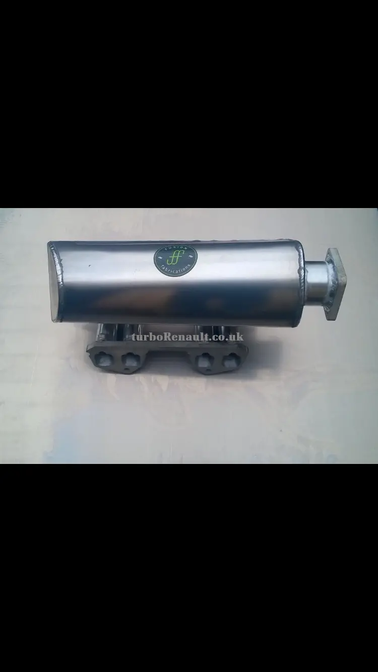

Pressure tested this morning. Leaks from inlet manifold where it joins OE manifold, leaks from 18mm inlet below throttle body. (Poor workmanship) Also leaking from inlet manifold to head (shit manifold and 100% my fault) and finally a leak from IAT sensor.
All in all I think I’ve found the source of poor idle and now is a good as time as any to get Matt Rowley to make me one of his custom inlets.

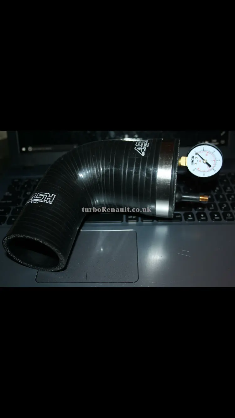

Here is my mates tester.
Stick a pressure testing kit on inlet, attach compressor line to about 20psi and then spray with soapy water or WD40 to spot leaks. To be honest you could hear my leaks instantly but as soon as started to spray you could see the whole of the manifold gasket leaking bad. Couldn’t get beneath the car to check at the bottom of manifolds but I suspect they are leaking too.

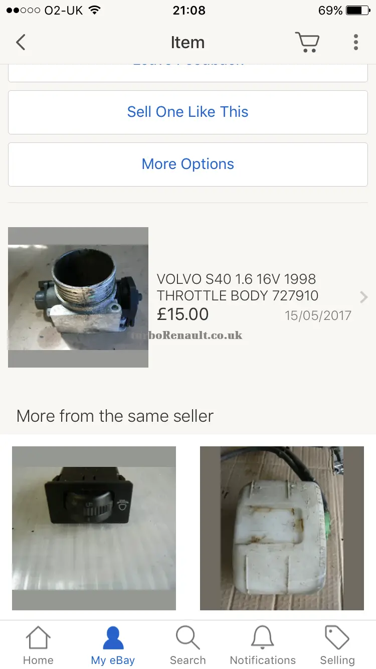

My father in law is demolishing the chocolate, oh also I’ll have a spare throttle body too plus TPS now I come to think of it. I just bought this to send to Matt. (Forgot to Skimlink)
What diameter is the butterfly? Looks good!
