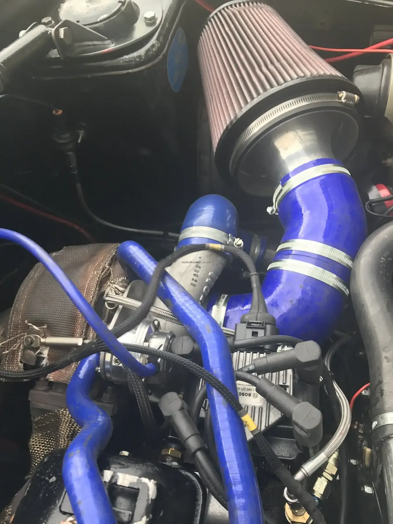

I am not entirely sure, I will measure for you. I have heard quite a few say that the throttle body is too large, I’ve no experience so not entirely sure what the ideal size is? Any idea?
Ideal size depends on so many factors! Basically the ideal one gives you enough resolution but won’t restrict airflow too much. Mind you, a meg 225’s butterfly is only 38mm so this one won’t be too small for sure :slight_smile:
Basically Mark, bigger is better until you get to the point where the TB is so big you are effectively at full throttle without being at full throttle… if you stuck a 100mm TB on it you’d get to about 50% open and the other 50% would make no difference whatsoever to power.

Manifolds are off and currently port matching new manifold gasket. This time I’m going to use some high temp sealant too. Plan is to seal up areas on inlet that are leaking with a thin bead of Tiger Seal. Also need to find new IAT sensor as the current one is leaking too.

It’s all back together, new gasket on both throttle body and manifolds and all is well. Now for a solid summers use starting with some 60-100 timing this weekend. Last set up was 5.7 sec so a good benchmark to work from.

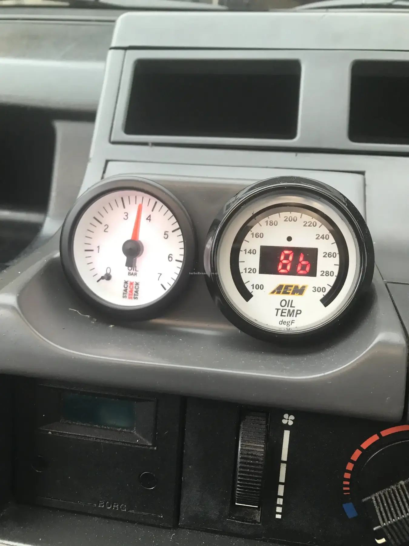

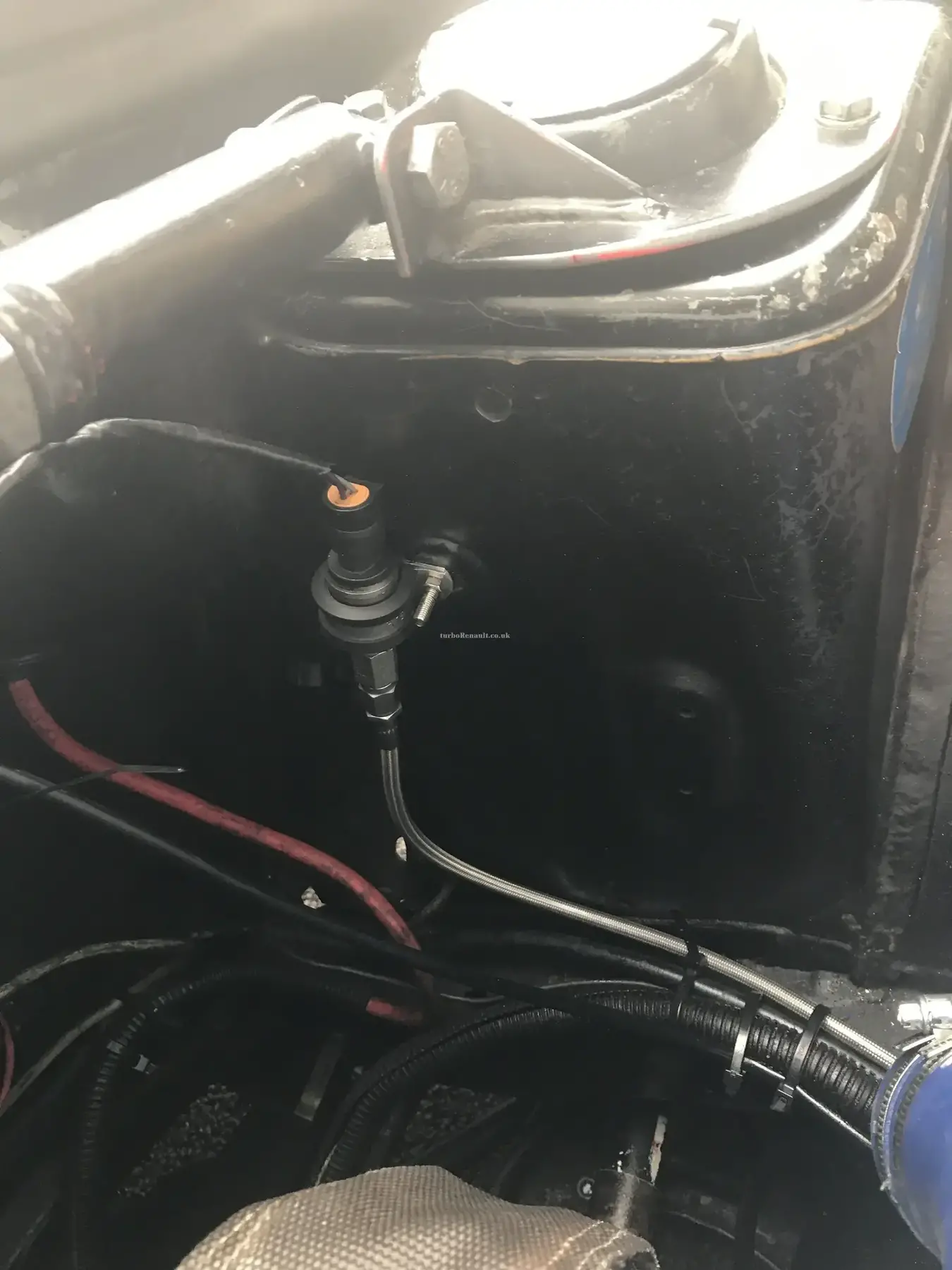

Anyway, picked up my third Stack oil pressure sensor due to vibration failure on the other two. I got them to knock up a hose to relocate onto side of strut. Pleased to say I now have a working gauge again and hopefully with any luck it will last this time.
It’s not perfect or pretty but secure and functional.
