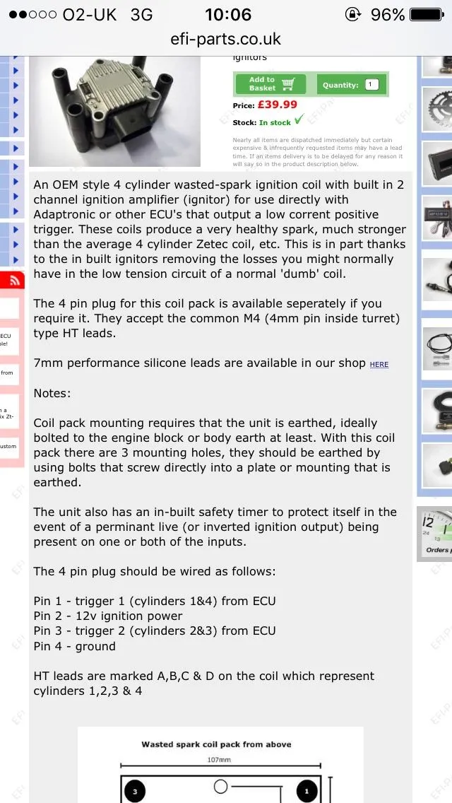

4-wire, +ve, Grnd, Ign1 and Ign2, i’m using the same coil and it’s not grounded through the case either. Not intentionally anyway.

Regarding the coil pack. Scoff looked at mine and said its earthed fine and wouldn’t cause any issues.

I’ve no idea but my bracket goes straight to the block. When i’ve had mapping sessions with him he said it was fine. He even swapped a coil pack for me once when trouble shooting.
Strange, mines sat on posts on a flat bracket like advised.
I didnt see that. I guess I better check it’s earthed then! I assumed (why wouldn’t you) that the earth wire on the harness was…well…the earth wire!
doesn’t it earth through the 3 bolts that go through it?
Yes, probably, I just never checked that plate and the plate that it fits to was earthed to the body.
It’s the under of the coil which is important because that’s the coil winding earths I’m sure
Either way worth checking
