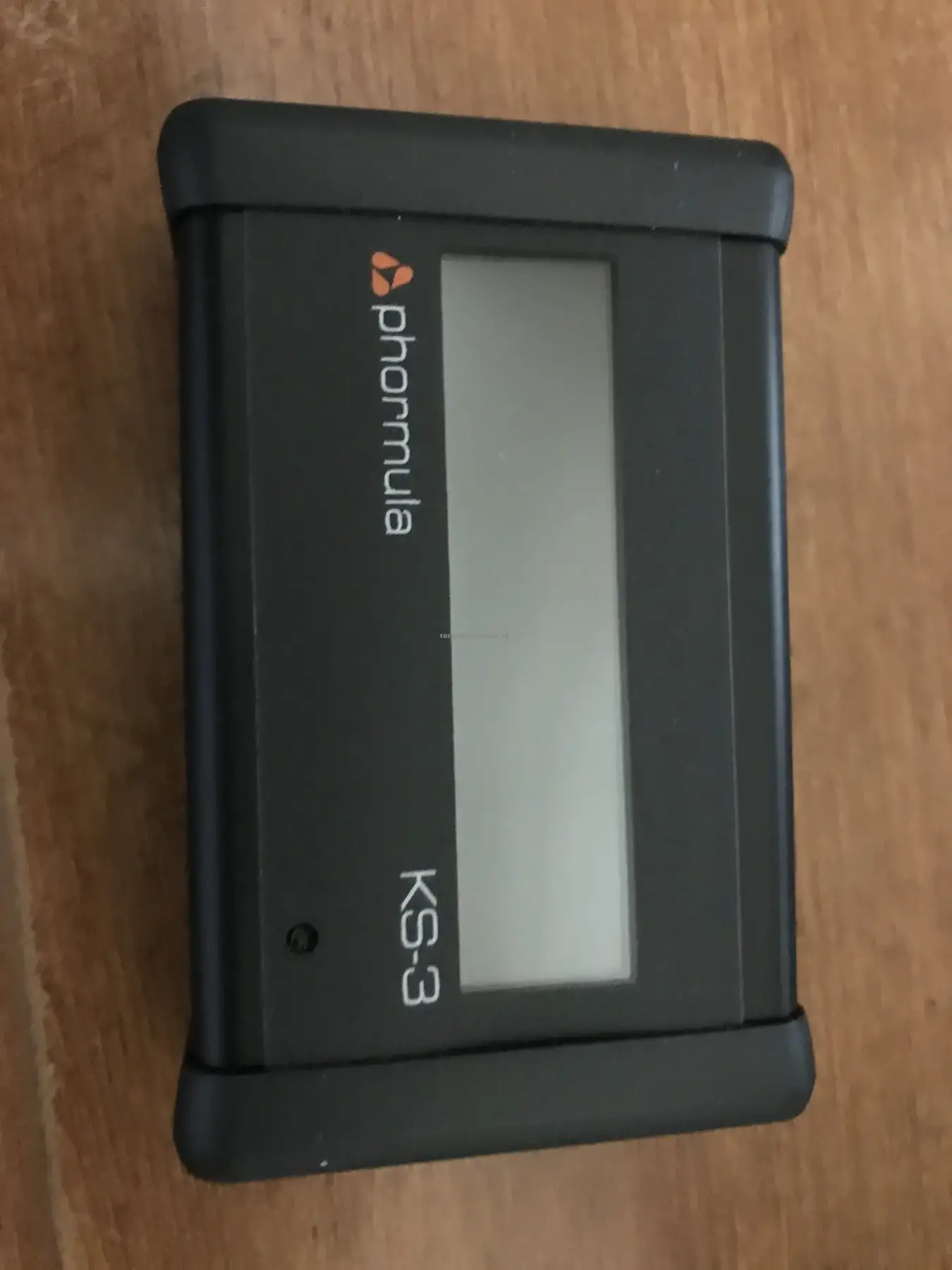

My new gadget, should hopefully prove to be a good investment.

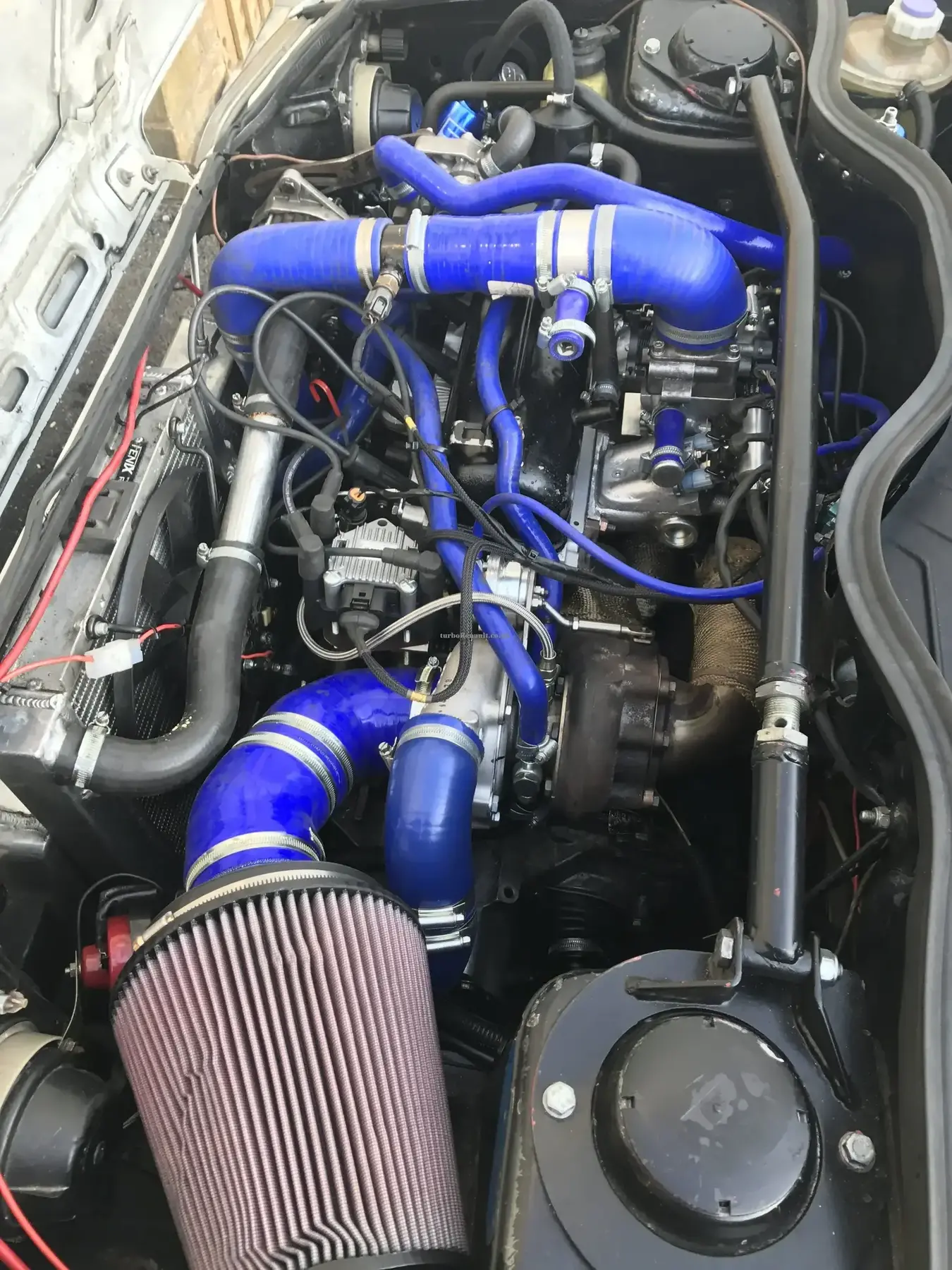

Took the afternoon off work to get it back together. Just need a new throttle cable plus waiting on coolant and oil.
So no evidence of cam or con rod imperfections which is good news. I took this opportunity to put and MLS gasket on plus some new head bolts.

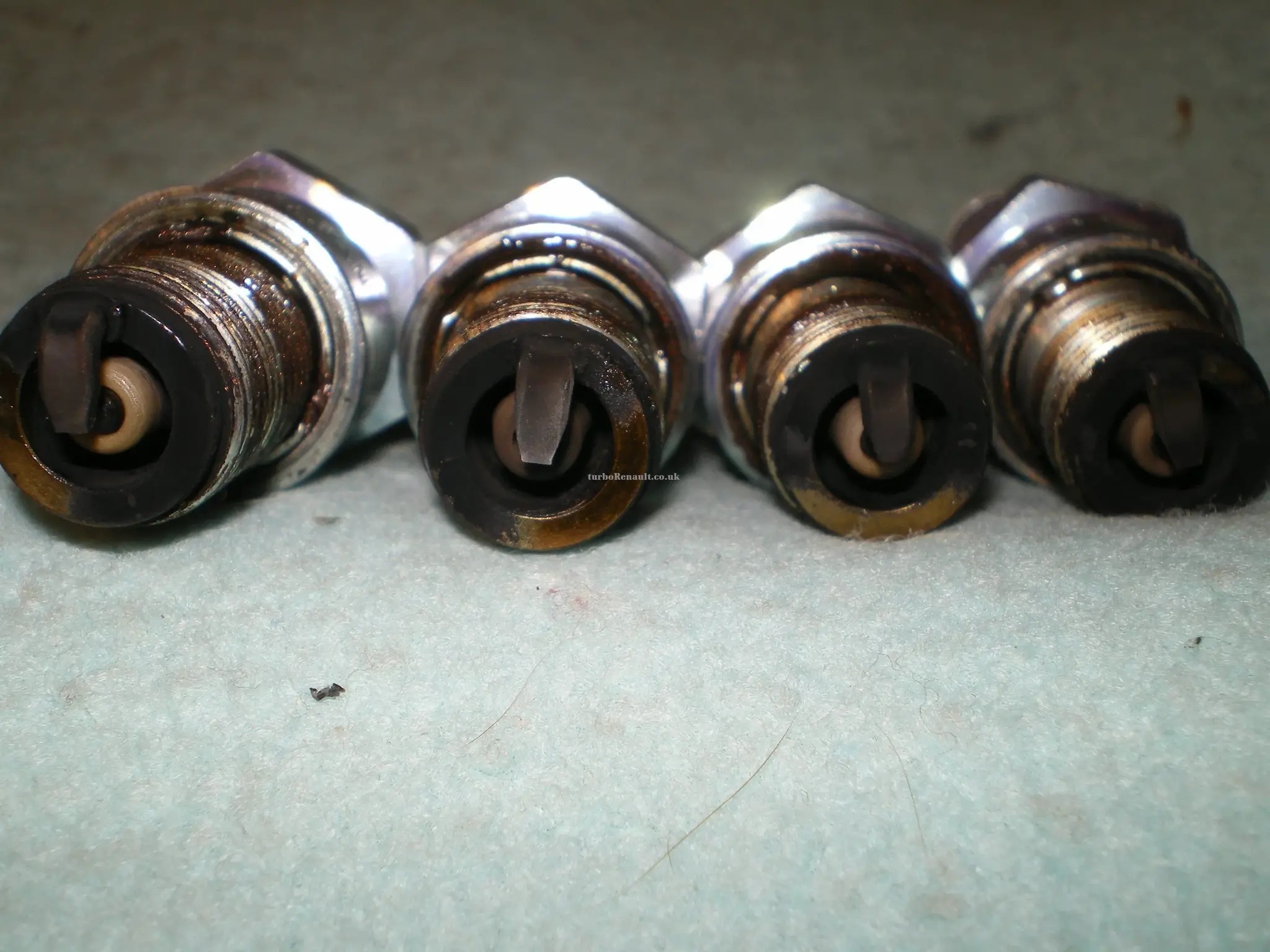

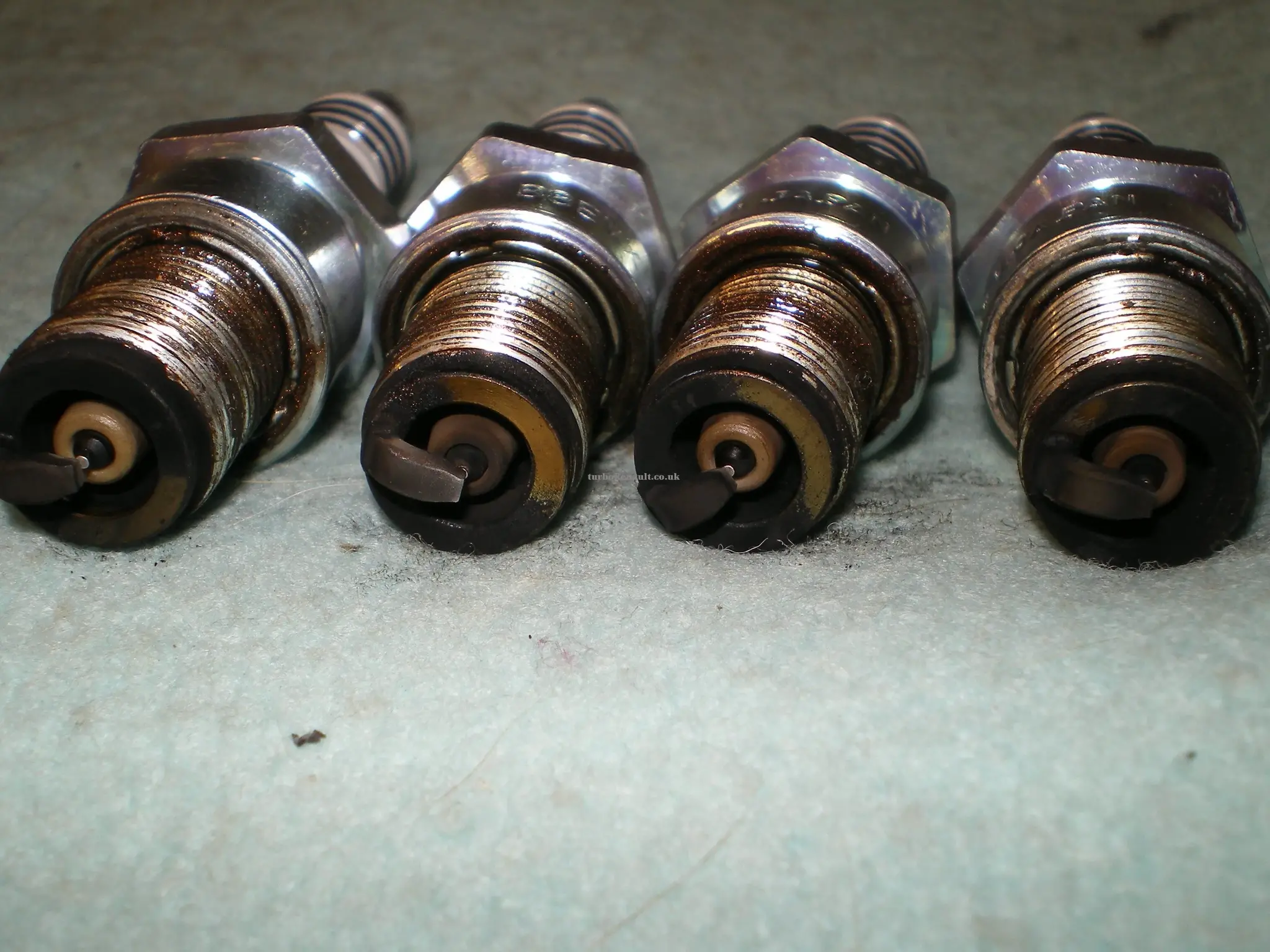

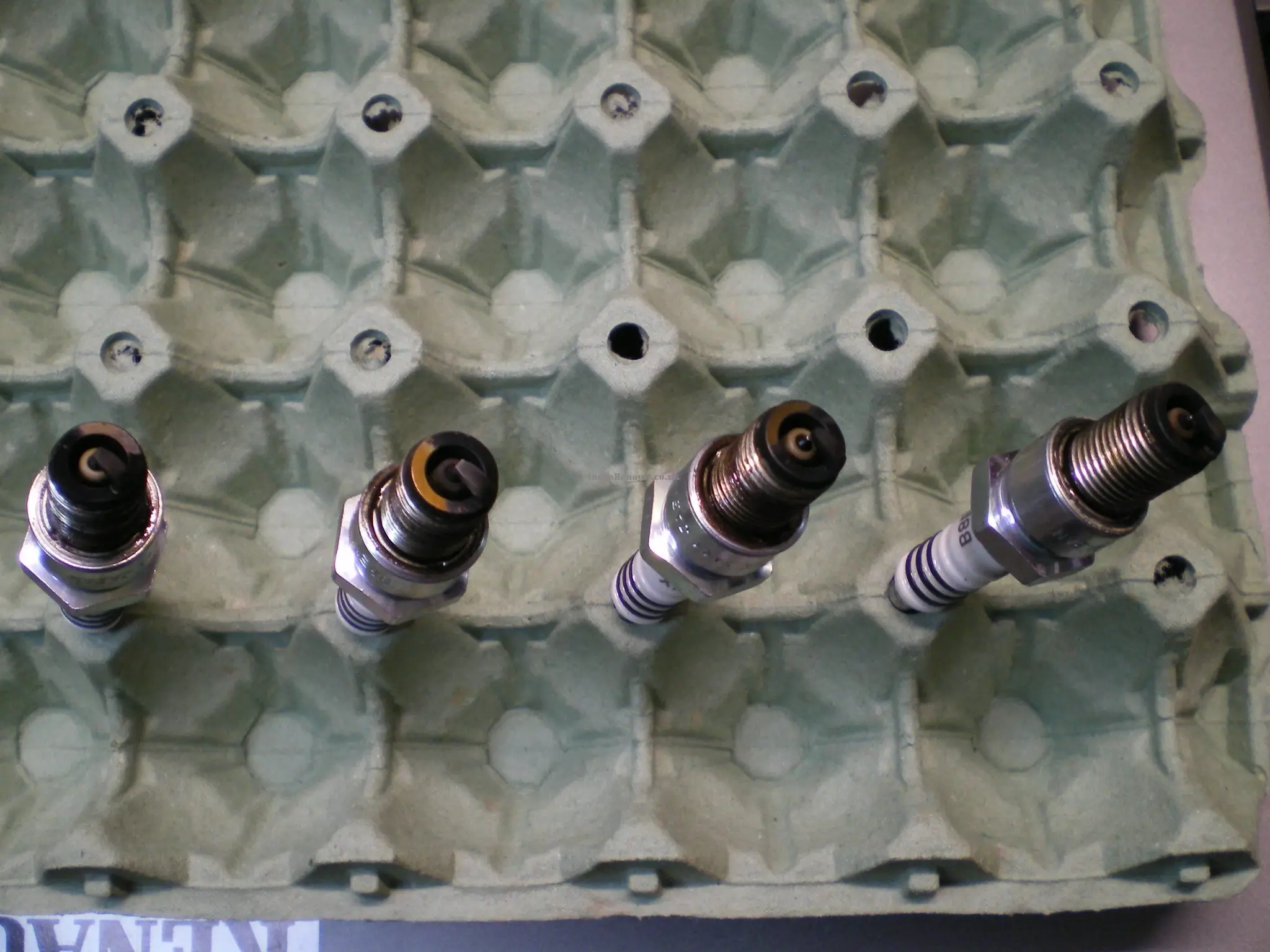

I’ve got a set of copper 8s and 9s now. I’ve gone with the 9s to start gapped to 0.5.
