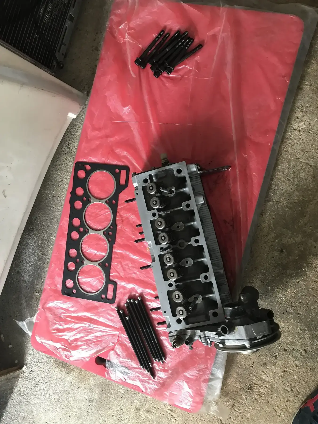

Well I’ve had a busy afternoon.

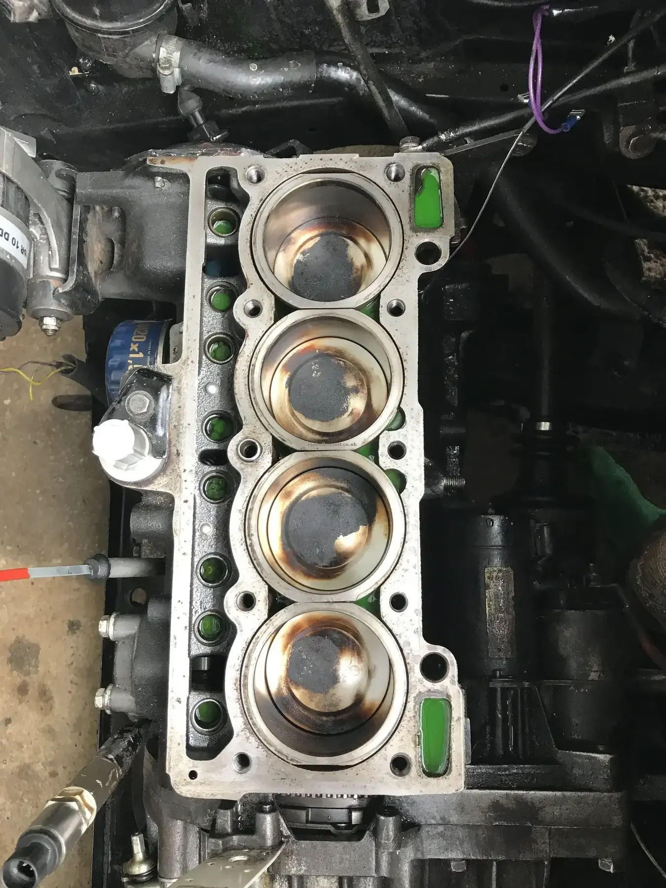

Long story short head is spot on and so is engine. No problems with valves or valve guides which is good news. Head gasket is perfect so at least that’s put my mind to rest. Pistons and liners looks mint.
However is there a way to check cylinder head function with it off ?
My compression tester from Clarke was a load of wank, tried another one and all cylinders around 140psi.
Going to upgrade to MLS gasket just because I can as will run more boost sooner or later.

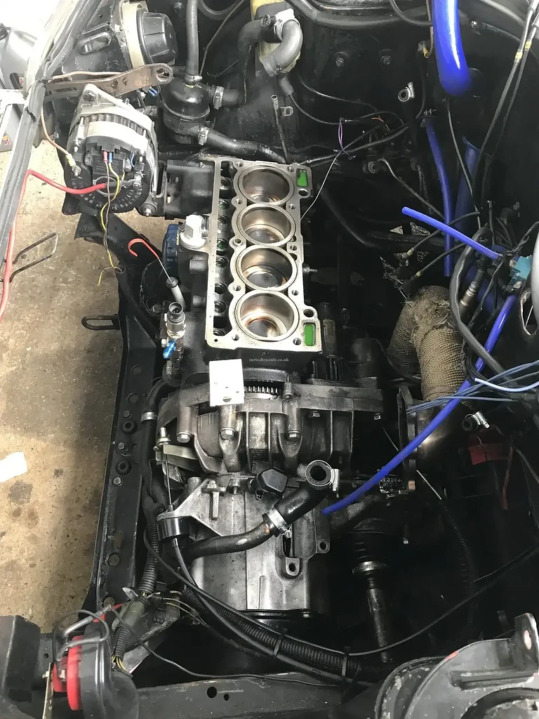

Ran checks on all leads, coil pack and injectors all fine. Still doesn’t explain why number 3 is missing however. Scratching head a little.

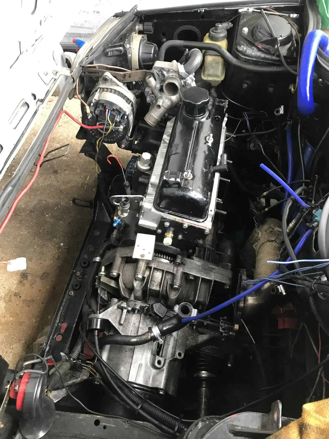

So will put it all back together and try new plugs. Going to order HG, bolts and type d now.
