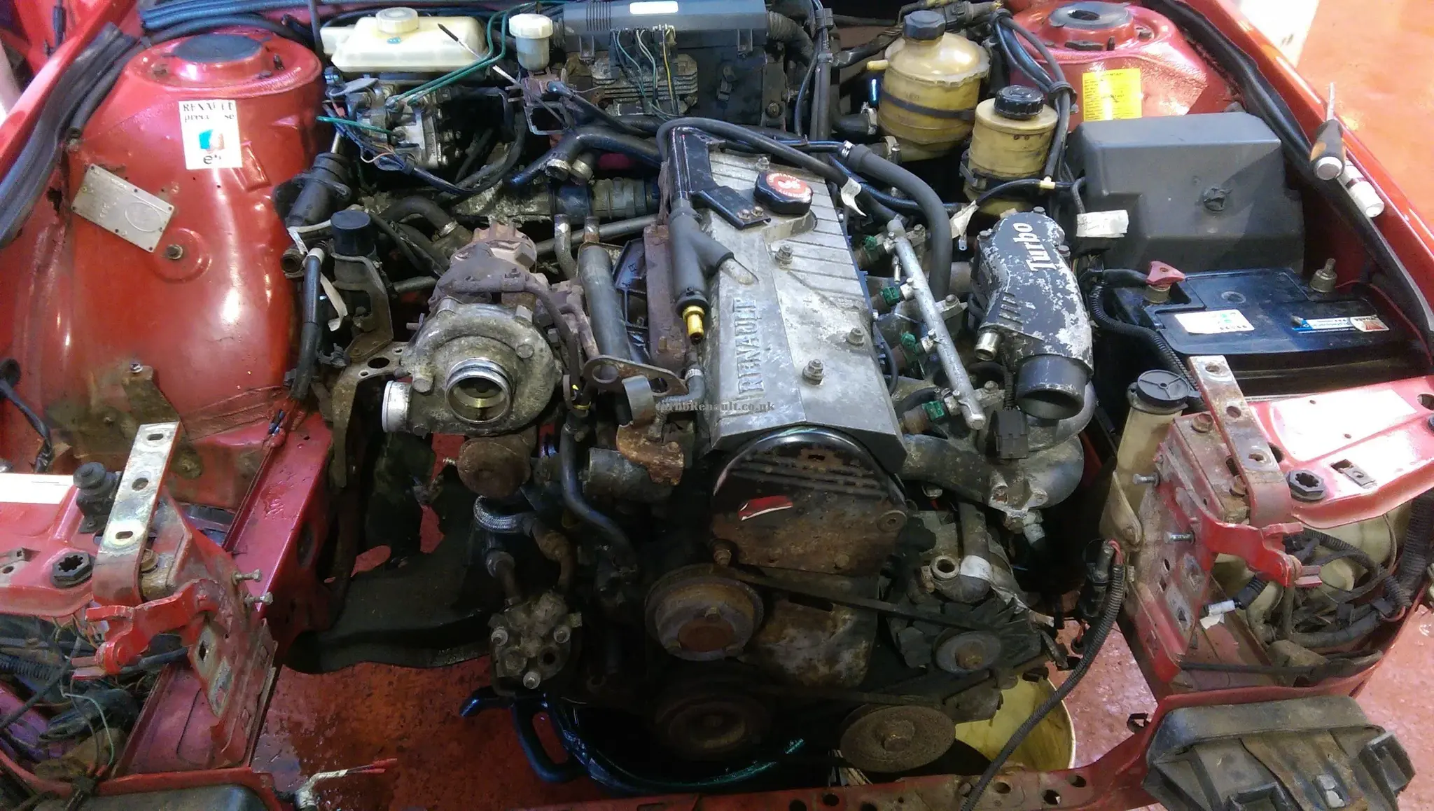

In other news, the engine is mostly ready to come out:

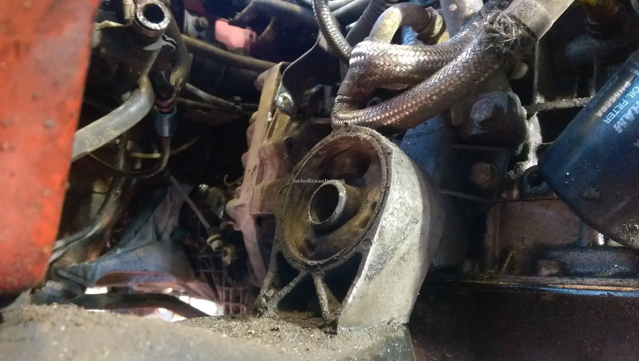

Do I need new engine mounts?

All in all, great progress for a day’s work!
I am very relieved that I got the 'box checked out. It would have been a huge issue if we’d just plonked it in and found that it was faulty and had to do it all again!
I’m very excited that work has started on the car. Further updates to follow in a day or two.

Nah be alright for a bit. As long as they aren’t loose.
They all do that.
They all do that
They all do that
They all do that
