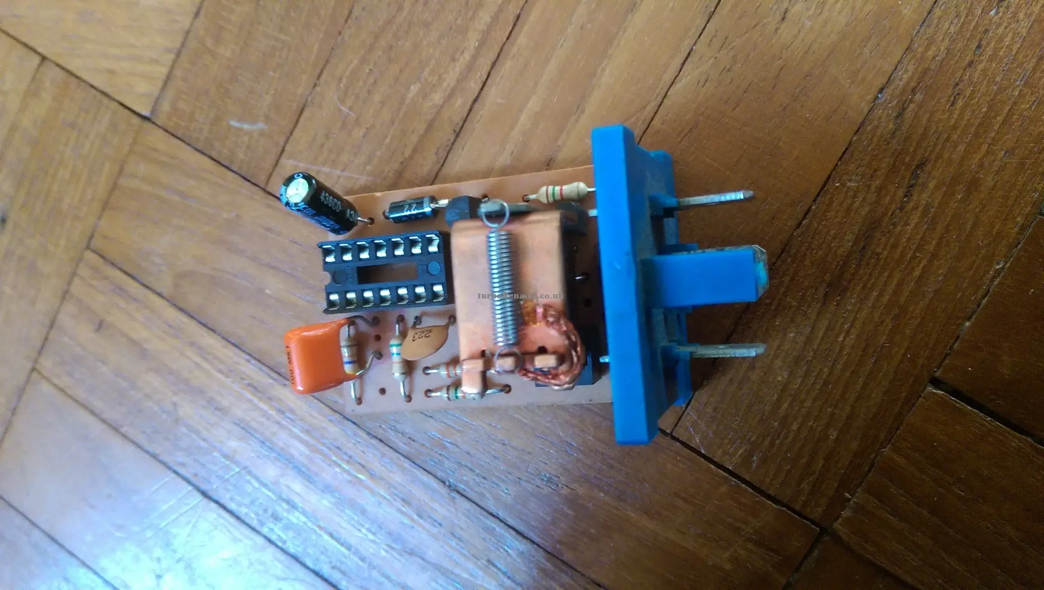

p.s. I think we will be very lucky to find a drop-in pin-compatible timer relay, but there might be something that can be adapted. It might even be possible to design a circuit that could be built into the case of an old relay that has failed. I have had mine apart and there’s no sign of any visible damage but it does smell “burnt”. I’d like to check a few things with my multimeter but I don’t hold out much hope of being able to fix it.
p.p.s. I see it uses this programmable timer IC: http://www.alldatasheet.com/datasheet-pdf/pdf/11989/ONSEMI/MC14541BCP.html
I suspect that the timer IC is fine. Most likely fault is that the single on-board electrolytic capacitor has failed. I could try replacing it! There’s also a transistor, which could be a likely candidate for failure. I can’t see what type it is without removing it. I have capacitor and transistor testers, so it might be fun to investigate further…

Thanks! I found that relay. I could be wrong but don’t think it’s the same pinout. Of course it could be adapted. I have checked all the discrete components in mine and they are fine. That just leaves the main timer IC. I’ve managed to find some on eBay and in the meantime have fitted an IC socket to the PCB, which awaits the new IC when it arrives!
The Renault relay seems to be missing pin 3… That’s what leads me to suspect it’s not standard.
Here’s a photo of the innards with the IC socket fitted.
