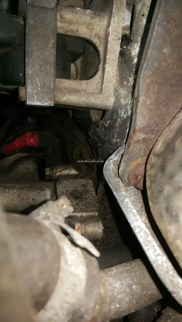

  2. The head gasket appears it may be leaking oil down the back of the engine. There’s quite a stain down the bellhousing and there’s a rag stuffed between it and the head! I tried to take a photo:
Nice! To worry about? Not sure! Do I just keep replacing the rag and monitor how much is leaking?
