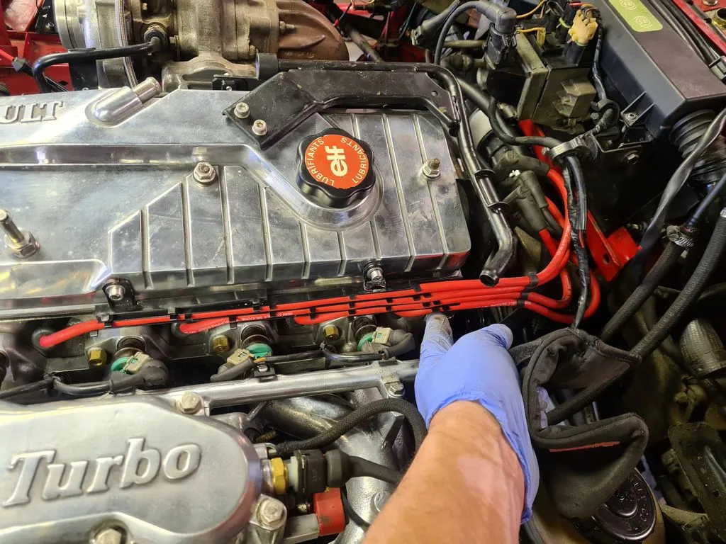

HT leads cleaned and attached

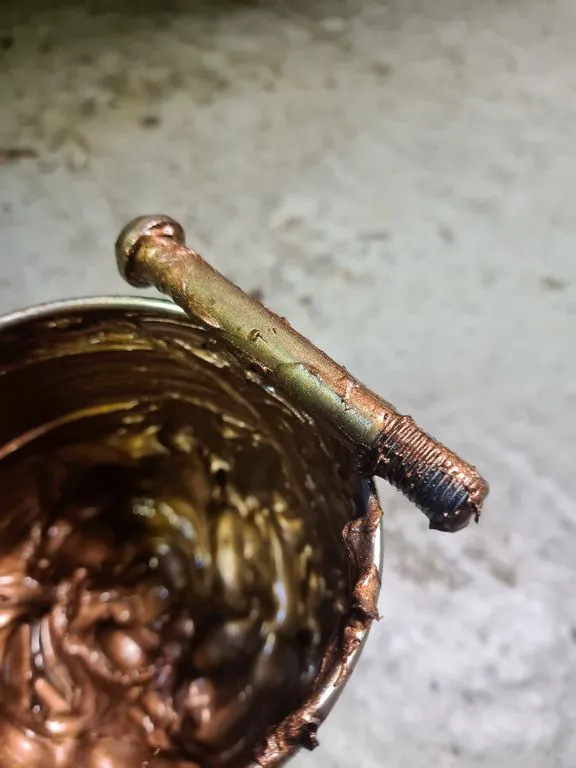

Then I got the remote oil cooler pipes and freed up the collars, making sure they were well oiled. These are a sod for seizing to the pipes and then you have to wreck the pipe to get it off. Three were fairly loose anyway, one was solid so I heated it up and got it free, then i span all the ends with WD and an air gun until they were nice and free. Note - if you heat these remove the tiny green union seal from the end first or you’ll cook it, it wont seal and it’ll piss oil out.

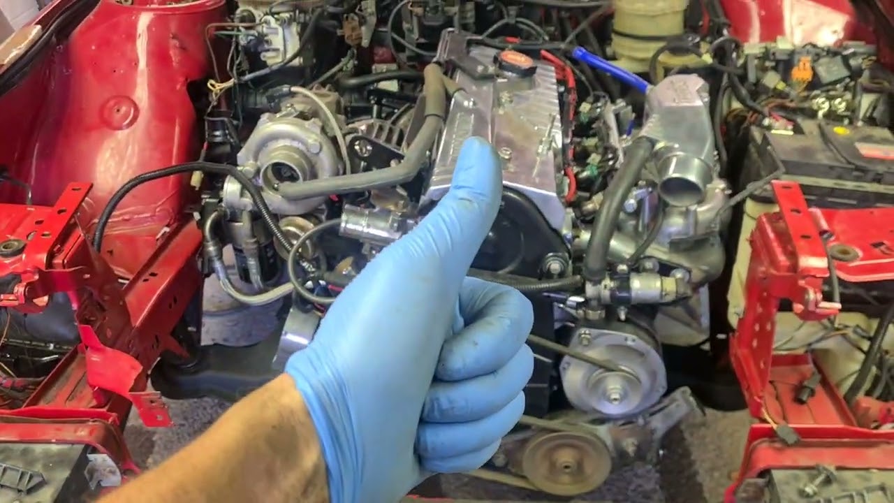

Continued assembly of the engine bay, alternator and power steering pump on
Hoofed some oil in it as well, primed the fuel system with some fresh fuel and… (this was genuinely the first turn of the key too)

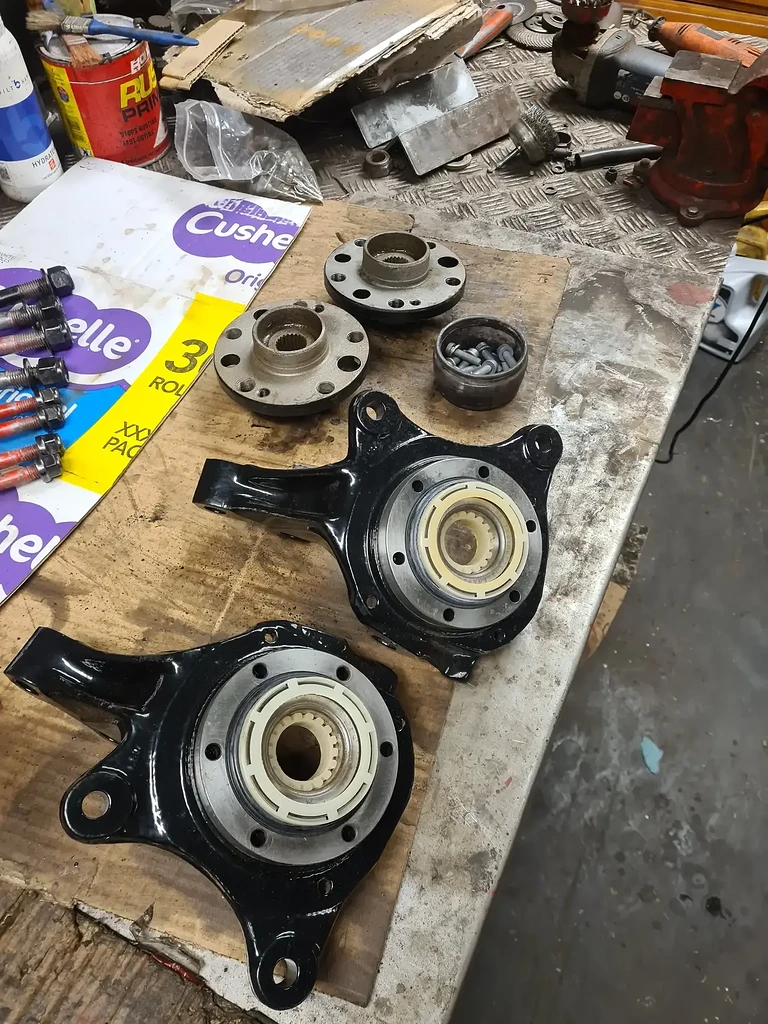

Front hubs powdercoated and assembled with new bearings
Shaft in and pinned, new wishbone and stub axle fitted.

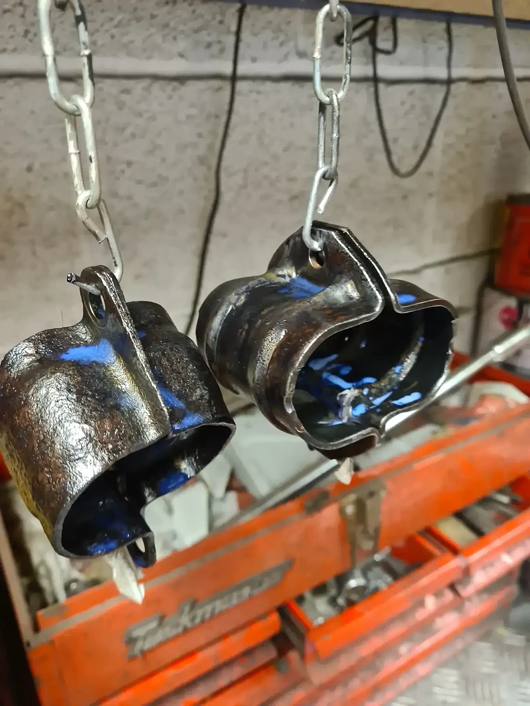

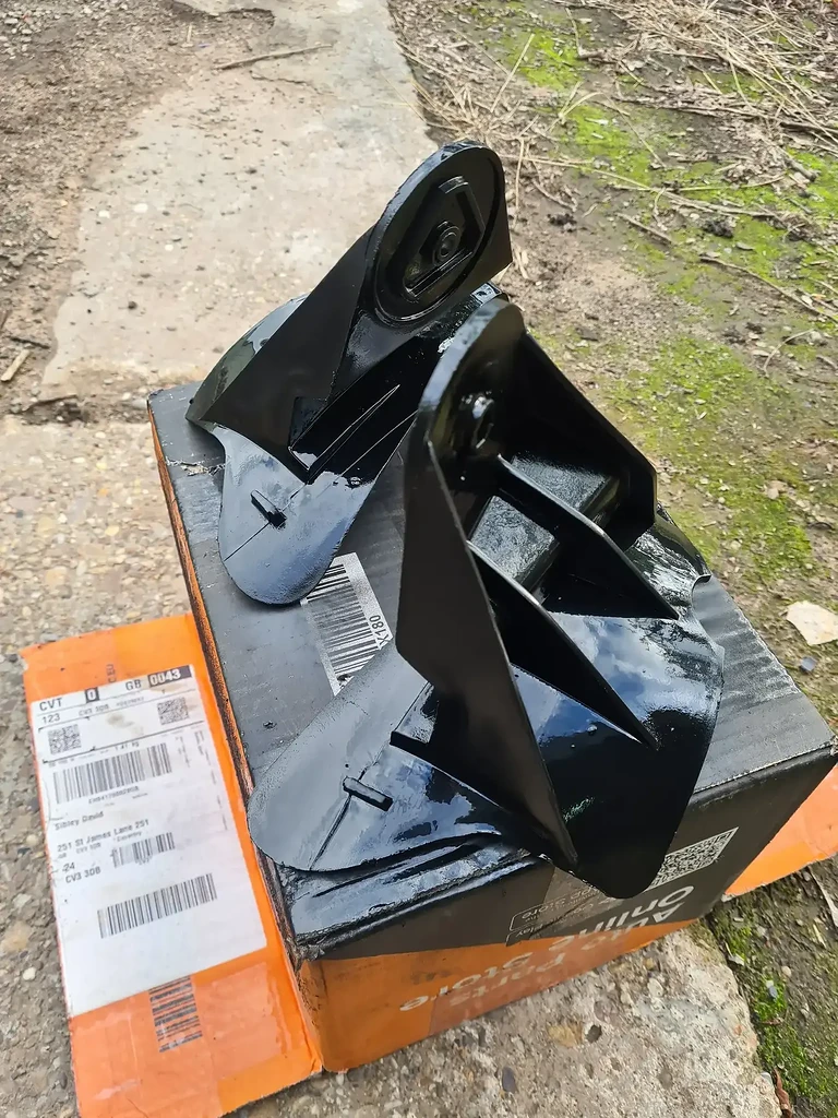

Cleaned and painted the wishbone air deflectors, these direct air from the bumper vents through the channel to the front brakes.
And fitted

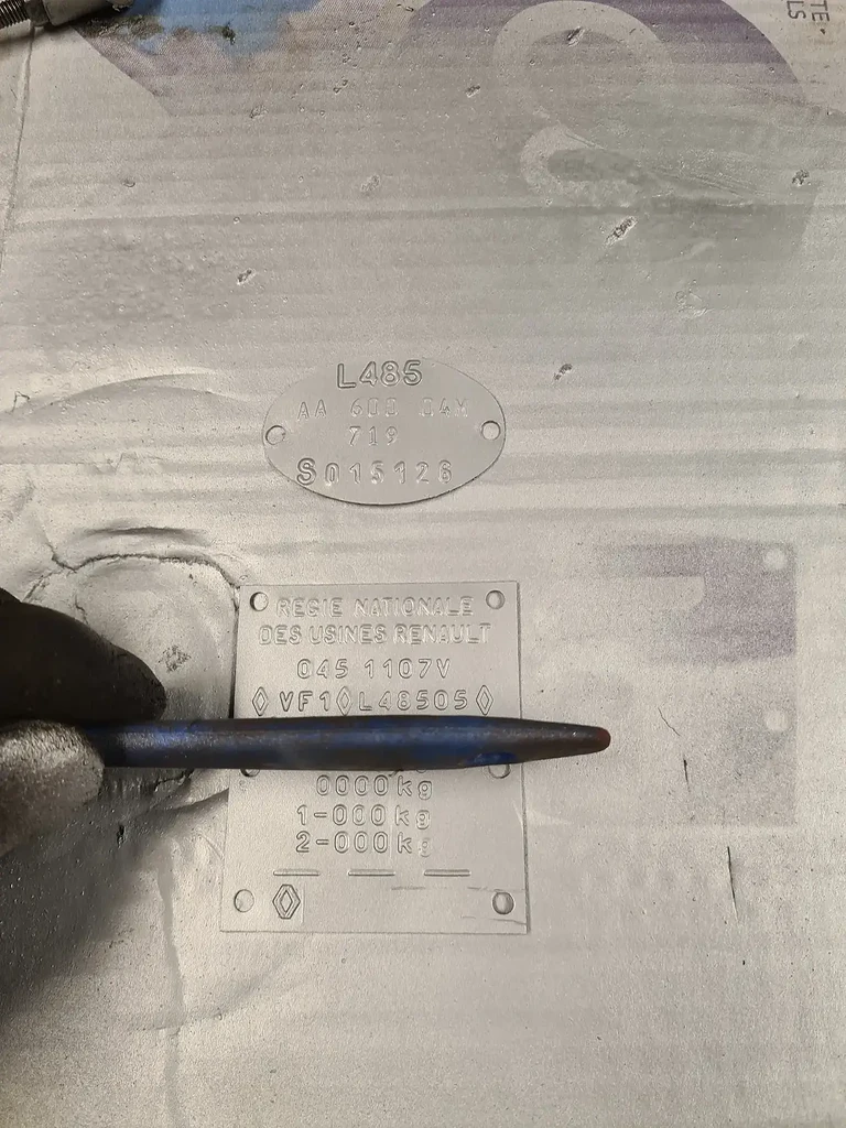

Cleaned and refitted the VIN tags

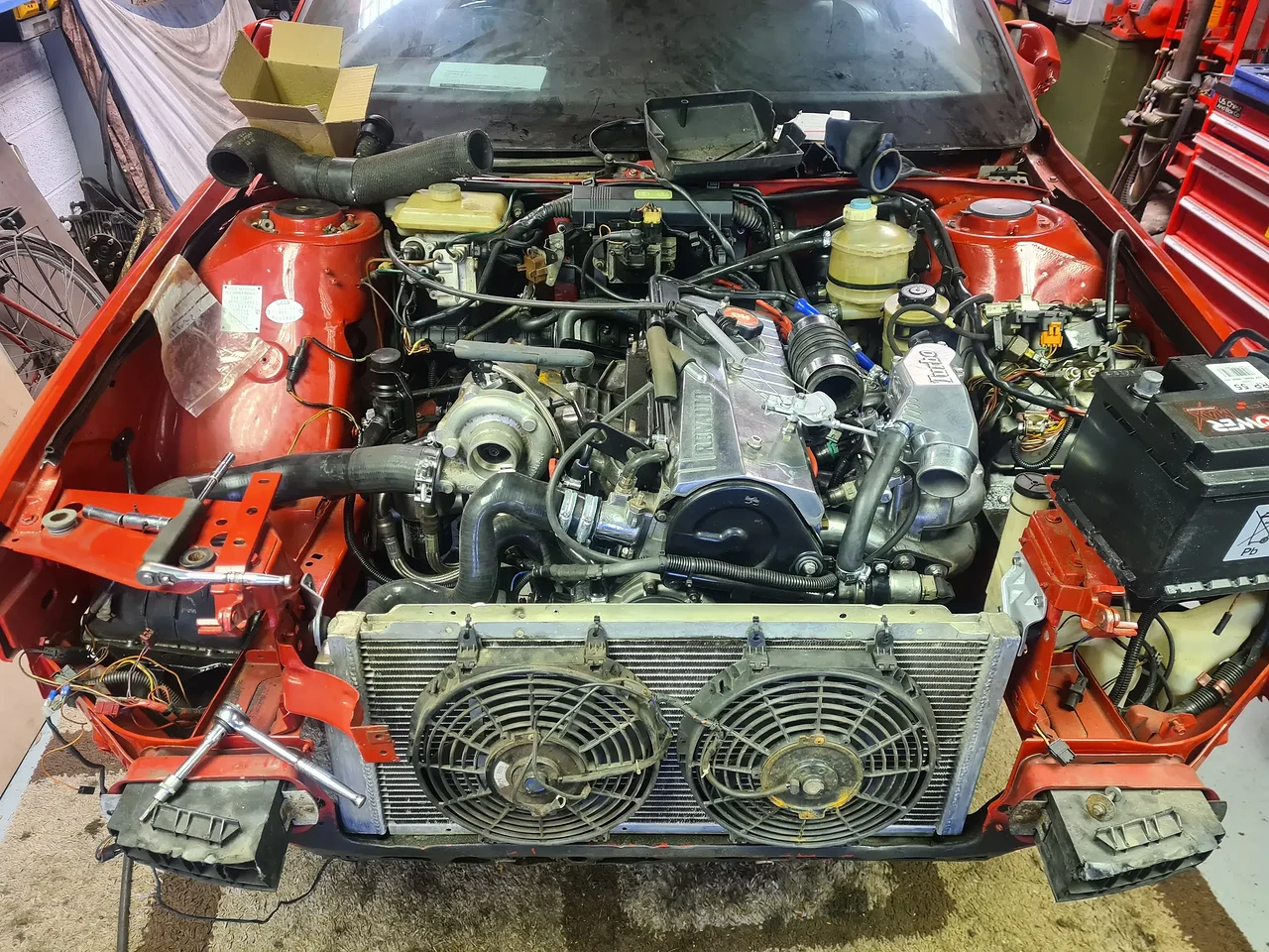

And then I ran it up for 20mins, up to fan temp. Let it run with a fan on for a bit, heater seems to work OK, no issues to report really save the header tank cap was leaking so I stuck a Megane one on it :slight_smile: Ready for the head bolt retorque now!
Can’t find a bloody fan switch, or the top crossmember which is annoying… need to source some parts!
OK then time to retorque the head bolts and set the valve clearances.

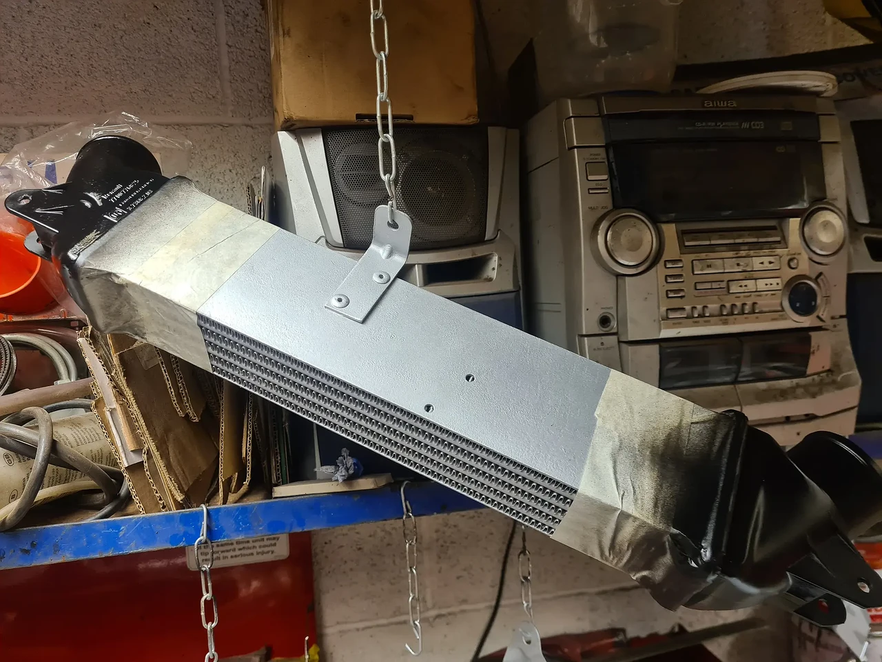

I found a temporary crossmember in roof storage so stuck that on and fitted the new rubber woggle things for the intercooler
Once that was done I ran it for a few mins, topped up the coolant and then pondered the next task. I decided to clean up the fluid leak underneath on the rear beam. This escalated…quickly.

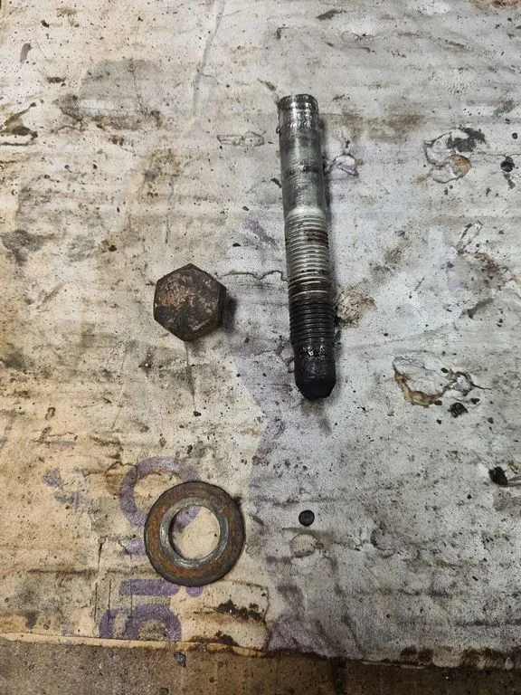

Note to self/everyone, these are 14mm hex, M10 heatproof nuts, makes refitting the turbo on the manifold loads easier. Normal M10’s are 17mm hex.

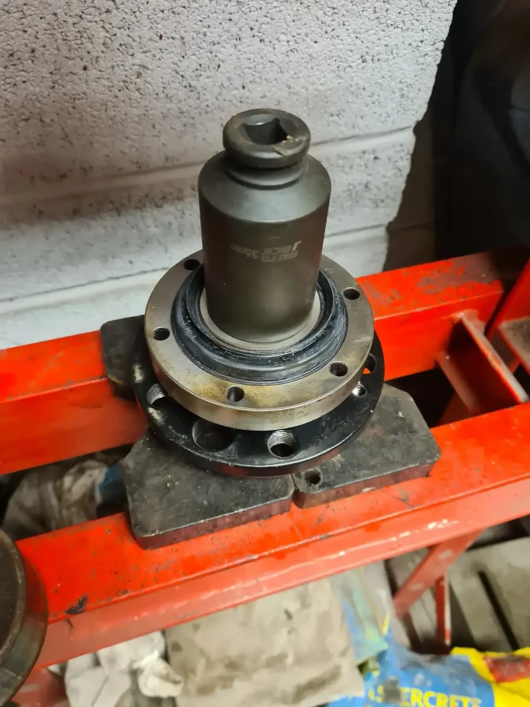

First off I got that blasted seized torx screw tail out of the wheel bearing assembly.

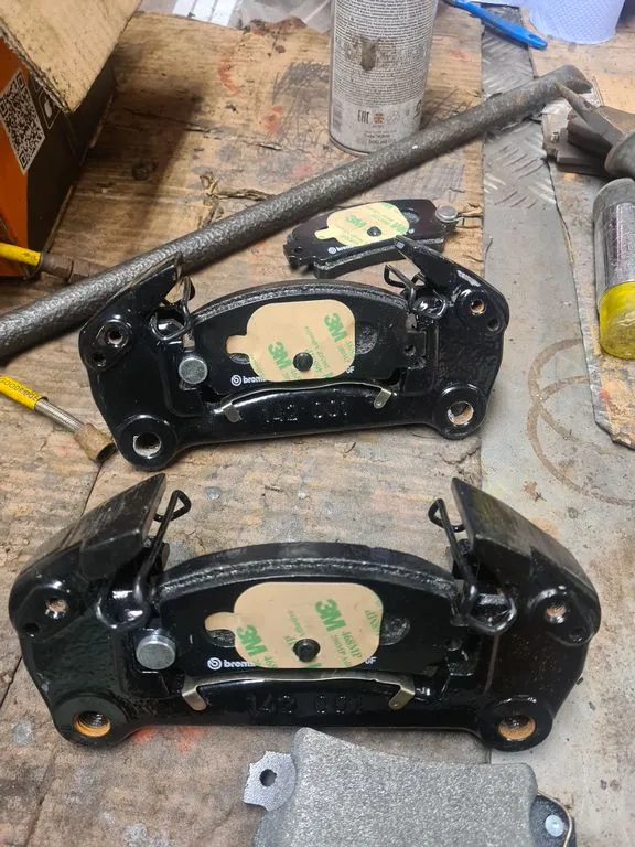

Caliper hangers and calipers.

Got the front brakes back together, struggling to find new front discs at the moment so put on a set of used I had on the shelf for now. Rebuilt calipers with new pistons and a new fitting kit, new pads and new braided lines.

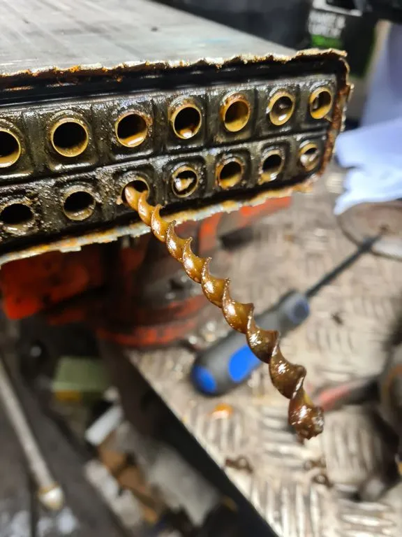

The times ive run it up to temp I noticed a bit of steam coming out the heater inlet, when I turned the blower motor on it blew steam out the heater vents. I was hoping it was just some residual damp in the matrix but seeing as its been dry stored for almost 8 years, I knew deep down what was coming.
Heater box out, and yet another parts problem in that I can’t get a new matrix for RHD any more! Supply seems to have dried up, so I had to improvise and bought a LHD one. The core is the same, so I set about swapping the top end tanks over. Might seem a faff but the new matrix was £30 and recoring the old one was >£100.
Yeah, definitely a leaky matrix. Yuk!
End tank swap.

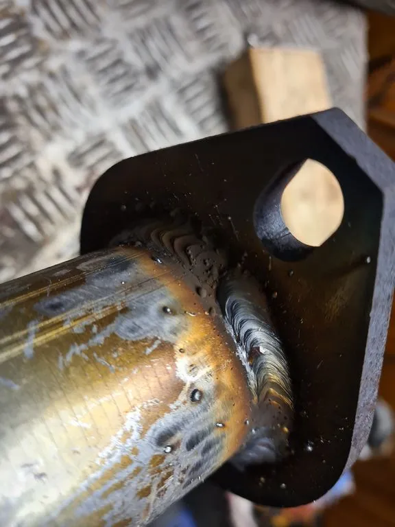

Still plugging away, was flaming cold this weekend and heater ran out of gas so I didnt stop for many pics. However, I did get the exhaust completed, welding in a gasketed flange join for the back cos a really hate sleeve joints.
