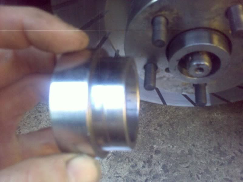

You could always try making some of these if you don't get hubcentric ones ... I had these made for my GT4 as I fitted a large brake conversion which required disc spacers ...
