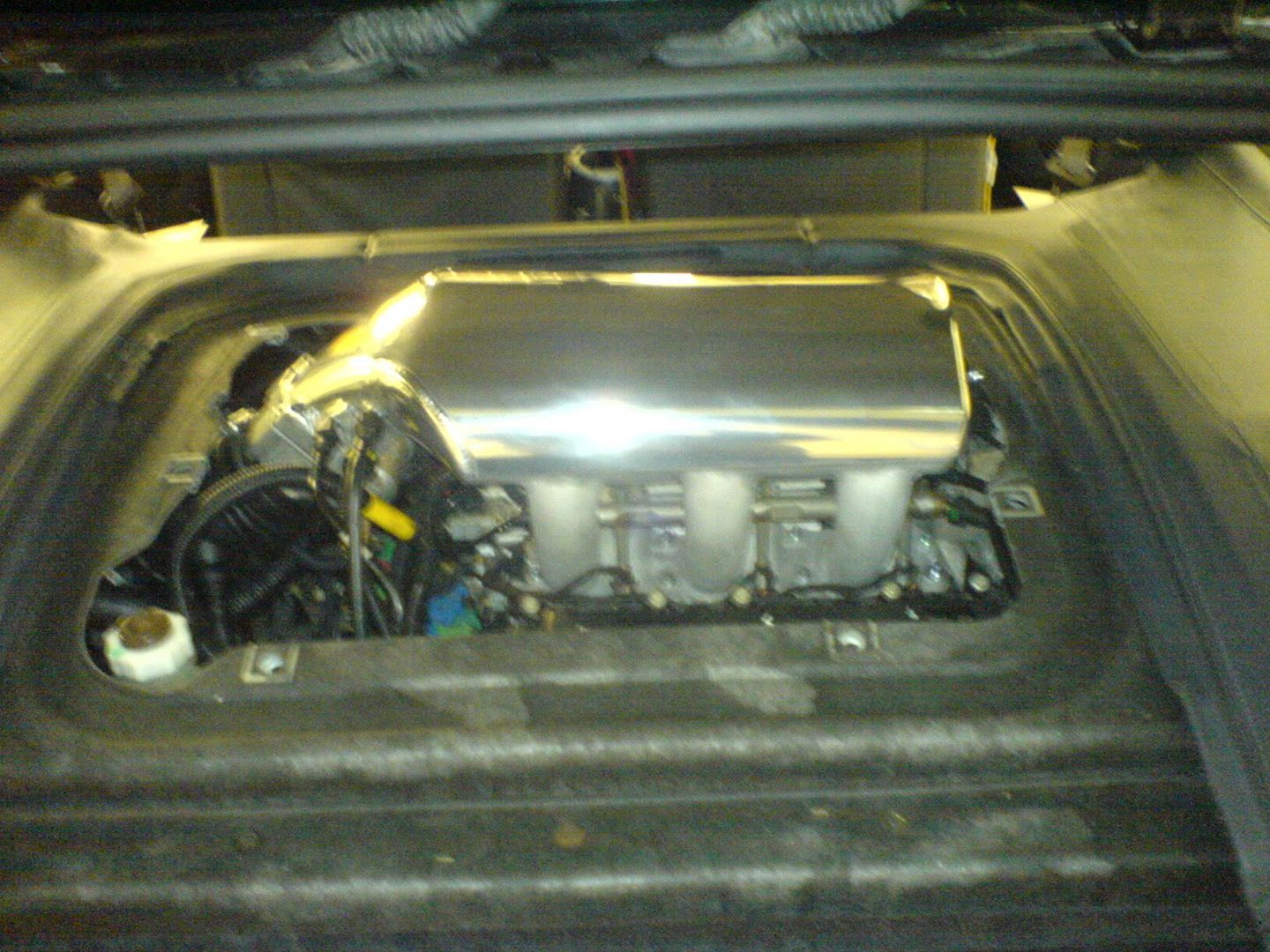

My standard plenum capacity was measured prior to fitting the upgraded "thing". They told me the standard plenum was lacking in capacity. Of course keep in mind they were not likely to tell me it was fantastic as standard. ;)
The "thing" created a heck of a lot more capacity (and NOISE). I don't doubt more in equalled more power, it certainly did, my Vee was shockingly faster!

Goodness me, that "thing" does look like a UFO [smilie=icon_eek.gif]
Did you run without the engine covers then? The noise would have been horrendous.

The spacers are for the Ph2 inlets and cover ( not sure how much different they are from Ph1's )
I made the spacers up in my spare time ;) have access to CAD/CAM software and CNC machine. The spacers were never going to get fitted on my car, I was only asked if I could possibly make a set.
The ones in the photo are 15mm thick and internal sizes ( excluding rads ) are roughly 280mm X 97mm.
