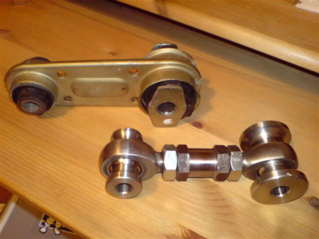

Now this got me thinking that if I need to replace these would it be worthwhile to source a custom lower engine mount and some uprated bushings (I remembered reading in the forums that [mention=393,#003300]Ali[/mention] advised against using stiffer bushes like those powerflex ones)
A pic of the custom lower engine mount from a very old thread in this post
82 00 000 003 Lower Engine Mount by Billy W, on Flickr
Don't know if they are still available though....

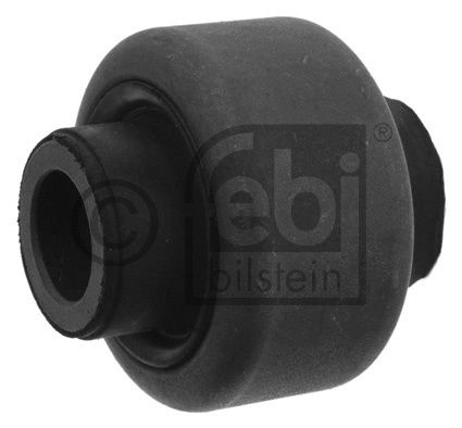

And these are the rear lower suspension arm bushings
7700822503 Rear Lower Susupension Arm Bush by Billy W, on Flickr

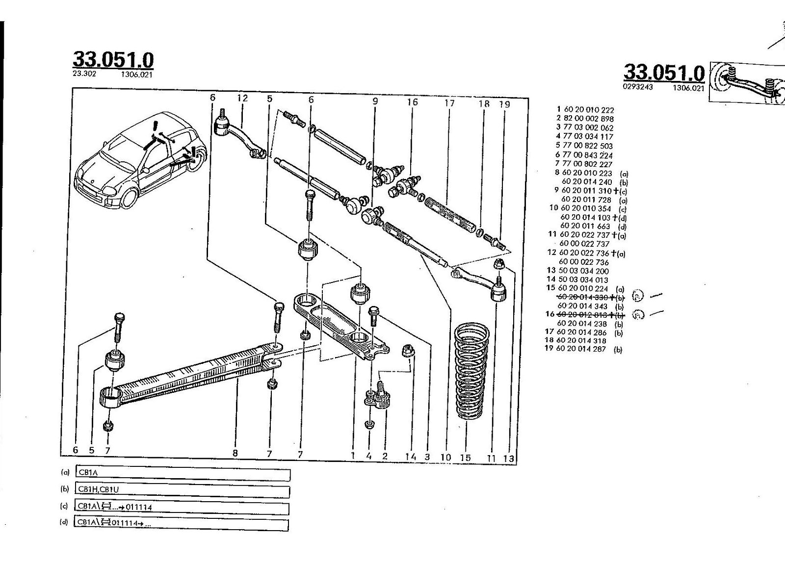

Located as Item 5 in the fiche
Clio V6 Rear Subframe_Page_2 by Billy W, on Flickr

2) any benefits of fitting aftermarket bushes? (I am really looking for durability to be honest)

Read too many regrettable stories online on ppl going for the poly bush route so I might just stick with original.

I am now looking at part number fiche and cannot confidently work out which ones are the flexible "rubber" bits that needs to be ordered. Also, are the nuts & bolts to secure the mounts be usually replaced at the same time?
I think I need the following but can anyone confirm whether they are the flexible bits that I need to replace on my Ph1?
Upper Engine Mount (5) 82 00 000 036
Upper Engine Mount bolt (6) 77 00 101 425
Upper Engine Mount (1) 60 20 011 801
Upper Engine Mount (4) 82 00 020 693
Upper Engine Mount bolt (20) 77 03 002 242
N/S Upper Engine Mount (15) 82 00 000 018
N/S Upper Engine Mount bolt (14) 82 00 000 030
N/S Upper Engine Mount nut (16) 77 03 034 204
Many thanks in advance!

How did you go sourcing engine mount components? My mechanic mentioned my gearbox side engine mount may need replacing (item 14, 15, 16 in the diagram).
